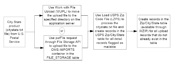

 1. Download the City State Product from the USPS web site.
2. When you receive the City State product:
• If you use the File Storage API, use the putFile request message to upload the file to the OMS-IMPORTS container in the FILE_STORAGE table; otherwise,
• If you do not use the file storage API, use the Work with File Uploads (WUPL) menu option to copy the data file to the location on your application server specified in the CWDIRECTCP_ USPS_UPLOAD_ FILE property. An example directory is /domain/conf/OMSFiles/LZIP/ctystate.txt/, where domain is the WebLogic domain directory for Order Management System. The file name matching is case-sensitive.
Note that even if you use the file storage API, the process uses the folder specified in the CWDIRECTCP_ USPS_UPLOAD_ FILE, so you must set up this property.
3. Use the Load USPS File Screen to submit the LZPS job, which uses the contents of the ctystate.txt data file to create records in the Zip/City/State table if these records do not already exist. The job performs the following steps:
