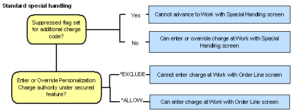

Standard special handling: The following chart summarizes how the system controls access for standard special handling formats:

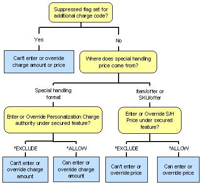

 Custom special handling: The following chart summarizes how the system controls access for custom special handling formats:
 Summary: The following table summarizes the situations in which you can enter or override the special handling charge or price:
| Screen | You can enter or override special handling charge/price if: |
| Special handling type = standard Authority under the Enter or Override S/H Price secured feature is *ALLOW | |
| Special handling type = standard Display of the special handling screen is not suppressed | |
| Special handling type = custom Display of the special handling screen is not suppressed And: • If the special handling price is derived from the special handling format: authority under the Enter or Override Personalization Charge = *ALLOW; or, • If the special handling price is derived from the item/offer or SKU/offer: authority under the Enter or Override S/H Price secured feature = *ALLOW |
