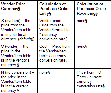

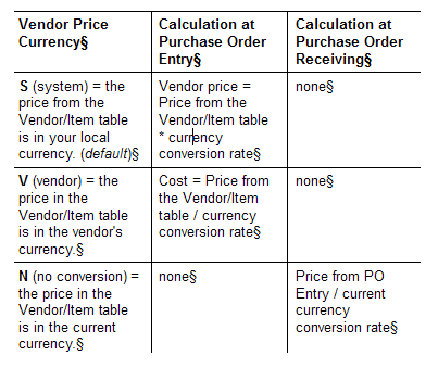

Currency code |
A code to identify a currency type. This code is used by the Purchase Order system to identify a vendor's currency and to perform currency conversion processing if the vendor's currency is different from yours. Currency codes are defined in and validated against the Currency Code table (fast path = WCUR). Defaults from the Local Currency Code (A55) system control value, but you can override it. The currency code you enter here defaults when you enter purchase orders, but you can override it. Note: The Supplier Direct Fulfillment integration does not support currency conversion. Alphanumeric, 3 positions; required. |
Indicates whether the prices from this vendor are in the system's currency or the vendor's own currency and controls how and when currency conversion takes place. |
Note: If this field is set to N or V, you must define vendor items in the Vendor Item table for the system to calculate the cost at the time of receiving. If you override the currency rate during Purchase Order Receiving, the system uses the following calculation: Price from Purchase Order/current currency conversion rate. Note: The Supplier Direct Fulfillment integration does not support currency conversion. Alphanumeric, 1 position; required. |
