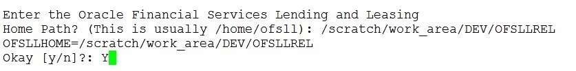

- On seeing the below prompt, enter OFSLL_HOME path. When the script prompts for confirmation, enter ‘y’ to continue.

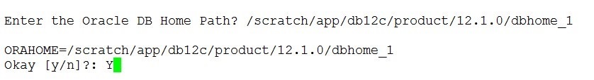

- On seeing the below prompt, enter Oracle DB Home Path. When the script prompts for confirmation, enter ‘y’ to continue.

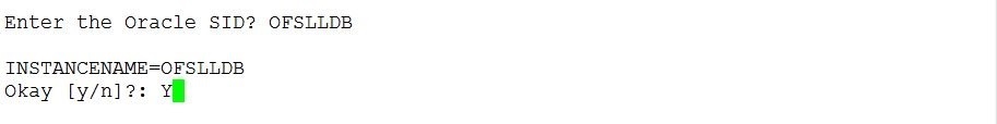

- On seeing the below prompt, enter Oracle SID. When the script prompts for confirmation, enter ‘y’ to continue.

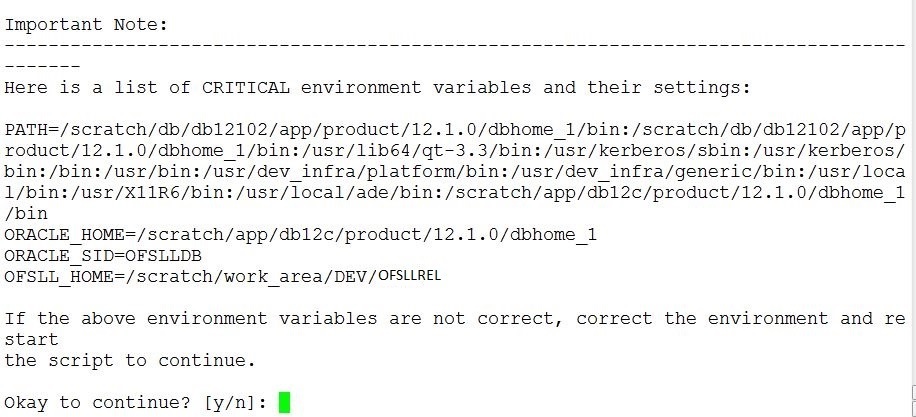

- Verify the critical environment variables and confirm 'Y' to continue.

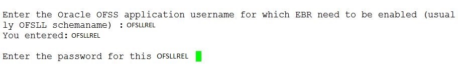

- Enter User ID who owns OFSLL objects and press ‘Enter’. You are prompted to enter password for the user. Enter the password and press ‘Enter’.

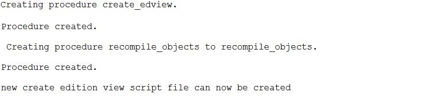

- The installer creates required procedures in the schema.

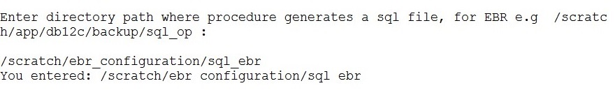

- When prompted, enter the path of directory for procedures to write sql files and press ‘Enter’. This is the same directory which was created before starting the installation process.
- Enter name of the directory object that is to be created to access the above path and press ‘Enter’.
- The installation process starts and the installer creates the required procedures and executes them.
The installation completes after recompiling all the invalid objects.
