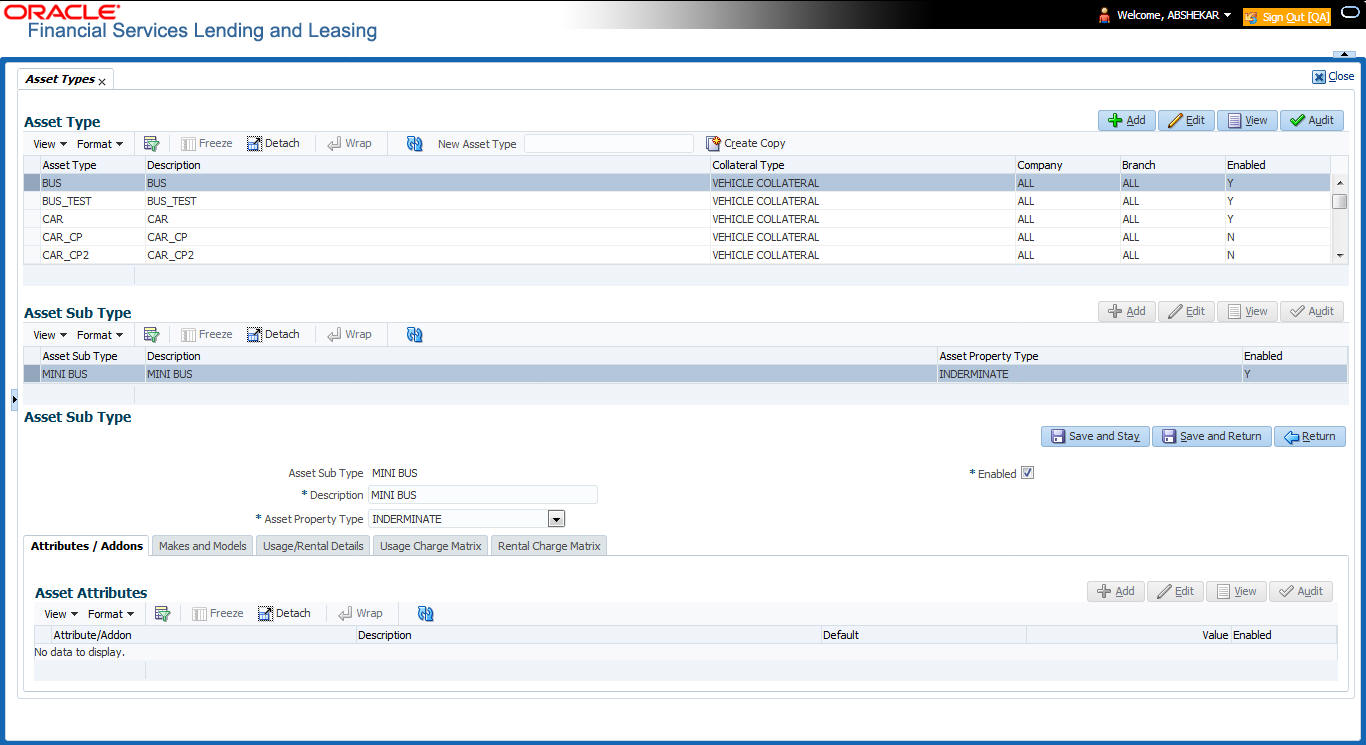

4.1 Asset Types
In Assets types you can setup the asset types that can serve as an application or account’s collateral.
The information on the Assets screen is used by the system to automatically display the appropriate collateral screen (Vehicle, Home, or Other) on the Application Entry screen.
The system recognizes the following four types of collateral:
Collateral Type
Description
Home collateral
Homes, manufactured housing, or any real estate collateral.
Vehicle collateral
All vehicle types, such as cars, trucks, and motorcycles.
Household goods and other collateral
All other collateral types not defined as home, vehicle, or unse­cured; for example, household items such as water heaters, tele­visions, and vacuums.
Unsecured collat­eral
All unsecured lending instruments. (This collateral type makes the collateral tabs on the system forms unavailable.)
The Asset Sub Type section allows you to further categorize an asset; for example, the asset type vehicle might be categorized as car, truck, or van.
The Attributes/Addons and Makes and Models sub screens continue to further detail the asset both in description and value. For example, a vehicle asset might include addons such as leather seats and cruise control.
Note
Neither asset types nor asset sub types can be deleted. As they may have been used in the past, the display and processing of that data is still dependent on the existing setup.
To set up the Asset Types
You can either define new Asset Type or specify a new name in the New Asset Type field and click Create Copy to create a copy of selected asset with details.
  1. Click Setup > Setup > Products > Asset Types.
  2. In the Asset Type section, perform any of the Basic Operations mentioned in Navigation chapter.
A brief description of the fields is given below:
Field:
Do this:
Asset Type
Specify the asset type.
Description
Specify the description for the asset. (This is the asset type which will appear throughout the system).
Collateral Type
Select the collateral type (the general category that the asset type falls within) from the drop-down list.
Note: There is no need to define an asset for UNSECURED COLLAT­ERAL, as by definition there is no asset on such account.
Company
Select the portfolio company to which the asset type belongs, from the drop-down list. These are the companies within your organization that can make Lines using this asset type. This may be ALL or a specific company.
Branch
Select the portfolio branch to which the asset type belongs, from the drop-down list. This is the branch within the selected company that can make Lines using this asset type. This may be ALL or a specific branch. This must be ALL if in the Company field you selected ALL.
IMPORTANT: By selecting which asset type to use, the system searches for a best match using the following attributes:
1 Company
2 Branch
Hence, the system recommends creating one version of each asset type where ALL is the value in these fields.
Enabled
Check this box to enable the asset type and indicate that the asset type is currently in use.
  1. Perform any of the Basic Actions mentioned in Navigation chapter.
  2. In the Asset Sub Type section, perform any of the Basic Operations mentioned in Navigation chapter.
Field:
Do this:
Asset Sub Type
Specify the asset sub type.
Description
Specify the description for the asset subtype
Asset Property Type
Select the type of property from the drop-down list.
Enabled
Check this box to enable the asset sub type.
  2. Click Setup > Setup > Products > Assets > Attributes/Addons.
  3. In the Attributes/Addons section, perform any of the Basic Operations mentioned in Navigation chapter.
Field:
Do this:
Attribute/Addon
Displays the asset attribute or addon name for the selected asset).
Description
Select the description for the asset attribute/addon from the drop-down list.
Default
Specify the default text to be copied or displayed when the asset attributes and addons fields are completed on an application for this asset.
Value
Specify the default monetary value to be copied or displayed when the asset attributes and addons fields are completed on an applica­tion for this asset.
Enabled
Check this box to enable the asset attribute/Addon and indicate that it is available for this type of asset.
  2. Click the Setup > Setup > Products > Assets > Makes and Models.
  3. In the Makes and Models section, perform any of the Basic Operations mentioned in Navigation chapter.
Field:
Do this:
Make
Specify asset make.
Model
Specify asset model.
Style
Specify asset style type.
Model Year
Specify asset model year.
Enabled
Check this box to enable the asset make and model and indicate that it is included on fields for this asset type.

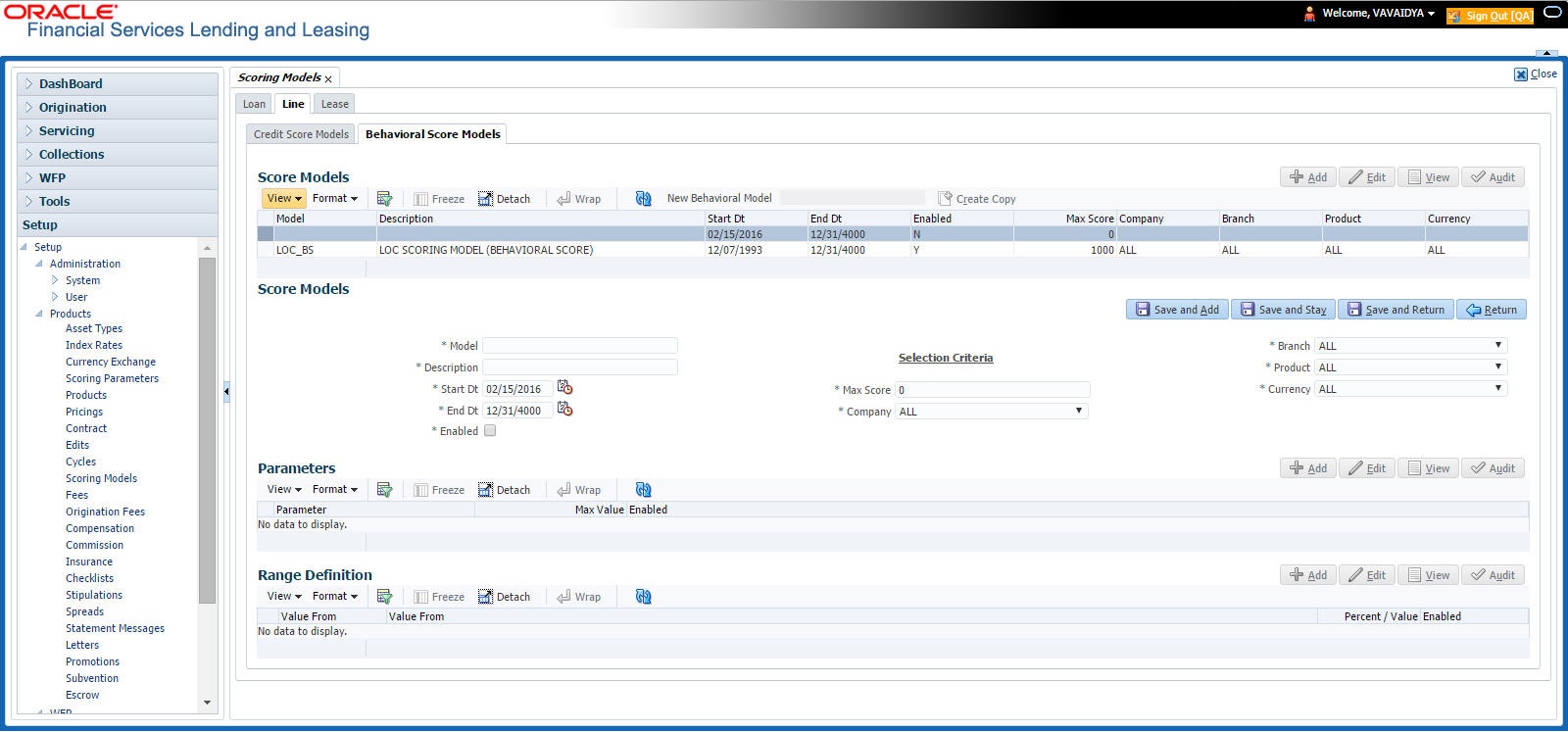

4.2 Scoring Parameters
With the Scoring Parameters, you can define the scoring parameters of a company’s credit scorecard and behavioral scoring.
Pricing scores apply to applications and are based on information recorded during origination, behavioral scoring applies to accounts and is based on account history attributes and performed on a monthly basis.
Behavioral scoring
Behavioral scoring examines the repayment trends during the life of the account and provides a current analysis of the customer. This logical and systematic method identifies which accounts are more likely to perform favorably versus accounts where poorer performance is probable. This is useful when determining which other Lines of credit/loan products a customer may qualify for.
This information appears on the Customer Service form in the Account Details screen’s Activities section.
To set up the Scoring Parameters
You can either define new Scoring Parameters or specify a new name in the New Parameter field and click Create Copy to create a copy of selected parameter with details.
  1. Click Setup > Setup > Products > Scoring Parameters.
  2. In the Parameters section, perform any of the Basic Operations mentioned in Navigation chapter.

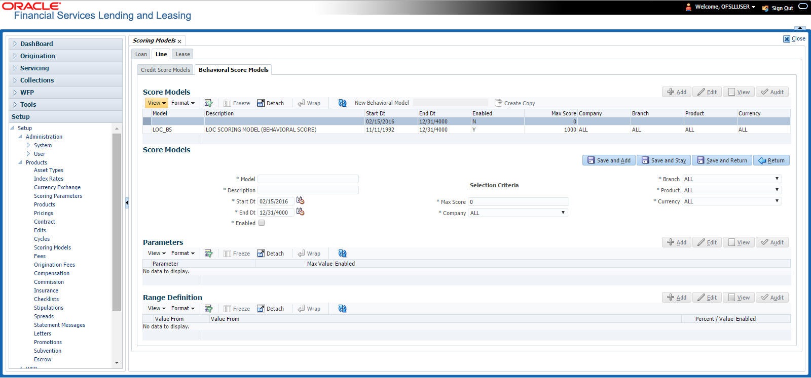

Field:
Do this:
Parameter
Specify the name of the scoring parameter. The system recom­mends entering a name that in some way reflects how the parameter is used; for example, use FICO_SCORE instead of PARAMETER_1.
Description
Specify a description of the parameter. Again, Specify a name that reflects how the parameter is used; for example, use FICO SCORE and WEIGHTED FICO SCORE instead of FICO SCORE NUMBER 1 and FICO SCORE NUMBER 2.
Data Type
Select the data type of the scoring parameter being defined from the drop-down list. This determines how the system handles the values. (While DATE and CHARACTER are available data types, generally only NUMBER should be used when defining a scoring parameter.
Scoring Type
Select the scoring type from the drop-down list: credit scoring or behavioral scoring.
Enabled
Check this box to enable and indicate that the scoring parameter is available.
The Formula Definition section allows you to define a mathematical expression of the scoring parameter you want to define. The expression may consist of one or more sequenced entries. All arithmetic rules apply to the formula definition. If errors exist in the formula definition, the system displays an error message in this section when you choose Show Expression.
  1. In the Formula Definition section, perform any of the Basic Operations mentioned in Navigation chapter.
Field:
Do this:
Seq
Specify the sequence number (the order in which the formula definition variable will be assembled and evaluated).
Specify a left bracket, if you need to group part of your formula definition.
Variable
Select the variable from a validated field based on the user-defined table SCR_CRED_SUMMARY: SCORING PARAMETERS, from the drop-down list.
Constant Value
Specify the constant value (optional).
You can specify varchar values which includes Numbers, Alphabets/letters, special character/symbols.
Mathemati­cal Operator
Select the math operator to be used on the adjacent formula definition rows, from the drop-down list.
Specify a right bracket, if you are grouping part of your formula definition.
Enabled
Check this box to enable the formula and indicate that it is included when building a definition for the scoring parameter.
  2. In the Parameters section, click Show Expression.
The mathematical expression appears in the Formula Expression section (in sequential order) in the Expression field.

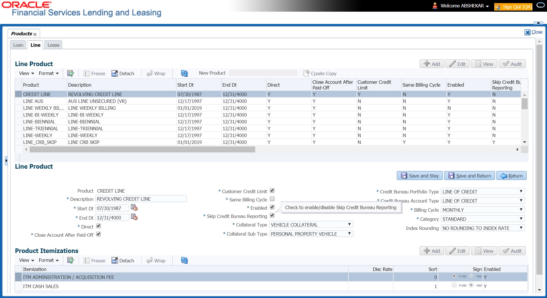

4.3 Products
The Product screen defines the closed ended products your organization offers. This screen is enhanced to support Islamic along with the conventional.
A product is based on the following attributes:
The Product Definition section records details about the product such as the description, start and end dates, collateral type and sub type, credit bureau reporting attributes, billing cycle, index and rate calculation attributes.
System supports ‘Biennial’ (once every 2 years) and Triennial (once every 3 years) type of billing cycles. Based on the following lookups, the billing cycle ‘frequency’ can be defined:
The Product Itemization section is used to define itemized entries for a product. This information is used on the Itemization sub screens of the Application Entry and Application screens.
The Rate Adjustments section is used to define the frequency of rate change allowed during interest rate calculations.
To set up the Product
You can either define new Product details or specify a new product code in the New Product field and click Create Copy to create a copy of selected product with details.
  1. On the Oracle Financial Services Lending and Leasing home screen, Setup > Setup > Administration > User > Products > Products > Line.
  2. In the Product Definition section, perform any of the Basic Operations mentioned in Navigation chapter.
Field:
Do this:
Product
Specify the product code as defined by your organization (in other words, how you want to differentiate the products). For example, products can be differentiated according to asset. The product code, or name, is unique.
Description
Specify the description of the product. (This is the product description as it appears throughout the system).
Start Dt
Specify the start date for the product. You can even select the date from the adjoining Calendar icon.
End Dt
Specify the end date for the product. You can even select the date from the adjoining Calendar icon.
Direct
Check this box, if you need the product to be originated directly to customer. (In this case, the compliance state is the state listed in the customer’s current mailing address.) If unchecked, the product is an indirect lending product; that is, payment is made to the producer. (In this case, the compliance state is the state listed in the producer’s address.)
Close Account After Paid-Off
Check this box to allow the account to be closed once the account is paid off i.e. system closes the account after the number of days specified in the system parameter has elapsed. This option is selected by default.
If not selected, system ignores the system parameter and does not close the account even if the account is paid off i.e. system keeps the accounts active so that the equity can be traded with other accounts. For information on accounts trading, refer to ‘Appendix - Trading of Accounts’ chapter.
Note: If the business practice of a financial institution is ‘not’ to close the accounts then this Indicator need to be unchecked. Mainly in the Vacation Ownership where a Timeshare Loan can be traded anytime even if the account is paid-off, this feature is used.
Customer Credit Limit
Check this box to enable ‘Customer Credit Limit’ tab in Origination module. Using the ‘Customer Credit Limit’ tab, an underwriter can define a specific credit limit for the customer while funding the first application and based on that credit limit, subsequent applications can be funded.
For more information, refer to ‘Customer Credit Limit’ details in User Guide.
Same Billing Cycle
Check this box to set the same billing cycle (supported only billing cycles Monthly and Weekly) for all the future applications funded for an existing customer.
Enabled
Check this box to activate the product.
Note: You can check this box only when Rate adjustment schedule is maintained, i.e., All the products should be variable rate products.
Skip Credit Bureau Reporting
Check this box to skip credit bureau reporting of all Accounts funded with this product type - i.e. on funding an application, that particular account is enabled with this parameter and is excluded when the metro II batch job is run for credit bureau reporting.
This option can also be enabled/disabled at individual account level in Servicing by posting ‘Skip Credit Bureau Reporting Maintenance’ non-monetary transaction.
However note that existing behaviour of ‘Stop Bureau Account’ condition would still be applicable.
Collateral Type
Select the collateral type for the product, from the drop-down list. This field identifies what type of collateral is associated with the and assists the system in identifying the correct screen(s) to display.
Collateral Sub Type
Select the collateral sub type for the product, from the drop-down list.
Credit Bureau Portfolio Type*
Select the credit bureau portfolio type for the product, from the drop-down list.
Credit Bureau Account Type*
Select the account type for the product, from the drop-down list.
*Note: The Credit Bureau Portfolio Type and Credit Bureau Account Type fields determine how the portfolio is reported back to the credit bureaus.
Billing Cycle
Select the billing cycle for the product, from the drop-down list.if
Category
Select the category as Standard for the conventional product and Islamic for the Islamic product, from the drop-down list. This serves to group products for reporting purposes.
Index Rounding
Select the index rate rounding factor for the product, from the drop-down list.
Note: For more information, refer Appendix C: Rounding Amounts and Rate Attributes.
4.3.1 Product Itemizations
  1. Click Setup > Setup > Administration > User > Products > Products > Line > Product Itemizations.
  2. In the Product Itemization sub screen, perform any of the Basic Operations mentioned in Navigation chapter.
Field:
Do this:
Itemization
Select the itemization type for the product selected in product definition section, from the drop-down list.
Discount Rate
Specify the discount rate.
Sort
Specify the sort order.
Sign
Select +ve for a positive number and -ve for a negative number.
Note: The +ve and -ve buttons determine whether the values will increase or decrease the itemization total for the product based on the selected product. Together the contents of the Product Itemization sub screen, positive and negative, add up to the amount.
Enabled
Check this box to indicate that this product itemization is currently available.

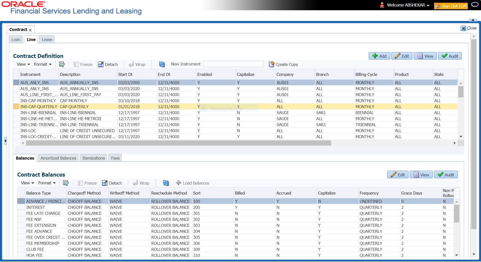

4.4 Contract
The Contract screen allows you to define the instruments used within your system. A instrument is a contract used by a financial organization with specific rules tied to it. When processing an application, an instrument associated with the application informs the system of the type of contract being used for the approved loan. This ensures that all parameters tied to the instrument are setup for the account as it is booked - without requiring you to do it.
Instruments can be setup at different levels:
The following groups of parameters are setup at the instrument level (Each has its own section on the Contract screen):
Items defined in the contract are “locked in” when you choose Select Instrument on the Funding form’s Contract link.
The Contract screen’s Instrument and Description fields allow you to enter the financial instrument’s name and description.
To set up the Contract
You can either define new Contract Definition details or specify a new name in the New Instrument field and click Create Copy to create a copy of selected contract with details.
  1. On the Oracle Financial Services Lending and Leasing home screen, click Setup > Setup > Administration > Products > Contract > Line
  2. On the Contract Definition section, perform any of the Basic Operations mentioned in Navigation chapter.

Instruments section
Instrument
Specify the code identifying the instrument.
Description
Specify the description of the instrument being defined.
Start Dt
Specify the start date for the instrument. You can even select the date from the adjoining Calendar icon.
End Dt
Specify the end date for the instrument. You can even select the date from the adjoining Calendar icon
Enabled
If you check this box, the system will consider this contract definition when selecting a instrument for an application.

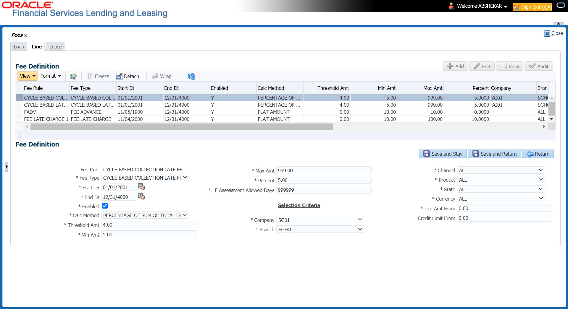

Cycle Based Fees - This section allows to define the parameters for calculating cycle based fees at individual account level. Using the below parameters, system derives the Cycle Base Fees and updates the account balances on processing the following batch jobs - TXNCBC_BJ_100_01 (CYCLE BASED COLLECTION LATE FEE PROCESSING) and TXNCBL_BJ_100_01 (CYCLE BASED LATE FEE PROCESSING). For more information, refer to ‘Fee Consolidation Maintenance’ section in Appendix chapter.
System calculates the below type of fee in combination of associated and master account and is assessed only when total due crosses ‘Threshold’ amount (that is defined in Setup > Products > Contract > Fees tab and Setup > Products > Fees screen):
Fee Late Charge (FLC)
  • Percentage of sum of payment due
  • Percentage of sum of standard payment
  • Percentage of sum of billed amount
Cycle Based Collection Late Fee
  • Flat amount
  • Percentage of payment due
  • Percentage of standard payment
  • Percentage of billed amount
  • Percentage of total due amount
  • Percentage of sum of total due amount
Cycle Based Late Fee
  • Flat amount
Check this box to enable cycle based collection late fee assessment on the account.
If selected, the balance type CYCLE BASED COLLECTION LATE FEE is made available in the Balances tab which further allows to define how system should derive the balances when an account is booked and funded.
If unchecked (default), system does not display the ‘Cycle based Collection Late Fee’ balance in Contract >Balances tab on clicking ‘Load Balances’ button.
Check this box to enable cycle based late fee assessment on the account.
If selected, the balance type CYCLE BASED LATE FEE is made available in the Balances tab which further allows to define how system should derive the balances when an account is booked and funded.
If unchecked (default), system does not display the ‘Cycle Based Late Fee’ balance in Contract >Balances tab on clicking ‘Load Balances’ button.
Cycle Based Collection Late Fee Grace Days
Specify the number of grace days allowed before cycle based collection late fee is assessed on the account. This field is enabled only if the Cycle Based Collection Late Fee option is checked above.
Cycle Based Late Fee Grace Days
Specify the number of grace days allowed before cycle based late fee is assessed on the account. This field is enabled only if the Cycle Based Late Fee option is checked above.
Fee Consolidation - If Cycle Based Late Fee is assessed based on above parameters, this section allows to enable/disable the option to consolidate the late fee at Master Account level.
Late Charge at Master Account
Check this box to allow system to consolidate the late charge assessment at master account level.
Cycle Based Collection Late Fee at Master Account
Check this box to allow system to consolidate the cycle based collection late fee assessment at master account level.
Ensure that, the option ‘Cycle Based Collection Late Fee’ is also checked for fee consolidation at Master Account level.
Cycle Based Late Fee at Master Account
Check this box to allow system to consolidate cycle based late fee assessment at master account level.
Ensure that, the option ‘Cycle Based Late Fee’ is also checked for fee consolidation at Master Account level.

4.4.1 Balances
The Balances sub screen lists the balances that will be established when an account is booked and funded.
CAUTION: Please contact your Implementation Manager for changes to this section.
To set up the Balances
  1. Click Setup > Setup > Administration > User > Products > Contract > Line > Balances.
  2. On the Balances sub screen, perform any of the Basic Operations mentioned in Navigation chapter.
Field:
Do this:
Balance Type
Displays the balance type.
Chargeoff Method
Select the charge off method to determine how the outstanding amount of this balance type will be handled from the drop-down list, if the account becomes uncollectable and the product is charged off.
Writeoff Method
Select the write off method to determine how the outstanding amount of this balance type will be handled from the drop-down list, if the account is within the write off tolerance of being PAID.
Reschedule Method
Select the reschedule method to determine how the outstanding amount of this balance type will be handled from the drop-down list, if the account is rescheduled.
Sort
Specify the sort order of how account balances will appear on the Customer Service form’s Balance screen.
Billed
Check this box to indicate that outstanding amounts for this bal­ance type are considered a part of the billed amount. This also determines whether payments applied to this balance type are considered when satisfying outstanding amounts due.
Accrued
Check this box to indicate that outstanding amounts for this bal­ance type will be included when interest is accrued against the account.
Non Performing Rollover
Check this box to indicate that “non-performing” is used as an intermediary status on your general ledger prior to charge off and want to create balances for non-performing accounts for this bal­ance type.
Note: (The Non-Performing Rollover box applies only to Balance Types of Advance/Principal and Interest. For all other Balance Types, this box would be cleared).
Non Performing Balance Type
Select the balance type you want to rollover from drop-down list, if you select the Non-Performing Rollover box (Advance/Princi­pal).
Enabled
Check this box to indicate that this balance type will be created when the account is booked and funded
This section is applicable if the capitalization frequency is selected as Balance Frequency for the contract and allows you to define capitalization parameters for a specific type of account balance such as ‘Interest’.
Note: The value of parameters defined in this section supersedes the values defined in header section.
Capitalize
Check this box to enable capitalization parameters for the selected balance type. By default, this option is un-checked.
Note: The option is disabled for ‘Advance / Principal’ type of Loan or Line contracts and for Lease Receivables.
Frequency
Select the capitalization frequency from the drop-down list. Frequency can be selected using any of the following options:
- Based on specific intervals such as Monthly, Quarterly, Annual and so on.
- Based on contract Billing Frequency, Billing Date, Due date.
- Specifically on every Month End.
Grace Days
Specify the grace days allowed in the frequency (minimum 0, maximum 31) before capitalizing the balances to account. This is also the deciding factor for executing the capitalization batch job which is based on Capitalization Frequency + Grace Days.
However, note that Grace Days are not accounted for Month End type of capitalization frequency and is ignored even if specified.
The system loads the currently defined balances for accounts.
If your organization maintains additional balances, contact your Implementation Manager for information regarding those balances.

Escrow
Allows you to connect the actual escrow itemization with the escrow type and the funding transaction.
To set up the Itemizations
  1. Click Setup > Setup > Administration > User > Products > Contract > Line > Itemizations.
  2. On the Itemization sub screen select the option button to indicate the type of itemization you are working with: Advance, Financed Fees, Pre-Paid Fees, Producer, or Escrow.
  3. On the Itemization sub screen, perform any of the Basic Operations mentioned in Navigation chapter.
Field:
Do this:
Itemization
Select the itemization from the drop-down list.
Disbursement Type
Select the disbursement type from the drop-down list.
Transaction
Select the funding transaction type from the drop-down list.
Itemization Type
Select the itemization type from the drop-down list.
Notes:
1. On selecting the "Prefunding Txns" as itemization type, it indi­cates that this particular itemization expects a payment from the cus­tomer prior to funding.
2. The itemization type "Prefunding Txns" is available only for loans.
Sort
Specify the sort order to define the order of the itemization transac­tions.
Sign
If the itemized transaction increases the group balance, click +ve.
-or-
If the itemized transaction decreases the group balance, click -ve.
Enabled
Check this box to enable the itemization and indicate that this itemi­zation transaction will be created when the account is booked and funded.
Amortize Bal­ance
Select the amortize balance affected by this itemization transaction from the drop-down list. Note: Advance itemizations do not affect amortize balances.
Refund Calcula­tion Method
Select the refund calculation method from the drop-down list
Taxable
Check this box, if the itemization type is taxable. However, note that the taxable option defined in Setup > Administration > System > Sale Tax screen will supersede with this preference.
Seller Pmt
Check this box to enable seller payment
Escrow
Select the escrow from the drop-down list.
Itemization For­mula
Select the itemization formula description from the drop-down list.
Check this box to enable Refund calculation Method.
Escrow Required
If this is an escrow account, check this box to indicate that an escrow is required during the application process (though at that time the user can choose Opt Out to decline.)
Discount. Rate
Specify the discount rate for the itemization.
4.4.4 Fees
Any fees that are defined in the contract are set up on the Fees sub screen. The system currently supports the following contract fees:
The Fees sub screen allows you to define those fees whose value and method of calculation are set at the time of the loan. As these amounts cannot be changed after the product is booked and funded, you should only set up fees here that will not change over the life of the loan. Individual contract fee types may be defined multiple times in order to create graduated fees.
Note
Certain fees, like late fees, can be set up at contract, as well as state level. In such cases, the contract fee, if present, is used first.
To set up the Fees
  1. Click Setup > Setup > Administration > User > Products > Contract > Line > Fees.
  2. In the Fees section, perform any of the Basic Operations mentioned in Navigation chapter.
Field:
Do this:
Type
Select the fee type from the drop-down list.
Txn Amt From
Specify the lowest transaction amount or balance amount against which this contract fee definition may be applied.
Credit Limit From
Specify the minimum value of credit limit for the pricing.
Method
Select the method of calculating the fee to be assessed from the drop-down list.
Frequency
Select the frequency of calculating the fee to be assessed from the drop-down list.
Threshold Amt
This field is enabled only if the Contract Fee type is either CYCLE BASED COLLECTION LATE FEE or CYCLE BASED LATE FEE.
Specify the threshold amount which is less than or equal to minimum fee amount to be assessed. Based on this amount, system calculates and posts the Cycle Based Collection Late Fee or Cycle Based Late Fee based on the account.
If calculated fee amount is less than threshold amount, fee is posted with transaction amount = 0.
If calculated fee amount is greater or equal to threshold amount, fee is posted based on existing min amt and max amt comparing logic.
Min Amt
Specify the minimum fee amount to be assessed.
Max Amt
Specify the maximum fee amount to be assessed. If you selected FLAT in the Method field, then this field is not used and is normally populated as $0.00.
Percent
Specify the fee percentage of the outstanding transaction amount to be assessed as a fee. This amount will be adjusted to fall within the Min Amount and the Max Amount.
Enabled
Check this box to create the selected contract fee when the account is booked and funded.

4.5.2 Behavioral Score Models
You can either define new Behavioral Score Model details or specify a new name in the New Behavioral Model field and click Create Copy to create a copy of selected score model with details.
  1. Click Setup > Setup > Administration > User > Products > Scoring Models > Line > Behavioral Score Models.
  2. In the Score Models section, perform any of the Basic Operations mentioned in Navigation chapter.
Field:
Do this:
Result section
Max Score
Specify the maximum score allowed. (This is normally the sum of the Max Value fields within the scoring parameters.).
Selection Criteria section
Company
Select the company for the scoring model, from the drop-down list. This may be ALL or a specific company.
Branch
Select branch within the company for the scoring model, from the drop-down list. (This may be ALL or a specific branch. However, if you have selected ‘ALL’ in Company field, then you must select ‘ALL’ for this field).
Product
Select the product for the scoring model, from the drop-down list. This may be ALL or a specific product.
Currency
Select the currency for the scoring model, from the drop-down list. This may be ALL or a specific currency.
Bureau Score Reasons
Check this box if bureau score reason is applicable.
Auto Decision
Check this box if auto decision is applicable.
Model
Specify the code for the scoring model.
Description
Specify a description of the scoring model.
Start Dt
Specify the start date for the scoring model. You can even select the date from the adjoining Calendar icon.
End Dt
Specify the end date for the scoring model. You can even select the date from the adjoining Calendar icon.
Enabled
Check this box to enable the scoring model.
  2. Click ‘Create Copy’ button on the Score Models screen to create copy of the selected record with details.
The Parameters section records the parameters used to determine the score calculated by the scoring model. You can define multiple parameters and adverse action reason associated with each parameter in a scoring model. Each scoring parameter can have maximum values set. The score range is based upon the information in the Range Definition section on the Parameters sub tab.
The system calculates a final score by adding the score for each parameter in the scoring model. A parameter weighted value is used to find the four adverse action reasons, if bureau reasons are not used.
Note
A character parameter range definition should contain the exact value of the parameter. Each scoring parameter should have range definitions defined that encompass all of the values that might result.
  1. In the Parameters section, perform any of the Basic Operations mentioned in Navigation chapter.
Field:
Do this:
Parameter
Select the parameter from the field, from the drop-down list.
Max Value
Specify the maximum value allowed for the selected parameter.
Adverse Action Reason
Select the adverse action reason.
Weighted Value
Specify the weighted value.
Enabled
Check this box to enable the parameter.
  2. The Range Definition section allows you to translate the calculated value for a scoring parameter into the value to be used, depending on the returned value of the parameter.
  3. In the Range Definition section, perform any of the Basic Operations mentioned in Navigation chapter.
Field:
Do this:
Value From
Specify the lowest calculated value to apply the specific translation. The ceiling of the range definition is based on the range definition with the next highest Value From or the Max Value of the scoring parameter (whichever is less).
Value From
Select the following options to determine how values for a scoring param­eters are translated:
% Max Value – If selected, then the calculated values within the range definition receives a value based on a percentage of the Max Value of the scoring parameter.
% Param – If selected, then the calculated values within the range defini­tion receives a value based on a percentage of the calculated value of the scoring parameter.
Value – If selected, then the calculated values with in the range definition receives a specific value.
Percent / Value
Specify the percent or value to be used in the translation of the calculated value of the scoring parameter.
Enabled
Check this box to consider this range definition while translating values for this scoring parameter.

To set up the Fee
  1. On the Oracle Financial Services Lending and Leasing home screen, click Setup > Setup > Administration > User > Products > Fees > Line.
  2. In the Fee Definition section, perform any of the Basic Operations mentioned in Navigation chapter.
Field:
Do this:
Fee Rule
Specify the fee rule used to identify the particular fee definition.
Fee Type
Select the fee type from the drop-down list. The system computes these drop-down values from the TXN_TYPE_CD Lookup, with FEE as the sub type.
Start Dt
Specify the start date. You can even select the date from the adjoin­ing Calendar icon.
End Dt
Specify the end date. You can even select the date from the adjoin­ing Calendar icon.
Enabled
Check this box to enable the fee.
Calc Method
Select one of the following method of calculating the fee, from the drop-down list.
If ‘Flat Amount' is selected, then minimum fee will be charged.
If ‘Percentage’ is selected, then the amount charged will be based on percentage defined subject to minimum and maximum amount (i.e. 'Txn Amt From').
Threshold Amt
Min Amt
Specify the minimum amount for the fee.
Max Amt
Specify the maximum amount for the fee. If you selected FLAT amount in the Calc Method field, then this field is not used and is normally populated as $0.00.
Percent
Specify the percentage value of the outstanding transaction amount to be assessed as a fee. This amount will be adjusted to fall within the Min Amount and the Max Amount.
Company
Select the portfolio company from the drop-down list. This may be ALL or a specific company.
Branch
Select the portfolio branch from the drop-down list. This may be ALL or a specific branch. (This must be ALL, if you have selected ‘ALL’ in the Company field).
Channel
Select the channel from the drop-down list, This can be ALL or a specific channel.
Product
Select the product from the drop-down list. This may be ALL or a specific product. The available values come from a validated field based on the selected Billing Cycle setup and the Product setup.
State
Select the state for this fee, from the drop-down list. This may be ALL or a specific state.
Currency
Select the currency for this fee, from the drop-down list. This may be ALL or a specific currency.
Txn Amt From
Specify the transaction or balance amount. The fee is calculated using the specifications of this record only if the transaction amount is greater than the value specified in this field (and less than this field in another record for the same fee).
IMPORTANT:
When you select the fee to use, the system searches for a best match using the following attributes:
1 Company
2 Branch
3 Product
4 State
5 Amount (Txn Amt From)
6 Effective/start date (Start Dt)
Hence, Oracle Financial Services Software recommends creating a version of each fee, where ALL is the value in the these fields.
It is also recommended that you define a default printer for an Organization, Division and Department.
Credit Limit From

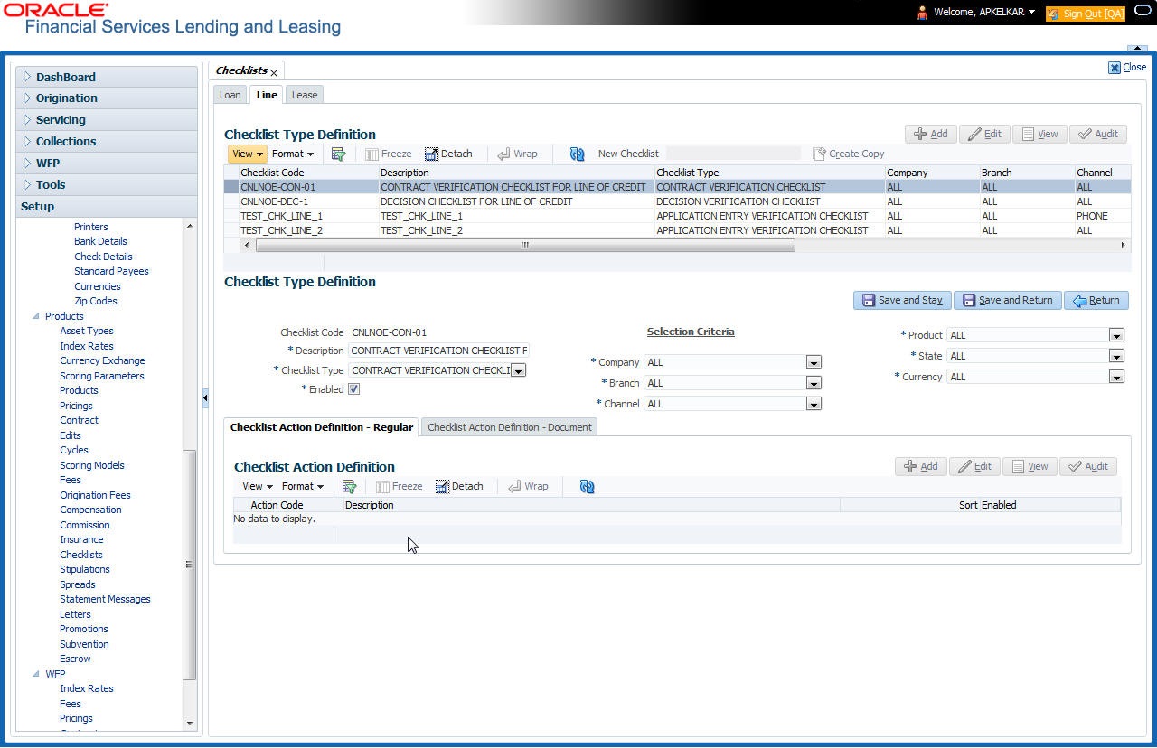

You can either define new Checklist Type Definition details or specify a new code in the New Checklist field and click Create Copy to create a copy of selected checklist type definition with details.
  1. On the Oracle Financial Services Lending and Leasing home screen, click Setup > Setup > Administration > User > Products > Checklists > Line.
  2. In the Checklist Type Definition section, perform any of the Basic Operations mentioned in Navigation chapter.
  3. A brief description of the fields is given below:
    Field:
    Do this:
    Checklist Code
    Specify the checklist code that identifies checklist being defined.
    Description
    Specify the description for the checklist.
    Checklist Type
    Select the checklist type from the drop-down list, to define where the specific checklist will be available in the system.
    Company
    Select the portfolio company associated with the checklist from the drop-down list. This may be ALL or a specific company.
    Branch
    Select the portfolio branch associated with the checklist from the drop-down list. This may be ALL or a specific branch. This must be ALL if in the Company field you selected ALL).
    Channel
    Select the channel from the drop-down list, This can be ALL or a spe­cific channel.
    Product
    Select the product associated with the checklist from the drop-down list. This may be ALL or a specific product. The available values come from a validated list based on the selected Billing Cycle setup and the Product setup.
    State
    Select the state associated with the checklist type from the drop-down list. This may be ALL or a specific state.
    IMPORTANT: By selecting which edits type to use, the system searches for a best match using the following attributes:
    1 Company
    2 Branch
    3 Product
    4 State
    Hence, Oracle Financial Services Software recommends creating one version of each checklist type where ALL is the value in these fields.
    Currency
    Select the currency associated with the checklist from the drop-down list. This may be ALL or a specific currency.
    Enabled
    Check this box to enable the checklist.
  4. Perform any of the Basic Actions mentioned in Navigation chapter.
Checklist actions are steps (a set of one or more tasks) related to the checklist you are creating. They are loaded on the Checklist Action Definition section.
  1. In the Checklist Action Definition - Regular section, perform any of the Basic Operations mentioned in Navigation chapter
Field:
Do this:
Action Code
Specify the action code for the checklist.
Description
Specify the description for the action type.
Sort
Specify the sort order to define the placement of the action type on the Checklist sub screen.
Enabled
Check this box to include this action in the checklist.

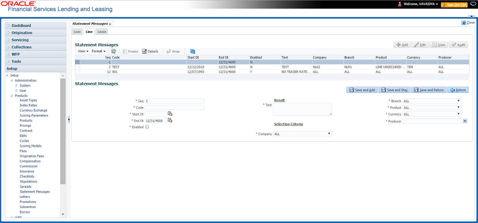

4.9 Statement Messages
The Messages screen allows you to set up messages that appear on account statements sent to customers. You can set up statement messages for different products. When the system generates a statement for an account, all statement messages matching the selection criteria are included in the statement file for that account.
The system inserts the message in the Text field into the statement file produced during the nightly batch job for the appropriate consumers.
A record of an account’s statement history, including the messages included in the statement, appears on the Statement’s screen on the Customer Service screen.
To set up the Messages
  1. On the Oracle Financial Services Lending and Leasing home screen, click Setup > Setup > Administration > User > Products > Statement Messages > Line.
  2. In the Statement Messages section, perform any of the Basic Operations mentioned in Navigation chapter.
Field:
Do this:
Seq
Specify the sort sequence of how the statement message should be printed.
Code
Specify the message code identifying the statement message.
Start Dt
Specify the first date the statement message is available. You can even select the date from the adjoining Calendar icon.
End Dt
Specify the last date the statement message is available. You can even select the date from the adjoining Calendar icon.
Enabled
Check this box to enable the message.
Result section
Text
Specify the text of the statement message.
Company
Select the company for the statement message from the drop-down list. This may be ALL or a specific company.
Branch
Select the branch within the company for the statement message from the drop-down list. This may be ALL or a specific branch. This must be ALL if in the Company field you selected ALL.
Product
Select the product for which this statement message will be used from the drop-down list. This may be ALL or a specific product.
Currency
Select the currency for the statement message from the drop-down list. This may be ALL or a specific currency.
Producer
Select the producer for the statement message from the drop-down list. This may be ALL or a specific producer. The available values come from a validated field based on the Pro Group and Pro Type.
IMPORTANT: By selecting which message to use, the system searches for a best match using the following attributes:
1. Company
2. Branch
3. Product
4. Producer
5. Currency
Hence, Oracle Financial Services Software recommends creating one version of each edit type where ALL is the value in these fields.

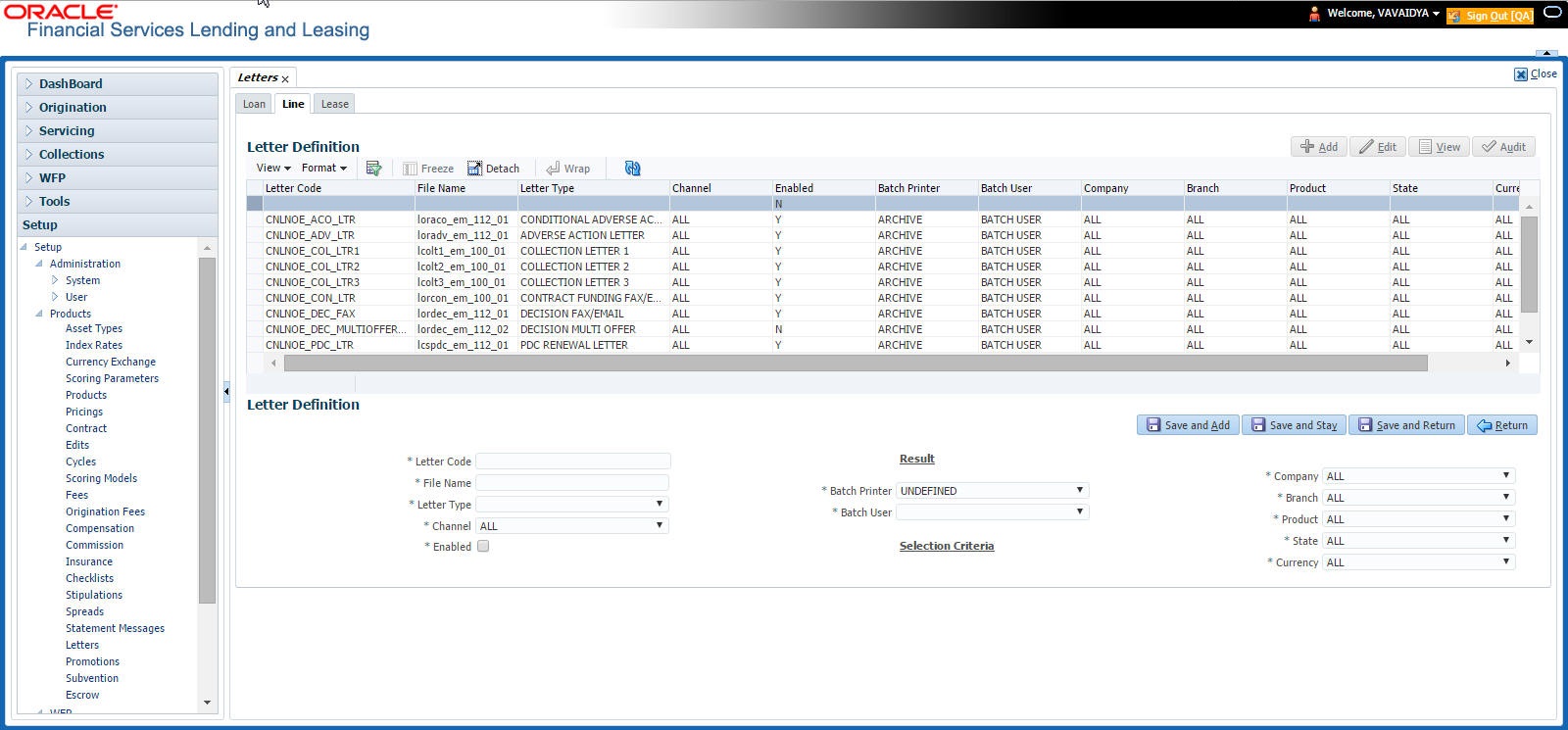

4.10 Letters
The Letters screen allows you to define letters that the system automatically generates when the application or the account for a products meets certain conditions, or “trigger events.” Each letter has its own trigger event. For example, you can configure the system to automatically send a welcome letter when an application becomes an account or send a collection letters when an account becomes delinquent.
The system supports the following types of letters:
Type of letter:
Definition:
ACCOUNT STATEMENT
Generated when account is to receive a billing statement (this time is defined in contract setup). Letter is sent to customer.
ADVERSE Action letter
Generated in nightly batch jobs for applications that were declined. This letter is sent to the consumer to indicate the reasons why the application was declined.
CONDITIONAL ADVERSE
ACTION LET­TER
declined. This letter is sent to the consumer to indicate the reasons why the application was declined. This letter also indicates steps that the consumer may take to gain approval of the application.
COLLECTION LETTER 1
Generated when an account becomes delinquent. This is the first dunning letter sent to the customer.
COLLECTION LETTER 2
Generated when an account remains in delinquency for an extended period. This is the second dunning letter sent to the customer.
COLLECTION LETTER 3
Generated when an account remains in delinquency for an extended period, even after having received previous notices. This is the final dunning letter sent to the customer.
CONTRACT FUNDING fax/email
Generated when an application is APPROVED: FUNDED or condi­tioned: funded. This letter is sent to the producer.
DECISION FAX/EMAIL
Generated when an application is APPROVED, conditioned, or rejected. This letter is sent to the consumer or producer, depend­ing on whether the product is a direct or in-direct loan.
PAID IN FULL LETTER
Generated in nightly batch jobs when the account pays off. This letter is sent to the customer.
PAYOFF QUOTE LET­TER
Generated when a payoff quote is created for an account. This letter is sent to the customer.
WELCOME LET­TER
Generated when an application is APPROVED: FUNDED. This letter is sent to the consumer.
STATEMENT PAST MATURITY Generated when an accounts are matured but unpaid.
This letter is sent to the account holders as a reminder to make their payments.
When the system generates letters, it searches the Letters screen for letter definitions that meet the following criteria:
Exact matches for each field are given a higher weight than matches to ALL.
The returned rows are then given a descending rank based on the weighted values and the hierarchical position of these fields:
  1. Company
  2. Branch
  3. Product
  4. State
  5. Currency
On the ranked rows, the first row is returned as the best match.
To set up the Letters
  1. On the Oracle Financial Services Lending and Leasing home screen, click Setup > Setup > Administration > User > Products > Letters > Line.
  2. In the Letter Definition section, perform any of the Basic Operations mentioned in Navigation chapter.
Field:
Do this:
Letter Code
Specify the code for the letter.
File Name
Specify the file name of the Oracle report used to generate the letter. The file should be named <File Name>.rep on your server.
Letter Type
Select the type of letter you want to generate from the drop-down list.
Channel
Select the application source (channel) for the letter from the drop-down list. This may be ALL or a specific channel.
Enabled
Check this box to enable this letter definition.
Result section
Batch Printer
Select the batch printer being used to generate the letter from the drop-down list.
Batch User
Select the user who will submit this letter from the drop-down list. This will normally be set to BATCH.
Company
Select the portfolio company for which this letter will be used from the drop-down list. This may be ALL or a specific company.
Branch
Select the portfolio branch for which this letter will be used from the drop-down list. This may be ALL or a specific branch. This must be ALL if in the Company field you selected ALL).
Product
Select the product for which this letter will be used from the drop-down list. This may be ALL or a specific product.
State
Select the state for which this letter will be used from the drop-down list. This may be ALL or a specific state.
Currency
Select the currency for which this letter will be used from the drop-down list. This may be ALL or a specific currency.
