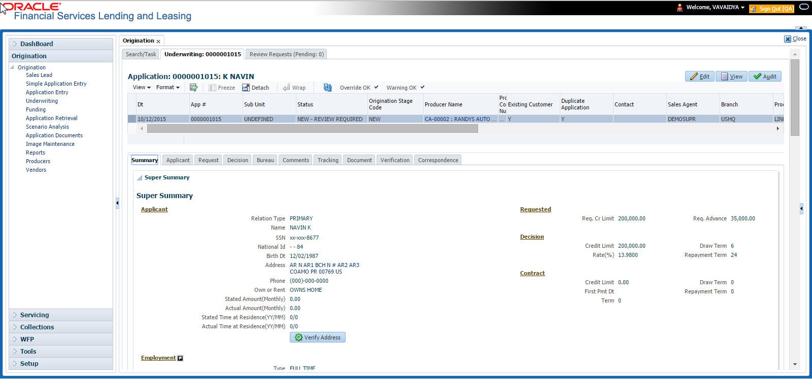

The summary screen provides a unified view of the application details without navigating to the respective screens/ sub-tabs.
Using this screen, you can view the following details in their respective sections:
To view the Super Summary
The Super Summary tab provides a snapshot of all relevant details in a single screen and contains details of Applicant, Employment, Ratios, Bureau, Requested financials, Decision updates, Contract updates and Primary Collateral details. You need not have to navigate to each of these tabs for specific information on the application. Also clicking on the hyperlinks of Address, Employment, Ratios, and Trade-In helps you to directly navigate to respective tab(s),
During the Underwriting and Funding stages, 'verified' button is displayed just below the address and employment details for each of the applicants. This would be enabled only when the Verified by and Verified Dt in the respective tabs are blank. You can verify the details from the Super Summary tab. Clicking on Verified will do the following:
You need not navigate to Address and Employment tab for verifying applicant details.

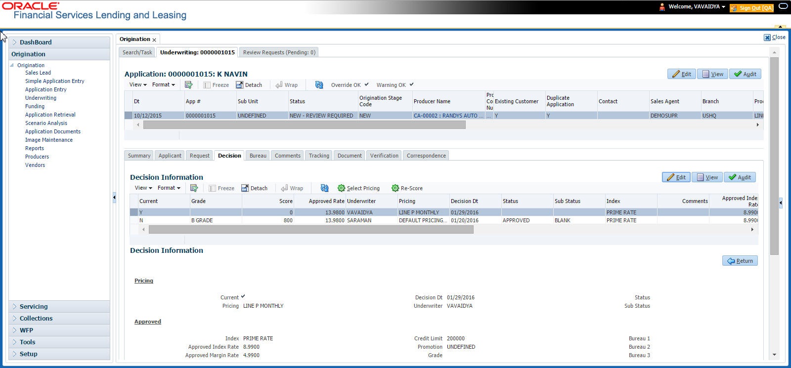

Decision details will be displayed when application has Origination Stage as “Review, Decisioned, Contract or Funded”. In case an application is Rehashed, only Decision information will be displayed and Contract information will not be displayed. Contract details will be displayed when application has Origination Stage as “Contract or Funded”.
The system displays the collateral details maintained in the collateral tab on click of navigation button under the headings Primary Collateral and Secondary Collateral. Collateral details for Unsecured loan also will be displayed if they are maintained.
All the trade-in details, if any, maintained in the application would be displayed on click of Navigation button.

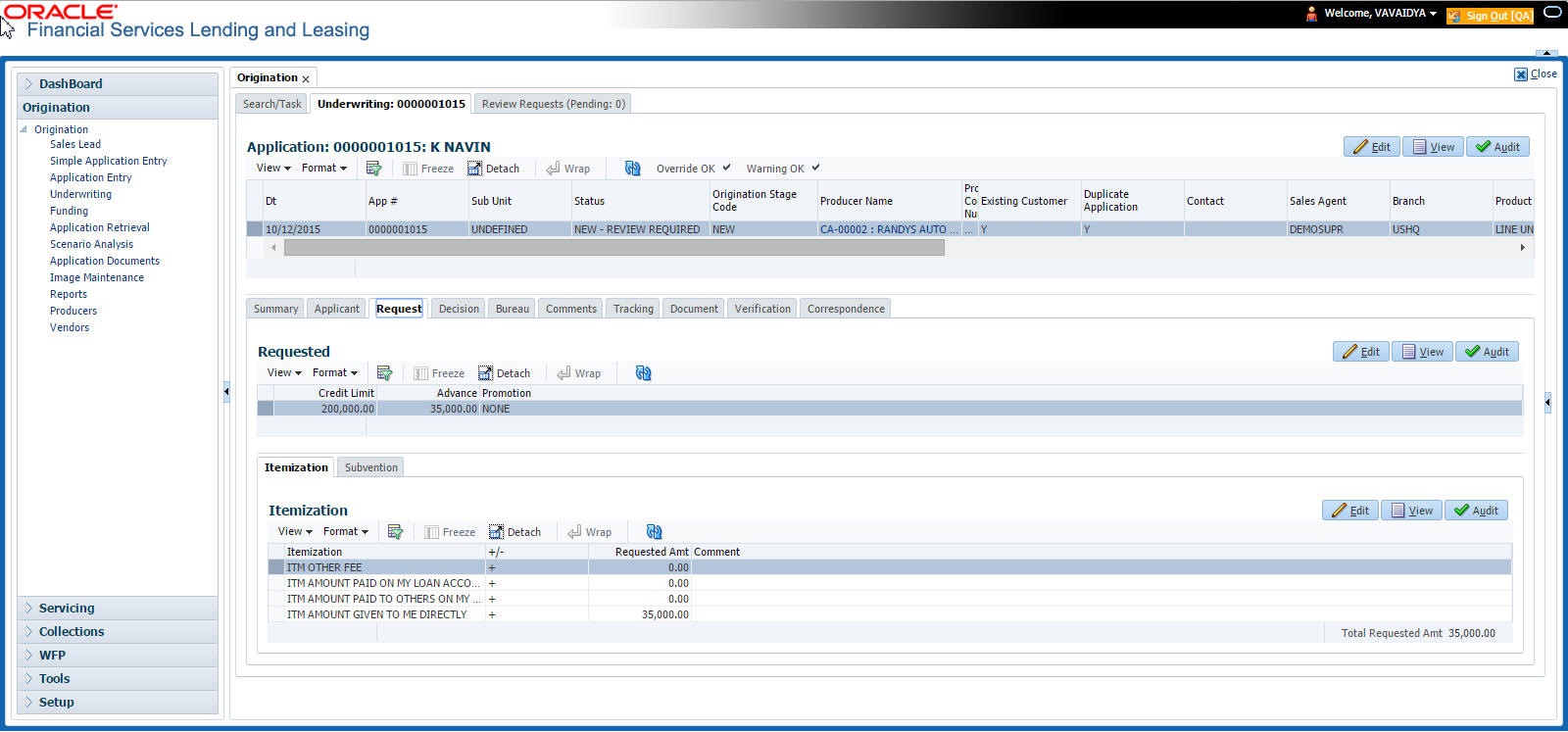

In the Request tab you can define the required Line of credit parameters. By default, system calculates for monthly repayment term basis. The payment frequency can be changed only in the Underwriting tab during decisioning.
To complete Request section:
A brief description of the fields are given below:
Field |
Do this |
Credit Limit |
Specify the value of the credit limit. |
Advance |
Specify the value of advance amount paid. |
Promotion |
Select the promotion type from the drop-down list. |
The Itemizations sub tab enables you to add or verify any itemized amounts associated with the application. The list of itemizations is determined by the product you select in the master screen during the application entry process. The Itemizations sub screen displays an itemization record of the amount financed, such as the cash price, cash down payment, trade-in, unpaid cash price balance and so on. Information that was entered on the Itemization sub screen during the application entry process will appear in the Requested Amt column. Information that you enter as an underwriter in the Approved Amt column will appear in the Itemizations sub tab on the Underwriting screen.
Application request details need to be essentially entered in the itemization sub tab for pre-screening to be successful. Else, the system displays error and application would not proceed to the next level in work flow. The details of down payment, trade-in, insurance, fees etc. and the total sale price are recorded under itemization.
To add or view itemizations
A brief description of the fields is given below:
Field: |
Do this: |
Itemization |
View the itemization. |
View whether the itemized amount is added or subtracted from the Line of credit amount. |
Requested Amt |
Specify the requested amount. |
Comment |
Specify a comment. |

If the application was initially approved automatically, the system displays its recommendations on the Decision tab’s Approved section.
If the application was initially rejected automatically, the system displays its reasons on the Decision link’s Stipulation sub tab.
If you choose to approve or reject the Line of credit manually, you must manually select the pricing (rule) set by the portfolio company for a specific product. The system validates this pricing against the information in the System Recommendation sections. The information in the Requested section comes from the application entry process and can be edited.
To verify the application decision data
Field: |
Do this: |
Pricing section |
Current |
Check this box to indicate that this is the current decision. |
Pricing |
View the pricing. |
Decision Dt |
View the decision date. |
Underwriter |
View the underwriter id. |
Status |
View the application status. |
Sub Status |
View the application sub-status. |
Approved section |
Index |
Specify the index type. |
Approved Index Rate |
Specify the approved index rate. |
Approved Margin Rate |
Specify the approved margin rate. |
Approved Rate |
Specify the approved rate. |
Maturity Index |
Select the approved maturity index. |
Maturity Margin Rt |
Specify the maturity margin rate. |
Credit Limit |
Specify the credit limit. |
Promotion |
Select the promotion. |
Grade |
Select the credit grade. |
Score |
Specify the credit score. |
Draw Term |
Specify the draw term. |
Repmt Term |
Specify the repayment term. |
Bureau 1 |
Specify the Bureau 1. |
Bureau 2 |
Specify the Bureau 2. |
Bureau 3 |
Specify the Bureau 3. |
Comments |
Specify comments, if any. |
The system determines the best pricing match of all enabled Line of credit pricing strings in the Setup menu and displays the results in the Pricing and Approved sections.
A 'Re-Score' button is available next to 'Calculate'. Whenever any sensitive Financial or Collateral information is amended in the Application, OFSLL displays a warning message 'Scoring sensitive information is changed. Re-score the application'. You need to click on Re-Score to re-validate the grade and pricing accordingly.
The display of the warning message to Re-score the application can be controlled using the respective System parameter. If the defined System Parameter is flagged 'Y', only then the message is displayed.
If you are underwriting a Line of credit, record the following information on the Decision tab:
