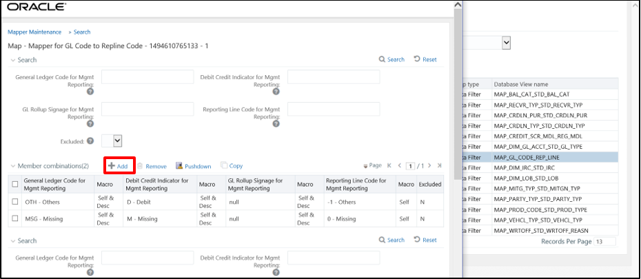

2.     For illustration, we have selected Mapper for GL Code to Repline Code. Click Mapper Maintenance.
Figure 161: Mapper Maintenance Page
This illustration shows the example of Mapper for GL Code to Repline Code in the map maintenance.
3.     OFS REG REP APME maps OTH and MSG out-of-the-box for this mapper. The remaining mappings can be maintained by the user according to user-specific values.
Figure 162:Mapper Maintenance Search Result Page
This illustration shows the Map Maintenance Search result details.

2.     Select an existing Map. For illustration, Mapper for GL Code to Repline Code value is selected. Select the Mapper Maintenance icon.
3.     The Mapper Maintenance window opens (in this illustration, the Map - Mapper for GL Code to Repline Code window opens). To conduct One to One or Many to One mapping, in the Member Combinations section, click Add.
Figure 165: Map Maintenance Add page
This illustration shows the map maintenance addition details.
4.     The Add Mappings pop-up window opens. In this illustration:

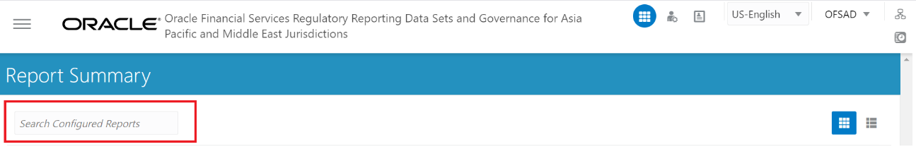

·        Viewing Report Summary
·        Viewing Schedule Summary

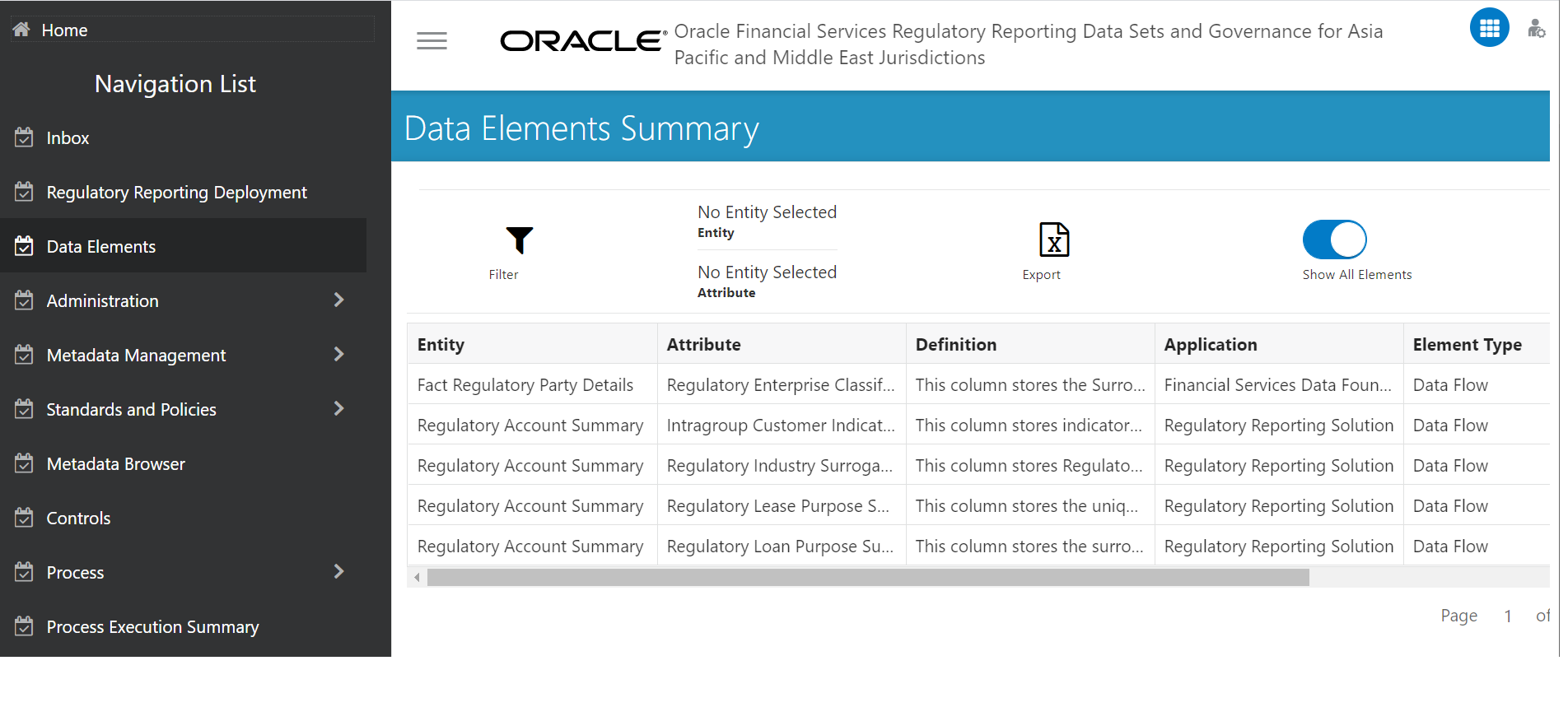

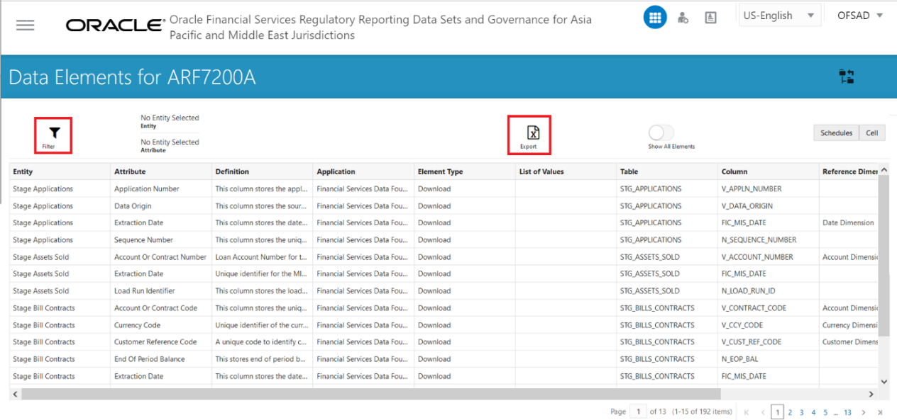

·        Viewing Data Elements
·        Viewing Data Elements Summary

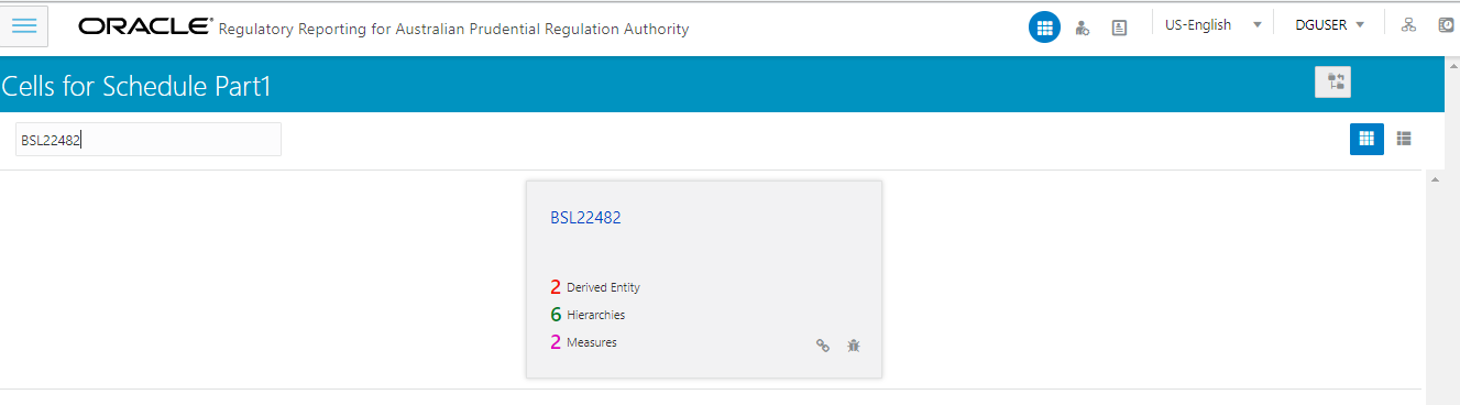

·        Viewing Cell Summary

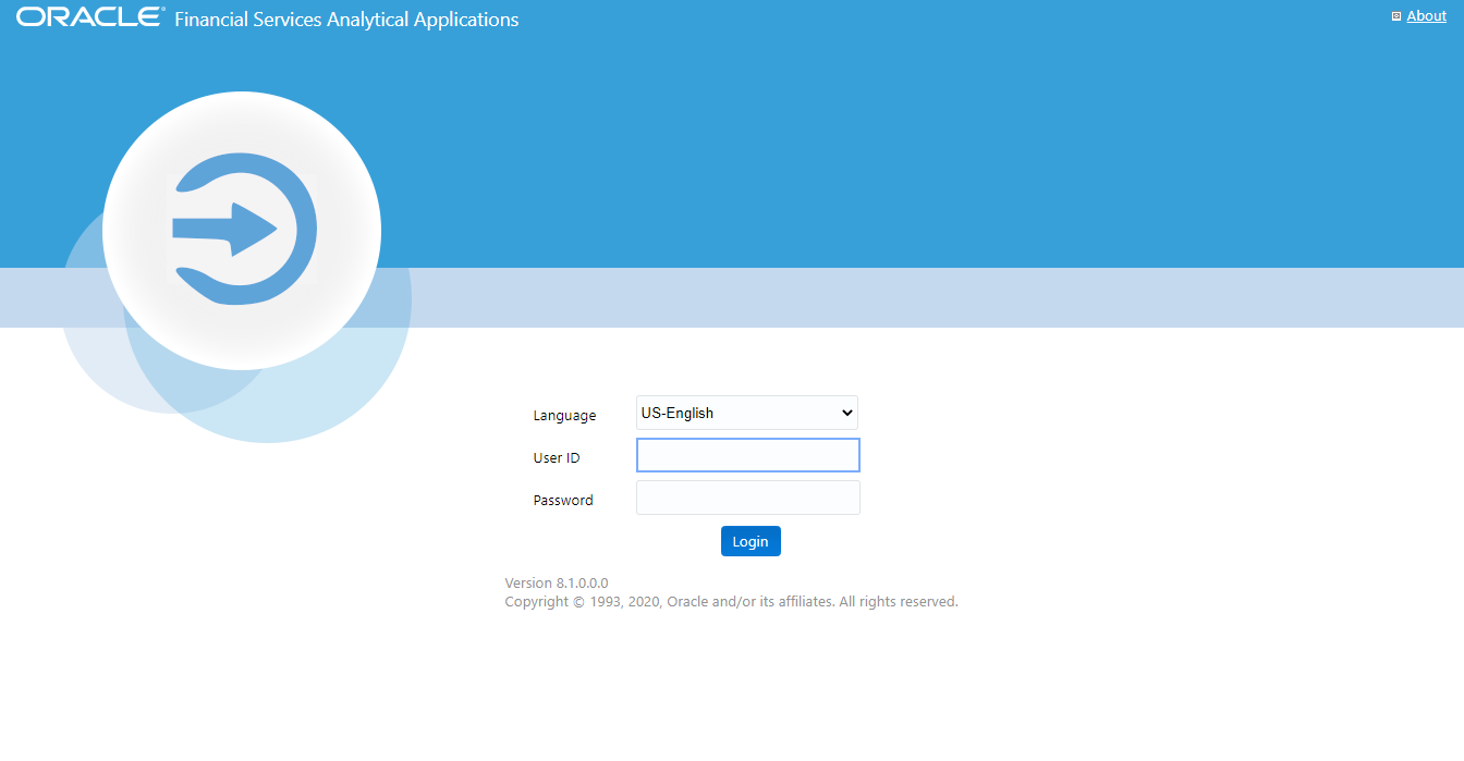

1.     Enter the OFSAAI URL in your browser. The OFSAAI login page is displayed.
Figure 169: OFSAAI Log In
This illustration shows the login page for the OFSAAI application. You can select the required Language, enter valid User ID and Password, and then click Login.
2.     Select the desired language from the Language drop-down list.
3.     Enter your User ID and Password. When you log into OFSAAI, the OFSAA Applications page is displayed.
Figure 170: OFSAA Applications Screen

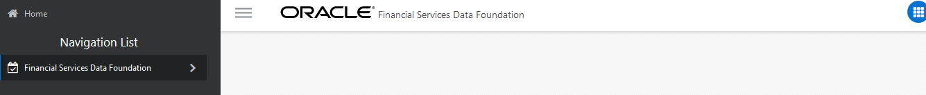

4.     Select the Financial Services Data Foundation. The FSDF landing page is displayed.
Figure 171: Financial Services Data Foundation Landing Page
This illustration shows the FSDF Landing page from OFSAAI applications login.

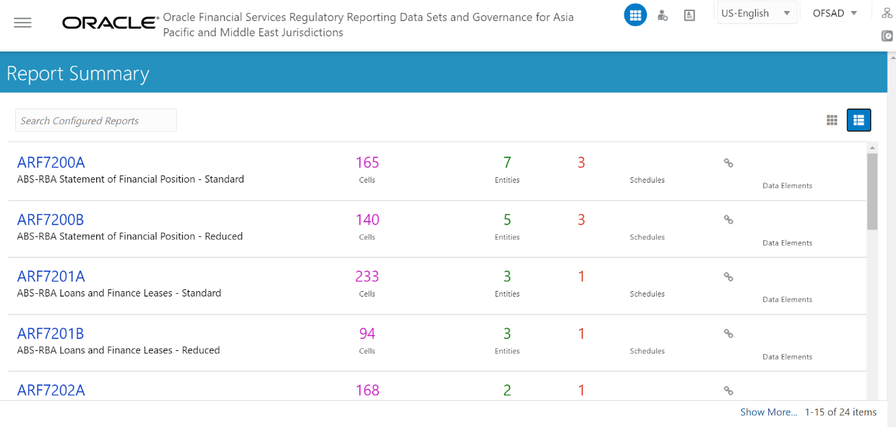

The Report Summary data comes pre-seeded based on the applications that are installed. The Report Summary enables you to view all the configured reports for the jurisdiction.
After logging into the OFS REG REP APME UI, navigate to Metadata Management and select Reports to view Reports Summary window.
Figure 173: Report Summary Screen
This illustration shows the Report Summary screen navigation steps. Starting from the OFS REG REP APME User Interface, then navigate to Metadata management, and then select Reports to view Report Summary.
NOTE:
You can view the summary of all the configured reports in the Tile view Tile View Icon or List viewList View Icon.
The Search Bar helps you to find the required information from the database. You can enter the nearest matching keywords to search and filter the results by entering information on the search box. You can search for a Report using either the name or description.
Figure 174: Report Summary Search Bar
This illustration shows the Report Summary Search bar which allows you to search for a specific report.

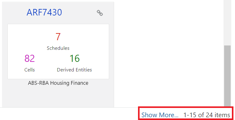

The Paging option at the bottom right corner allows you to see more reports than the ones currently displayed on the window.
Figure 175: Report Summary Paging Option
This illustration shows the Report Summary Paging option which displays the current items displayed and the total number of items in the Report Summary.

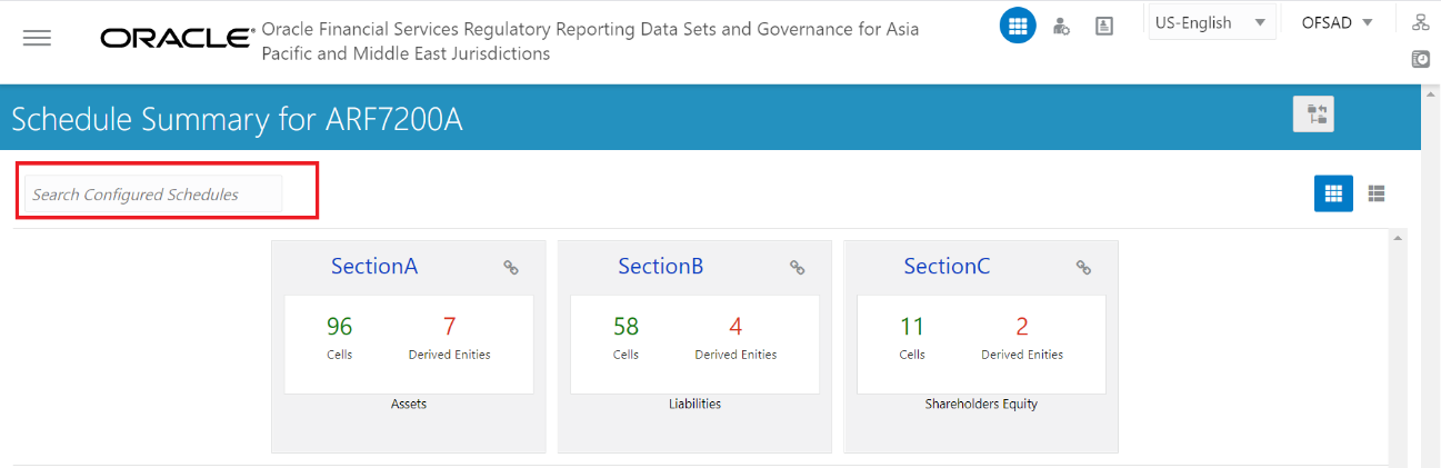

The Schedule Summary window provides the component schedules for the corresponding report. Select the Report Code in the Report Summary window to navigate to the Schedule Summary window (as shown in Figure 66).
For example, the Schedule Summary window for the ARF7200A report is displayed as follows.
Figure 179: Schedule Summary Screen
This illustration shows the Schedule Summary screen navigation steps. Starting from the OFS REG REP APME User Interface, then navigate to Metadata management, then select Reports to view Report Summary and then select the Report Code to view the schedule summary.
NOTE:
The Search Bar helps you to find the required information from the database. You can enter the nearest matching keywords to search and filter the results by entering information on the search box. You can search for a Schedule using either the name or description.
The Paging option (Figure 96) at the bottom right corner allows you to see more reports than the ones currently displayed on the window.
NOTE:
Select the Return Icon icon on the top right corner to return to the Report Summary window.
Schedule Information
Each tile or list on the Schedule Summary window corresponds to one schedule under the report. For each schedule, you can view the schedule code and the description, the number of configured non-derived cells for the schedule and count of utilized derived entities.
For example, the Schedule Page3 tile is displayed as follows. Select the Schedule Code to navigate to the Cell Information window.

1.     Click the chain icon on the right top corner to display the data elements for the respective item. The data elements view option is available at the report schedule and cell level.
Figure 182: Data Elements Screen
This illustration shows the Data Elements screen with Filter and Export options.
2.     Select Filter to apply filters on the selected data. The filter pane allows filtering data on specific columns.
Figure 183: Filters
This illustration shows the Filters window with filter details such as Entity, Attribute, Application, Element Type, Table and column and click Apply Filter.
3.     Select Apply Filter to apply the required filters on the selected data.
4.     Select Clear Filter to clear the applied filters and display all records for the component.
5.     Select Export to CSV to export the data displayed in the window.

1.     After logging into OFS REG REP APME UI, from the main navigation menu select Data Elements to view all the Data Elements.
Figure 184: Data Elements Summary
By default, the page displays all the data elements.
Figure 185: Selection Panel
This illustration shows the Selection Panel information such as Entity and Attribute.
2.     Click a row and the selection panel displays the selected entity and attribute.
Figure 186: Selected Entity
This illustration shows the Selected Entity information such as Entity and Attribute. It displays the Reports , Schedule and Cell that can be viewed.
The tabs on the right can be used to view reports, schedules, and cells as shown in Figure 102, which are utilized for the selected data element.

The Cell Summary window provides the non-derived cells or MDRMs configured as a part of the solution for the corresponding schedule under a report. Select the Schedule Code in the Schedule Summary window to navigate to the Cell Summary window (as shown in Figure 104).
For example, the Cells for Schedule Part7 summary window under the CRSA report is displayed as follows.
Figure 188: Cell Summary Window
This illustration shows the cell information for the schedule.

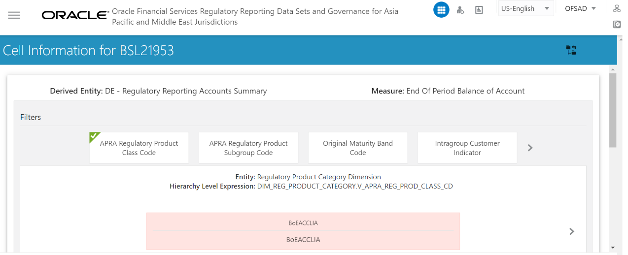

Cell Information
Each tile or list on the Cell Summary window corresponds to one cell or MDRM under the schedule. For each cell, you can view the MDRM name, count of utilized derived entities, count of utilized OFSAA hierarchies, and measures for that cell.
For example, the cell CRSAR040C180 tile is displayed as follows. Select the cell or MDRM Code to navigate to the Cell Information window.
Figure 189: Cell Information
This illustration shows the cell details derived from a report.
The Cell Information window is displayed as follows.

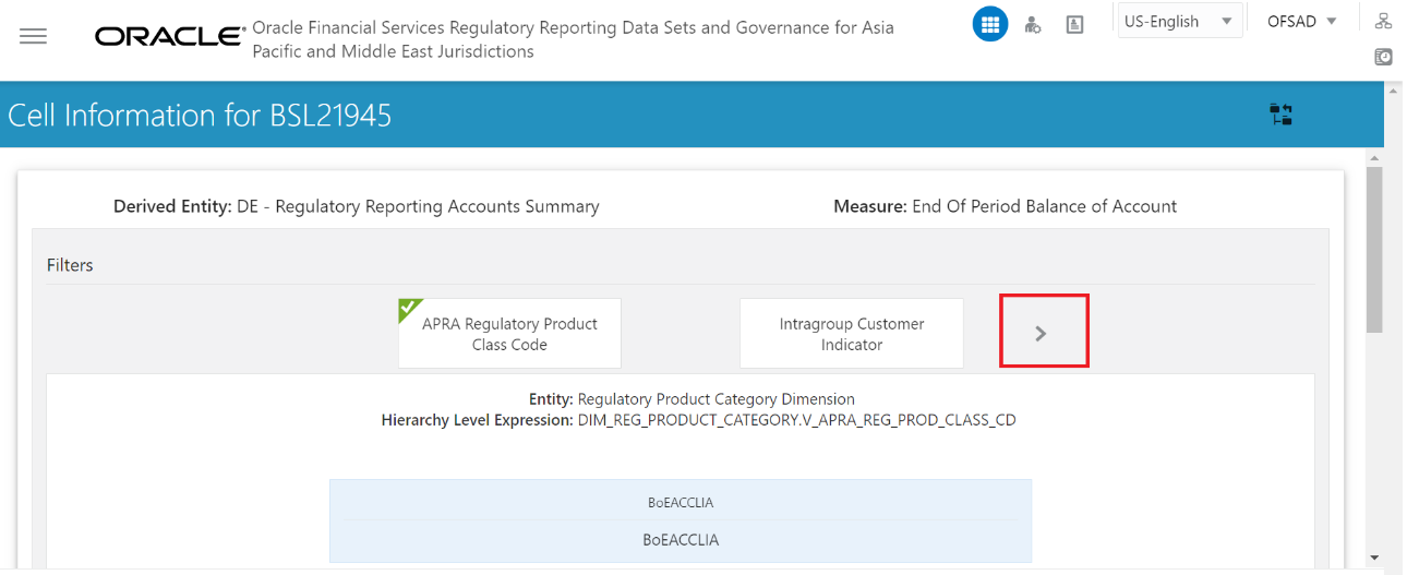

Figure 190: Cell Information Window
This illustration shows the cell information such as Derived Entities, Measure, Filters, regulatory Report Cell Identifier and Cell Dimension.
Each section in the Cell Information window displays the relevant OFSAA Metadata and filters used for the cell.
Derived Entity
This displays the name of the OFSAA Materialized View or View that contributes to the Cell.
Measure
This displays the name of the OFSAA Measure that is reported for the particular Cell.
Filters
The Filter conditions are as follows:
1.     All filters that are applied to the cell are displayed under the filter section. It displays all the applied filters as their OFSAA description.
2.     On selection, the filter is marked by a Filter icon sign on the top left corner of the selected filter.
3.     The section that follows displays the entity or table on top of which the filter is based and the OFSAA Level Description for the selected filter.
4.     All filter values that apply to the particular MDRM are available as a ribbon. Each filter value is in a separate box.
For example, in the previous case for MDRM CRSAR040C180, the applied filters are Consolidation Code and Reporting Line Code. Currently, the Consolidation Code filter is selected and the required filter values for the same are 100.

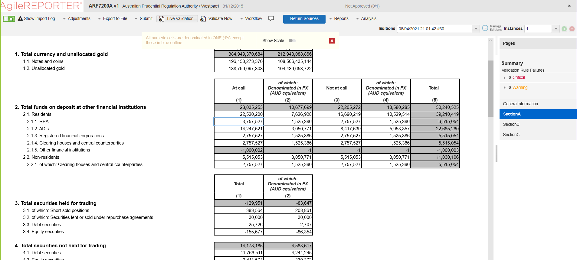

The adjustments feature is a new enhancement to adjust the differing values of the report systems. The Adjustments Derived Entity derives its values from the Adjustments Fact table (FCT_REG_REPORT_ADJUSTMENTS) that specifies the adjustment value and the seeded table (DIM_REG_REPORT_CELL) that specifies the Cell ID or MDRM Code and the Report Code to which the MDRM belongs to. This ensures that there can be direct adjustments made to MDRM(s) such that the values from both the derived entities are traceable and efficiently reported.
Implementing the Adjustment Feature
To implement the Adjustment feature, identify the Cell ID for the report and the line item where adjustment must be implemented.
For example: ARF7200A v1 Report
070 Line Item: On balance sheet exposures subject to credit risk
Cell ID: BSAO27429
NOTE:
The Adjustment feature works only for fixed table cells (Open Y cells are not supported).
The report currently displays a Total value = 3.758 M for the identified cell as shown in the following figure.
Figure 200: Adjustment Feature
 This illustration shows the Adjustment Feature page for the identified cell in AgileREPORTER.
Now, the requirement is to adjust this amount to 2.758M+1 M=3.758 M

For example, with the page instance, identify the Cell ID for the report and the line item where adjustment must be implemented.
2.12 ADIs Line Item: On balance sheet exposures subject to credit risk
Cell ID: BSAO27429
NOTE:
The drill-down will always show the total page instance value but not the individual page instance.
The report currently displays a Total value = 3,757,527 for the identified cell.

Dimensional and measure combination stored within the derived entity is mapped to cells within the report. This mapping is maintained within the Dimensional mapping template. Decision Process within AgileREPORTER reads the derived entities and dimension mapping information to derive the data for reporting. Derived entities are created based on measures, hierarchies, and datasets.

AgileREPORTER: Submission
The AgileREPORTER is a web-based regulatory reporting tool provided by Lombard Risk. It provides necessary features to address e-filing workflow, validation and submission process and supports reports (called as forms or returns) for various jurisdictions. AgileREPORTER provides a reliable and efficient infrastructure to compile, generate, and submit regulatory reports.
