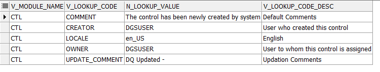

1. For control creation, the FSI_DGS_CONFIGURATION table has to be seeded first.
NOTE:
In the N_LOOKUP_VALUE column, you can modify the values in the CREATOR and the OWNER fields.

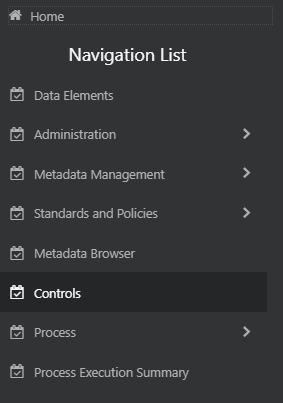

To view the controls, follow these steps:
1. From Regulatory Reporting Data Sets and Governance for Asia Pacific and Middle East Jurisdictions window navigate to Controls.
Figure 113: Controls
2. The Control summary window is displayed. After you execute the batch DGS_CONTROL_BATCH, the Control summary window displays the stage tables for which the controls are defined. It also displays the assessments and open issues if any.

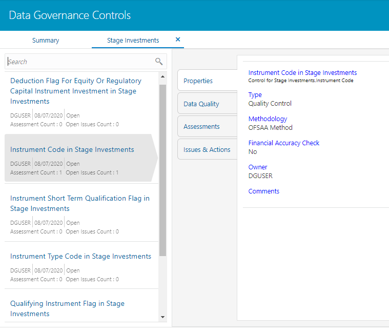

5. Click Properties, to view the control properties.
Figure 116: Data Governance Controls – Properties
The Control Information is displayed:
— Name: Name of the control
— Type: Type of Control – Quality Control
— Methodology: Method used – OFSAA Method
— Financial Accuracy Check: Yes or No
— Owner: Name of the Owner
— Comments: Add comments if any

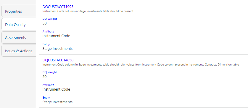

6. Click Data Quality, to view the Data Quality information on which the control is created.
Figure 117: Data Governance Controls – Data Quality
The Data Quality information is displayed:
— Data Quality Name: Name of the Data Quality contributing to the control.
— Data Quality Weight: Weight of the Data Quality contributing to the control. In case there is one Data Quality the number is 100. If there is more than one the number is divided to make it 100.
— Attribute: Name of the attribute on the entity column where the Data Quality is defined.
— Entity: Name of the stage table name.

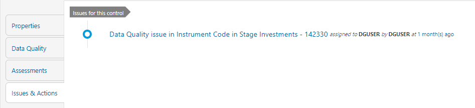

8. Click Issues & Actions to view the system-generated issues created for control.
Figure 119: Data Governance Controls – Issues & Actions

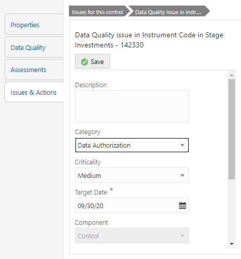

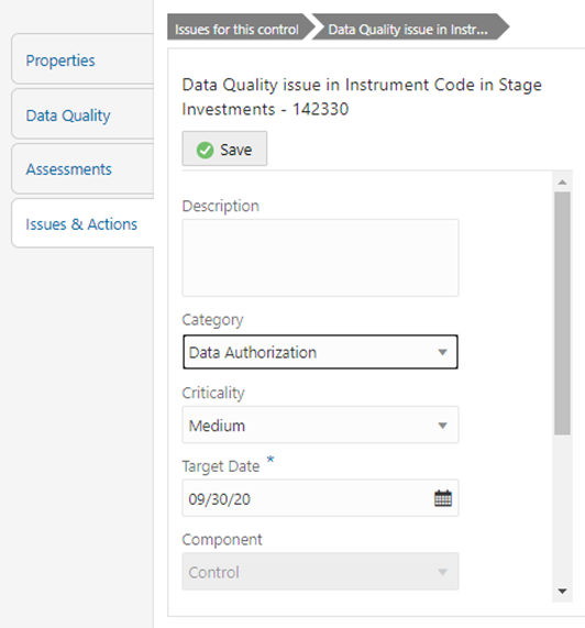

To edit an issue, follow these steps:
2. Select a stage table and then click
View Controls to view the details.

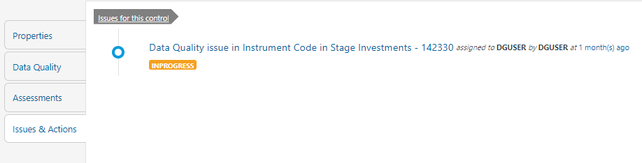

3. Click Issues & Actions.
The system-generated issues for this control are displayed.
Figure 120: Data Governance Controls – Issues & Actions

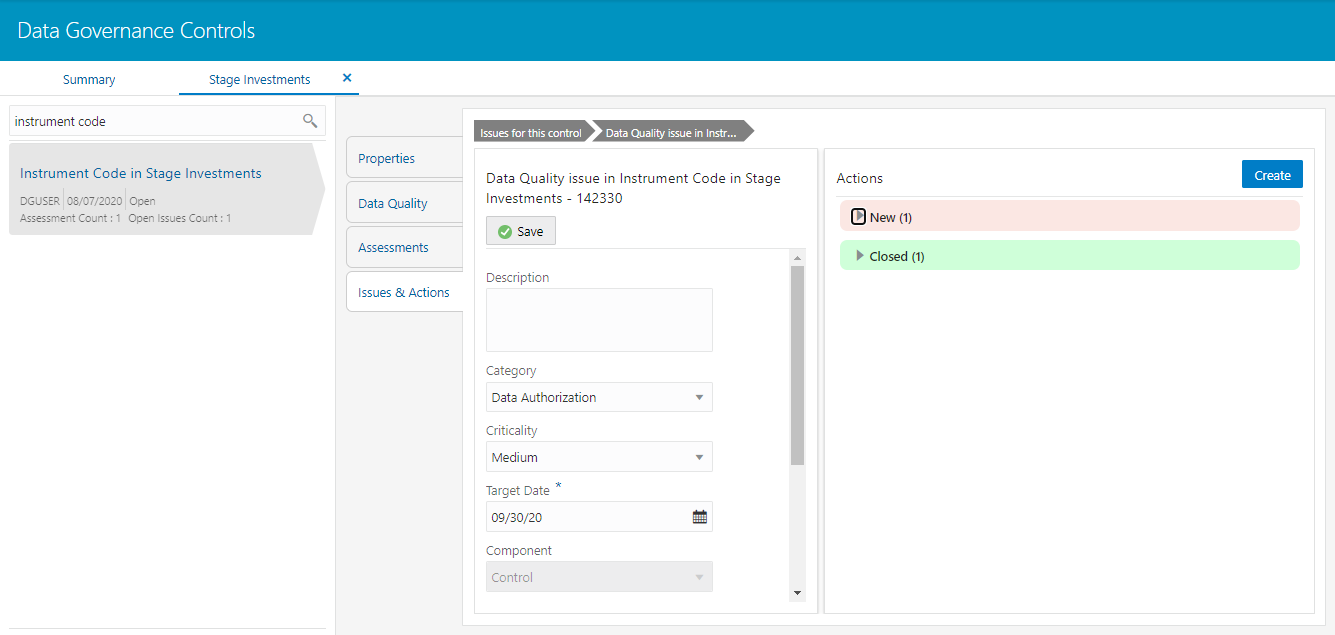

4. Click the required issue to edit.
Figure 121: Data Governance Controls – Issues & Actions
5. You are allowed to modify the following parameters or fields:
a. Description: Enter the description.
b. Category: Select the Category from the drop-down list.
c. Criticality: Select the criticality of the issue.
d. Target Date: Select the target date from the Date Calendar.
e. Component: Component module for which the issue is created.
f. Owner: Name of the Owner.
g. Status: Status of the Issue.
h. Comments: Add comments if any for the issue.
6. After editing the required fields, click Save.

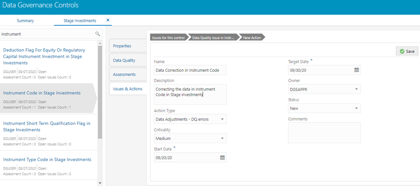

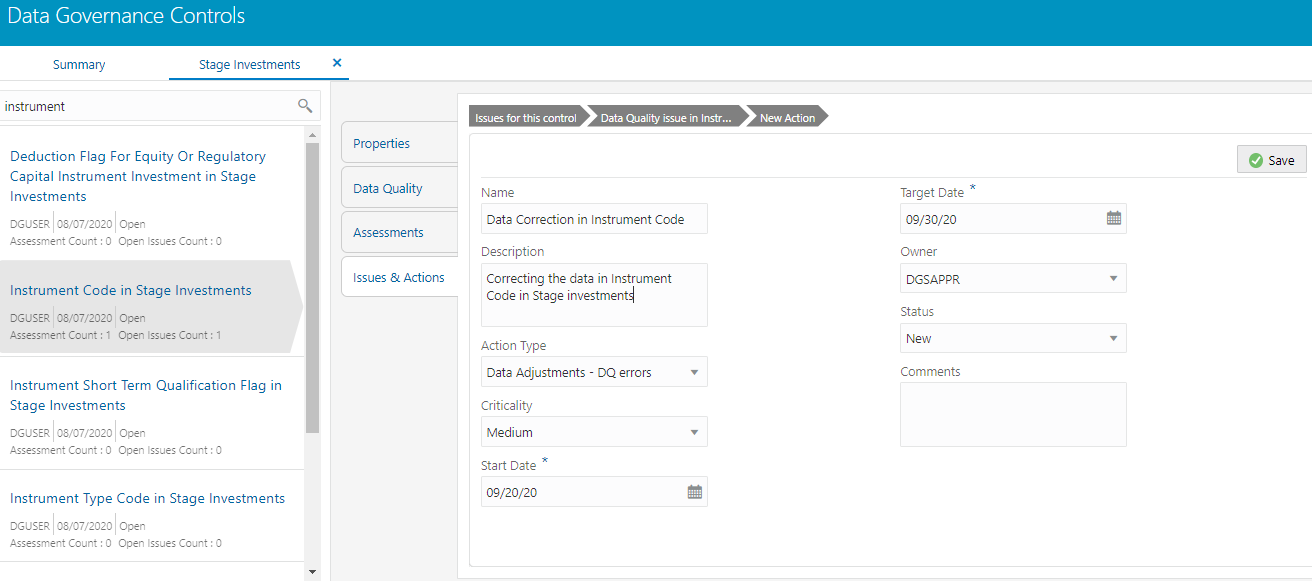

To create a new action for the system generated Issue, follow these steps:
3. Click Issues & Actions. The Issus for this control is displayed with the details.
Figure 122: Data Governance Controls – Issues & Actions
4. Click the required issue.

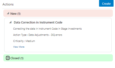

The Actions pane is displayed.
Figure 123: Data Governance Controls – Actions
5. To create an action, in the Actions section click Create.
Figure 124: Data Governance Controls – New Actions
6. Enter the Name and Description.
7. Select the Action Type from the drop-down list:
— Data Adjustments - Data Quality errors
— Data Adjustments - Others
— Data Adjustments - Regulatory Reporting
— Reconciliation Adjustments
— Others
8. Select the Criticality:
— High
— Medium
— Low
9. Choose the Start Date and Target Date from the Calendar
. Action Start and Target Date must be within the Issue Target Date.
10. Select the action Owner name from the drop-down list.
11. Select the Status from the drop-down list:
a. New
b. InProgress
c. Closed
12. Enter Comments if any and click Save. A confirmation message is displayed Action saved successfully. This creates an action for a particular issue.
NOTE:
Based on the Action Type, the Data Adjustment Details Page is displayed during the Data Adjustments Process for Data Quality errors or any other errors.
13. When a new action is created it is listed under the Actions Section under the New status of the Issue. In the Status field, the issue can be closed when it is resolved, it is then moved to Closed status.
Figure 125: Data Governance Controls – New Actions
1. From Financial Services Data Governance for North America Regulatory Reporting window navigate to Controls.
3. Click Issues & Actions. The system-generated issues for this control are displayed.
Figure 126: Data Governance Controls – Issues & Actions
Figure 127: Data Governance Controls – Issues & Actions
5. Enter the Description.
6. Select the Category from the drop-down list:
§ Data Authorization
§ Data Privacy
§ Data Security
§ Data Accuracy
§ Data Availability
7. Select the Criticality:
§ High
§ Medium
§ Low
8. Choose the Target Date from the Calendar
9. Enter Comments if any.
10. Select a file or drag and drop a file to Attach a document.
11. Click Save. A confirmation message is displayed: Issue is saved successfully. This creates an issue for the particular action.

1. From the Financial Services Data Governance Studio window, navigate to Controls.

4. Click the required issue. The Actions pane is displayed.
Figure 129: Data Governance Controls – Actions
Figure 130: Data Governance Controls – New Actions
a. Data Adjustments - DQ errors
b. Data Adjustments - Others
c. Data Adjustments - Regulatory Reporting
d. Reconciliation Adjustments
e. Others
a. High
b. Medium
c. Low
. Action start and target date must be within the Issue target date.
a. New
b. InProgress
c. Closed
12. Enter Comments if any and click Save. A confirmation message is displayed: Action saved successfully. This creates an action for the particular issue.
