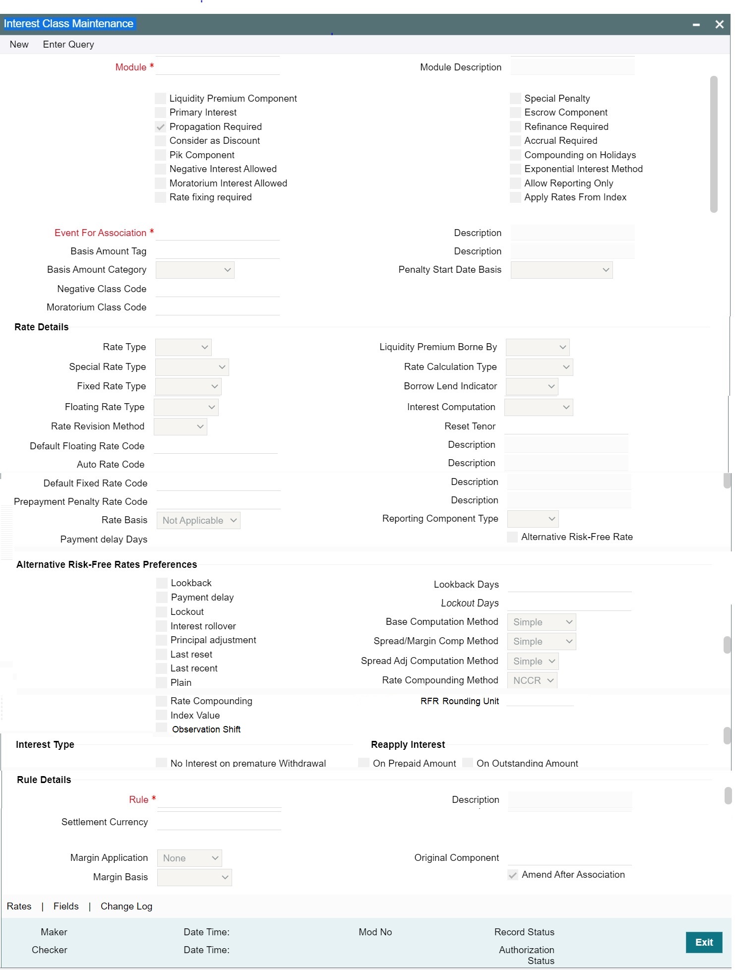

You can define the attributes of an interest class, in the ‘Interest Class Maintenance’ screen.
You can access this screen by typing LFDINTCL in the field at the top right corner of the Application tool bar and clicking the adjoining arrow button.
Before defining the attributes of an interest class, you should assign the class a unique identifier, called the Class Code and briefly describe the class. A description would help you easily identify a class.

Basis Amount Tag
The basis on which an interest is calculated is referred to as the Basis Amount. When building an interest class, you have to specify the tag associated with the Basis Amount.
The attributes defined for an interest class, will default to all products with which you associate the class. When maintaining interest details for a product, you can change these default attributes. Contracts maintained under a product will acquire the attributes defined for the loan product.

Specifying rate fixing
Select this check box to indicate whether the rate fixing is applicable for a particular component. This is applicable for Bilateral Loans and Loan Syndications.
Moratorium Interest Allowed and Moratorium Class code
In case 'Moratorium Interest Allowed' check box is selected for main interest component, then on save the system creates 'Moratorium Class Code' ('Class Code' field value is appended with _M).

Specifying the amount category
Indicate the category of the component on which the interest has to be applied. The available options are:
If Normal is selected, the balance on which interest has to be applied will be the Expected Balance (assuming that all the scheduled repayments, defined for the contract, are made on time). An example of this category is the application of interest on the principal of a loan.
If Overdue is selected, the balance on which interest has to be applied will be the amount that is outstanding, based on the repayment schedule defined for the contract. An example of this category is the application of penalty interest, on the principal or interest, when a repayment has not been made as per the schedule.
If Outstanding is selected with the amount category as principal, the interest is calculated on the balance of the total principal outstanding amount.
If Overdue OS is selected with the amount category as principal, the interest is calculated on the principal overdue outstanding.
If SCH-Overdue is selected, then the basis amount refers to amount outstanding on a particular schedule due date. If you select the ‘Basis Amount Tag’ as ‘SCH_AMT_OS’, then system defaults the ‘Amount Category’ as ‘Sch-Overdue’ and disables this field.
Select the applicable category using the drop-down list. The system defaults to Normal.

Specifying Rate Details
Rate Type
The interests paid on contracts can be at a Fixed Rate, or on the basis of a Floating Rate. If you indicate that interests should be calculated on the basis of a Floating Rate, you must specify the ‘Periodic’ Floating Rate Type.
For all contracts maintained under products, associated with a class, the interest will be by default calculated using the specified Rate type.

Choosing Rate Basis
The following options are available for rate basis.
Choosing the Default Floating Rate Code
Interest payable on contracts would be calculated at specific rates. When building an interest component, you have to specify the rate at which the interest should be computed. When associating a rate code (that you have maintained in the Rate Codes Maintenance screen) with the interest component that you are building, the rates corresponding to the code is used to compute interest.
The details defined for an interest class defaults to all products with which the class is associated. When maintaining interest details for a product, you can change this default information. Contracts maintained under a product acquires the interest details defined for the contract product. However, you can define unique interest details specific to a contract.
When maintaining a contract, you can choose to waive the rate code altogether or amend the properties of the code to suit the security.
If you allow amendment of a rate code, you can specify if you would like to allow rate code amendment after the association event.
You can also allow the amendment of the rate value (corresponding to a rate code).

Payment Delay Days
You can define the payment delay days in this screen and the same is defaulted to product and contract screens.
Payment delay days is used to capture the number of days between 'Schedule Due Date' and 'Pay By Date'.

Alternative Risk-Free Rate
If you select this check box then only you can select options available in the 'Alternative Risk-Free Rates Preferences' screen. Select this check box to define floating rate as ‘Alternative Risk Free Rate’.
Note
Look back and Look out methods can be selected in combination. None of the other meth­ods are selected in combination.

Lockout Days
This option is applicable only for Lockout method.
Base Rate/Spread Margin/ Spread Adj Computation Method
You can select 'Simple' or 'Compound'. For compounding, interest calculation on week days go with compounded P, while for week ends its on simple P.
Rate Compounding Method
You can either select 'NCCR' or 'CCR' methods. The rate compounding happens in these two methods for RFR rate types (Normal and Index value rate types).
CCR - Cumulative Compounded Rate calculates the compounded rate at the end of the interest period and it is applied to the whole period. It allows calculation of interest for the whole period using a single compounded rate.
NCCR - Non Cumulative Compounded Rate is derived from Cumulative Compounded Rate i.e., The Cumulative Compounded Rate is first un-annualized. And then the cumulating is removed by subtracting previous day rate with current day & the same is annualized.. This generates a daily compounded rate which allows the calculation of a daily interest amount. For OL module, this value gets defaulted to 'Bilateral Loans - Product Definition' (OLDPRMNT) from 'Interest Class Maintenance' screen. If required, you can define rate compounding method at component level in these product screens. Similarly, rate compounding method is defaulted to 'Loan and Commitment -Contract Input' (OLDTRONL) screen based on the selection at the product level. If required, you can define rate compounding method at component level in these contract screens.
For LB module, this value gets defaulted to Loan Syndication -Borrower Product Definition' (LBDPRMNT) screen from 'Interest Class Maintenance' screen and then it is defaulted from product to tranche (LBDTRONL). If required, you can redefine the rate compounding method at tranche level. For drawdown contract (LBDDDONL), rate compounding method is defaulted from tranche (LBDTRONL). If tranche level rate compounding method is not defined then, it is defaulted from product screen. If required, you can redefine the rate compounding method at drawdown contract level as well.
RFR Rounding Unit
This option is applicable only for Rate compounding method. This contains the Risk Free Rate rounding unit as agreed with the borrower. The CCR is rounded with this parameter.
