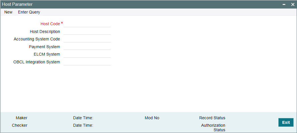

You can configure the accounting system using host code in the ‘Host Parameter’ screen.
To invoke this screen, type ‘PIDHSTMT’ in the field at the top right corner of the application toolbar and click the adjoining arrow button.
Specify the following details
Host Code
Specify the host code.
Host Description
Specify the brief description for the host.
Accounting System Code
Specify the accounting system code.
Payment System
Specify the payment system.
ELCM System
Specify the ELCM system.
OBCL Integration System
Specify the external system. For example, OLINTSYS

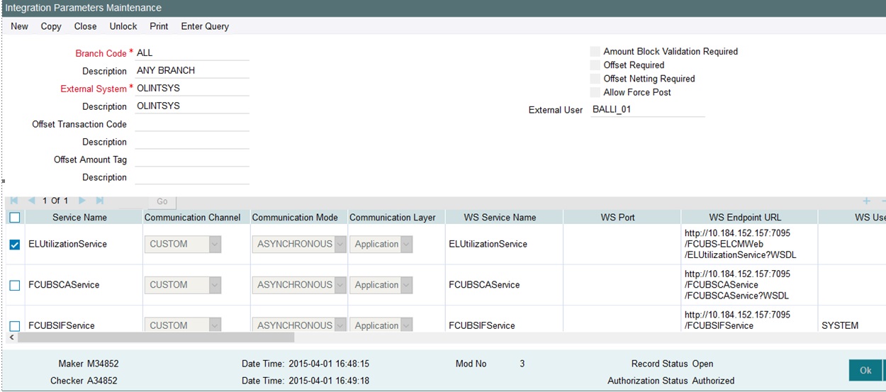

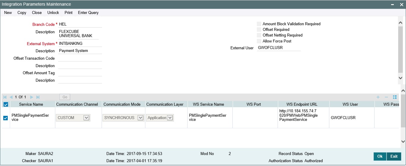

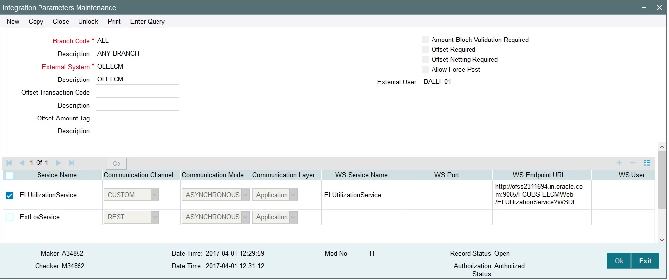

You have to maintain integration parameters for ‘External LOV’ and ‘ELCM/Payment/OL Utilization’. This maintenance must be done for all branches. This maintenance is done through ‘Integration Parameters Maintenance’ screen.
To invoke this screen, type ‘IFDINPRM’ in the field at the top right corner of the application toolbar and click the adjoining arrow button.
Example of Integration Parameter Maintenance screen for Payments
Example of Integration Parameter Maintenance screen for ELCM
Example of Integration Parameter Maintenance screen for OBCL
You can specify the following fields in this screen:
Branch Code
Select the branch code for which the parameters are to be maintained from the adjoining option list.
Description
A brief description of the branch code is displayed.
External System
Select the external system for which the parameters are to be maintained, from the adjoining option list.
Description
A brief description of the external system is displayed.
Offset Transaction Code
Select a transaction code for the offset entry from the adjoining option list. The adjoining option list displays all valid transaction codes available in the system. You can select the appropriate one
Offset Amount Tag
Select an amount tag for the offset entry from the adjoining option list. The adjoining option list displays all valid amount tag available in the system. You can select the appropriate one
Amount Block Validation
Select this check box to validate the amount block. If the amount block reference number is sent with the transaction details then the accounting will be invoked after the release of amount block.
Offset Required
Select this check box if an offset entry is required. If this check box is selected, then ISB GL will be resolved based on branch, currency, function id and external system. If the check box is not selected, then it is expected that external system sends the balanced entry
Offset Netting Required
Select this check box if offset netting entry is required. If this check box is selected, then the consolidated entries will be built. Offset amount tag is picked from the maintenances. If this check box is not selected, then individual entries are built.
Allow Force Post
Select this check box to suppress all the overrides after posting transactions.

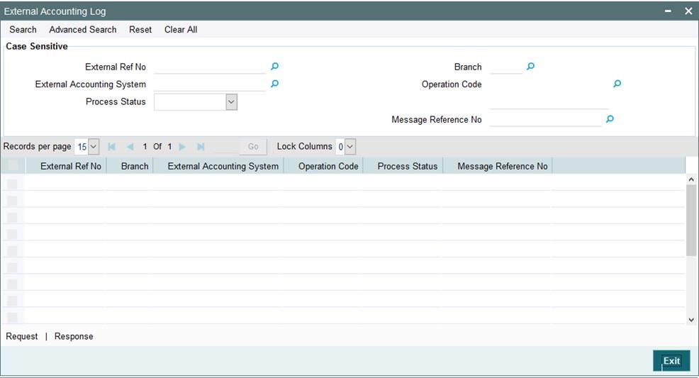

'External Accounting Log' screen contains OL/LS transaction details with External Accounting System linkage.
To invoke this screen, type ‘OLSEACLG’ in the field at the top right corner of the application toolbar and click the adjoining arrow button.
In this screen, you can view the request sent from OL and LS module and view the response (received for the request sent) from the External Accounting System.
You can search records based on the following parameters:
Click ‘Search’ button with or without entering any of the above search parameters. All records matching the search criteria are displayed. To view a particular record double-click on the desired record displayed in the list of records. The details pertaining to each record is displayed.

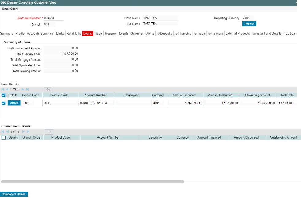

Using 360 Degree Customer View, you can query customer limits, account statements, view settlement balances contracts, view assets and liability balances, view loans, commitments and syndication contract details of the customer. You can also view summary of loans, commitments and syndication contract details of the customer. The 360 degree customer view facilitates easy and total view of the customer details and reduces customer service complexities.
FCUBS pulls the required data from OBCL by using the below operation code.
The ‘Summary’ tab displays the OBCL loan contracts of the selected customers along with the details.
In an FCUBS – OBCL integrated environment, click ‘Loans’ tab in ‘360 degree customer view’ screen to view the details for OBCL contracts in Loan details/Commitment and Syndicate Loan Details block for the selected customer.
The loans details are classified as follows:
Under each of the loan details, the system displays the following:

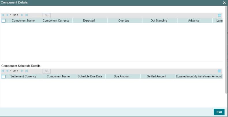

You can view details about the components linked to an account in the ‘Component Details’ screen. You can invoke this screen by clicking the ‘Component Details’ button in the ‘360 Degree Retail Customer View’ screen.
You can view the following component details:
Here you can view the following:

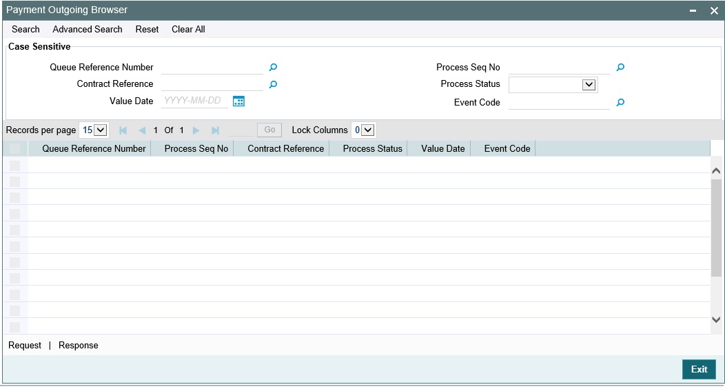

You can view Oracle Lending and Loan Syndication contracts with payment integration in ‘Payment Outgoing Browser’ screen.
To invoke this screen, type ‘OLSPMTBR’ in the field at the top right corner of the application toolbar and click the adjoining arrow button.
In this screen, you can view the request sent from Oracle Lending/Loan Syndication module and view the response (received for the request sent) from the Payments module.

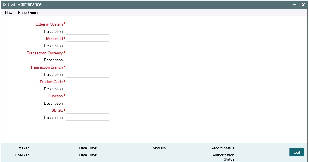

You can invoke the ‘ISB GL Maintenance’ screen by typing ‘OLDISBGL’ in the field at the top right corner of the application tool bar and by clicking the adjoining arrow button.
You can specify the following field information in this screen. A brief description of each value updated in the fields appearing in this screen, is displayed by the system.
External System
Select the external system from the adjoining option list.
Module ID
Select a valid module code from the adjoining option list.
Transaction Currency
Select a valid currency code from the adjoining option list.
Transaction Branch
Select a valid transaction branch code from the adjoining option list
Product Code
Select a valid product code from the adjoining option list.
Function ID
Select a valid function ID from the adjoining option list.
ISB GL
Select a leaf General Ledger from the adjoining option list.

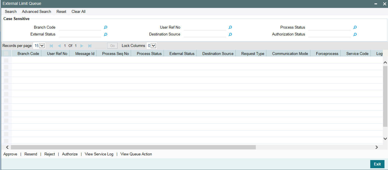

External Limit Summary screen contains details of the Oracle Lending and Loan Syndication transactions with ELCM linkage.
You can approve, resend, reject, and authorize the Oracle Lending and Loan Syndication transactions using this screen.
To invoke this screen, type OLSEXLMT’ in the field at the top right corner of the application toolbar and click the adjoining arrow button.

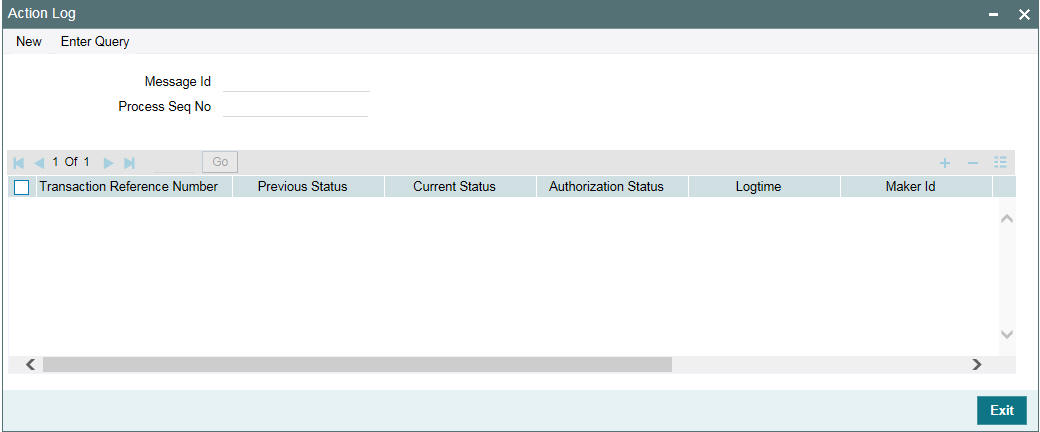

The action log screen displays the details of actions performed in the External Limit Queue screen.
To invoke this screen, type ‘OLDQAHIS’ in the field at the top right corner of the application toolbar and click the adjoining arrow button.
This screen displays the action log of the following fields along with ‘Message Id’ and ‘Process Sequence Number’.

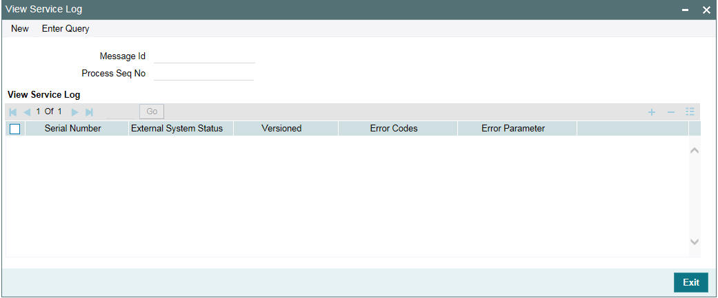

You can view service log using ‘View Service Log’ screen. To invoke this screen, type ‘OLDSRLOG’ in the field at the top right corner of the application toolbar and click the adjoining arrow button.
