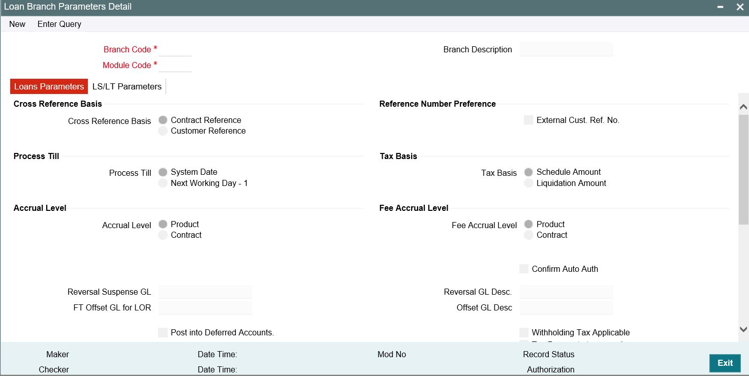

11.2 Specifying Branch Parameters
A set of rules that govern the loans that you disburse in a particular branch (of your branch) are defined through the Branch Parameters screen.
You can invoke the ‘Branch Parameters Detail’ screen by typing ‘OLDBRPRM’ in the field at the top right corner of the Application tool bar and clicking the adjoining arrow button.

11.2.3 Setting the Accrual Level
To recall, at the time of creating a product, you specify
A loan inherits the accrual frequency defined for the product associated with it.
Since the accounts (the accrual account and the income account) are defined for a product, the accrual entries for all loans involving the product are passed to the same accounts.
These entries can be passed in two ways:
The idea of generating a single entry for all loans involving a product is to reduce the number of entries and thus, the processing time. The details of entries passed for each loan is available in the Accrual Control Journal, a report that should be generated after the accruals have been made.
Whether interest accrual entries are passed as a single consolidated entry for a product, or as an individual entry for each loan, should be specified for a branch.
Note
This specification is applicable only for automatic periodic accrual entries. When there is an accrual necessitated by a payment or a change in the terms of a loan, the entries will be for the specific loan affected by the change.

Accrual entries level - Product
If you indicate that the automatic interest accrual process should pass accrual entries at the product level, a single accrual entry will be passed for all the loans.
Accrual entries level - Contract
If you indicate that the automatic interest accrual process should pass accrual entries at the contract level, three accounting entries for the loans are passed, for each loan.
11.2.4 Auto Authorization
Select this check box to indicate authorization can be carried out automatically.

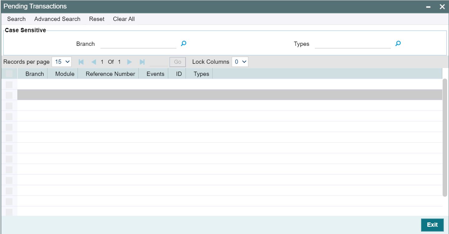

11.13 Viewing Unauthorized Transactions
You can view the details of all the unauthorized transactions from the ‘Pending Transactions’ screen. You can invoke the ‘Pending Transactions’ screen by typing ‘OLSVWPNT’ in the field at the top right corner of the Application tool bar and clicking the adjoining arrow button.
Through this screen you can view details of the following:
You can search for the records based on one or more of the following parameters:
Once you have specified the search criteria, click ‘Search’ button. The system displays the following details of the unauthorized transactions that match the filter criteria.
Types
