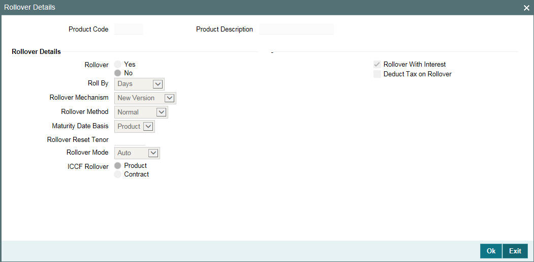

You can capture the following details in this screen:
Rollover Mechanism
When defining rollover mechanism for a loans syndication product, the default rollover mechanism will be ‘Spawn Contract’ and you cannot change this specification. This creates a new drawdown on rollover.
Rollover Method
You have to indicate the method that you want to employ to rollover the drawdown. You can choose from the following methods:
Note
Normal rollover method is NOT support for Loans Syndication (LB) module.
Each of the above rollover types are discussed later in this chapter.
Maturity Date Basis
Select the basis on which the system should arrive at the maturity date of the rolled over drawdown. The options available are:
Rollover Mode
You can select the rollover mode from the drop-down list. The options are:
Forward Processing has been explained in the chapter ‘Reference Information for Loan Syndication’. Refer to the same for more information
Cont Booking for Addl Amt Only
You have to select this option if you wan to rollover the drawdown for an additional amount only.
Apply Charge on Rollover Amt
You can select this option to indicate that charge is to be applied on drawdowns that are rolled over. However, for charge to be applicable on a rolled over drawdown:
Liquidate Overdue Schedules
You can select this option to liquidate the overdue schedules, if any, before rolling over a drawdown.
Repickup Interest Rate on Rollover
You may select this option to instruct the system to reapply the interest rate for the rolled over drawdown. If not selected, the interest rate applied for the original drawdown is used for the new drawdown as well.

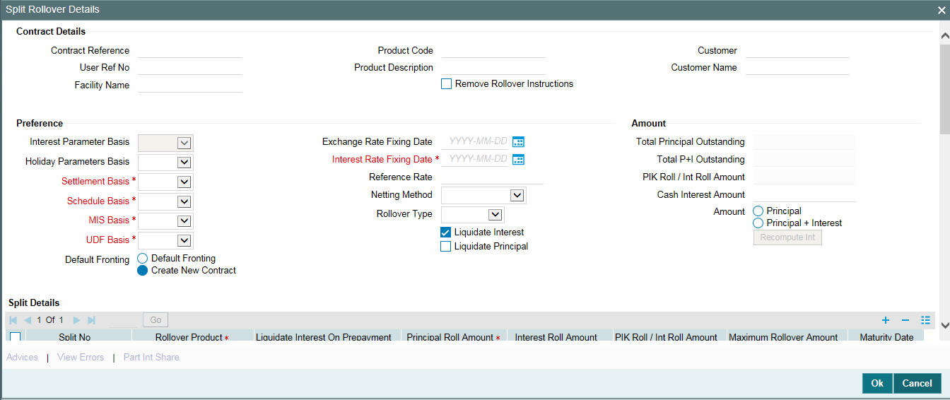

You can capture instructions for a split rollover in the ‘Split Rollover Details’ screen (LBCSPROL). Click ‘Spilt Roll’ in the ‘Drawdown Contract Online’ screen to invoke this screen.
Note
This section explains only those features that are specific to split rollover. The preference applicable for ‘Normal’ rollover will be applicable for ‘Split’ rollover as well.
When you indicate the rollover method as ‘Split’, the system creates multiple drawdowns out of the original drawdown. For each rolled over contract, the system generates a split number. After specifying the details for the first split drawdown, click ‘Add Row’ button to specify details for the next drawdown.
The defaulted value for the Netting Option will be No Netting.
Default Fronting
Indicate if the fronting detail has to be defaulted for the increase in amount during rollover / reprice. You can select one of the following options:
On selecting the ‘Default Fronting’ option, the front/fund details is defaulted from the past disbursement events to the new disbursement event (VAMB/VAMI) which is triggered as part of rollover processing. System generates BPMT to the borrower for the fronted/funded investor’s portion and proceed with the rollover processing.
On selecting the ‘Create New Contract’ option, the system defaults the front/fund details to the new disbursement event (VAMB/VAMI) which is triggered as part of rollover processing, but the BPMT event will not be fired based on these default options. Further, as part of Rollover processing, one of the child contracts are created for the increase in amount without any default fronting/funding options. In the split child contract, for the increased amount, the funding details are captured and borrower payment is also sent from this child contract.
You have to specify the following split in the ‘Split Details’ section of the screen:
Amount
You have to specify the amount that can be rolled over to create each of the multiple drawdowns as part of the rollover split. This amount depends on the ‘Rollover Amount Type’ you select. The rollover amount type can be any one of the following:
Note
In the case of split renewals, the system apportions the interest amount against each split contract in the same ratio as the principal split break up.
PIK Roll amount gets updated if the PIK Rollover with capitalization is checked for parent contract.
Liquidate Principal
By default, the system selects this box. It instructs the system to liquidate the outstanding principal on rollover. If you have chosen the automatic mode of liquidation, the system does not allow you to deselect this check box. You can amend this option only if the following criteria are met:
Liquidate Interest
By default, this check box is deselected. If you select this box, the system liquidates the outstanding interest on rollover. If you have chosen the automatic mode of liquidation, the system automatically selects this box and does not allow you to change this preference. You can amend it only if:
The following example illustrates the manner in which the system handles liquidation of interest and principal components when you select/deselect the above options.
Rollover Netting
You have to specify the rollover netting indicating parameter here.
The options are:
The value defaulted is No Netting.
If any of the netting option is selected, then the Liquidate Principal and Liquidate Interest boxes are selected and disabled.
Rollover Product
Oracle Banking Corporate Lending allows you to select a product for the new rolled-over/child contract. The option-list displays the drawdown products defined in the linked tranche (under which the drawdown being rolled over is booked). As mentioned above, if the product you select is a ‘Prime Loan’ product, you have the option to check ‘Liquidate Interest on Prepayment’ box. If checked, whenever your customer makes a prepayment towards the rolled over loan, the system also liquidates the interest on the amount prepaid.
Schedule Basis
You have to specify the basis on which the system should compute the repayment schedules for the rolled over drawdown. The options are:
Interest Parameter Basis
Specify the basis on which the interest components should be applied for the rolled over drawdown. The options are:
MIS Basis
Here, you have to specify whether the MIS details for the rolled over drawdown should default from the product level or applied from the original drawdown.
UDF Basis
In this field, you can indicate whether user-defined fields (UDFs) for the rolled over drawdown must default from the drawdown product or the original drawdown that is being rolled over.
Settlement Basis
In this field, you can indicate the basis on which the system should pick up the settlement details for the rolled over drawdown. The options are:
Holiday Parameter Basis
You have to specify the basis for holiday processing if schedules, value date and maturity date of the rolled over drawdown fall due on holidays. The options are:
PIK Rollover Amount
If the product you have selected has an associated PIK component, then the calculated PIK margin amount for that contract gets displayed here.
Note
Cash Interest Amount
Specify the interest amount to be liquidated for the borrower which should be lesser than or equal to the outstanding interest of parent drawdown.
This field is disabled during Principal+Interest Rollover (P+I) and enabled only for drawdown contracts under prorata non-lead tranches and the propagation value for the drawdown should be ‘Cash’. Maturity Date
You can capture the maturity date of the rolled over drawdown here. If you do not specify the maturity date, the system will arrive at the maturity date based on the ‘Roll By’ value and the ‘Maturity Days’ specified for the drawdown.
If you do not select any options here, system will display the maturity date based on the ‘Maturity Date Basis’ maintained at the product level (in the ‘Rollover Details’ screen).
Maturity Days
You have to specify the number of days that is to be added to the value date of the new split drawdown to arrive at the maturity date of the drawdown.
Roll By
Indicate the tenor basis upon which the maturity days specified for the rolled-over contract is reckoned. The options are:
This value you specify here is used in combination with the value specified for ‘Maturity Days’. For instance, if the ‘Maturity Days’ is ‘90’ and the ‘Roll By’ is ‘Days’, then the system adds 90 days to the rolled over drawdown value date to arrive at the maturity date of the rolled over drawdown.
Note
Consider for Split
Select this check box to specify the split that should be considered for the new contract created for the increase in amount without the default front/fund details.
It is mandatory to select this option for one of the splits if ‘Create new contract’ option is selected.
Note
On selecting the 'Default Fronting' option, the 'Consider for Split' is disabled.

As part of split rollover one drawdown results into multiple drawdowns. After successful creation of new drawdowns, the system displays the reference number of the newly created drawdowns in the ‘Roll Contract Ref No’ field (in the ‘SPLIT ROLLOVER’ screen) of the original parent drawdown.
Note
If the UDF ‘RATE-VARIANCE’ is maintained as a non-zero value for a tranche contract to which the drawdown is linked, dual authorization is required.
For more details, refer the section ‘Authorizing Overrides’ in the chapter titled ‘Loan Syndication Contracts - Part 1’ of this User Manual.
Oracle Banking Corporate Lending allows you to do the rollover of the special amount exceeding the current outstanding amount of the parent contract. During the rollover process, system checks if the sum of the split amount exceeds the outstanding amount of the parent. System initiates a value dated amendment process to increase the principal amount to the extent of the additional amount to be disbursed to the borrower. This value date of the amendment will be the rollover date.

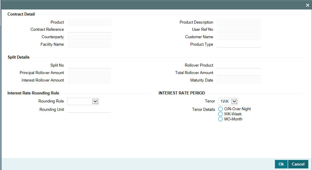

To set the rate setting rules for the Splitrollover, click the ‘Rate Setting’ button in the ‘Splitrollover’ screen and invoke the ‘Rate setting’ screen.
Product code
The system displays the product code.
Contract Ref number
The system displays the contract ref number.
User ref number
The system displays the user ref number.
Customer
The system displays the customer name.
Facility name
The system displays the facility name.
The system displays the split number.
Principal roll amount
The system displays the principal roll amount.
Interest roll Amount
The system displays the Interest roll amount.
Roll Product
The system displays the roll product.
Total roll amount
The system displays the total roll amount.
Maturity date
The system displays the maturity date.
Rounding rule
Select the rounding rule from the adjoining drop down list. Select one of the options listed below:
Rounding Unit
The rounding unit enables only if the you have selected the ‘rounding rule’ as ‘Down’ and ‘Upto’.
Interest rate period
Select one of the interest rate periods from the options given.
Note the following

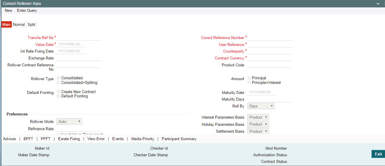

You can capture instructions for a consolidation rollover in the ‘Consolidation Rollover’ screen. You can also define split instructions as part of capturing normal consolidation instructions. You can invoke the ‘Consolidation Rollover’ screen by typing ‘LBDCOROL’ in the field at the top right corner of the Application tool bar and clicking the adjoining arrow button.
Note
This section explains only those features that are specific to consolidation rollover.
To specify consolidation details for a new drawdown, select New from the menu.
Rollover Netting allows you to capture the netting option for Consol Rollover. The available options are:
Note
The consolidation details to be captured in this screen are explained below:
You can select the child drawdowns for consolidation rollover only if the child drawdowns:
Tranche Ref No
You have to select the reference number of the tranche under which you wish to consolidate drawdowns, as part of the rollover operation. The option list displays all active and authorized tranches maintained in Oracle Banking Corporate Lending Select the tranche of your choice from this list.
Product Code
You have to select the drawdown product based on which the system selects the drawdowns for consolidation. The option list displays the drawdown products associated with the tranche product under which the selected tranche is processed.
Note
Upon selection of the product, the system generates a ‘Contract Reference No’ which may be used as a reference to view the consolidation instructions captured in the screen.
Counterparty
You have to select the counterparty of the drawdowns that have to be consolidated as part of rollover. The option list displays the list of all active customers of the branch.
Contract Ccy
You have to select the currency of the drawdowns that have to be consolidated as part of rollover. The option list displays the allowable currencies for the tranche. Select a currency from this list.
Value Date
Another parameter for selecting the drawdowns for consolidation is the value date. In effect, this date refers to the maturity date of the child drawdowns that have to be consolidated as part of rollover. In addition to the same combination of counterparty, product, and currency, the child drawdowns should also have the same maturity date for consolidation to occur.
Rollover Type
You have to indicate the type of rollover you wish to perform. The available options are:
Default Fronting
In consolidation rollover, if ‘Create New Contract’ option is selected, then the system will internally treat it as consol + split and do the rollover processing.
After selecting the combination of counterparty, product, currency and value date for drawdown selection, you have to capture the following in the ‘Consol Details’ section of the screen:
Child Contract Ref No
You have to select the child drawdowns that have to be consolidated as part of rollover. The option list displays all drawdowns with the same combination of counterparty, product, currency and maturity date that you select. Select a drawdown from this list.

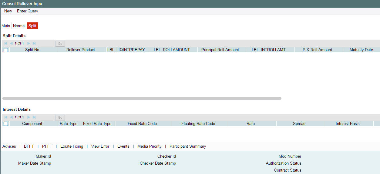

You can define split instructions for a consolidation rollover only if you select the ‘Rollover Type’ as ‘Consolidation + Split’. You can specify the split instructions in the ‘Split’ tab of the ‘Consolidation Rollover’ screen.
For more details on this screen, refer the section titled ‘Specifying details for ‘Split’ rollover’ in this chapter.
If you capture split instructions as part of consolidation rollover, the system first consolidates the selected child drawdowns and then splits the same as per the split instructions you define. The system further ensures that the sum of the split is equal to the consolidated amount.

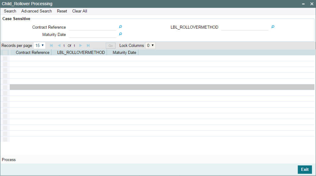

In the case of future dated rollovers, Oracle Banking Corporate Lending allows you to create the rollover child contracts in advance i.e. before the rollover date. You can use the ‘Rollover Child Processing’ (LBSPAROL)screen to generate the child contracts.
In this screen, the system displays all future dated rollover contracts for which child contracts are yet to be created. You can select the contracts for which you wish to create the child contracts in advance. Check the box against each record to select a contract.
Click ‘Ok’ to generate the child contracts for the selected parent contracts.
