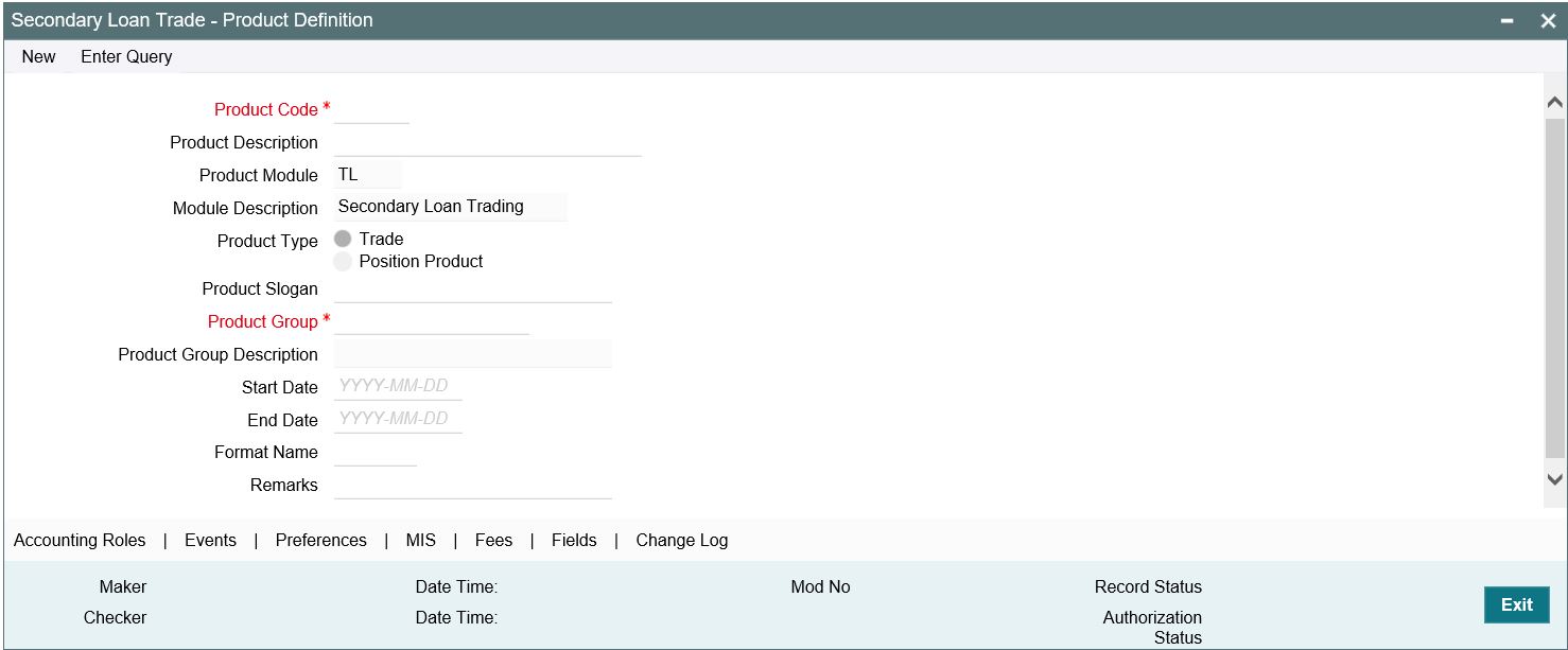

In this chapter, you can define attributes specific to a Secondary Loan Trading product.
You can create an SLT product and maintain basic information relating to the product such as the product code, description, product type and so on, in the ‘Secondary Loan Trade - Product Definition’ screen.
You can invoke the ‘Secondary Loan Trade- Product Definition’ screen by typing ‘TLDPRMNT’ in the field at the top right corner of the Application tool bar and clicking on the adjoining arrow button.
For an SLT product, you can define generic attributes such as branch, currency, customer restrictions, and so on, by clicking on the appropriate icon in the horizontal array of icons in this screen. In addition to these generic attributes, you can define attributes specifically for an SLT product. These attributes are discussed in detail in this chapter.
For further information on these generic product attributes, refer the following Oracle Banking Corporate Lending User Manuals.
You can specify the following details specific to SLT module, in this screen:
Product Code
Specify a unique identification code for the SLT product.
Product Module
The product module displays a default value ‘LT’ indicating Secondary Loan Trading.
Product Type
Select the type of the SLT product from the drop-down list. The following options are provided:
Description
Specify a suitable description for the product.
Product Slogan
Specify a slogan for promoting the product.
Product Group
Select the group to which the product belongs from the option list provided.
Start Date
Specify the date on which the product becomes effective.
End Date
Specify the date on which the product ceases to be effective.
Format Name
Select the format name to be used to generate the customer reference number.
Remarks
Specify additional remarks regarding the SLT product, if any.

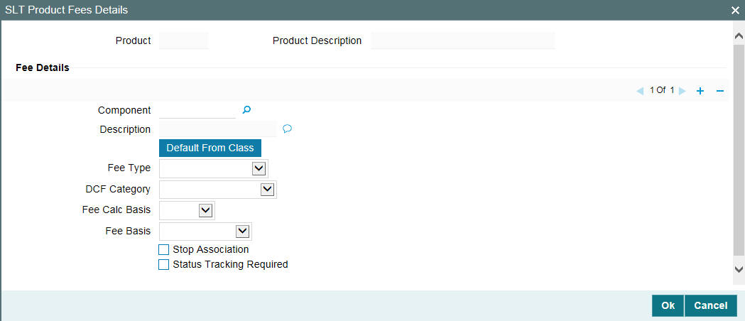

You can specify the details regarding the fee associated with an SLT in ‘SLT Product Fees Details’ screen. To invoke this screen, click ‘Fees’ in the ‘Secondary Loan -Product Definition’ screen.
You can specify the following details regarding fee, in this screen:
Component
Specify the name of the fee component for which you are maintaining the details.
Description
Specify a suitable description for the fee component.
Fee Type
Select the type of the fee from the drop-down list. The following options are provided:
DCF Category
Select the sub category associated with the delayed compensation fee from the drop-down list. The following options are provided:
DCF category is enabled only if you select the fee type as ‘DCF’.

Fee Calc Basis
Select the source for deriving the ‘Fee Basis’ for calculating the fee amount, from the drop-down list. The following options are provided:
This is enabled if you select the fee type as ‘DCF’ or ‘Break-fund Fee’.
Fee Basis
The Fee Basis indicates the method in which a given fee amount has to be calculated. The values in the drop-down list are:
This is enabled if you select the fee type as ‘DCF’ or ‘Break-fund Fee’. If you specify the Fee Calc Basis as ‘Agency’, this will get disabled.
Stop Association
Select this check box to indicate the fee component should not be associated with the product henceforth.
Note
There are no fee components associated with internal deal type of products.
Status Tracking Required
Select this check box to allow the system to start and restart accrual of DCF components.
Note
You can select this check box only for the following type of DCF components:
