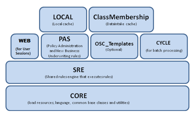

OIPA caches static configuration data and other data that rarely change. There are eight cache regions in the system, each for a different module. Every cache region is configured separately, allowing each one to be configured differently. The cache regions are:
  1. Region CORE for shared libraries.
  2. Region SRE for shared rules engine components.
  3. Region PAS for OIPA specific data.
  4. Region LOCAL for providing caching services on the local node.
  5. Region OSC_Templates for OSC specific caching.
  6. Region CYCLE for batch processing.
  7. Region ClassMembership for Data Intake processing.
  8. Region WEB for User Session Data
Cache Regions
Cache Regions
Above are the Region OSC_Templates for OSC-specific caching. This only needs to be configured if OSC is being used—see the document "OSC Installation Instructions" for further details. The regions CORE, SRE, PAS, WEB, OSC_Templates, CYCLE and ClassMembership are distributed across all nodes in a cluster. The LOCAL region is not distributed. Each JVM has its own LOCAL cache.

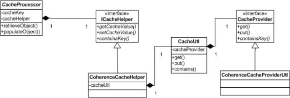

CacheProvider and ICacheHelper Interfaces
The CacheProvider interface defines all methods a caching provider must implement in order to manage cached objects in OIPA. Coherence is the caching provider employed by OIPA.
The ICacheHelper interface defines all methods required by caching access in the system, including getting and setting values for a caching key and method checking if the cache contains a given caching key.
Using CacheProvider and ICacheHelper interfaces allows OIPA to change the actual caching technology that is used for caching without impacting any client code.
CacheProcessor Abstract Class
The abstract class, CacheProcessor, retrieves the object for the caching key from the ICacheHelper in every CacheProcessor instance. An abstract method populateObject() is declared for every CacheProcessor subclass to specify what value object is to be put into the cache associated with the caching key. An updateCache() method is also available for use when a cached value object needs to be updated for the caching key, such as when the system date is advanced from cycle processing. In that case, a new value is updated in the cache.
The following is the pseudo-code of the retrieveObject() method provided by CacheProcessor.
IF cacheHelper contains cacheKey THEN
get cache value of cacheKey from cacheHelper
ELSE
invoke populateObject() to get cache value
put cache value into cacheHelper associated with cacheKey
Accessing Cache
Wherever a piece of data as cache candidate is requested, one anonymous inner class that extends CacheProcessor is defined and instantiated to determine how the value object is created when it is not yet in the cache. The value returned from CacheProcessor retrieveObject() method will be used by the client code. It could be found from the cache region for that module with the caching key, or newly created and put into the cache region associated with the caching key. This is transparent, so the difference is not visible to the client code.

CoherenceCacheProviderUtl and CacheUtl
The utility class CoherenceCacheProviderUtl implements the CacheProvider interface. It enforces the convention for interacting with Coherence. Every CoherenceCacheProviderUtl instance gets a cache region for a given name from the Coherence CacheFactory, which creates a clustered NamedCache instance when necessary. The CoherenceCacheProviderUtl object delegates all caching accesses to its Coherence NamedCache object.
Coherence Cache Provider Utility
Coherence CacheProviderUtl
Every instance of utility class CacheUtl wraps a CacheProvider object. CacheUtl also maintains a class-level map of mappings from cache region name and cache provider type to a CacheUtl instance. This guarantees that only one CacheProvider exists per cache region per cache provider type.
CacheHelper Classes
CoherenceCacheHelper classes are ICacheHelper implementations that use Coherence for caching. There are three CoherenceCacheHelper classes in packages. They are as follows:
  1. com.adminserver.dal.helper
  2. com.adminserver.sre.helper
  3. com.adminserver.pas.dal.helper
Additionally, the LocalCacheHelper class also implements ICacheHelper and is used for local node caching. It is in the com.adminserver.sre.helper package.
Each class corresponds to cache region CORE, SRE, PAS and LOCAL, respectively.
Coherence Cache Helper
These four CacheHelper classes are almost identical, except that each declares its own unique cache region name (i.e., "CORE", "SRE", "PAS","LOCAL") and each registers with Spring using a different bean name.
Each CacheHelper has its own unique CacheUtl instance, which is mapped from the cache region name for the Coherence cache provider type.
