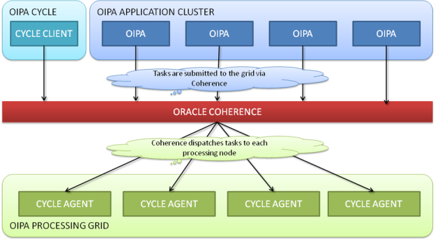

The Cycle subsystem drives processing of transactions through a Cycle Grid, which is comprised of a set of Cycle Agents. Each Cycle Agent is a separate JVM instance, which acts as a processing node in the Grid. A special application called a Cycle Client submits tasks to the Cycle Grid to direct what type of Cycle processing the group is to work on. The following is a high-level diagram showing how the different collaborators work together to start processing a Cycle run.
OIPA Cycle Architecture
Cycle Agents

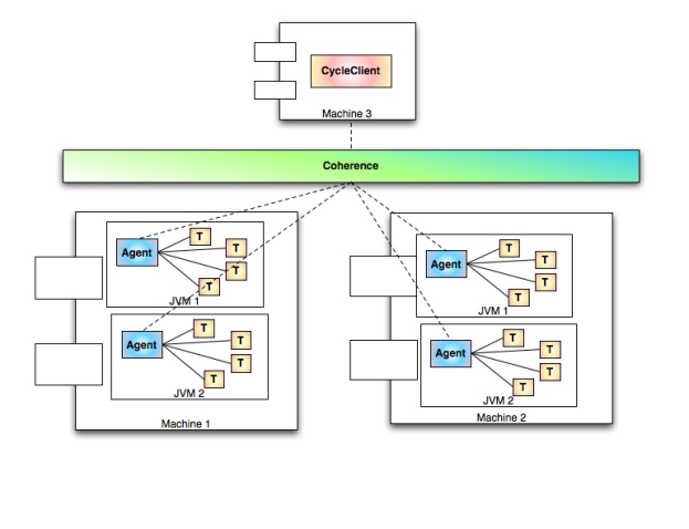

Cycle Agents are the programs that execute the tasks that comprise the Cycle batch process. Each Cycle Agent runs in its own Java Virtual Machine (JVM). Depending on the number of tasks that must be executed during Cycle processing, any number of JVMs may be used to run the desired number of Cycle Agents. The JVMs may be started on one or more physical machines. If more than one machine is used, they will be effectively clustered via the Coherence clustered caching and messaging system.
The following conceptual deployment diagram shows how the Cycle Agents may be distributed between multiple machines and JVMs. The boxes labeled "T" represent the threads controlled by the Agents to perform the units of work.
OIPA Cycle Agent

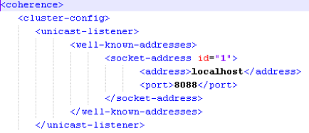

The Coherence cluster configuration in cycle-coherence-config.xml must be modified to include each Cycle Client and Agent that will participate in the Cycle group.
Since each Cycle member exists in its own JVM process and each member may be spread across multiple machines, the Cycle members in the same Cycle group must communicate. The messaging functionality of Coherence is used to accomplish this communication.
It is required that all Cycle members in the same Cycle group be configured in the same Coherence cluster.
The top of the file contains a section that allows for the addition of each machine that will participate in the Cycle group. Every Cycle Client and Agent that participates in a given Cycle group must be contained in this section. Also, each OIPA instance, if used for cycle processing, should also be listed in this section, as OIPA has the ability to submit work to the Cycle group. In the case that a machine is not included in the Coherence configuration, the machine will not be able to join the Cycle group and will encounter issues starting up.
When configuring the well-known-address list, keep the following in mind:
  • Every Cycle Client, Cycle Agent, and OIPA instance (if participating in cycle) must be listed in the well-known-address list
  • The well-known-address list must be exactly the same across all members (Cycle Clients, Cycle Agents, and OIPA instances)
  • If all members do not have the same well-known-address list, some may not start up properly or run at all.
  • Incorrect configuration of the well-known-address list is the most common source of Cycle and OIPA problems. Ensure the list is configured correctly and shared by all members.
  • If you use a member-identity section like the example below, make sure that the member-name is unique in the cluster, and that the cluster-name is the same for all members of the cluster. If the cluster-name is not the same, members may not be allowed to join the Coherence cluster, causing startup issues for the OIPA instance, Cycle Agent, or Cycle Client.
