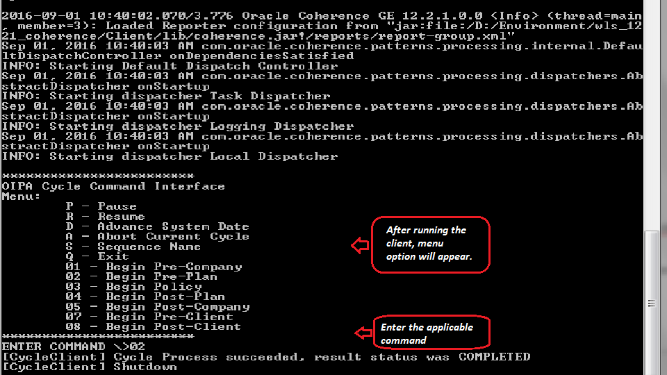

Running Cycle Client allows you to set how you want a set of pending activities to process. You must use the run.bat file for a Microsoft ® Windows environment.
  1. Open a command line.
  2. Navigate to the path where the application is installed and then to the Cycle.client-<version number>/bin folder. Type 'run'.
  3. Type in the letter or number associated with the command you want to run. Explanations of the commands are below.
  4. Refer to the log files to see messages and errors.

  4. Type in the letter or number associated with the command you want to run.
  5. Refer to the log files to see messages and errors.
