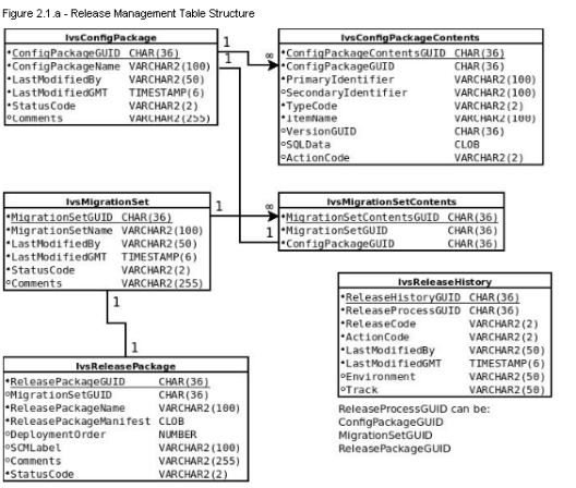

Figure 4: Release Management Table Structure

Configuration Packages represent a unit of work, or an issue in an issue tracking system (e.g. JIRA). A Configuration Package can contain several rules that were modified as part of an issue. It can also contain non-rule items such as SQL Scripts (DML or DDL), stored procedures, and reports. All Configuration Packages are represented in the database by the IvsConfigPackage table, and the rules that are part of them are represented by IvsConfigPackageContents (see Figure 4). This is a one-to-many relationship.

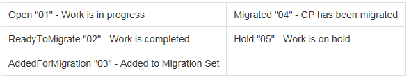

The following type codes related to CPs correspond to the following IvsCode Code Names:
IvsConfigPackage.StatusCode: IvsCode.CodeName = "IvsCodeConfigPackageStatus"
A list of statuses available for a Configuration Package appears in Figure 5 below.
Figure 5 - Configuration Package Statuses
The Configuration Lead is responsible for reviewing all Configuration Packages to make sure there are no conflicts. Any rules that were deleted should reside in an Orphan Rules Configuration Package. All these rules should be reviewed to ensure the rules are not needed in any other configuration.

Migration Sets represent a collection of Configuration Packages that will be associated with a release and migrated from a Development environment to different environmental levels of a company, generally ending in Production. All Migration Sets are represented in the database by the IvsMigrationSet table, and the Configuration Packages that are part of them are represented by IvsMigrationSetContents (see Figure 4). This is a one-to-many relationship. The IvsMigrationSetContents:IvsConfigPackage relationship is one-to-one. While IvsMigrationSetContents looks similar to a link table, the relationship cannot be many-to-many because a Configuration Package may only be in one Migration Set.

All Release Packages are represented in the database as the IvsReleasePackage table (see Figure 4). There is a one-to-one relationship with the IvsMigrationSet table. The ReleasePackageManifest column stores an XML CLOB that serves as a readable version of the contents of the Release Package. ReleasePackageManifest is for users who don't have access to the database, but want to know what is in the Release Package. It can also be used for the planned "file deployment" functionality described above.

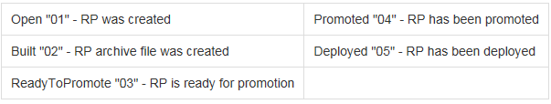

The following type codes related to Release Packages correspond to the following IvsCode Code Names:
IvsReleasePackage.StatusCode: IvsCode.CodeName = "IvsCodeReleasePackageStatus"
A list of statuses available for a Release Package is shown in Figure 7 below.
Figure 7 - Release Package Statuses
Promotion mentioned in statuses 03 and 04 has to do with external Source Control Management (SCM) systems. The idea was to have SCM environments that corresponded to the OIPA environments, then to set a Release Package "Ready to Promote", check the Release Package into the SCM environment, "Promote" the Release Package to the target SCM environment, and then deploy the Release Package to the target OIPA environment. This process was part of an "external approval procedure," which was an offshoot of Sarbanes Oxley legislation. All of these steps must be performed manually as the Rules Palette currently does not interface with any third party SCMs.

Release History provides an audit trail for all actions that take place in the Release Management process. Release History is represented by the IvsReleaseHistory table (see Figure 4). The Release History table shows that action that occured (ActionCode), when it happened (LastModfiedGmt), the user who executed it (LastModifiedBy), where it happened (Environment AND Track), what type of Release Management component the action is being performed against (ReleaseCode), and the identifier for the component (ReleaseProcessGUID).
