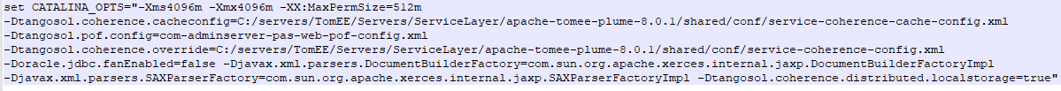

setenv configuration
For Windows deployment we need to create setenv.bat file in the bin folder of extracted TomEE directory.
For Linux deployment we need to create setenv.sh file in the bin folder of extracted TomEE directory.
The following configuration needs to be placed in the setenv.bat file for Windows environment

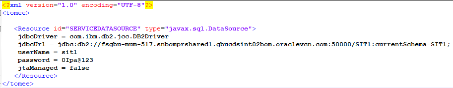

Creating Data Sources
tomee.xml is the file where all the data sources, JMS configurations are made. Any data source, which is needed by an application to run, has to be configured in this file. ServiceLayer requires SERVICEDATASOURCE datasource to be created.
Sample configuration of all the data sources which are required for ServiceLayer to run:
