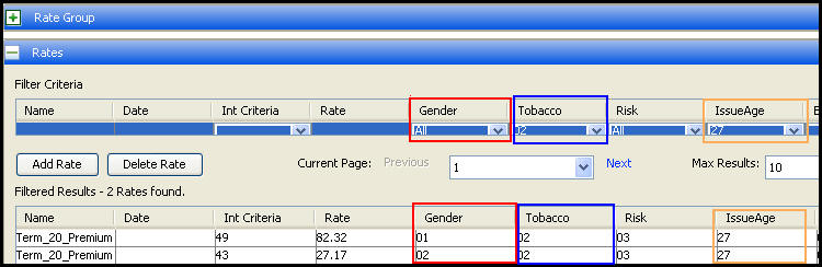

  7. Select a filter criteria from any column shown in the filter criteria section. For example, if you want to see all male and female non-smokers age 27 with a specific Tobacco class, you would set your filter as shown in the image below.

Rates Editor with Filter Criteria selected
