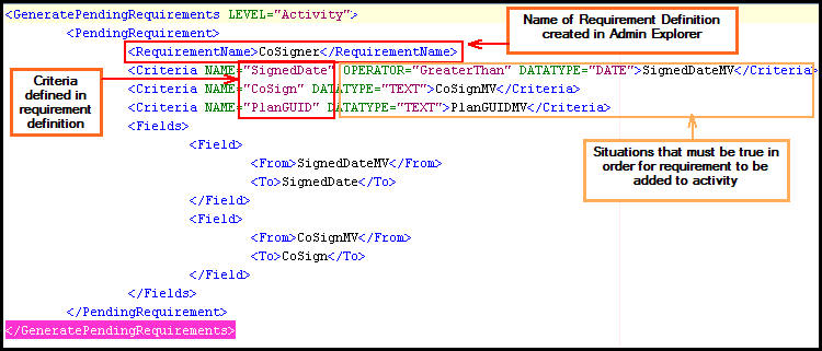

GeneratePending Requirements Business Rule
GeneratePendingRequirements references the criteria identified in the requirement definition (AsRequirementCriteria) and matches it to the math variable identified in the rule. If all conditions identified in the rule are true, then the requirement is generated.
Important: Refer to the XML Configuration Guide in the Rules Palette help menu for a detailed explanation of the elements and values available for configuration in this business rule. The business rule can be found in the Business Rules | Attached Rules folder.
GeneratePendingRequirements business rule XML
GeneratePendingRequirements Business Rule XML
