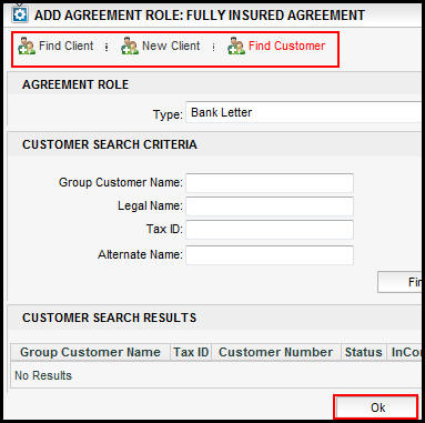

- OK: this controls the availability of the OK button at the bottom of the Add Agreement Product window.
- AddClient: this opens a new client detail section in the window so new clients can be created and added as roles.
- FindClient: this opens a client search section in the window so existing clients can be found and added as roles.
- FindCustomer: this opens a customer search section in the window so existing customers can be found and added as roles.
- OK: this controls the OK button at the bottom of the Add Agreement Role window.
Add Agreement Role Window With Security Applied

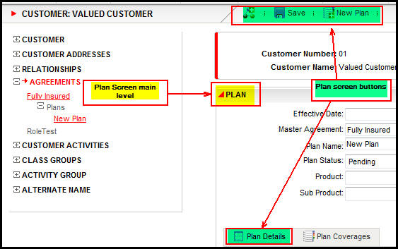

AgreementHistory: this controls the options available to an Agreement History Page
AgreementPlans: this controls the options available on the tab of the Agreement screen.
- AddActivity: this controls whether the Add Activity link will display on the Secondary menu.
- AddAgreementPlan: this controls the Add Agreement Plan button on the Agreement screen's Plans tab.
CopyAgreementPlan: this controls the Copy Agreement Plan button on the Agreement screen's Plans tab.
- DeleteAgreementPlan: this controls the Delete right-click option on the Agreement screen's Plans tab. This option allows the user to delete an agreement plan.
- EditAgreementPlan: this controls the Edit right-click option on the Agreement screen's Plans tab. This option allows the user to edit an agreement plan's details.
- GoToPlan: this takes the user to the Plan screen with the selected plan displaying on the screen. This is a right click option available after clicking on the Plans tab in the lower section of the Agreement screen.
- OpenClassRuleVariables: this controls whether the Class Rule Variables button will display on the Secondary menu.
- Save: this controls the availability of the Save button on the Agreement screen's Plans tab. This button allows the user to save an agreement plan.
Agreement Screen With Plan Right-Click Action with Security Added

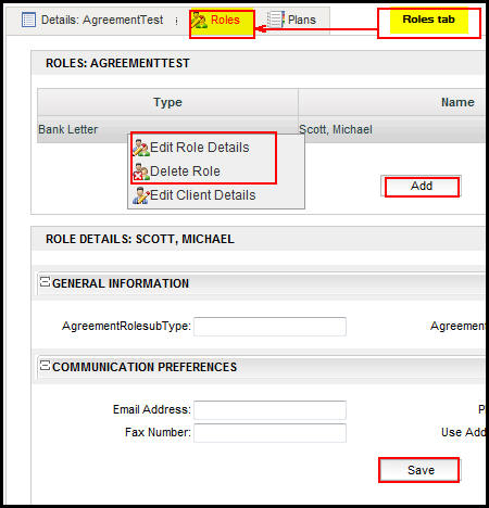

- AddAgreementRole: this controls the Edit option on the right-click menu when a role is selected.
- AddClient: : this controls the availability of the Add option on the right-click menu when a Role is selected.
- EditAgreementRole: : this controls the availability of the Edit option on the right-click menu when a Role is selected.
- DeleteAgreementRole: this controls the Delete option on the right-click menu when a role is selected.
- FindClient: this controls the Find Client option.
- FindCustomer: this controls the Find Customer option.
- Save: this controls the Save button at the bottom of the Roles section.
Roles Tab on Agreement Screen with Security Applied

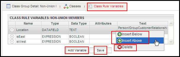

- OpenClassRuleVariables: this controls display of the Class Rule Variables button on the secondary menu.
- Return to Draft: this controls the "Return to Draft" time slice action, which is controlled from within the class group time slice table.
- Save: this controls display of the Save button on the secondary menu.
- Submit: this controls the "Submit" time slice action, which is controlled from within the class group time slice table.
Class Group Screen showing security applied

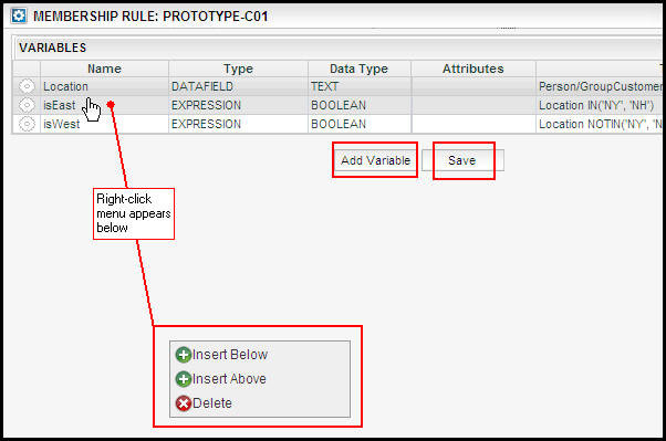

- AddVariable: this controls display of the Add Variable button.
- Delete: this controls display of the Delete option on the context menu for the Class Rule Variables table.
- Insert: this controls display of the Insert options (Insert Above and Insert Below) on the context menu for the Class Rule Variables table.
- Save: this controls display of the Save button.
Class Rule Variables table on Class Group Screen showing security applied
- Insert: this controls display of the Insert options (Insert Aboveand Insert Below) on the context menu for the Class Rule Variables table.

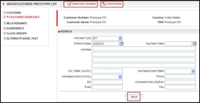

GroupCustomerAddress: this page controls the availability of actions when the Customer Addresses link is clicked on the Customer Left Navigation menu
- AddActivity: this controls display of the Add Activity button on the secondary menu.
- AddAddress: this controls display of the Add Address button on the secondary menu.
- AddIssueDocument:
- GroupCustomerComments: this controls the display of GroupCustomerCommentsbutton on the GroupCustomer Address screen.
- Inquiry: this controls display of the Inquiry button on the secondary menu.
Group Customer Address Screen showing security applied
GroupCustomerClassRuleVariables: this controls the user's ability to use the buttons on the Group Customer level Class Rule Variable screen.
Class Rule Variable screen security

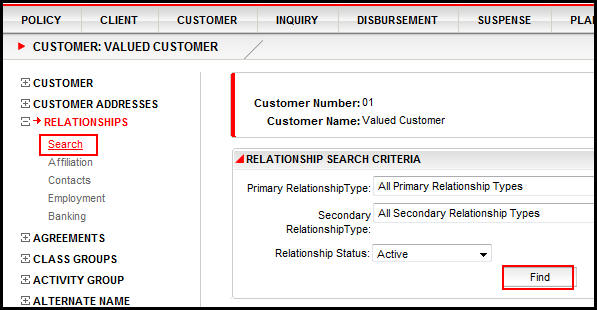

GroupCustomerRelationshipSearch: this page controls the Search link under the Left Navigation menu link for Relationships on the Group Customer screen. If this link is present, then users will be able to search by primary relationships, secondary relationships, relationship status and any combination of the three.
- Find: this controls the Find button on the Group Customer Relationship Search screen.
Relationship Search and Find Buttons in OIPA

Plan: this page controls the Plan screen. The Plan screen is accessed from the Plans tab at the bottom of the Agreement screen.
- Activity
- Add
- AddIssueDocument
- AddActivity: this controls whether the Add Activity link will display on the Secondary menu when the Plan Activity screen is visible in OIPA.
- Delete
- Diff
- Edit: this controls the Edit right-click option on the Agreement screen. This option allows the user to edit an agreement's details.
- GoToAgreement: this controls the Go to Agreement right-click option on the Agreement screen. This option allows the user to view an agreement's details.
- GroupCustomerComments: this controls the display of GroupCustomerCommentsbutton on the Plan screen.
- Inquiry: this controls whether the Inquirydrop-down displays on the Secondary menu of the Plan screen.
- NewPlan: this controls whether the New link displays on the Secondary menu of the Plan screen.
- OpenClassRuleVariables: this controls whether the Class Rule Variables link displays on the Secondary menu of the Plan screen.
- PlanDetails: this controls whether the Details tab is visible at the bottom of the Plan screen.
- Save: this controls whether the Save button displays at the bottom of the Plan screen.
- ReturnToDraft
- NewTab: this controls the display of a new tab under Group Customer to display the list of members enrolled in that Plan.
Plan Screen With Security Applied to Links
