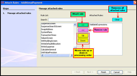

Select the rule to attach from the Rule List.
Use the
button to attach the
rule. -
Repeat as necessary.
Select Finish.

Select the rule to remove from the Rule List.
Use the
button to remove a rule. -
Select Finish. The Attached Rules node may disappear from the navigation tree. If this happens, logout and log back into the Rules Palette to refresh the navigation tree.
