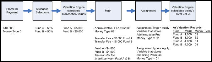

High Level Valuation Steps
High Level Work Flow Diagram
