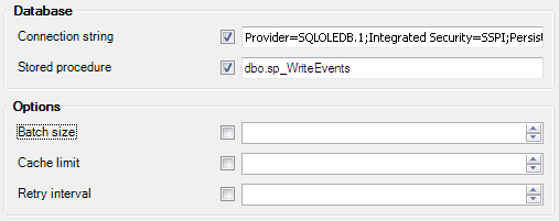

  3. Expand Audit Logging and select Reporting Server. Configure the following settings:
    Description of reporting_database.png follows
    Description of the illustration ''reporting_database.png''
    • Connection string: Enter the database connection string in OLE DB format. The machine must be within the domain. For example:
      Provider=SQLOLEDB.1;Integrated Security=SSPI;PersistSecurity Info=False;Initial Catalog=Database_Name;Data Source=database_server
    • Stored procedure: The name of the stored procedure in the database. When encoded events are sent to the database, the stored procedure is called to decode the XML file and store the events in the database. Set this to dbo.sp_WriteEvents.
    • Batch size: Defines the group size of events to be sent to the database Stored Procedure at one time. For example, if you have 1000 events in the Reporting Service cache and the Batch Size is 100, you will have 10 database Stored Procedure calls. (Default is 100.)
    • Cache limit: Maximum number of reporting events to be cached. Once this number is reached, the oldest events are discarded. For example, if the batch size is 100, and an end-user's system cannot connect to the reporting service, it will keep logging events. Once it gets to 1000, the oldest events will be discarded. (Default is 1000.)
    • Retry interval: Defines timeout in minutes between sequential operations of the Reporting Service Cache offloading events to the database. An interval is necessary to reduce database connection load. (Default is 30.) Retry Interval should be set to 0 when Reporting is used.

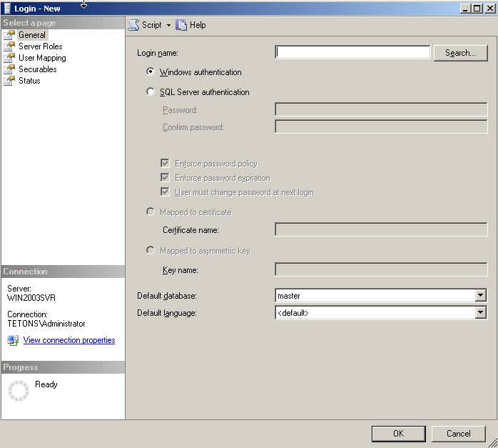

    • For Microsoft SQL, create a domain user with the same rights to the SQL database as you would give the Domain Computers group.

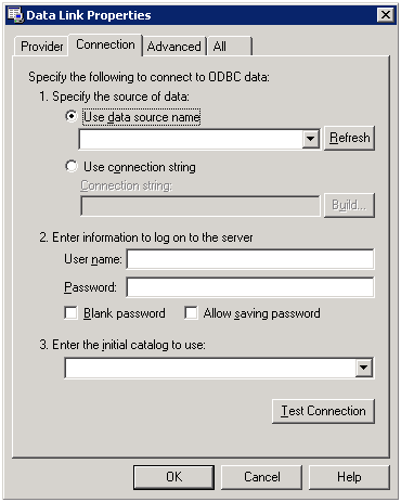

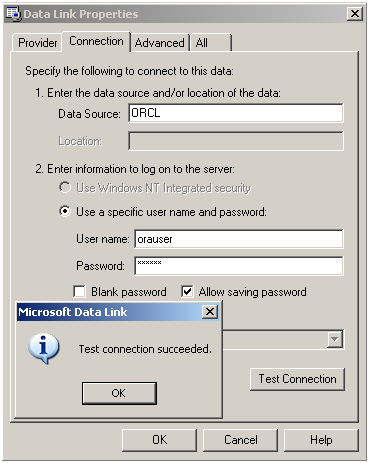

  1. Open Windows Explorer and navigate to the folder in which you want to store the .udl file.
  2. From the File menu, click New and then click Text Document. A new file named New Text Document.txt appears in the directory.
  3. Rename this file, removing all spaces and changing the file extension to .udl, for Universal Data Link.

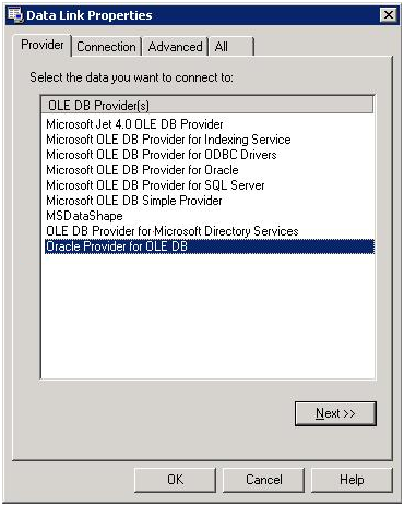

  4. Double-click the Universal Data Link (.udl) file. The Data Link Properties dialog opens.
    Description of rep_oradb7.png follows
    Description of the illustration ''rep_oradb7.png''
  5. On the Provider tab, select Oracle Provider for OLE DB and then click Next.
    Description of rep_oradb8.png follows
    Description of the illustration ''rep_oradb8.png''
  6. On the Connection tab, enter the Data Source, User name, and Password. Check the Allow saving password check box and click Test Connection. For example: Data Source: ORCL, User name: orauser, Password: oracle.
    Description of rep_oradb9.png follows
    Description of the illustration ''rep_oradb9.png''
  7. A message will appear indicating that the test connection succeeded. Click OK.
  8. Click OK to save the connection string to the Universal Data Link (.udl) file.

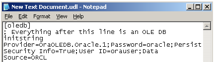

  9. Open the .udl file in Notepad. In the next section of this guide you will be instructed to enter a connection string. Copy and paste this string and enter it into the Connection string field.
    Description of rep_oradb10.png follows
    Description of the illustration ''rep_oradb10.png''
    Description of rep_oradb5.png follows
    Description of the illustration ''rep_oradb5.png''
    The full connection string above reads as follows:
    Description of rep_connctn_string.png follows
    Description of the illustration ''rep_connctn_string.png''

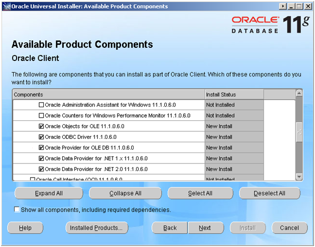

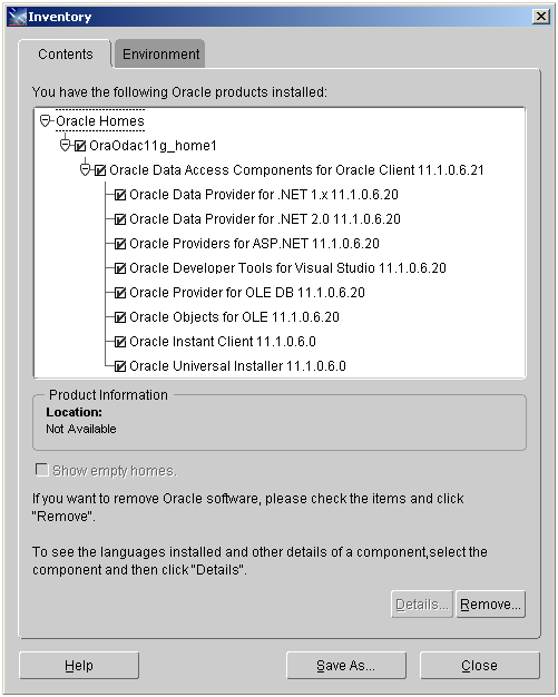

If you are installing Logon Manager on a 64-bit system and plan to configure the Reporting Service to store event data in an Oracle Database, you must install the 32-bit version of the Oracle Database client on the target end-user machine; otherwise, the Reporting Service will not be able to connect to the Oracle Database.
  1. Install either Oracle Client with Oracle Provider for OLE DB or Oracle Data Access Components for Oracle Client.
    Description of rep_oradb1.png follows
    Description of the illustration ''rep_oradb1.png''
    or
    Description of rep_oradb2.png follows
    Description of the illustration ''rep_oradb2.png''

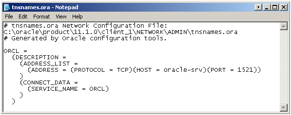

  2. Next, configure the Oracle Client for connection to the Oracle Server. Edit or create the following file:
    <Oracle_Home\client_1\Network\Admin\tnsnames.ora:
    "# tnsnames.ora: Network Configuration File:
    C:\oracle\product\11.1.0\client_1\NETWORK\ADMIN\tnsnames.ora
    # Generated by Oracle configuration tools.
    ORCL =
    (DESCRIPTION =
     (ADDRESS_LIST =
     (ADDRESS = (PROTOCOL = TCP)(HOST = oracle_host_server_name)(PORT = 1521))
     (CONNECT_DATA =(SERVICE_NAME = ORCL)))
    Description of rep_oradb3.png follows
    Description of the illustration ''rep_oradb3.png''

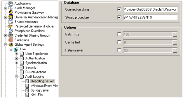

  3. Launch the Administrative Console by clicking Start > Programs > Oracle > Administrative Console.
  4. In the tree, right-click Global Agent Settings, click Import, then click From live HKLM.
  5. Under Global Agent Settings > Live, expand Audit Logging > Reporting Server.
  6. Copy and paste the string you created in the previous section, Creating a Connection String. For example:
    "Provider=OraOLEDB.Oracle.1;Password=password;Persist Security Info=True;User ID=user_name;Data Source=ORCL"
  7. Set the Stored Procedure setting to:
    "SP_WRITEEVENTS"
    Description of rep_oradb5_crop.png follows
    Description of the illustration ''rep_oradb5_crop.png''
  8. Right-click Live and click Write to Live HKLM.
  9. Close the Administrative Console.

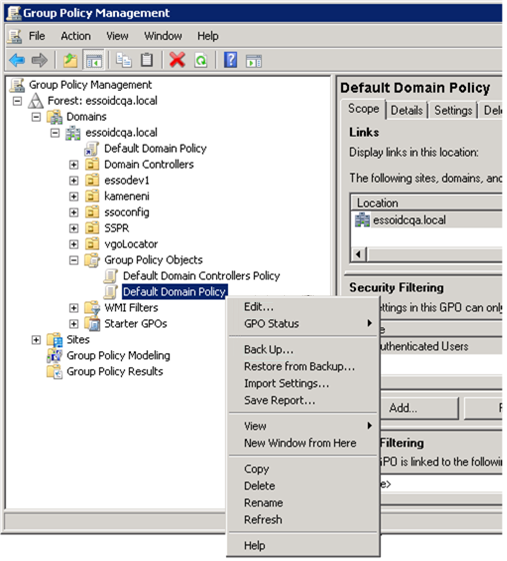

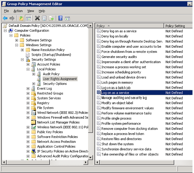

  1. On your domain controller, click Start, click Run, enter gpmc.msc, and then click OK.
  2. In the console tree, open Domains > Current Domain Name > Group Policy Objects. Right-click Default Domain Policy, and select Edit from the context menu.
    Description of rep_int_auth_with_sql1.png follows
    Description of the illustration ''rep_int_auth_with_sql1.png''
  3. In the Group Policy Management Editor's console tree, go to Computer Configuration > Policies > Windows Settings > Security Settings > Local Policies > User Rights Assignment.
  4. In the details pane, double-click Log on as a service.
    Description of rep_int_auth_with_sql2.png follows
    Description of the illustration ''rep_int_auth_with_sql2.png''

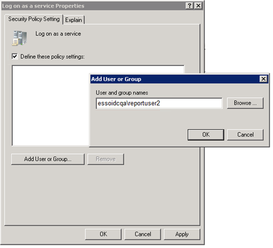

  5. Verify that the Define this policy setting check box is selected, and click Add User or Group. Enter the new Reporting Domain User in the User and group names field.
  6. Click OK when finished.
    Description of rep_int_auth_with_sql3.png follows
    Description of the illustration ''rep_int_auth_with_sql3.png''

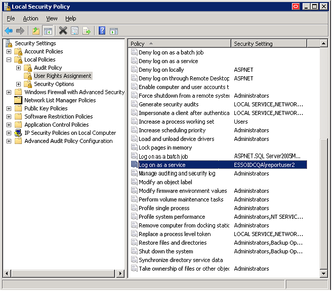

6.4.5.3 Verifying Publication of the Active Directory Permission on the Client Machine
Also see Microsoft's technical note about modifying permissions on an Active Directory domain or local computer to allow a domain user to log on as a service.
  1. Ensure that the client is updated by opening a command prompt and entering the gpupdate /force command. For a discussion of this procedure, see the Microsoft Technical Library article at http://technet.microsoft.com/en-us/library/cc778890%28v=ws.10%29.aspx
  2. Go to Administrator Tools > Local Security Policy.
  3. In Local Security Policy go to Security Settings > Local Policies > User Rights Assignment (as shown in the following figure).
  4. In the Detail Panel check for the updated "Log on as a service" policy. It should include the Reporting Domain User among the users who have this permission.

6.5.3 Creating the Connection String for Integrated Login
Use a .udl file to create a connection string for the integrated Login User as you would for any other Oracle Database user. For the Integrated Login User, do not specify any username or password. Enter the user name as "/" and test the connection.
Make sure you are logged on to the system as the Report Domain User who has been identified in Oracle Database as an external user, and that the sqlnet.ora file has AUTHENTICATION_SERVICES set to NTS.
The connection string will read as follows:
Provider=OraOLEDB.Oracle.1;Persist Security Info=False;User ID=/;Data Source=ORCL
6.5.4 Configuring the Oracle Database on Client Machines
Refer to the section on Configuring the Oracle Client and Server for this procedure.
Ensure that the SQLNET.AUTHENTICATION_SERVICES parameter in the sqlnet.ora file is set to NTS on both the client and the server.
Also see the Oracle Database Platform Guide for more information on External User Authentication Task on the Client Computer and more.

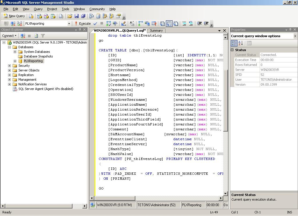

6.6.1 Creating the Database Table and Setting Up Stored Procedures
The following procedure creates a database table and stored procedures for a SQL Server database. You must perform these steps for both upgrades and new installations.
  1. Open SQL Server 2005 or 2008. Click All Programs > Microsoft SQL Server 2005 (or 2008) > SQL Server Management Studio.
  2. Connect to the Database using Windows authentication, which should be the default.
  3. On the left pane, navigate to Databases.

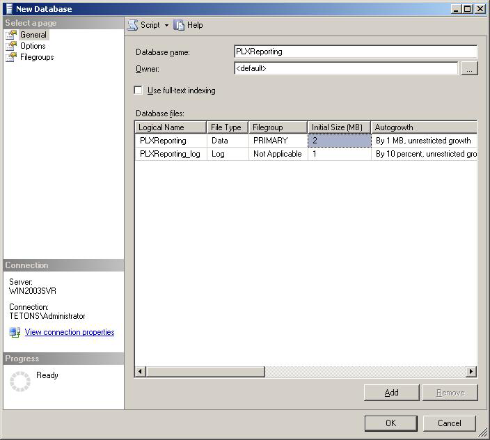

  4. Right-click on Databases and select New Database. The New Database dialog opens.
    Description of rep_new_db.png follows
    Description of the illustration ''rep_new_db.png''
  5. Enter a Database name, for example PLXReporting, and click OK. You should now see a PLXReporting database under Databases.
    The database can have any name as long as the name is consistent in the queries and stored procedures.
  6. Right-click on PLXReporting and select New Query.
  7. Execute the following script on the SQL Server to instruct the database where to put the ESSO.Reporting.MSSQL.Decoding.dll:
    • For SQL Server 2005:
      DECLARE @AssemblyPath nvarchar(1024)
      SELECT @AssemblyPath = REPLACE(physical_name,
      'Microsoft SQL Server\MSSQL.1\MSSQL\DATA\master.mdf',
      'Microsoft SQL Server\MSSQL.1\CLR\')
      FROM master.sys.database_files WHERE name = 'master';
    • For SQL Server 2008 R2:
      'Microsoft SQL Server\MSSQL10_50.MSSQLSERVER\MSSQL\DATA\master.mdf',
      'Microsoft SQL Server\MSSQL10_50.MSSQLSERVER\CLR\')
      The result of this query provides the correct path for the file ESSO.Reporting.MSSQL.Decoding.dll. After receiving this information, create the folder where this file will be placed:
      1. Browse to the path that resulted from the query above.
      2. Create a folder named CLR.
      3. Place ESSO.Reporting.MSSQL.Decoding.dll in this folder.
  8. Open the MSSQL_Setup.sql file located in the Reporting package. Copy the contents of the file into the New Query panel.
    The database name after the Use statement in the query must match the database name entered in Step 5 above.
  9. Click Execute, which is located above the workspace pane. Upon completion, a success message appears in the bottom right pane.
    You have completed creation of the Database table dbo.tblEventsLog, under PLXReporting - Tables, and the stored procedures.

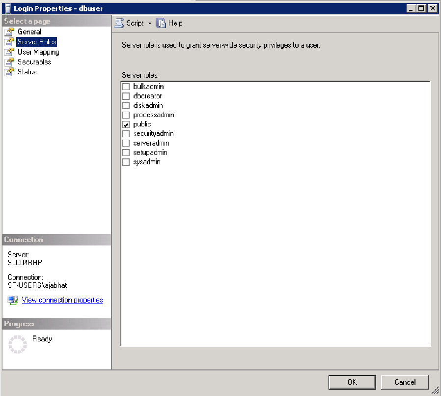

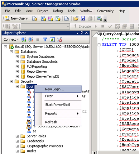

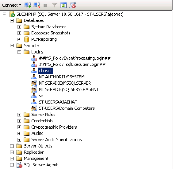

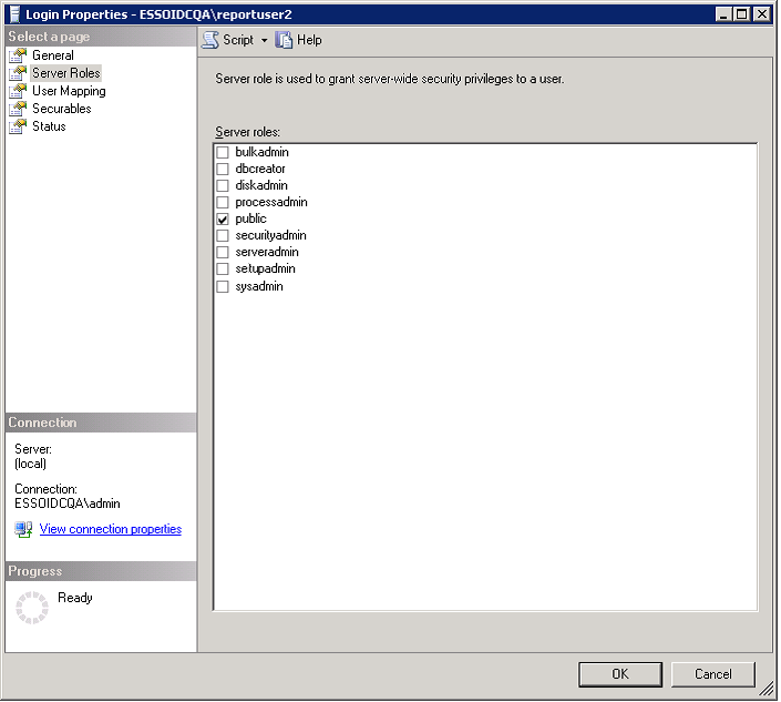

6.6.2 Creating the Reporting Database User
To create the Reporting database user:
  1. In the SQL Server Management Studio left pane, expand the top node (server name), then navigate to Security > Logins.
  2. Right-click on Logins and select New Login.

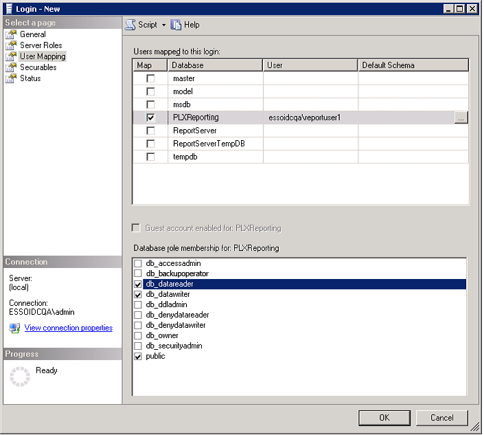

  3. On the New Login dialog:
    1. Select SQL Server Authentication.
    2. Enter your login name and password.
    3. Unselect User must change password and next login.
    4. Select User Mapping in the left pane.
    5. Select the Reporting database (in this case, PLXReporting).
    6. Ensure all server roles except public are unchecked.
    7. Enable db_datareader, and db_datawriter.
  4. Click OK.

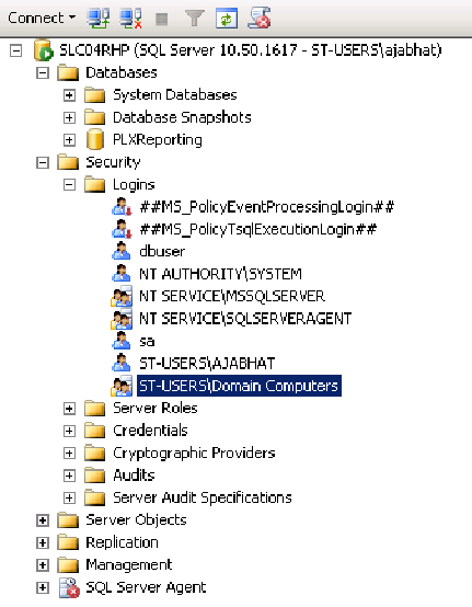

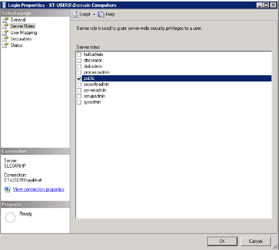

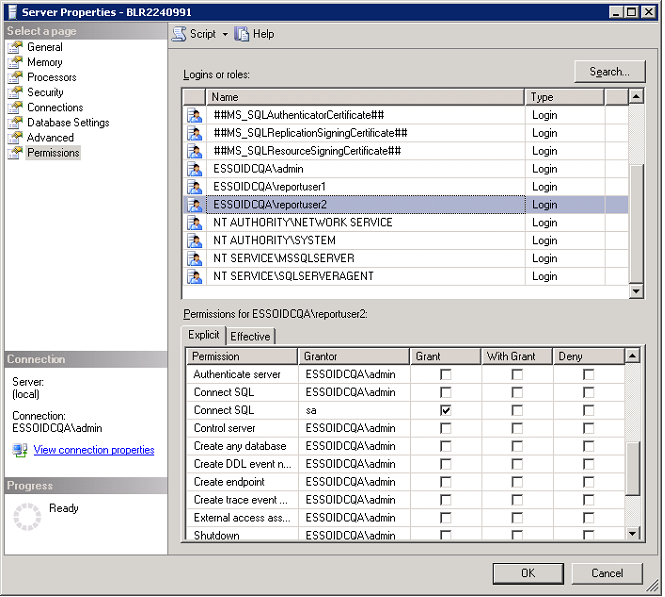

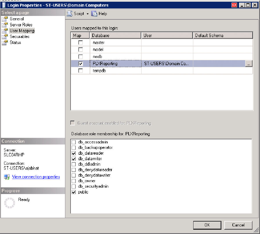

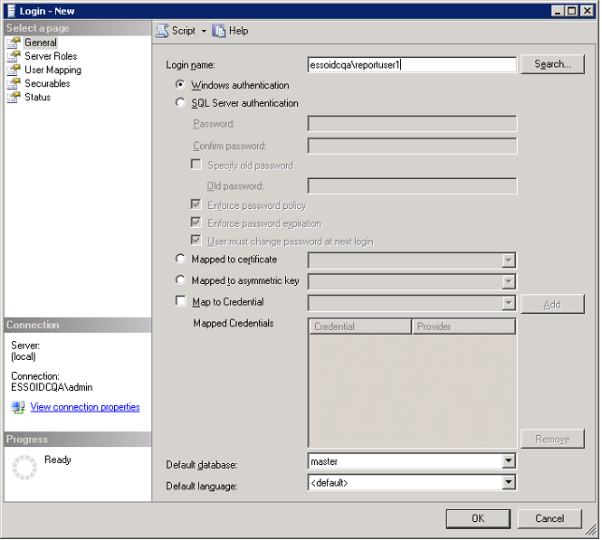

6.6.3 Setting Up the Domain Computer
The following steps configure the Reporting Service to connect to the database.
    Description of rep_security.png follows
    Description of the illustration ''rep_security.png''
  3. On the New Login dialog, enter Domain\Domain Computers in the Login Name field, and then select Windows Authentication.
  5. In the right-hand pane, select the reporting database, (in this case, PLXReporting) as shown in the following screen.

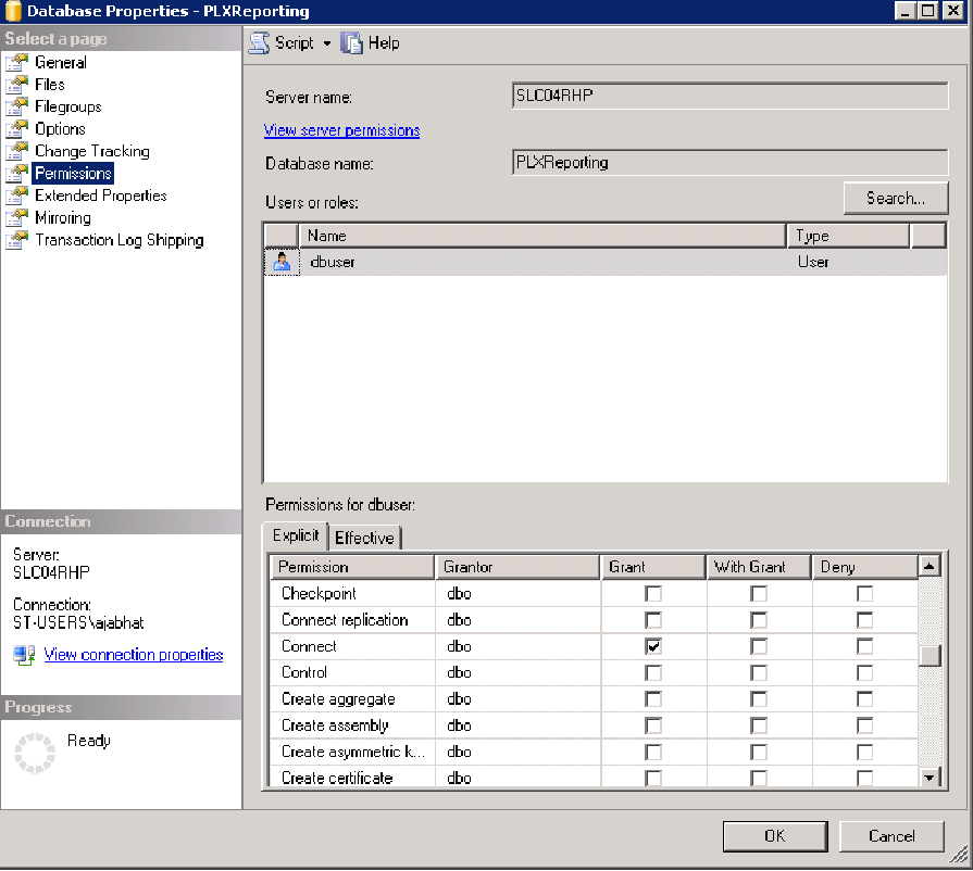

6.6.4 Setting Permissions to Log On to the Reporting Administrative Console
To set permissions to log on to the Reporting Administrative Console:

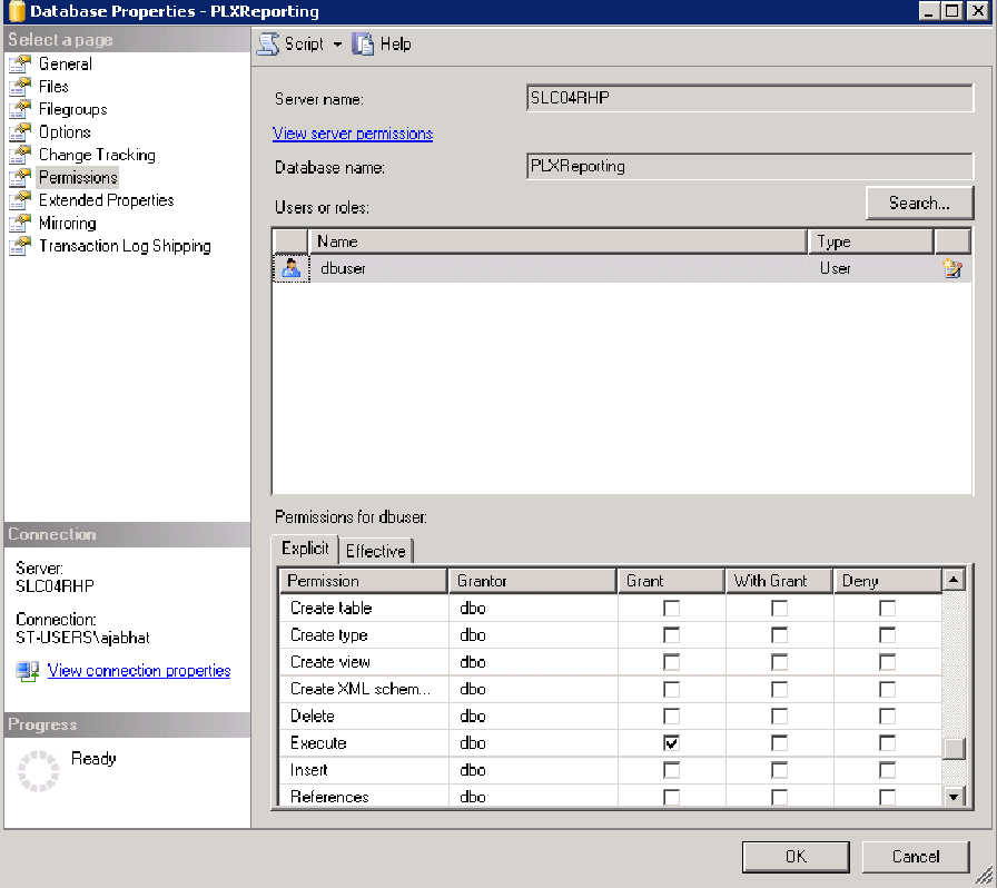

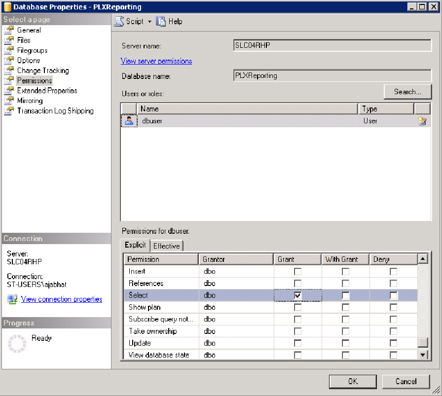

  1. In the SQL Server Management Studio left pane, right-click on the database name (in this case, PLXReporting) and select Properties, then select Permissions from the left pane.
  2. Highlight the user that was created to access the Reporting database (in this case, dbuser).
  3. Ensure Connect, Execute, and Select are enabled in the Grant column, as shown in the following screens.
    Description of rep_sql1.png follows
    Description of the illustration ''rep_sql1.png''
    Description of rep_sql2.png follows
    Description of the illustration ''rep_sql2.png''
    Description of rep_sql3.png follows
    Description of the illustration ''rep_sql3.png''
  4. Click OK.

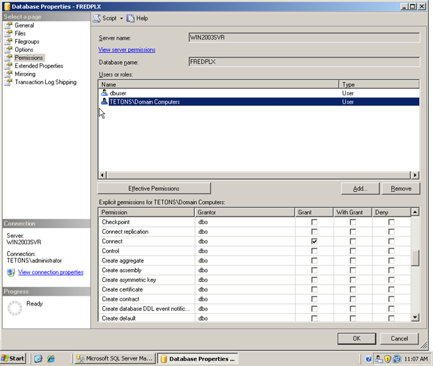

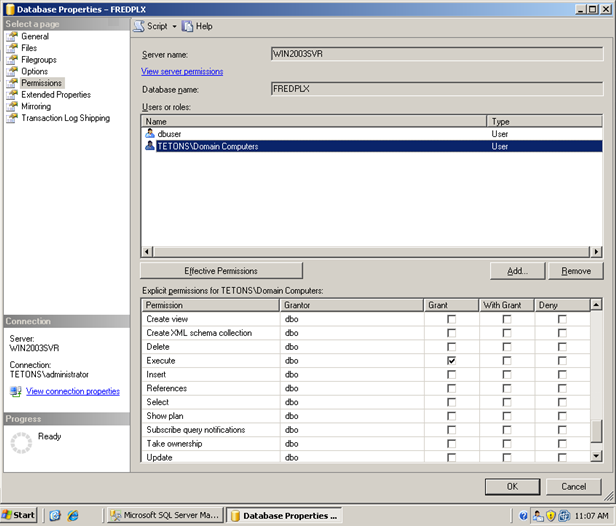

  5. Right-click on the Reporting Database, and select Properties.
  6. Select Permissions from the left pane.
  7. Highlight Domain\Domain Computers.
  8. Ensure Connect and Execute are enabled in the Grant column, as shown in the following screens.
    Description of rep_connect_permission.png follows
    Description of the illustration ''rep_connect_permission.png''
    Description of rep_execute_permission.png follows
    Description of the illustration ''rep_execute_permission.png''
  9. Click OK.
  10. From the top node, go to Security> Logins.
  11. Under Logins, select the user created to access the Reporting Console (in this case, dbuser), right-click, and select Properties.
    Description of rep_sql4.png follows
    Description of the illustration ''rep_sql4.png''
  12. Select Server Roles from the left pane, and ensure all selections except public are unchecked.
    Description of rep_sql5.png follows
    Description of the illustration ''rep_sql5.png''
  13. From the top node go to Security > Logins.
  14. Under Logins, select Domain\Domain Computers, right click, and select Properties.
    Description of rep_sql6.png follows
    Description of the illustration ''rep_sql6.png''
  15. Select Server Roles from the left pane.
  16. Ensure all selections except public are unchecked.
    Description of rep_sql7.png follows
    Description of the illustration ''rep_sql7.png''

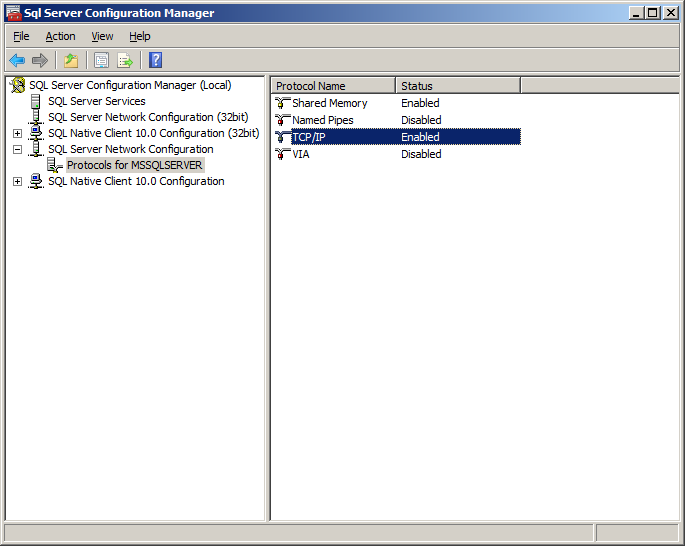

6.6.5 Enabling TCP/IP Protocol on SQL 2008 Server R2
This step only applies to SQL 2008 Server R2.
  1. In the SQL Server Configuration Manager, select SQL Server Network Configuration.
  2. Select Protocols for MSSSQLSERVER.
  3. On the right pane, under Protocol Name, ensure that TCP/IP is enabled.
    Description of server_config.png follows
    Description of the illustration ''server_config.png''

  1. On your domain controller, click Start, click Run, type gpmc.msc, and then click OK.

6.6.7 Verifying Publication of the Active Directory Permission on the Client Machine
  1. Ensure that the client is updated by opening a command prompt and entering the gpupdate/force command. For a discussion of this procedure, see the Microsoft Technical library.
    Description of rep_int_auth_with_sql4.png follows
    Description of the illustration ''rep_int_auth_with_sql4.png''

6.6.9.1 Configuring a Login and Role for the New Reporting Domain User in the Microsoft SQL Database
  2. Right-click on Logins and select New Login….
    Description of rep_int_auth_with_sql5.png follows
    Description of the illustration ''rep_int_auth_with_sql5.png''
  3. In the New Login dialog:
    1. Select Windows authentication. Enter the Reporting Domain User as the Login name.
      Description of rep_int_auth_with_sql6.png follows
      Description of the illustration ''rep_int_auth_with_sql6.png''
    2. Select User Mapping in the left pane.
    3. Map the Reporting Console user to the PLXReporting database.
    4. Enable the db_datareader and db_datawriter role memberships for the Reporting Console User.
      Description of rep_int_auth_with_sql7.png follows
      Description of the illustration ''rep_int_auth_with_sql7.png''
    5. Select Server Roles in the left pane.
    6. Ensure all roles except public are unchecked.
      Description of rep_int_auth_with_sql8.png follows
      Description of the illustration ''rep_int_auth_with_sql8.png''
  4. Click OK.

  1. In the SQL Server Management Studio left pane, right-click on the top node (server name), and select Properties.
  2. In the Properties dialog, select Security from the left pane.
  3. Select the SQL Server and Windows Authentication mode radio button.
  4. Select Permissions from the left pane.
  5. Select the user (Reporting Domain User, created in the previous section) in the Logins or roles section.
  6. In the bottom pane, Explicit Permissions for <name>, ensure Grant is enabled for the Connect SQL permission.
    Description of rep_int_auth_with_sql9.png follows
    Description of the illustration ''rep_int_auth_with_sql9.png''

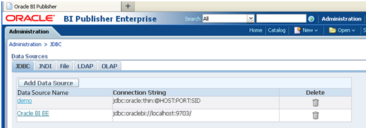

6.7.1 Configuring Oracle Business Intelligence Publisher
  1. Open BI Publisher in your browser (the typical URL is
    http://host:7001/xmlpserver).
  2. Submit credentials for an administrator account.

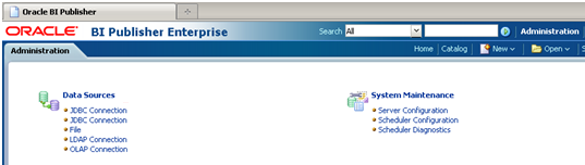

  3. In the BI Publisher window, select the Administration menu.
    Description of bi_pub_choose_admin.png follows
    Description of the illustration ''bi_pub_choose_admin.png''
  4. Under Data Source, select JDBC Connection.
    Description of bi_pub_choose_jdbc_crop.png follows
    Description of the illustration ''bi_pub_choose_jdbc_crop.png''

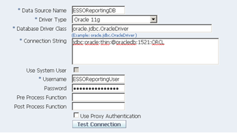

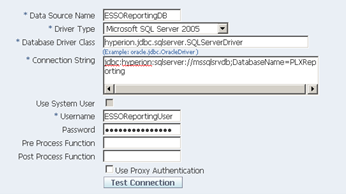

  6. For the data source name, enter: ESSOReportingDB. Provide the Reporting database connection information as in the following examples:
  7. Click Test Connection to verify that the connection is operational. You will see a Confirmation message when the test succeeds.

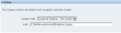

  11. In the Catalog section choose catalog type Oracle BI Publisher - File System and set a folder on your hard drive. This folder will be used for storing your reports. Click Apply.
    Description of bi_pub_choose_cat_type_crop.png follows
    Description of the illustration ''bi_pub_choose_cat_type_crop.png''

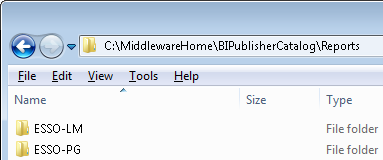

  1. Open the BI Publisher Catalog folder on your hard drive.
  2. Create a Reports folder in this location. BI Publisher searches for the Reports folder in the BIPublisherCatalog directory, so it is important that you create this folder in the correct place.
    Description of bi_pub_deploy_folder_crop.png follows
    Description of the illustration ''bi_pub_deploy_folder_crop.png''
  3. Copy Oracle Enterprise Single Sign-On Suite reports to the Reports subfolder.
    Description of bi_pub_reports_folder_crop.png follows
    Description of the illustration ''bi_pub_reports_folder_crop.png''

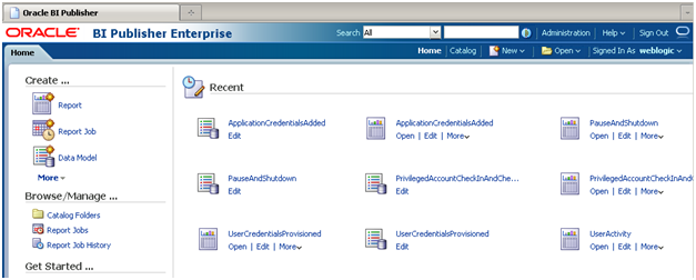

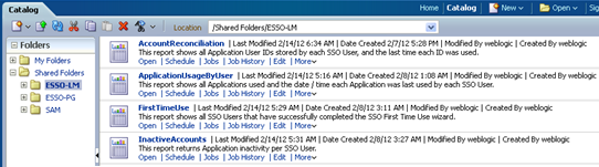

  5. Log on to Business Intelligence Publisher and navigate to Catalog > Shared Folders. Oracle Enterprise Single Sign-On Suite Reports are ready to use.
  6. Under the Report Folder for each component (for example, Logon Manager), for each Report Type "Data Model," click Edit.

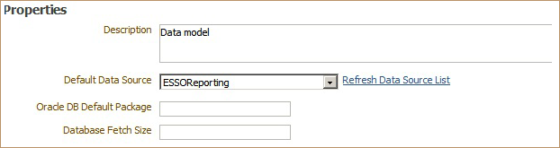

  7. In the Properties dialog, select the database connection you created previously as the value for the Default Data Source.
    Description of bi_pub_datamodel2.png follows
    Description of the illustration ''bi_pub_datamodel2.png''
    Then select from the List of Values to the left of the Properties dialog. Change the Data Source in this dialog as you did in the step above, assigning the previously-created database connection.
