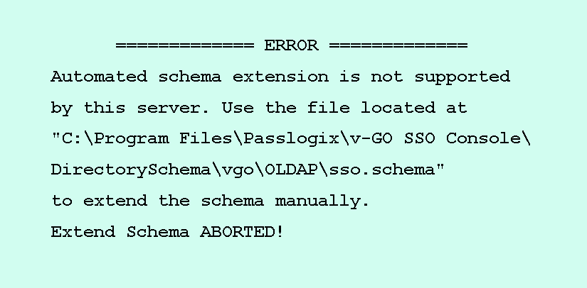

An error message appears when extending the Schema
In the Connect to Repository dialog, if OpenLDAP Directory Server is selected as the Repository Type and an Extend Schema Status error appears, the schema will have to be manually extended.
The Error message appears as follows:
If you receive this error, follow these steps to extend the schema manually:
Copy the sso.schema file to the OpenLDAP server. The sso.schema file can be located in the following location: C:\Program Files\Passlogix\v-GO SSO Console\DirectorySchema\vgo\OLDAP\sso.schema
Place the sso.schema file in the following directory (or other schema directory for OpenLDAP configuration): /usr/local/etc/openldap/schema
The OpenLDAP configuration file must be modified to include the new schema file. Open the file, and add the following line: include <path>/sso.schema where <path> is the path specified in the previous step.
On UNIX machines, this file is calledslapd.conf.This section describes solutions to issues you may encounter when working with Universal Authentication Manager.
