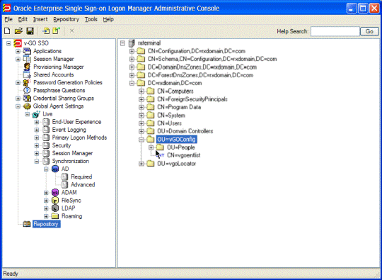

When you have completed your configuration, select Global Agent Settings > Live > Write to Live HKLM.
When you create the Anywhere deployment, you will have the option to use the Live HKLM settings, or an exported registry file. If you plan to use a registry file, select the set of Global Agent Settings you have configured, right-click, and Export to a .REG file. The following graphic depicts a sample configuration.
Oracle recommends that you thoroughly test the registry settings before you export them for inclusion in the package.If you want to sign your package using a digital certificate, follow the instructions for generating an X.509 certificate in the following MSDN article: http://msdn2.microsoft.com/en-us/library/ms819929.aspx
