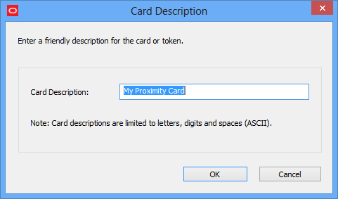

A passive proximity card or token is an identity object (such as a workplace ID badge) containing a circuit that a card-reading device can detect and decipher. When you place a proximity card close to a card reader, the reader detects the token's presence and recognizes identifying information that is associated with you.
Universal Authentication Manager also gives you the option (depending on your system configuration) to require a PIN during logon for more secure two-factor authentication.
The following actions are available:

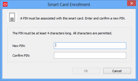

A smart card is a credit card-sized token containing a chip or embedded circuits that can store and process data securely. Information stored on a smart card can also be used for identification and authentication. Universal Authentication Manager enables you to enroll and use smart cards for logon and authentication without writing any data on the smart card chip.

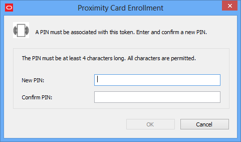

For heightened security, Universal Authentication Manager requires that a PIN be assigned to each enrolled Smart Card and that you enter that PIN when logging on with the corresponding card. Universal Authentication Manager supports a card's built-in PIN and can also generate and assign a virtual PIN.
When using a smart card, the card's own PIN cannot be changed. Only a Universal Authentication Manager PIN associated with the smart card can be changed. For more information, see Configuring Universal Authentication Manager.Challenge Questions is a question-and-answer quiz that requires you to correctly answer enough questions (which you have selected and provided answers for when you first enrolled this method) to satisfy the weight requirement for successful logon set by the administrator.

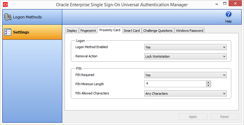

The Settings panel displays configurable policy settings for each logon method. The following settings are available, depending on how your instance of Universal Authentication Manager is configured by your administrator:
On the Display tab, you may be able to view or configure the following setting:
| User Language | Selects the language in which the Universal Authentication Manager interface is displayed. The default value is the language of the operating system.
Note: This menu only shows languages for which the corresponding Universal Authentication Manager language packs have been installed. If you don't see the desired language in the list, contact your administrator. |
On the Fingerprint tab, you may be able to view or configure the following settings:
| Logon Method Enabled | Controls if an installed authenticator is enabled or disabled. This policy setting enhances security by controlling the specific logon methods you are allowed to use. Options are Yes (default setting) and No.
Note: The Logon Method Enabled setting is only displayed if Universal Authentication Manager has been configured into local client mode. In enterprise mode, this setting is not displayed. |
| Number of Fingers | Specifies the number of finger samples you are required to enroll. This policy requires you to enroll exactly the specified number of finger samples during enrollment. Default is 1. Maximum is 10. |
| PIN Required | Specifies whether you must submit a PIN in order to be authenticated. Options are Yes (default setting) or No. |
| PIN Minimum Length | The minimum allowed length for the PIN. Possible values are 4-16 characters (default setting is 4 characters). |
| PIN Allowed Characters | Restricts the character type(s) you can use in your PIN. Options are numeric only, alphanumeric only, or any characters (default setting). |
On the Proximity Card tab, you may be able to view or configure the following settings:
Note: The Logon Method Enabled setting is only displayed if you are working in local mode. In enterprise mode, this setting is not displayed. |
| Removal Action | Controls how Universal Authentication Manager behaves when you "tap out" your proximity card (tap your card against the reader a second time during a session). Options are:
| PIN Required | Specifies whether you must submit a PIN for your card in order to be authenticated. Options are Yes (default setting) or No. |
| PIN Minimum Length | The minimum allowed length for the proximity card PIN. Possible values are 4-16 characters (default setting is 4 characters). |
| PIN Allowed Characters | Restricts the character type(s) you can use in your proximity card PIN. Options are numeric only, alphanumeric only, or any characters (default setting). |

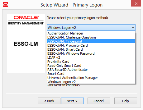

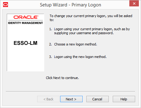

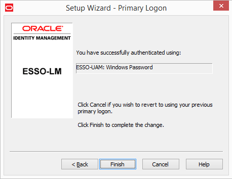

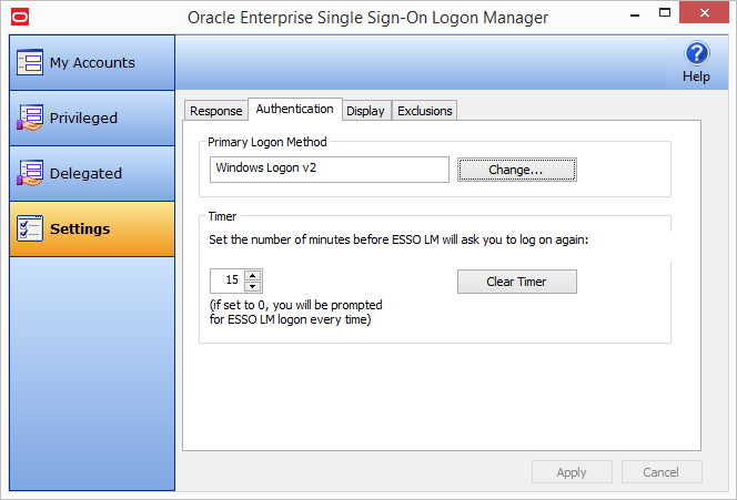

To configure a Universal Authentication Manager logon method as the primary logon method for Logon Manager:
Click Start > Programs > Oracle > Logon Manager > Logon Manager. The Logon Manager icon appears in the system tray. Launch Logon Manager.
Select Settings, then click the Authentication tab.
In the Primary Logon Method section, click Change…. The Primary Logon Setup Wizard opens. Click Next to proceed.
Enter your Windows password or authenticate to your currently enrolled logon method when prompted.
From the list of available primary logon methods, select the desired Universal Authentication Manager logon method. (For an explanation of the available logon methods, and the difference between the individual logon methods vs. the multi-method Universal Authentication Manager option, see Integrating with Logon Manager.)
Click Next.
The Universal Authentication Manager authentication dialog is displayed; enter your Windows password or authenticate with another enrolled logon method.

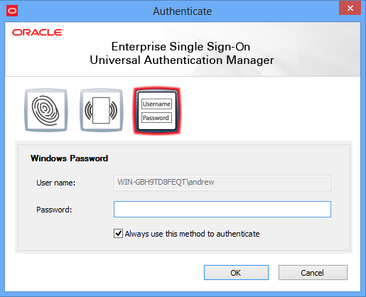

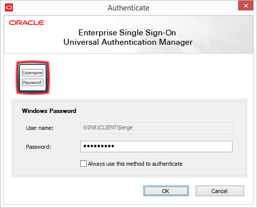

When authentication is required, you are prompted by the Universal Authentication Manager authentication screen. This screen may vary depending upon the logon methods you have enrolled and will reflect the logon method you last used to authenticate to Universal Authentication Manager. For example, if you last authenticated to Universal Authentication Manager with your Windows password, the screen will appear as follows:
Enter your Windows password or use another enrolled logon method to continue with authentication. After you have authenticated, you can continue working with Logon Manager.

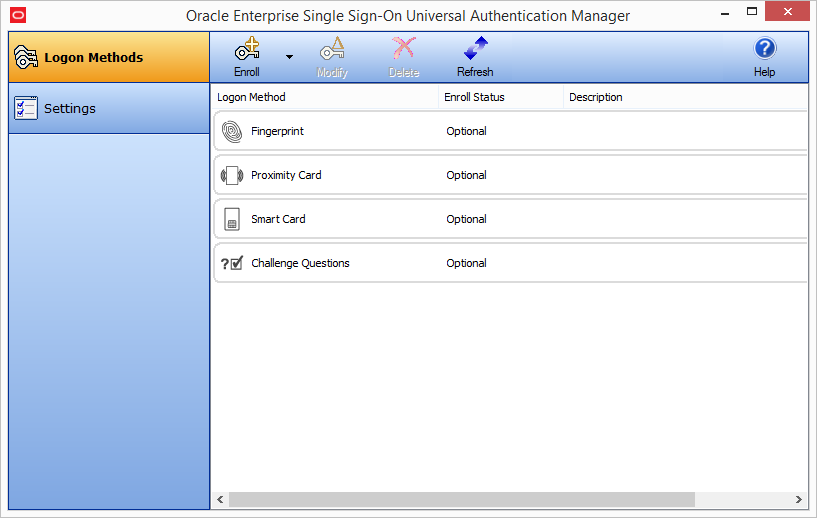

To start Universal Authentication Manager:
Click Start, then Programs.
Point to Oracle, then Universal Authentication Manager.
Click Universal Authentication Manager.
Universal Authentication Manager opens.

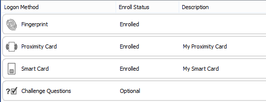

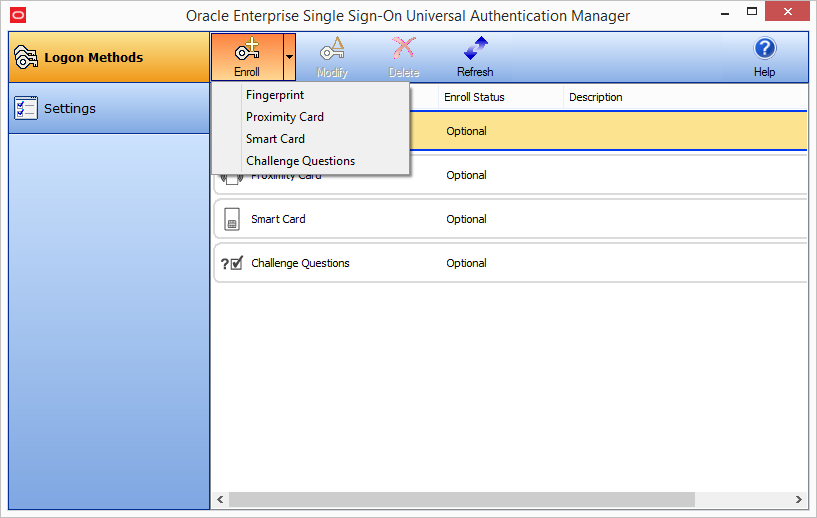

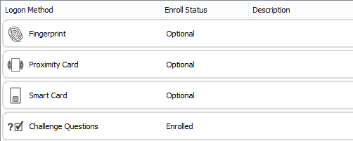

The Logon Methods panel displays the installed logon methods (authenticators) available to you, and allows you to enroll a logon method, as well as modify and delete existing enrollments. For faster access, the Enroll, Modify, and Delete controls are also available in a context menu accessible by right-clicking the desired logon method in the list. From this panel you can also do the following:
Changing Your Universal Authentication Manager PIN associated with a fingerprint, smart card, or proximity card.
Refreshing your account to synchronize changes made by your administrator.
Accessing the help system.
Your administrator has made available one or more of the following logon methods:
The controls on this panel are:
| Icon | Label | Purpose |
| Enroll | Enrolls a new credential. When you click Enroll, a drop-down list of available logon methods appears; from this menu, select the logon method you wish to use. | |

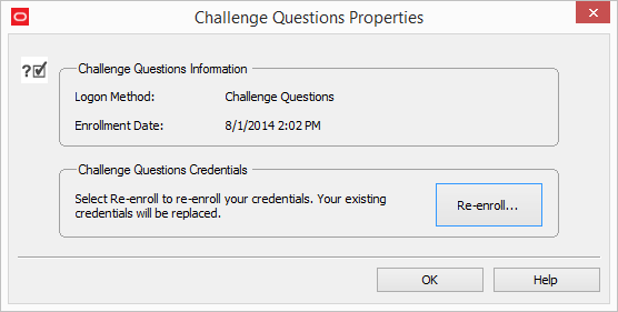

| Modify | Modifies the selected enrollment. For some enrollment methods, you can modify properties of your credential. For example, if you are authenticating with a proximity card that has an associated PIN code, click Modify to change your PIN. | |
| Delete | Deletes an enrolled credential. If you do not have permission to delete the enrolled credential, you will receive an error message stating so. | |
| Refresh | Synchronizes with the Universal Authentication Manager repository and updates any policy settings that were changed by your administrator (in Enterprise client mode). |

Credentials can be enrolled manually, or you may be prompted to enroll credentials during Windows logon, or upon launching the Universal Authentication Manager Client Application. Your administrator may also set a grace period for required enrollment.
Click one of the links below to see instructions for enrolling your selected logon method:

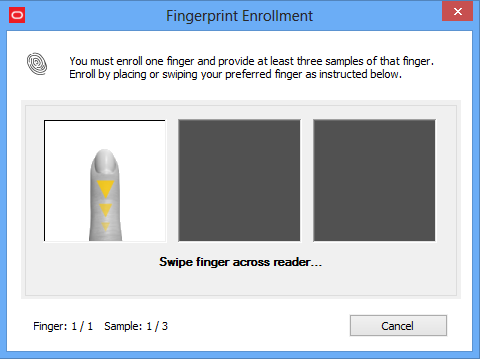

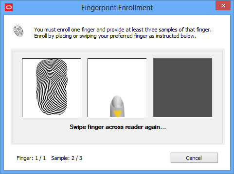

To enroll a Fingerprint, see:

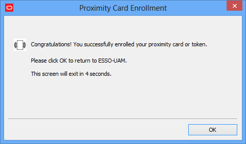

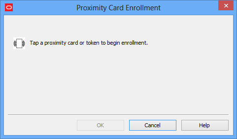

To enroll a Proximity Card, see:

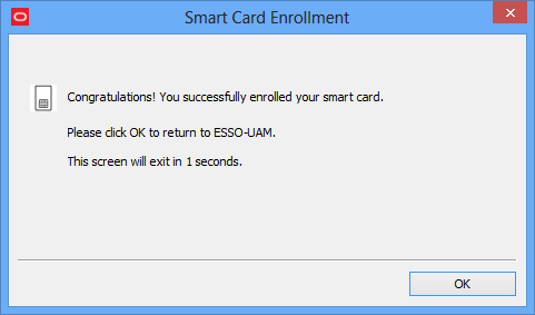

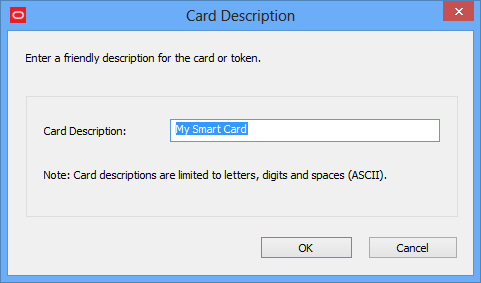

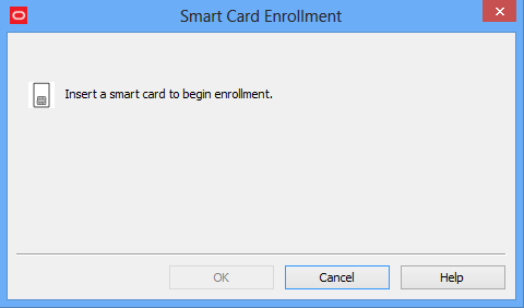

To enroll a Smart Card, see:

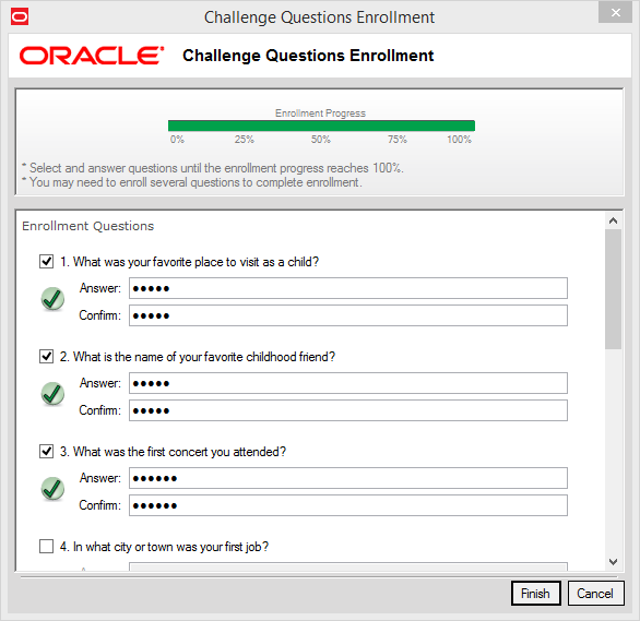

To enroll Challenge Questions, see:

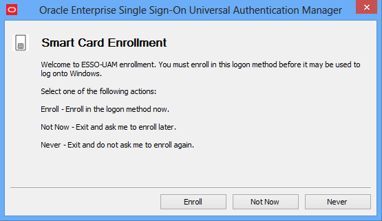

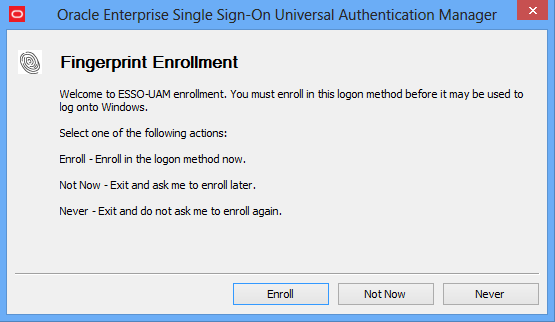

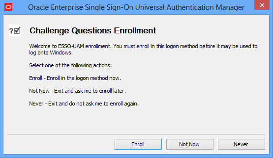

Enrollment can occur in one of the following ways:

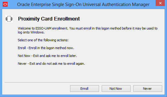

Prompted with a Grace Period
After Universal Authentication Manager is installed and you restart your machine, you will be prompted (by default) to enroll in one or more logon methods when you log on to Windows.
If multiple logon methods are installed, you will be consecutively prompted to enroll each logon method. You may choose one of the following options when prompted (depending on your configuration):
Enroll. Enroll in the logon method now.
Not Now. Skip this enrollment and ask me to enroll later.
Never. Exit and do not ask me to enroll again.
Your administrator may have set an enrollment grace period which allows you to defer a required enrollment for a configured number of days. If a grace period is set, the automatic enrollment screen informs you that your administrator requires you to eventually enroll this logon method before you can log on to Windows.
The Never option is not available.
If you click Not Now, a message appears stating how many days remain within the grace period.
You must enroll this logon method within the configured number of days. Once the Grace Period has ended, you will be required to enroll in this logon method before logging on to Windows.
If prompted enrollment is configured to optional or required with a grace period, you will be prompted to enroll when you launch the Universal Authentication Manager.
If you choose not to enroll a logon method when you log on to Windows, you can launch Universal Authentication Manager and manually enroll a logon method using one of the following enrollment procedures:
Click the Enroll button and choose a logon method from the drop-down list that appears.
Enter your Windows password (or authenticate with a previously enrolled logon method) when prompted. You are instructed to follow enrollment steps based on the type of authenticator you are using. For example, if you are enrolling a smart card as an authenticator, you are prompted after entering your Windows password to insert the smart card into the card reader and enter the PIN. A confirmation message then informs you that your card is enrolled.

When you log on to your workstation, you are automatically prompted to enroll installed logon methods. If one of those methods is Fingerprint, you will be prompted to enroll it.
Click Enroll to enroll a fingerprint.
If your system is configured to require a PIN with the fingerprint, enter and confirm a PIN.
Enroll at least one fingerprint sample. The number of fingerprint samples is configured by your administrator. Enroll by placing or swiping your preferred finger.
Swipe your finger on the reader again and repeat as many times as requested.

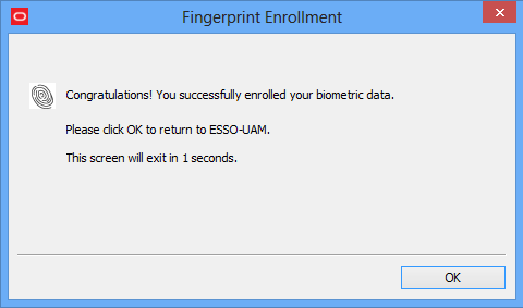

After all fingerprint samples have been enrolled, a message informs you that the data is processing. Wait until it completes.
When enrollment is complete, a message confirms that your biometric data is enrolled. Click OK to exit and resume log on to Windows. If other Universal Authentication Manager logon methods are installed, you may be prompted to enroll in additional methods.

Authenticate using a previously enrolled logon method or your Windows password.

When you log on to your workstation, you are automatically prompted to enroll installed logon methods. If one of those methods is a proximity card, you will be prompted to enroll it.
Click Enroll to enroll a proximity card.
Hold your card near the reader until Universal Authentication Manager detects it.
Enter a meaningful description for the proximity card and click OK.
If your system is configured to require a PIN with a proximity card, enter and confirm a PIN, then click OK.
When enrollment is complete, a message confirms that your card is enrolled. Click OK to exit and resume logon to Windows. If other logon methods are installed, you may be prompted to enroll in additional methods.
When you launch Universal Authentication Manager, you are automatically prompted to enroll installed logon methods. If one of those methods is a proximity card, you will be prompted to enroll it.
Click Enroll to enroll a proximity card. You are prompted to authenticate to continue. You can authenticate through any of the available authentication methods.
A message confirms that you have successfully enrolled your card. Click OK to return to Universal Authentication Manager.
The Enroll Status column shows a status of Enrolled.

Click Enroll in the Logon Methods toolbar and select Proximity Card from the drop-down list; or right-click in the highlighted proximity card row and select Enroll; or double click in the proximity card row.

If your system is configured to require a PIN with a proximity card, enter and confirm a PIN. (see detailed instructions in the previous section).

Click Enroll to enroll a smart card.
Insert your card into the reader.
Enter a meaningful description for your smart card, then click OK.

If the smart card logon method is configured to use the card's own PIN, enter the PIN and click OK.
If the smart card logon method is configured to use the Universal Authentication Manager PIN, enter and confirm a PIN of your choice, then click OK.

A message informs you that your card is being enrolled. When enrollment is complete, a message confirms that your card is enrolled. Click OK to exit and resume logon to Windows. If other Universal Authentication Manager logon methods are installed, you may be prompted to enroll in additional methods.
When you launch Universal Authentication Manager, you are automatically prompted to enroll installed logon methods (if they are not already enrolled). If one of those methods is a smart card, you will be prompted to enroll it.

A message informs you that your card is being enrolled. When enrollment is complete, a message confirms that your card is enrolled. Click OK to return to Universal Authentication Manager.

Click Enroll in the Logon Methods toolbar and select Smart Card from the drop-down list; or right-click in the highlighted smart card row and select Enroll; or double click in the smart card row.

When you log on to your workstation, you are automatically prompted to enroll installed logon methods. If one of those methods is a challenge questions quiz, you will be prompted to enroll it.
Click Enroll to begin the enrollment process.
Select the challenge questions you want to enroll, then enter and confirm your answers.If your entries do not match, the mismatch is indicated in red; re-enter each incorrect answer and its confirmation to correct the mismatch. When you have selected and answered enough questions to satisfy the weight requirements configured by the administrator, the progress bar at the top of the window will show 100%. At this point you can select additional questions to fall back on in case you forget the answers to your main questions. When you have selected and answered all of the desired questions, click Finish.

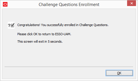

When enrollment is complete, a message confirms that the Challenge Questions method is now enrolled. Click OK to dismiss the dialog.

Click Logon Methods to view available logon methods. The second column in the row for each method indicates the status of user enrollment for that method. Possible values are:
Enrolled. You have successfully enrolled credentials for the logon method.
Optional. You may enroll credentials for the logon method, but is not required.
Required. You are required to enroll credentials for the logon method.
Not available. The detected card is enrolled by a different user. This only applies to smart card and proximity cards.
Disabled. The logon method is installed, but disabled.

For fingerprint, you can view your enrollment date and re-enroll. Your existing credentials will be replaced.
For challenge questions, you can view your enrollment date and re-enroll. Your existing credentials will be replaced.
When a smart card or proximity card is detected, Universal Authentication Manager displays a single row of information, including a status of either OPTIONAL or REQUIRED. When you enroll the first card or token, the enrolled credential will activate the existing row and display a status of ENROLLED.
If you have enrolled at least one card, and want to enroll an additional one, click the Enroll button and choose either Proximity Card or Smart Card from the drop-down list that appears. Universal Authentication Manager displays a message stating that you have already enrolled one card and asks you to confirm that you want to enroll another one.
Click OK to continue with enrollment or click Cancel to cancel enrollment. If you click OK, follow the on-screen instructions to enroll an additional card. You will be asked to tap or insert your card to begin enrollment and then asked to enter your PIN. When the card has been enrolled, Universal Authentication Manager displays a message confirming successful enrollment.
The Enroll Status column now shows two rows of card credentials, each with a status of Enrolled.
When the Fingerprint or Challenge Questions logon method is enrolled, Universal Authentication Manager displays a single row of information, including a status of either Optional or Required. When you enroll the first fingerprint samples, the enrolled credential will activate the existing row and display a status of Enrolled.
You cannot enroll additional credentials, but you can replace your existing ones by re-enrolling. If you have enrolled at least one fingerprint sample, and want to re-enroll, highlight the logon method and click Modify.
Select Re-enroll to re-enroll your credentials and follow the on-screen instructions to re-enroll. When re-enrollment is complete, Universal Authentication Manager displays a confirmation message.

Upon initial logon to Universal Authentication Manager, use your Windows Password (if this is an option). You can then launch the Universal Authentication Manager client and enroll credentials. Once enrolled, you can use an enrolled credential (for example, a smart card or fingerprint) to log on to Windows or to unlock your workstation in place of a Windows password.
If necessary-for example, if your card is lost or damaged-you can always fall back on using your Windows password or the Challenge Questions quiz for logon (if enabled).Universal Authentication Manager extends your system's normal Windows logon behavior. Microsoft Windows includes numerous security policies and settings that affect the Windows logon and unlock process; Universal Authentication Manager conforms with these policies. For example, if your password reaches the maximum password age, Universal Authentication Manager will still require you to change your password before you can log on.

The Fingerprint logon method must be manually selected from the logon dialog.
For example, to log on to or unlock Windows with an enrolled fingerprint:
At the logon screen, select or enter a user name (and domain, if required).
Click Sign-in options and select Fingerprint logon method.
Click the submit (right-arrow) button.
If you have enrolled a PIN, Universal Authentication Manager prompts you to enter it.
Universal Authentication Manager prompts you to present your fingerprint sample (for example, place or slide your finger on your reader).
Universal Authentication Manager validates the fingerprint sample and logs you on to Windows.
You can cancel this process at any time and return to the logon screen by clicking Cancel.

Unlike the Fingerprint and Challenge Questions logon methods, Smart Card and Proximity Card logons are event-driven by token insertion and removal.
If your smart card or proximity has already been inserted or registered by the reader, its respective icon will appear when you click Sign in options in the logon screen after selecting the desired user. Simply select the icon and click the Submit ("right-arrow") button to log on with the card.For example, to log on to or unlock Windows with an enrolled smart card or proximity card:
At the logon screen, insert or tap an enrolled card on the card reader. Universal Authentication Manager locates and validates the enrolled card and identifies you. If no PIN is required with your card, you are logged on to Windows.
If you click Sign-in options and select the smart card or proximity card icon, Universal Authentication Manager prompts you to tap or insert your card. (For proximity cards, hold your card near the reader until Universal Authentication Manager detects it.)
If a PIN is required with your card, enter your PIN when prompted. Universal Authentication Manager validates the PIN and logs you on to Windows.
You can cancel this process at any time and return to the logon dialog by clicking Cancel.

The Challenge Questions logon method must be manually selected from the logon dialog.
For example, to log on to or unlock Windows with Challenge Questions:
Click Sign-in options and select the Challenge Questions logon method.
In the dialog that appears, read the challenge question and provide your answer, then click Next. If you don't know the answer to the question and have enrolled extra questions to fall back on, click Skip. (If you have not enrolled extra questions, skipping a required question will result in a failed logon since you will not be able to satisfy the weight requirement set by the administrator.) When you have correctly answered enough questions to complete the logon, Universal Authentication Manager logs you on to Windows.
If working in Enterprise Client Mode, your Administrator may disable use of the Windows Password logon method through the Logon Method Enabled Rules. If Windows password is disabled, you will be able to continue using it until you enroll in at least one other logon method. Once you are enrolled in another logon method, you will no longer be able to log on with a Windows password.
The Universal Authentication Manager re-authentication dialog box provides the ability to authenticate to Windows within the currently active user session via available logon methods. You can select your logon method from the horizontal bar of icons, which from left to right represent: Fingerprint, Proximity Card, Smart Card, Challenge Questions, and Windows Password.
Each icon presents different controls in the dialog, for example selecting the password icon will show a password field, selecting the smart card icon will hide the password field and prompt you to insert a smart card.
Insertion of smart card and proximity card tokens triggers authentication immediately. However, if no cards are inserted, selecting the button for the appropriate logon method prompts you to insert a card or tap a token.
The reauthentication dialog box:
Filters out logon methods that are not installed, not registered, not enrolled, or that are disabled by the Logon Method Enabled policy.
Defaults to the last used logon method, so if Fingerprint is used to log on, it will be pre-selected at next logon.
The Always use this method to authenticate check box is always selected by default. This means that future authentications will default to the selected logon method and you will not see the Authenticate dialog box if not necessary.
If you deselect the checkbox and click OK, the re-authentication dialog box is always displayed, and the previously-used method is selected by default. This is useful for users who often switch between different logon methods.
