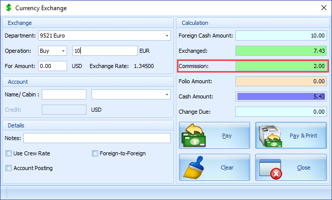

To exchange €10 and minimum commission is $2.00, the calculation formula is (€10/1.345) – $7.43 x 3% = $0.0223. Since the calculated value is below the amount specified, the system will post $2.00 as the applicable commission. Hence, the guest only receives $5.43.
Figure 2-3 Minimum Commission Charged
This figure shows the Minimum Commission Charged
