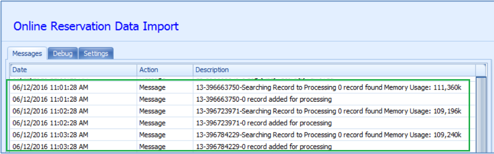

Refresh Interval
Figure 5–1 below shows the system constantly checks for new records to process every 60 seconds or per a defined interval time.
Figure 5-1 Sample Refresh Interval Messages

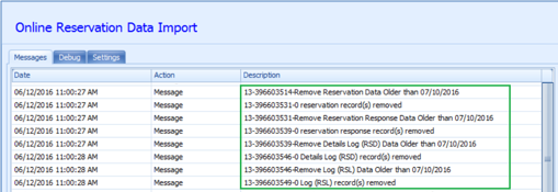

Delete reservation data older than 60 Days
In the Messages tab, data older than 60 days from the date of modification is removed.
Figure 5-2 Sample Deleted Reservation Message

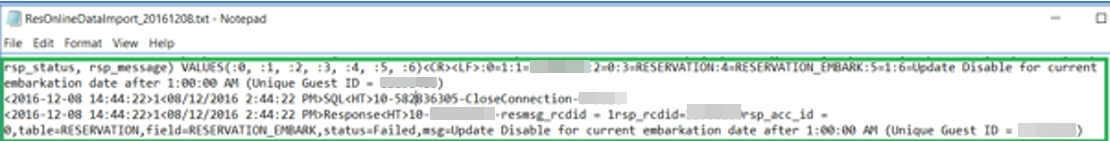

Stop update on embarkation day
A message “Update Disable for current embarkation date after x:xx:xx” is added to the ResOnline Data Import log file, when the Stop Update on Embarkation parameter is enabled or when a value is inserted into the field.
Figure 5-3 Sample Stop update on embarkation day message

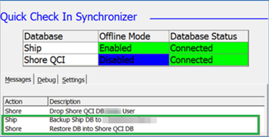

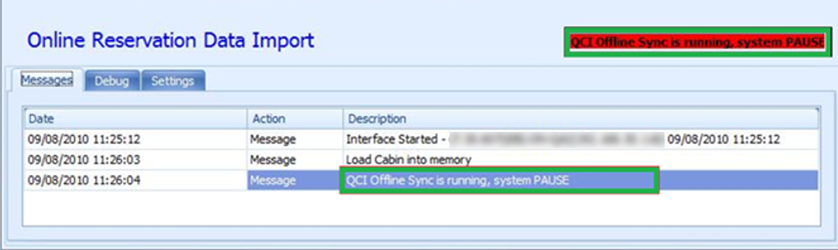

Stop process when QCI Offline Sync is enabled
This parameter backs up and restores the latest database to the QCI Shore Database when the parameter is enabled and the QCI Sync Interface is started.
At the point when Quick Check In Synchronizer Ship database mode is in an Enabled status in Offline Mode, the DGS ResOnline Interface status switches to a Pause and resumes when the Offline Mode is Disabled.
Figure 5-4 QCI Synchronization Status
Figure 5-5 DGS Pause Mode

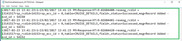

Do not import cruise (SCR), only import cruise details (SCD)
When this parameter is enabled, the system only imports the cruise details excluding the cruise date.
Figure 5-6 Sample Do Not Import Cruise Details Messages

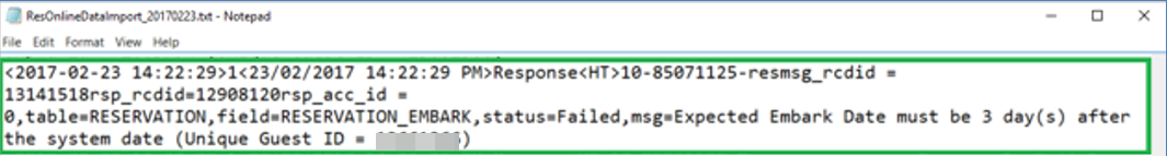

Stop Reservation Update x Days Before Embarkation
This parameter stops the import of reservation updates based on the number of days defined in the parameter and logs a fail message, ‘Expected Embark date must be x day(s) after the system date.’
For example, the number of days defined before embarkation is three and record with embark date less than or equal to three days after the system date are not imported
Figure 5-9 Sample mMessage on Stop Reservation Update x Days Before Embarkation

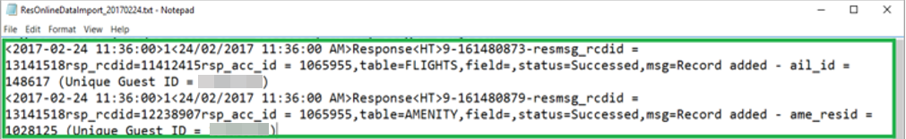

Allow Update Flights for Check-In Guest
This parameter disables users from adding, deleting or editing the flight information in the Management and Crew, Flight Information function, and sets it to view only. When the parameter is checked, importing of flight information including checked-in guest is allowed.
Figure 5-10 Sample Allow Update Flights for Check-In Guest

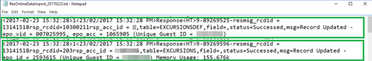

Only Update Cruise ID, Department, Net Price and Sales Price For Excursion/Ticket
The system only updates the cruise ID, department, net price, and sales price for excursion when the parameter is selected, and no other changes shall take place. The example below shows the price value has been updated.
Figure 5-12 Sample message of Update Cruise ID, Department ID, Net Price

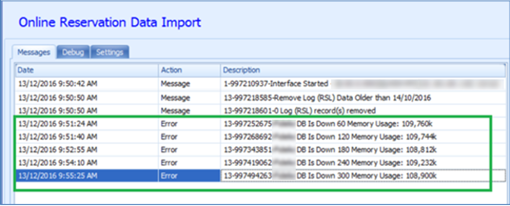

Connection Lost Retry 10 Times
When a connection is lost, the interface attempts to reconnect and display an error message ‘Error – DB is down’ in ResOnline Message tab after the 10th retries.
Figure 5-17 Sample message of Lost Connection Retry
Assuming the Refresh Interval is set at 60 seconds and the DB down time hits 300, this closes the application.
The application prompts a command prompt screen when it restarts and closes the command prompt screen after the application restarts completely.

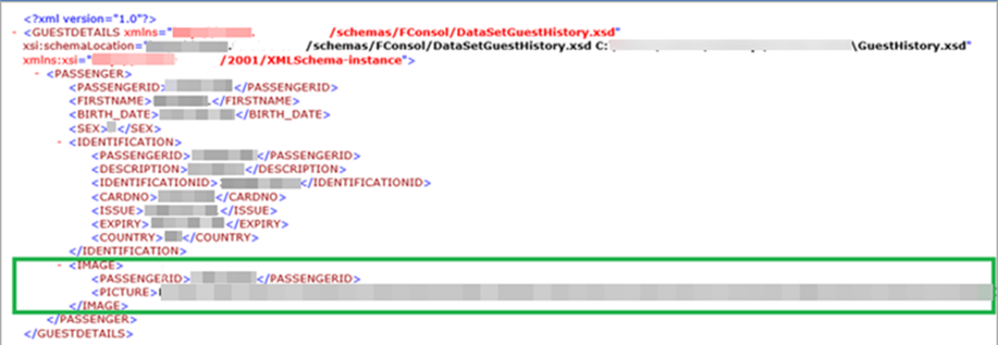

Guest Picture Import
The application supports importing a guest picture from an XML file, inserting the value into the MSSG_GUEST_HISTORY field, and stores the picture in the SEC table. The picture cannot be updated after the guest checks-in.
Figure 5-18 Sample picture string in XML file format
