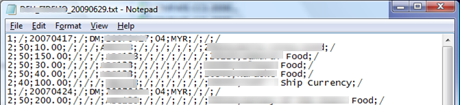

Delimann Sample Output File
The following is the sample output file. The fields are separated by a semicolon (;) and each record is fed by line feed. The file name is saved in “XXXX_Application_Date” format.
Figure 3-1 Sample Delimann Output File

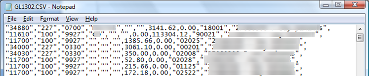

AIDA Sample Output File
The filename for this output format is in a Comma Separated Value (CSV) format and its columns are separated by a comma (,).
Figure 3-2 Sample AIDA Output File
