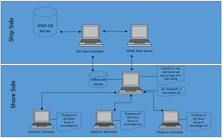

The diagram below illustrates the data flow for QCI Offline Check In environment at the Shore Side.
Figure 2-1 Environment Setup

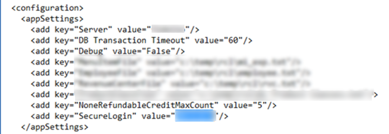

The server must be pre-installed with SPMS Web Service. Define the Ship WebService IP at SecureLogin, web.config file. This is to obtain the encryption password (OHCSecurity.par) from the ship’s web service when connected.
Figure 2-2 QCI Sync WebService Configuration
