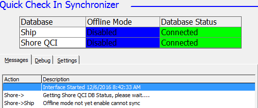

At the QCI Sync Interface PC, run the QCI Sync application.
Database Status shows: ‘Connected’
Offline Mode shows: ‘Disabled’
Messages shows: ‘Offline mode not yet enable cannot sync’
Figure 5-1 QCI Sync Offline Mode
