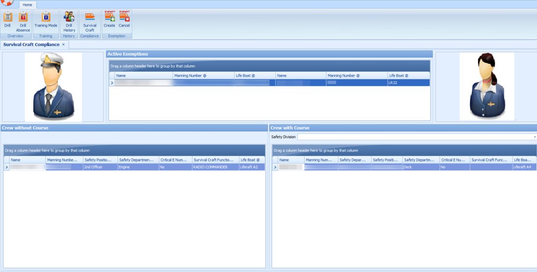

The Survival Craft Compliance functions are divided into three sections. The information displayed in each of the sections defines the task of the Crew.
Active Exemptions: Displays the Crew exempted from its role.
An Emergency# (E Number) is assigned in Muster List Assignment.
The Emergency# must have a Safety Function assigned.
The Safety Function must have Commander/2nd Commander enabled.
The Emergency# must have Medical Care (MCARE) course and certificate assigned.
The crew must not have an MCARE course and certificate assigned/expired.
Has an Emergency# (E Number) assigned in the Muster List Assignment.
The Emergency# (E Number) is not necessary to have a Safety Function assigned.
The Emergency# (E Number) is not necessary to have an MCARE course and certificate assigned.
The Commander/2nd Commander must be disabled in Safety Function.
The crew must have an active MCARE course and certificate assigned.

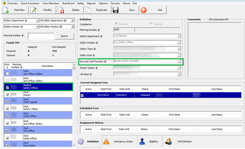

Figure 4-2 Survival Craft Function In Muster List Setup

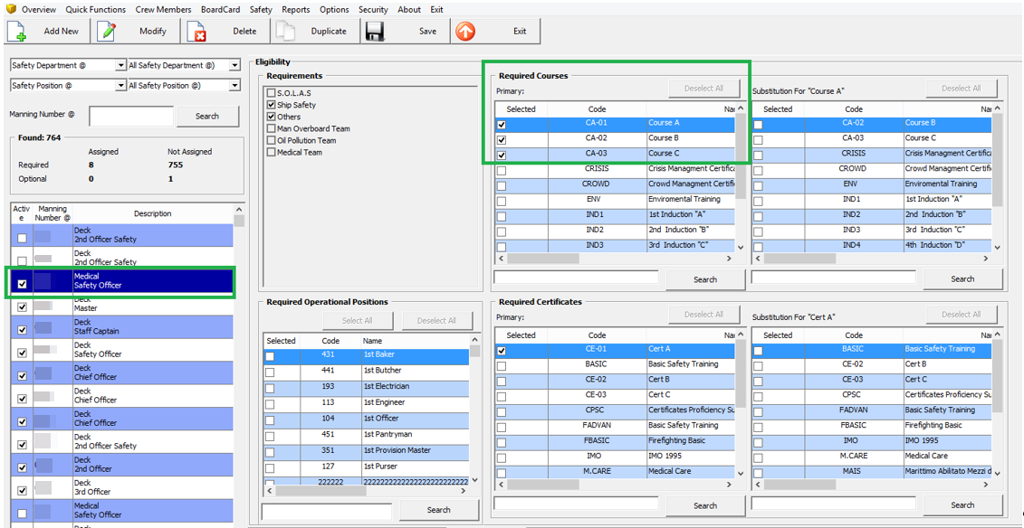

Figure 4-3 Required Courses Option in Muster List Setup

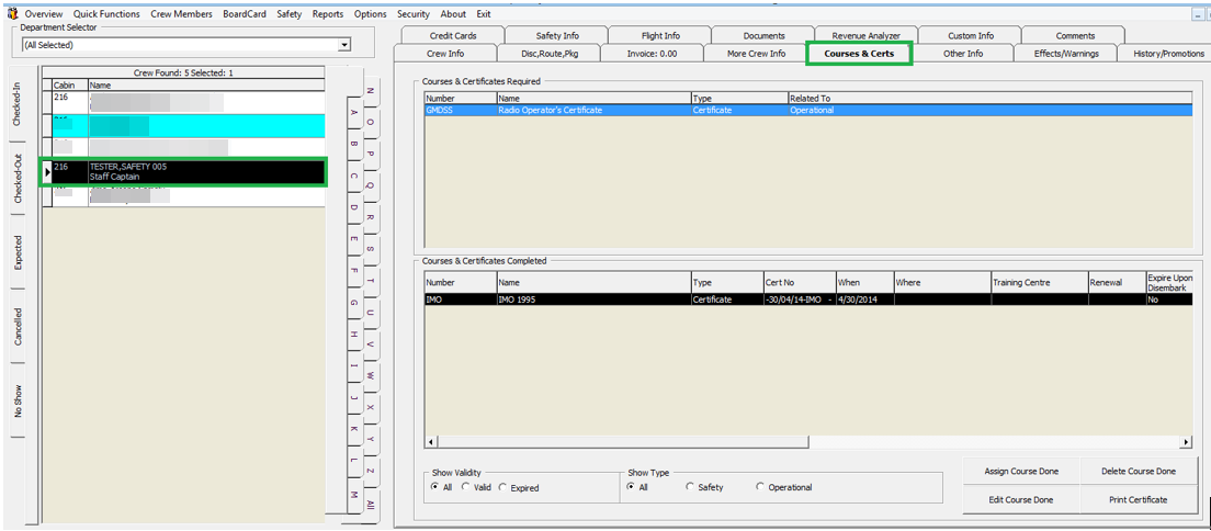

Figure 4-4 Crew with Course and Certificate In Crew Handling

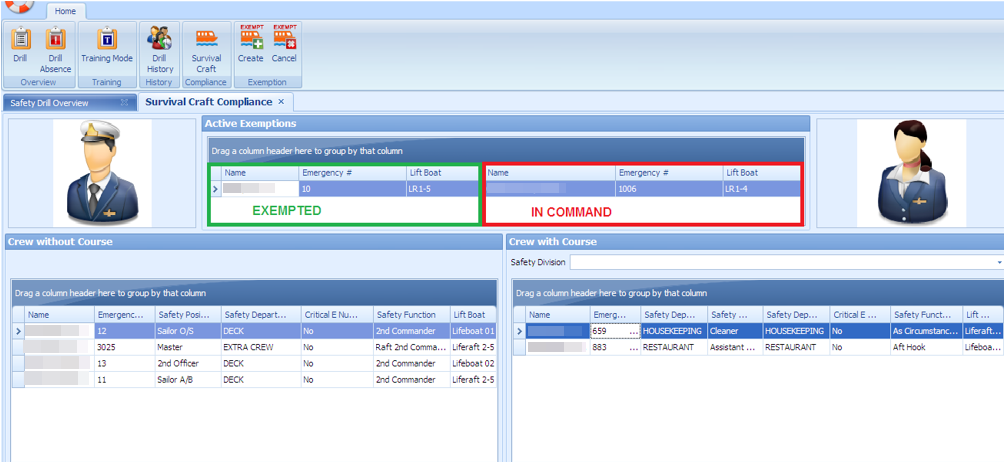

Creating an Exemption
Figure 4-5 Survival Craft Exemption

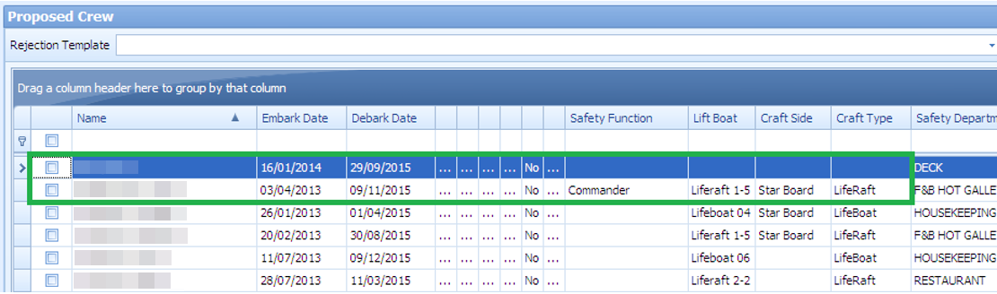

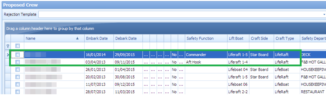

Figure 4-6 Proposed Crew List with Exemption
Select a crew from each section - Crew with Course and Crew without Course.
Click the Create Exemption button. The name of the exempted crew is now shown in Active Exemption as illustrated in the figure below. The information displayed in Safety Function, Lifeboat, Craft Type, and Craft Side in the Safety Drill Overview changes when an Exemption is created.

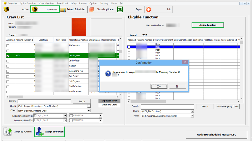

Changing the #E Number
You can only change the crew #E number when the crew is exempted from Survival Craft Compliance.
Figure 4-8 #E-Number Assignment
At the Crew module, select the Safety, Muster List Assignment from the drop-down list.
At the Muster List Assignment window, click the Schedule button from the menu bar and click the Assign by Person tab.
At the Crew List section, select the Crew name, and go to the Eligibility section.
Highlight the number and click the Assign Function button.
Click the Yes button at the confirmation prompt to change the #E Number or click No to exit without changing.
Click the Exit.

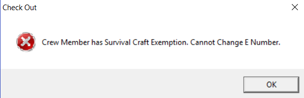

The system does not allow you to change the #E number from the Muster List Assignment for the crew that is exempted from Survival Craft Compliance. You must remove the exemption first before making any changes or you will receive an error prompts during check-out.
Figure 4-9 #E-Number Change Notification

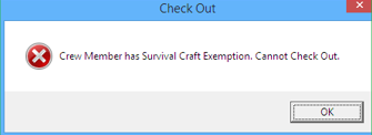

If a crew is exempted from the Survival Craft Compliance, you cannot check out the crew from Crew Handling without removing the exemption first. The crew is also not permitted to go ashore or onboard through the Gangway Security.
Figure 4-10 Notification of Survival Craft Exemption At Check Out
