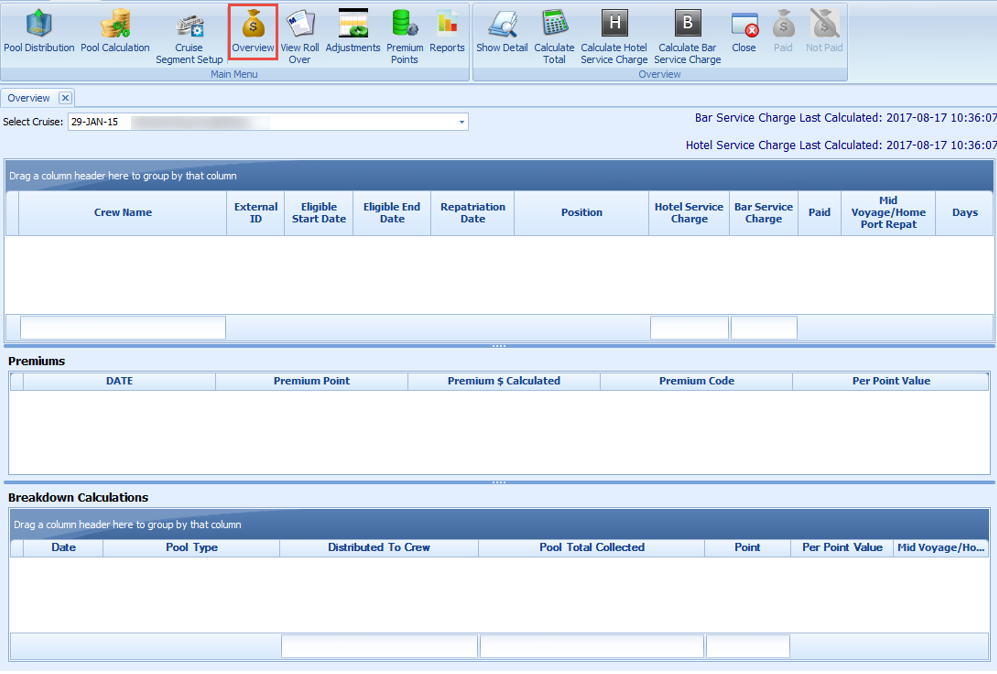

Click the Overview button to access the Service Charge Dashboard.
The Service Charge Dashboard window appears blank when you first open. Click Show Details to populate the information.
The window is divided into three (3) sections. The columns and width of these sections are adjustable by dragging the column divider.
If there are no HSC or BSC posting to the voyage at the time the Calculate Total button is first pressed, no crew members will appear in the list. The BSC list appears only when the BSC has been charged and not HSC or visa-versa.

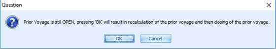

When the Calculate Total is clicked for the first time on a newly open voyage, the system automatically recalculates the previous open voyage for the final time, before closing the previous voyage and calculating the new voyage for the first time. After the previous voyage status is set to close, no further changes are allowed. Therefore, it is important to check and ensure the previous voyage that all the postings, premium points, and manual adjustments are complete.
Figure 3-2 Open Status of Prior Voyage

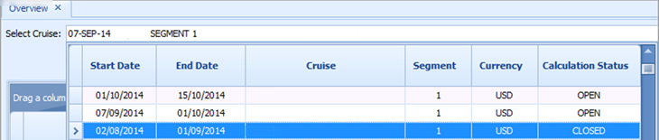

The date of the voyage status changes to Close becomes the Last Calculated date that appears in the Select Cruise drop-down list. Therefore, for reporting clarity it is best to maintain the last calculated date as the actual voyage or segment end date.
Figure 3-3 Segment Status

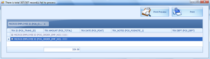

Similar to HSC, this function only calculates the BSC. The BSC calculations could fail when any of the following occurs:
MICROS charges posted with a MICROS employee number that is not assigned to any crew member.
MICROS number is assigned to a crew member whose eligibility is not within the date range of the voyage being processed.
The posting (POS_ORDER_EMP_NO) is not associated with any crew member ID (UXP_C_ORDER_EMP_NO) in the database.
Figure 3-4 BSC Record Failed to Process
Click the Print Preview button to preview the Failed to Process record in the report layout or print to the printer directly.
