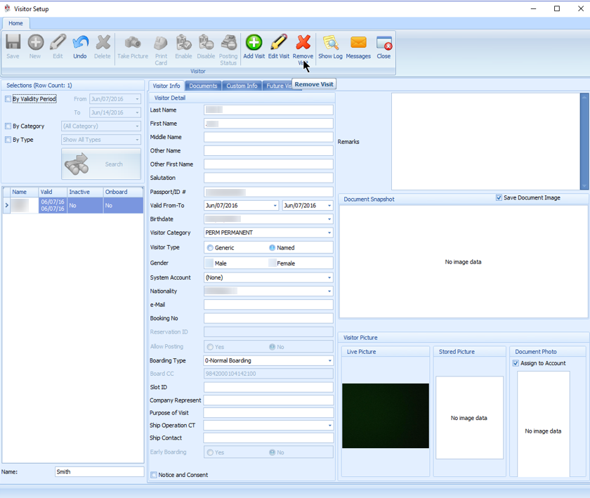

Visitor Registration
  1. At the WPF Security main window, click the Visitor icon on the Toolbar to open the Visitor Setup form.
  2. At Visitor Setup form, click New to add a new visitor record and fill in the details in the Info tab.
  3. At the ribbon bar, click Take Picture to capture a live picture. Ensure a camera is attached to the workstation and the device is correctly setup in Management, Option, Video Parameter.
  4. Click Swipe Passport on the ribbon bar to open the ATB Document Entry form, then scan the passport through the passport reader and click OK to save.
  5. Click Print Card to generate a visitor board card. This function starts the Batch Board Card Printing if the card fails to print.
  6. Select the Notice and Consent check box located next to the Bane Search field. If this check box is deselected, the system prompts a warning message and disallows you from proceeding.
  7. Click Save to save the visitor record.
Editing Visitor Record
  1. At the Visitor Setup window, search the visitor record using the filters or enter the last name in the name search field.
  2. Click Edit on the ribbon bar.
  3. Edit the necessary information and click Save to save the changes.

Adding Future Visits
Future visits can be added to visitors who visit the ship regularly.
  2. Click Edit at the ribbon bar.
  3. Navigate to the Future Visits tab and at the ribbon bar, click Add Visit.
  4. Select the visit date from the calendar and click OK to add.
  5. To edit, click the Edit Visit and select a new date.
  6. To remove, select the visit date from the grid and then click Remove Visit.
