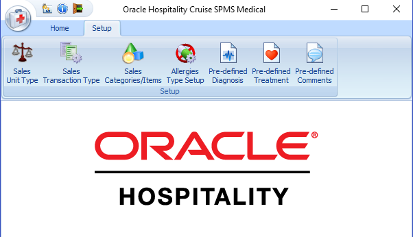

To access the Setup page, launch the Medical module and navigate to the Setup tab on the main page.
Figure 1-1 Medical Setup Main Page

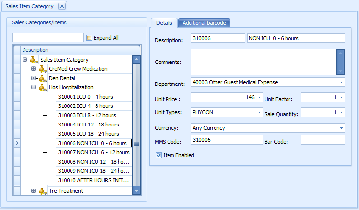

The Sales Categories/Items is a category that groups the sale items according to the diagnostic, treatment or supplies, for example, medicines, treatment, and laboratory test. You must create a category before you can create an item or add the item into a category
Setting up Sales Items
Once the Sales Categories is available, you can create the sales items with pricing and the sale quantity for the respective category.
Figure 1-3 Sales Categories/Items Configuration Form

On the Sales Category page, expand the tree view and select a category.
To create a new item, click Add New on the ribbon bar.
Enter the Description Code and Name in the description field.
Enter the item description in the comments field.
Select the Posting Code from the Department drop-down list.
Enter the Unit Price, Unit Factor, and theSale Quantity.
Select the Unit Types from the drop-down list.
If a currency is defined in the setup and the current onboard currency defers to, then the item code is not available for posting. For example, item currency is Euro and onboard currency is USD..Enter the MMS Code, if any.
Enter the barcode in the Barcode field or scan the code using a barcode scanner. The scanned barcode of the item is shown in the Additional barcode tab.
Click Save to save the record.
Repeat the steps above to add more Sales Items.
