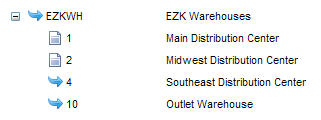

by default. A blue arrow (
2. Optionally, click the plus sign next to the organization to display each Location Type for the organization if they are not already displayed. Again, a blue arrow next to the location type name indicates if there are any rules assigned at any level within the location type.
3. Optionally, click the plus sign next to a location type to display each Location for the type if they are not already displayed. A blue arrow next to a location indicates if there are any rules assigned to that particular location.

A organization. Defaults from the organization associated with the Default Shipping System from your user profile, but you can override this default. |
A location. The location code is also displayed. Note: Rules assigned at the location level are eligible to be applied only if another activity, such as an inventory import, updates the product location. |
Rule assigned? A blue arrow ( Note: To refresh the display of the blue arrows based on your activity at this screen, close the Probable Quantity Location screen and re-enter. |
