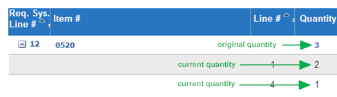

Quantity
Original quantity: If the line is split, the quantity displayed on the first line without a current line number is the quantity of the item that was originally assigned to the Fulfilling Location or Sourced Location. This quantity might differ from the quantity originally submitted to Order Broker if the Allow Split Line preference is selected, and the Routing Engine initially split the line across multiple fulfilling or sourcing locations. Also, the original quantity in Order Broker might subsequently be split across multiple order lines in Order Broker if the original fulfilling or sourcing location rejects the assignment and the Routing Engine splits the line when it reassigns it, or if a location submits a partial status update.
Current quantity: The quantity that is currently assigned to the fulfilling, sourcing, or pickup location. This quantity might be different from the original quantity if the Allow Split Line preference is selected, and the Routing Engine split the line across multiple fulfilling or sourcing locations after it was initially rejected by the first location, or if a location submits a partial status update.
Not split: If the line is not split, the original and current quantities are the same. If none of the lines on the order are split, then just a single quantity is displayed.

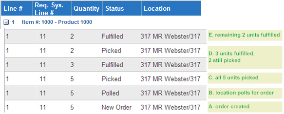

History tab
This tab displays the status history for each line on the order, created whenever a line is:
         created, or
         assigned or reassigned to a fulfilling or sourcing location, or
         when its status changes for any other reason, or
         when its shipping address is updated, or
         when there is an update to the Under Review indicator
         when a store associate closes an item on a ship-to-store order (the status changes to canceled)
         when the Pickup By Date is assigned, changed, or removed
         when the customer data is anonymized through the Completed Order Private Data Purge job or through the ForgetPrivateData web service request
The History tab lists records for each item in reverse chronological order (newest to oldest). A single transaction can create multiple history records if the transaction splits the line due to a partial status update or reassignment of a rejected order to multiple fulfilling locations. Optionally, you can collapse the history for an item by clicking the box next to the line number.
Note:  Status history and changes to the Under Review indicator are tracked at the line level even if the organization does not split orders or order lines.
Item #
The system product code and item description for the user’s Default Shipping System. If the user’s Default Shipping System is not in the organization associated with the order, the system product code and item description for the fulfilling or sourcing location is displayed. Up to 26 positions.
Line #
The current line number at the time the activity took place. This number might differ from the current line number if the Routing Engine split the line after initial creation in Order Broker because the original fulfilling location rejected it.
Which line number? The status history entry always lists the line number referenced in the status update request, even if the status update creates a new line number.
Example:  Line 10 currently includes 5 units in picked status. A partial status update indicates to change the status of 3 units on the line to fulfilled status. This update changes the quantity of line 10 to 2, and creates a new line, line 11, for 3 units in fulfilled status. However, both status history entries list line number 10, since that was the line number referenced in the status update request. The Routing Engine does not write a separate status history record for the creation of line 11.
Under Review update: An update to the Under Review indicator creates a history record for each line on the order.
Pickup By Date update: An update to the Pickup By Date creates a history record.
For more information: See the Line # for an example of how the Routing Engine might track the same order line using different line numbers.

Note:  When an order is rejected and it cannot be reassigned and, as a result, the Routing Engine changes its status to unfulfillable, 2 history records are written: 1 for the rejected status, and 1 for the unfulfillable status.
Under Review update: An update to the Under Review indicator creates a history record using the order-level status, even if the status of an individual line is different; however, this update does not affect the actual status of individual lines.
Example:  An order includes a line in polled status and a line in new order status, so the status of the order is open. You update the Under Review indicator for the order. The history record indicates a status of open on both lines, although the status of the polled and new order lines does not change.
