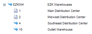

review the levels for rule assignment or review
1.      The organization associated with your Default Shipping System is selected by default. A blue arrow (rule_assigned_icon.png) next to the organization name indicates if there are any rules assigned at any level within the organization. Optionally, you can select a different organization.
2.      Optionally, click the plus sign next to the organization to display each Location Type for the organization if they are not already displayed. Again, a blue arrow next to the location type name indicates if there are any rules assigned at any level within the location type.
Note:             If the organization includes a location type that does not include any locations, the location type is not displayed.
The hierarchy may not be displayed correctly until you assign a default shipping system to the default admin user. See Assign the default shipping system to the default user for more information.
3.      Optionally, click the plus sign next to a location type to display each Location for the type if they are not already displayed. A blue arrow next to a location indicates if there are any rules assigned to that particular location.
Sort order: This screen sorts all displayed records in alphanumeric order within each organization. In other words, organizations are listed alphanumerically by name, as are location types within an organization, and locations within a location type. Since the sort is alphanumeric, numeric codes are listed before alphabetical codes; for example, location 123 is listed before location ABC.

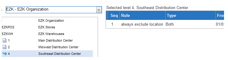

select location type or location for rule assignment or review, or select a different organization
Highlight the location type or location to display the rules that are currently assigned at that level, or select a different organization from the drop-down list.
Note that the currently selected location level is indicated above any assigned rules.

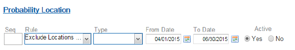

assign a probability rule
Use the navigational fields in the left-hand pane to select the organization, location type, or location where the rule should apply, as described above. You can assign a rule at only one level at a time; however, rules you set at the organization level or location type level apply to all lower levels, unless they are overridden by another rule at a lower level. See Probability Rule Overview for background.
Use the fields at the top of the screen to select the rule and optionally specify a date range or reset the Active flag.
Rule not displayed? If you create or update the name of a probability rule while the Probability Location screen is open, the new or renamed rule is not available for assignment until you close the Probability Location screen and reopen it.
1.      Enter a Seq (sequence number) to use for the rule assignment. Rules with the lowest sequence numbers are evaluated first, and when you add a new rule, Order Broker reassigns the sequence numbers.
2.      Select the Name of the rule you would like to assign from the drop-down list.
3.      Set the Type field to Off-line only, On-line only, or leave it set to Both to indicate whether the rule is conditional based on an interactive inventory update. See inventory level type for a discussion.
4.      Optionally, enter an From (Effective From Date) to have the rule become effective on that date.
5.      Optionally, enter an To (Effective To Date) in to have the rule no longer effective on that date.
Note:             You can specify an Effective From Date, an Effective To Date, both, or neither.
6.      Optionally, reset the Active flag if the rule should not be created in active status.
7.      Click Save to create the new rule assignment.
The sequence in which Order Broker should evaluate rules assigned at this level. A lower sequence number indicates to evaluate the rule earlier; that is, a rule with a sequence number of 10 is evaluated before one with a sequence number of 20. Optional entry.
Rule entries and sequence number assignments: Order Broker maintains sequence numbers that are multiples of 10, and resequences existing rules to accommodate your entries:
         First rule assignment: The first rule assignment takes sequence number 10.
         To create a new highest-priority rule: If you enter a sequence number lower than 10, the rule is assigned sequence number 10, and the existing rules are assigned higher sequence numbers that are multiples of 10. For example, if there were rules assigned sequence numbers 10 and 20, and you enter sequence number 1, the new rule is assigned sequence number 10 and the existing rules change to 20 and 30.
         To insert a rule into the existing hierarchy: If you enter a sequence number that is between 2 currently assigned numbers, the rule is assigned the next multiple of 10, and the higher rules are resequenced accordingly. For example, if you have rules assigned to sequence numbers 10 and 20, and you enter a sequence number of 15, the new rule is assigned sequence number 20 and the existing rule that was assigned sequence number 20 changes to sequence number 30.
         To add a rule a new lowest-priority rule: If you enter a sequence number that is higher than any currently assigned sequence number, the rule is assigned the next available multiple of 10. For example, if you have rules assigned sequence numbers 10, 20, and 30, and you enter a sequence number of 99, the new rule is assigned sequence number 40.
Note:  If you do not enter a sequence number, Order Broker assigns the rule to the next available multiple of 10. For example, if there is currently a rule assigned sequence number 20, Order Broker assigns the new rule sequence number 30.
         Updating a rule: When you update a rule assignment and enter a sequence number, Order Broker uses the same logic described above to determine the sequence number assignment; however, if the sequence number is blank when you update an existing rule assignment, the updated rule is reassigned sequence number 10, and the remaining rules are resequenced.
See Probability Rule Overview for more information on how Order Broker applies probability rules to product locations.
Name
The Name of the rule. You can select a rule by highlighting its name in the drop-down box. Required.
Type
Indicates whether to apply the rule to off-line product locations, on-line product locations, or both. Defaults to BOTH. Required. See inventory level type for a discussion.
The date when the rule becomes effective. Optional.
The first date when the rule is no longer effective. Optional.
Active
Indicates whether Order Broker should evaluate the rule or not to determine whether to apply it to a product location. Possible settings are:
         Yes: Order Broker should evaluate the rule and apply it if the product location qualifies.
         No: Order Broker should not evaluate the rule.

Rule assigned? A blue arrow (rule_assigned_icon.png) next to the organization, location type, or location indicates if there are any rules assigned at that level or below.
Note:  To refresh the display of the blue arrows based on your activity at this screen, close the Probability Location screen and re-enter.
Selected level
When you highlight an organization, location type, or location in the left-hand pane, the code and description are displayed in the center of the screen above any rules that apply to the selection.
