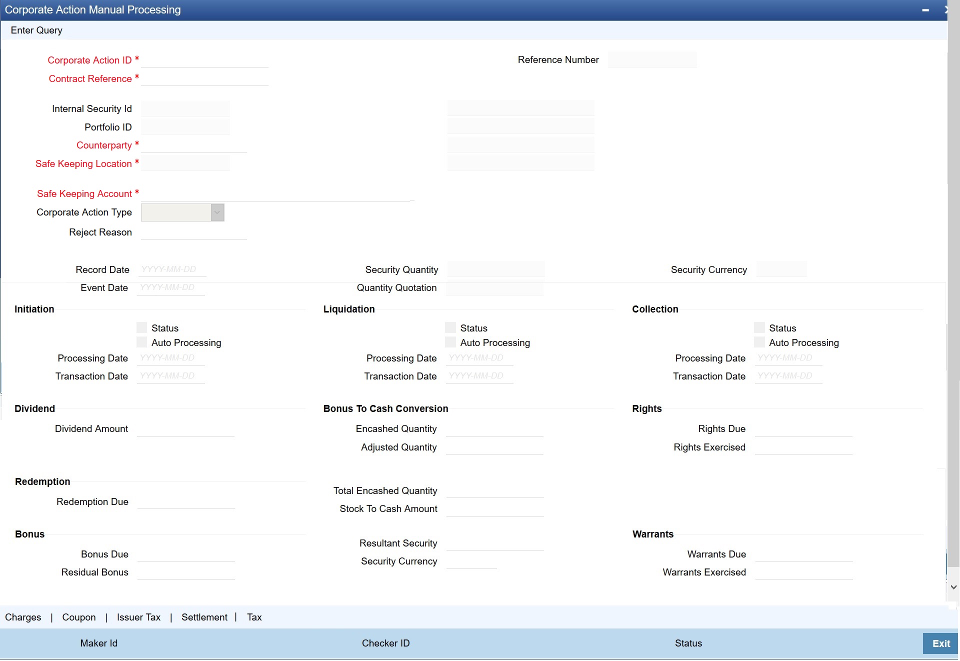

16)Process Corporate Action Events

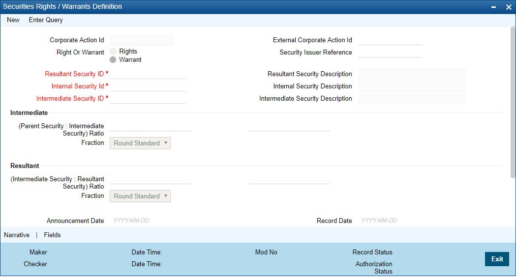

1.On Homescreen, specify SEDXRWDF in the text box, and click next arrow.
Step Result:   Securities Rights/Warrants Definition screen is displayed.
Figure 20.1: Securities Rights/Warrants Definition
2.On Securities Rights/Warrants screen, specify the fields.
If you are defining details of a new right or warrant, click on a new icon from the toolbar. The Rights and Warrants Corporate Action maintenance detailed screen will be displayed without any details. If you are calling a record that has already been created, click on the Summary view. The details of existing records will be displayed in a tabular form. Highlight the record you wish to view and double click on it. You can specify whether you are maintaining details for Rights or Warrants by clicking on the appropriate button.

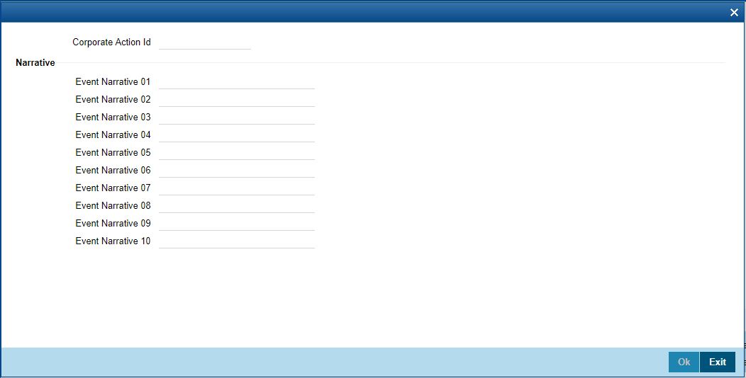

3.On Security Rights/Warranty Definition screen, click Narrative
Step Result:   Security Rights/Narrative Definition screen is displayed.
Figure 20.2: Security Rights/Narrative Definition
You have the option of entering a free format narrative for the rights/warrants event or leaving this screen blank. If you choose to define a narrative, it will be associated with the security of rights/warrants type, for which you have defined the event. You can also choose to leave this field blank.

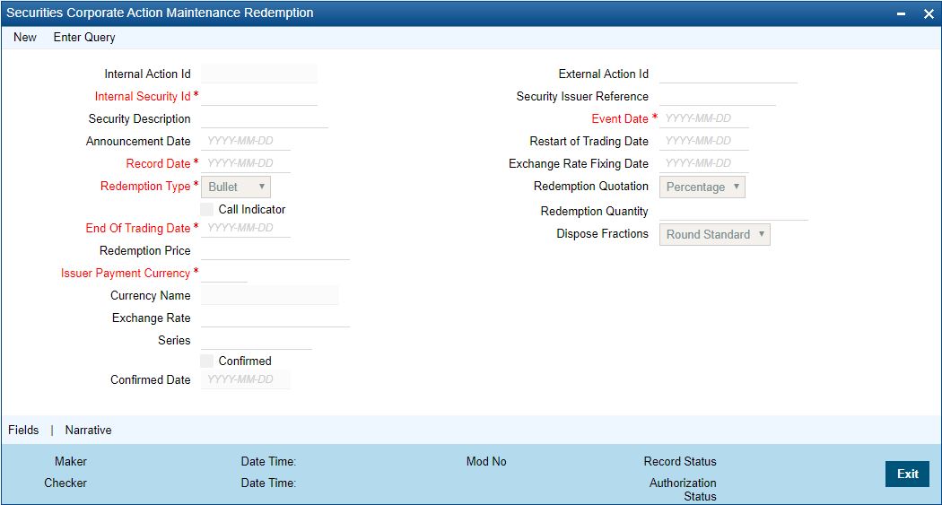

1.On Homescreen, specify SEDXREDF in the text box, and click next arrow.
Step Result:   Securities Corporate Action Maintenance Redemption screen is displayed.
Figure 20.4: Securities Corporate Action Maintenance Redemption
2.On Securities Corporate Action Maintenance Redemption screen, specify the fields.
If you are defining details of new redeemable security, click new icon from the toolbar. The Corporate Action Maintenance Redemption detailed screen will be displayed, without any details. If you are calling a redeem­able security record that has already been created, click on the Summary view. The details of existing records will be displayed in a tabular form. From the Summary, the screen chooses an existing record to open it.

20.11.2 Redemption Processing based on Quotation Type
If the redemption quotation type is ‘Factor’, then the redemption amount due for the intermediate redemption sched­ules will be calculated as follows: Redemption Amt = Holdings * (Redemption factor of previous period – Redemption factor of the current period) If the redemption quotation type is ‘Cash flow’, then the redemption amount due for the intermediate redemption schedules will be calculated as follows: Redemption Amt = Holdings * (Redemption price/Initial FV) For final redemption, the remaining holdings are redeemed. On running the YTM recalculation batch, the system recalculates the price of the redemption schedules based on the current coupon rate in case of coupon rate revision.
note: Batch processing is applicable only for securities under ‘Cash flow’ type of redemption quotation. Recal­culation is done only for the redemption schedules on or after the current coupon period.

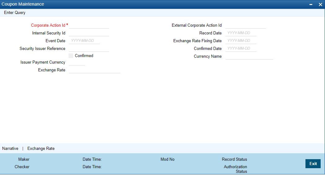

20.12.1 Process Interest Coupon Details
This topic contains the systematic instruction to process interest coupon Details.
Context:
The securities coupon definition screen allows capture of additional details of a coupon event, for the security of bond type. The details that are displayed in this field (such as the Internal action ID, the Internal Security ID and description, the event date, etc.) are picked up from the Security Definition screen. You are only allowed to amend existing details, like the currency in which the issuer would make the cash payments, the exchange rate between the security currency and the issuer payment currency and the date on which the exchange rate will be announced.
Prerequisite:
Specify User Id and Password, and login to Homescreen.
1.On Homescreen, specify SEDXCPND in the text box, and click next arrow.
Step Result:   Coupon Maintenance screen is displayed.
Figure 20.5: Coupon Maintenance
2.On Coupon Maintenance screen, specify the fields.
If you are calling a coupon maintenance record that has already been created, click on Summary view. The details of existing records will be displayed in a tabular form. From the
Summary highlight the record you wish to view details of and double click to open it. To amend the details of an existing coupon, click on unlock icon in the toolbar or choose Unlock from the Actions Menu.
note: You are allowed only to amend the details of future dated records that are not yet confirmed. Once a record is authorized and confirmed it will be processed as of the event date. You will not be allowed to make any changes to a confirmed record.
Exchange Rate and the Exchange Rate Fixing Date
If the issuer payment currency is different from the security currency, then you can specify the exchange rate between the security currency and the issuer payment currency. In addition, you can also indicate the date on which the exchange rate between the security currency and the issuer payment currency will be announced. The exchange rate that you define in this screen will be used for conversion when the security is being processed. If no exchange rate has been maintained, then the mid-rate will be used for conversion.

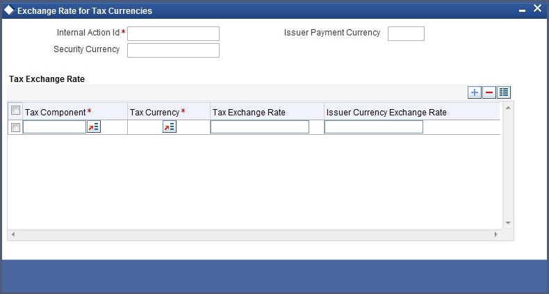

20.12.2 Link Interest Component to Tax Component
An interest component can be the basis amount tag of one or more tax components. Since each coupon that is main­tained can have several interest components you need to link each of these components to the tax components. The interest components can also be in a currency other than the tax currency. Therefore, in addition to linking an interest component with the tax component, you need to specify the tax currency. If the currency of the interest component is different from the tax currency, then specify the tax exchange rate. To link an interest component with a tax component and to specify the tax currency for the exchange rate, click ‘Exchange Rate’ in the Coupon Main­tenance screen. The Exchange Rate for Tax Currencies screen is displayed.
Figure 20.6: Exchange Rate for Tax Currencies
You also need to specify the exchange rate between the issuer payment currency and the tax currency. You can add or delete a tax component from the list of tax components maintained. To add a new component, click add icon and select the new component from the pick list. To delete an existing tax component, highlight it and click the delete icon.
20.12.3 Specify Event Narrative
You can maintain a free format message, of the coupon event. This narrative or message will be used while gener­ating SWIFT messages. Click ‘Narrative’ button, the Event narrative screen is displayed. In this screen, you can either enter a free format narrative for the coupon event or leave this screen blank. If a narrative is defined, it will be associated with the security of the bond type for which the coupon event has been defined.

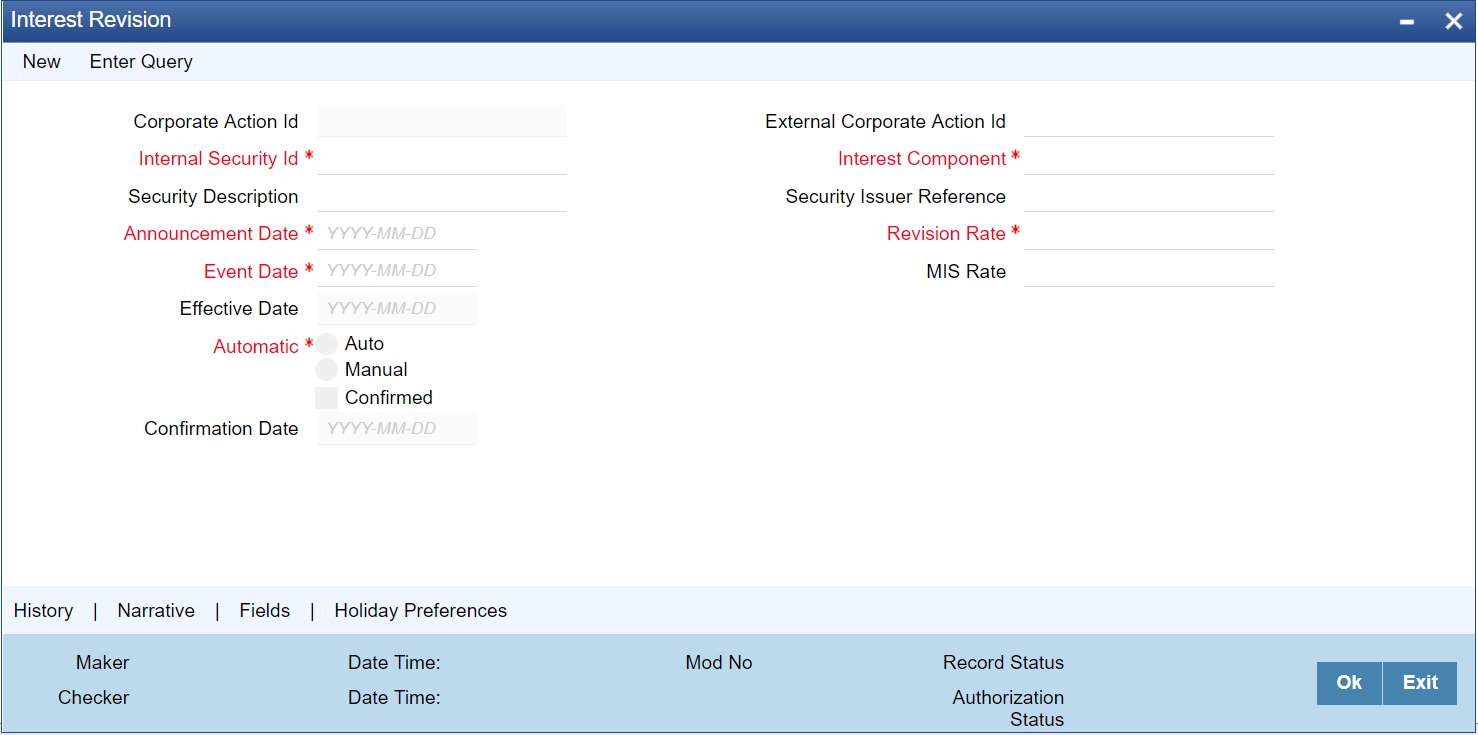

1.On Homescreen, specify SEDXRVND in the text box, and click next arrow.
Step Result:   Interest Revision screen is displayed
Figure 20.7: Interest Revision
2.On Interest Revision screen, specify the fields.
To enter interest rate remission details, click new icon on the toolbar. If you are calling an interest revision record that has already been created, click on Summary view. From the summary screen you can choose to open an existing record. The details of the record that you have created will be displayed in a tabular form.
note: Interest revision screen for a security id and effective date will have two records one for positive and another for negative interest component
For a positive interest component corresponding to a corporate action id, the system to allow input of negative revision rate for a manual corporate action record.
All operations in revision screen such as new, open, close, unlock, copy, and reopen should be allowed only in the Positive Interest component record and the Negative interest component should be meant for query only.
The system supports the auto propagation of details and records the status of the positive component to negative components automatically.
Interest Revision screen does not support the manual rate revision, and hence the RFR Interest compo­nents are not fetched.
Table 20.6: Interest Revision -Field Description
Field
Description
Corporate Action Identification
This is the system generated ID to uniquely identify the interest revision.
External Corporate Identification
This is the Id assigned to the event at the time of event declaration. Enter the Id associated with the event to uniquely identify it.
Issuer Reference
Indicate the issuer reference for the interest rate revision event.
Announcement Date
Enter the date on which the issuer would have declared the interest revision event.
Event Date
Each Rate Revision defined is having a event date from when it will be applicable. From this date the interest revision rate will be effective.
MIS Rate
For the Securities module you only have the option of maintaining a fixed rate for MIS refinancing.
Confirmed
Check this box to indicate if the occurrence of the event is confirmed.
Confirmation Date
When you select the check-box, and save the record the confirmation date will be defaulted with the current date.
Parent Security Identification
You have to indicate the code or ID of the bond type for which you are defining the interest revision rate. The Security ID or Code is picked up from the Security Definition screen. This short description of the security is for information purposes only and will not be printed on any
customer correspondence.
Interest Component
Specify the component of the security for which you are defining the interest revision rate. At the time of defining a security, you can maintain different interest components for the security. The interest component(s) maintained will be reflected in the pick list available for this field.
Effective Date
Each rate that is defined for a Security ID and Interest Component combination should have an Effective Date associated with it. This is the date from which the interest revision rate will be effective. Once a rate comes into effect, it will be applicable till another Effective Date is defined for the same Security ID and interest component combination. When you save a record the effective date gets defaulted with the Event Date of Rate Revision.
note: In Interest Revision screen, changes are done not to fetch RFR Interest components as no manual rate revision is supported.
20.13.2 Specify Auto or Manual Interest Revision
While specifying the interest revision rate, you can indicate whether the interest revision for the particular security is to be automatic or manual. If an automatic revision is specified, then revised rates will be applied and liquidations made as part of the Beginning of Day process. Otherwise, revisions will have to be made manually by you.
Revision Rate
The revision rate that you enter here will be effective as of the Value date defined.
20.13.2.1 Specify Event Narrative
You can also enter a free format narrative, of the interest rate revision event. This narrative or message will be used while generating SWIFT messages. Click the ‘Narrative’ button, the Event Narrative screen is displayed. The message entered will be associated with the interest revision event. This field can be left blank if necessary.

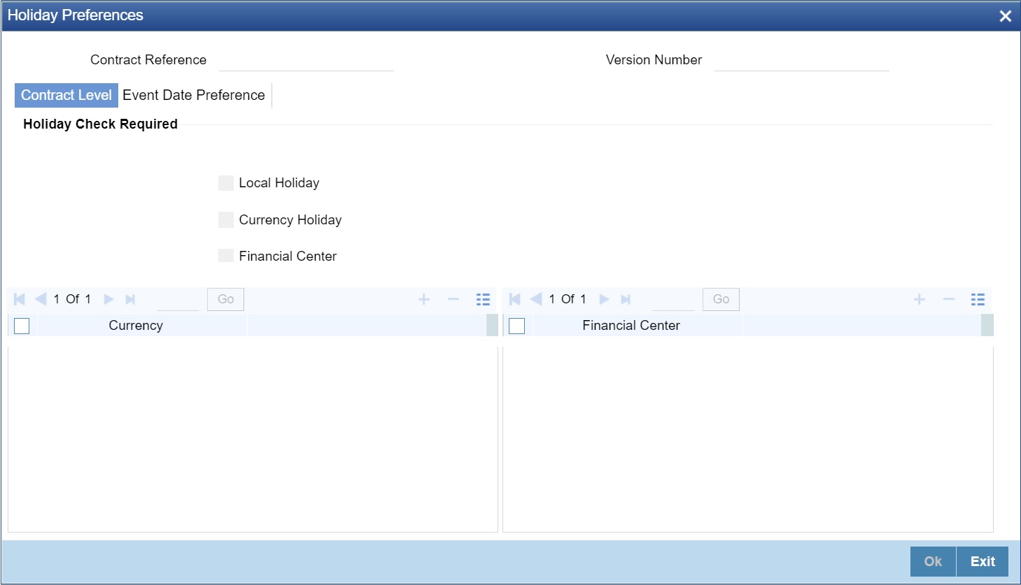

20.13.3 Holiday Preference
1.On the Interest Revision screen, click Holiday Preferences.
Step Result:   Holiday Preference screen is displayed.
Figure 20.8: Holiday Preference
2.On the Holiday Preference screen, specify the details as required.
For more information on holiday preference, see the section 19.13 Holiday Preference

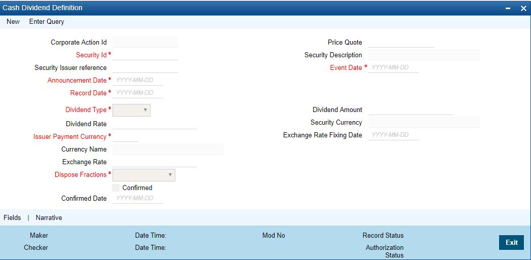

The details of a cash dividend declaration can be captured through the Cash Dividend Definition screen. Through this screen, you can capture relevant details such as the dividend type (rate or amount), the issuer payment currency, the exchange rate, and the rate-fixing date.
Context:
Prerequisite:
1.On Homescreen, specify SEDXCDVD in the text box, and click next arrow.
Click the new icon on the tool bar to create the icon.
Step Result:   Cash Dividend Definition screen is displayed.
Figure 20.10: Cash Dividend Definition
2.On Cash Dividend screen, specify the fields.
Table 20.9: Cash Dividend Definition - Field Description
Field
Description
This is the system generated ID to uniquely identify the declaration of Cash Dividend.
External Corporate Action Identification
This is the Id assigned to the event at the time of the event declaration. Enter the Id associated with the event to uniquely identify it.
Specify the security Id of the equity type for which the cash dividend event is to be defined.
The description associated with the specified code will be displayed in the adjacent field.
Security Issuer Reference
Indicate the issuer reference for the cash dividend event.
Announcement Date
This is the date on which the issuer would have declared the cash dividend event.
Enter the announcement date of the event.
Event Date
Enter the date on which the cash payment will be made by the issuer.
Record Date
Enter the date on which the issuer determines the beneficiary eligible for the dividend based on the registered owner of the securities. The Record Date is computed from the ex days set up defined for the local market of issue.
Dividend Type
Indicate the type in which the dividend amount should be declared. It could be a percentage of the face value of the security, or it could be the amount per unit of the security.
Dividend Amount
Indicates amount per unit.
Specify the amount per unit to be used in calculating the cash dividend.
Dividend Rate
This field indicates the rate as a percentage of the face value. Enter a percentage of the face value to be used in calculating the cash dividend.
Issuer Payment Currency
Indicate the currency in which the issuer will make the cash payment. Click the adjoining option list for a list of valid currency codes. Select the appropriate.
Dispose Fractions
Indicate how fractions should be handled. Refer Dispose Fractions Available Options for available options.
Confirmed
Check this box to indicate that the occurrence of the event is confirmed.
Confirmed Date
Select the check-box, and save the record the confirmed date will default with the current date.
Exchange Rate and Exchange Rate Fixing Date
When the issuer payment currency is different from the security currency, the exchange rate between the security currency and the payment currency has to be indicated. Along with this, the date on which the exchange rate will be announced should also be entered.

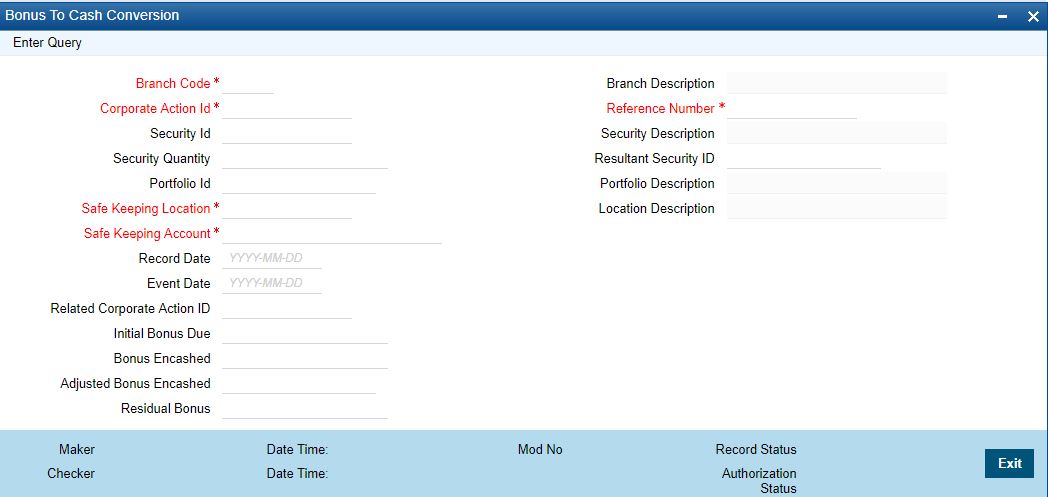

20.17.1 Process Bonus to Cash Conversion Details
This topic describes the systematic instructions to process bonus to conversion details.
Context:
When you specify that stock is to be converted to cash, in the Stock Dividend definition screen, details of that event will be picked up and stored as, a Bonus to Cash conversion record. You are only allowed to maintain some addi­tional stock to cash conversion details, such as the bonus to be en cashed, the total bonus en cashed, the residue bonus due. This is maintained so on in the Bonus to Cash conversion screen. Invoke this screen by clicking on Bonus to Cash and then on the Detail option, under Securities CA Maintenance. This is invoked from the Application Browser. To view the details of a previously created record, go to the Summary View screen. The details of existing records are displayed in a tabular form. Highlight the record you want to view and double click it.
Prerequisite:
1.On Homescreen, specify SEDXBNCS in the text box, and click next arrow.
Step Result:   Bonus to Cash Conversion screen is displayed.
Figure 20.11: Bonus to Cash Conversion
2.On Bonus to Conversion screen, specify the fields.
In the Bonus to Cash conversion, the main screen enters the security ID, the portfolio ID, and the SK location Id from where bonus due, is to be received.
Table 20.11: Bonus to Cash Conversion - Field Description
Field
Description
Branch Code
Specify the Branch Code
Corporate Action ID
This is the system generated ID to uniquely identify the declaration of Stock Dividend. This value is defaulted.
Reference Number
This is the system generated ID to uniquely identify the Corporate action of Stock to cash conversion.
Security Id
This is the security Id of the equity for which the bonus to cash details are being maintained.
The description associated with the specified code is displayed in the adjacent field.
Security Quantity
This is the quantity of security for which the bonus was declared.
Resultant Security Id
The resultant security Identification to which shares have been awarded is defaulted here.
Portfolio Id
This is the portfolio ID of the equity for which the bonus to cash conversion details are being defined.
Stock Keeping Location
This is the SK location where the security is lodged and for which cash payment is to be received.
Stock Keeping Account
This is the account number which is to be credited when the payment due is received.
Record Date
The record date is defaulted from the Stock Dividend definition screen.
Event Date
The event date is defaulted from the Stock Dividend definition screen.
Stock to Cash Action Id
The stock to cash action Id assigned in the Stock Dividend screen is defaulted in this screen.
Initial Bonus Due
This field indicates the bonus amount that is due to be paid.
Bonus Encashed
You can choose to convert either a part of or the entire bonus that is due. Specify the amount to be encashed, in the Bonus to be Encashed field. If you choose to encash only a part of the amount due, then the residue bonus will be automatically calculated and displayed, in the Residue Bonus Due field. Assume that you have a holding of 500 units in a particular security. Bonus is declared in the ratio of 2:1. Therefore, you are liable to get 250 units of shares free. If you indicate that bonus is to be encashed for 125 units only then the remaining 125 units, which need to be encashed, will be reflected in the Residual Bonus field. You can choose to encash them at a later date.
Adjusted Bonus Encashed
The adjusted bonus is calculated by the system and displayed in this field.
The calculations are such that, the net bonus encashed minus the adjusted bonus will be equal to the initial bonus.
Residual Bonus
If the bonus is encashed in parts then the residual amount due is displayed here.

1.On Homescreen, specify SEDXCAMN to the text box, and click next arrow.
Step Result:   Corporate Action Manual Processing screen is displayed.
Figure 20.12: Corporate Action Manual Processing
2.On Corporate Action Manual Processing screen, specify the fields.
The Corporate Action Manual Processing screen, allows you to amend existing details such as the processing date. You can also change the processing from automatic to manual or vice versa. To amend the details of an existing event, click on unlock in the toolbar or Unlock from the Actions Menu.
Counterparty Id will fetch the coupon from Repo counterparty. The Counterparty for Collateral portfolio is for repo counterparty and for bank portfolio will be issuer/External SK CIF.
To the right of the Corporate Action Manual Processing, the screen are displayed a vertical array of six icons. By invoking these icons, you will be able to view and in case of charges and tax modify the attributes, of the event you are processing. To select a screen, click on an icon from the group of icons displayed at the right-hand side of the screen. A brief description of the functions icons represent, the given below:
Table 20.12: Icons
Icons
Description
Events
Click on this button to view the leg events accounting entries and overrides.
Settlement
Click on this button to enter the settlement message details. You can specify the following details:
The accounts to be debited for charges The method in which the event is to be settled whether it is an instrument (as in a check or a demand draft) or a message (as in SWIFT or mail message). Details about the parties involved in the event.
Charge
Click on this button to view the charge details associated with the product. You are allowed to amend the charge amount and if necessary waive the application. You are allowed to make these changes, only at the time of processing the event.
Tax
Click on this button to view the transaction tax details. In addition to changing the charge amount, you can also waive the application. You are allowed to make these changes, only at the time of processing the
event.
Issuer Tax
Click on this button to view the issuer tax details. This is only a view screen, you are not allowed to modify the details displayed in this screen. You can view the issuer tax details only in case of coupon dividend or bonus to cash conversion events.
Coupon
Click on this icon to view the coupon details. This is a view-only screen, you are not allowed to modify any details displayed here. The coupon events are displayed only for a corporate action event coupon.
Counterparty Coupon Details
Click this icon to view the Counterparty Coupon Details. This screen displays the counterparty wise coupon details. Bank claims the coupon from Repo counterparty for the pledged security. The same details are shown in this screen to view Counterparty wise coupon details for a Corporate action ID

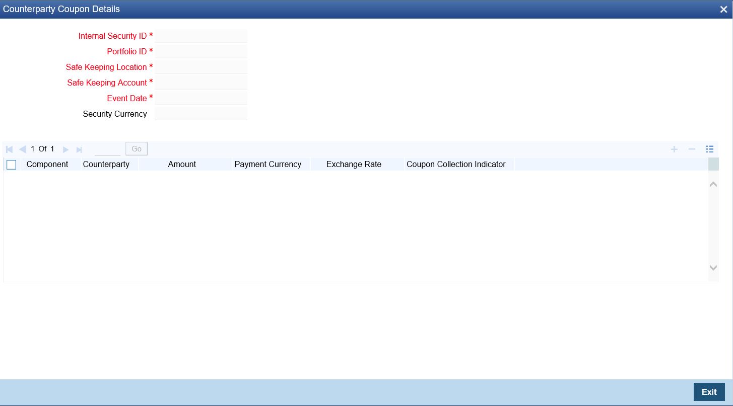

3.On the Corporate Action Manual Processing screen, click Counterparty Coupon Details.
Step Result:   Counterparty Coupon Details screen is displayed.
Figure 20.13: Counterparty Coupon Details
4.On the Counterparty Coupon Details screen, specify the details as required.
For more information on fields, see the below table
Table 20.13: Counterparty Coupon Details
Field
Description
Component
System will default the Interest Component for the coupon.
Counterparty
System defaults Repo Counterparty to whom security is pledged and bank will claim the coupon.
Amount
System shows the Coupon amount to be claimed from the Repo Counterparty.
Payment currency
Currency in which coupon is paid.
Exchange rate
System defaults Currency exchange rate.
Coupon Collection Indicator
Indicates whether bank has collected the coupon from the counterparty or not. system updates the field as processed after the coupon is collected

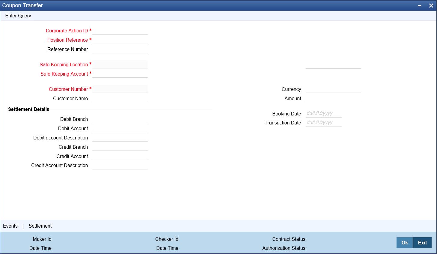

1.On the Homepage, type SEDXCTFR in the text box, and click the next arrow.
Step Result:   Coupon Transfer screen is displayed.
Figure 20.14: Coupon Transfer
2.On the Coupon Transfer screen, refer to the details as required.
   On selecting Corporate action ID, Position Reference number and Counterparty Coupon amount collected in collateral portfolio for the coupon schedule is default in amount field.
20.20 Coupon Transfer - Field Description
Field
Description
Corporate Action ID
   Corporate Action ID of the security code
Position Reference
Collateral portfolio Position reference number
Reference Number
Generated by system on a successful save of record
Safe Keeping Location
ID of the safekeeping location
Safe Keeping Account
   Default Safekeeping Account that the holder of the collateral portfolio maintained.
Customer Number
   Lists Reverse Repo Counterparty number
Customer Name
Defaults Reverse Repo Counterparty name
Currency
Defaults Coupon Currency
Amount
   System defaults Coupon amount that bank transfers to the counterparty
Settlement Details
Debit Branch
   Defaults Debit account branch
Debit Account
   Defaults Debit account from which coupon amount is paid
Debit account Description
Default account description
Credit Branch
   Defaults Credit account branch
Credit Account
Defaults Counterparty account where coupon amount is transferred
Credit Account Description
Default Account Description is displayed in this field
Booking Date
Date when Coupon transfer is booked
Transaction Date
Date when the settlement happens
