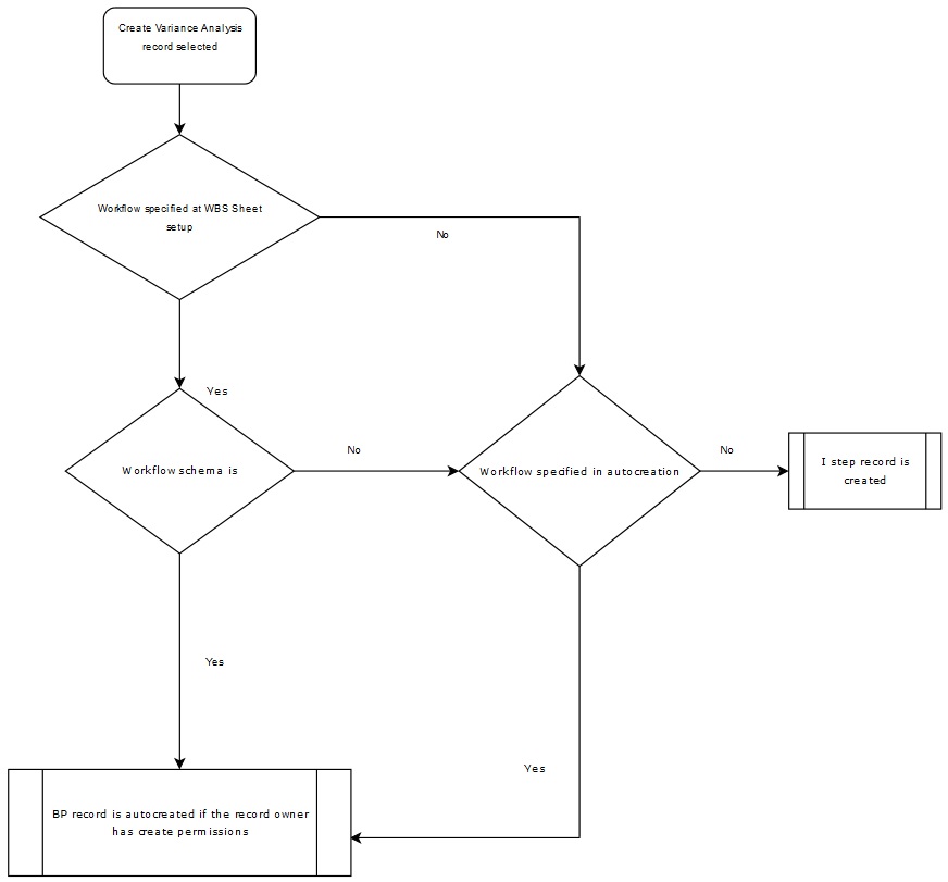

During the Business Process (BP) setup, the administrator can set up the auto-created workflow BP to skip the Initiation step and send the record directly into the workflow, where it normally arrives at the first step after the Create step (or the first step in a conditional routing).
Workflow BP
For a workflow BP, the administrator specifies the workflow schema to use, the step in the workflow that the record should use as its first step, the workflow duration, and the name of the person or group who will be the owner of the auto-created record. When the record is created, data will roll up to any applicable manager sheets (for example, the cost sheet) at the appropriate status; however, if the system encounters errors or invalid data, the record will remain at the Create step, and roll-ups will not occur until the user resolves the errors.

For Workflow BP, when By Pass I-step selected, the following process takes place:
