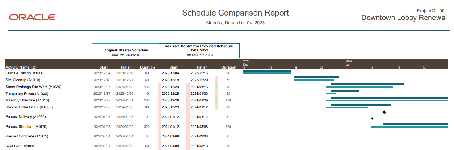

A new Schedule Comparison custom report has been added. Two Activity Sheets with common activity ID numbers may be selected and compared. Columns display start date, finish date, and duration for each activity, along with a color-coded Gantt chart.
Implementation Note: This enhancement is included in Configuration Package. An administrator will need to update the Project/Shell navigator and grant permissions for the report.
Image of a schedule comparison setup screen, where the master schedule is being compared to a contractor provided schedule.
Image of a schedule comparison report, showing a Gantt chart with different-colored lines representing the original master schedule and the revised contractor-provided schedule.

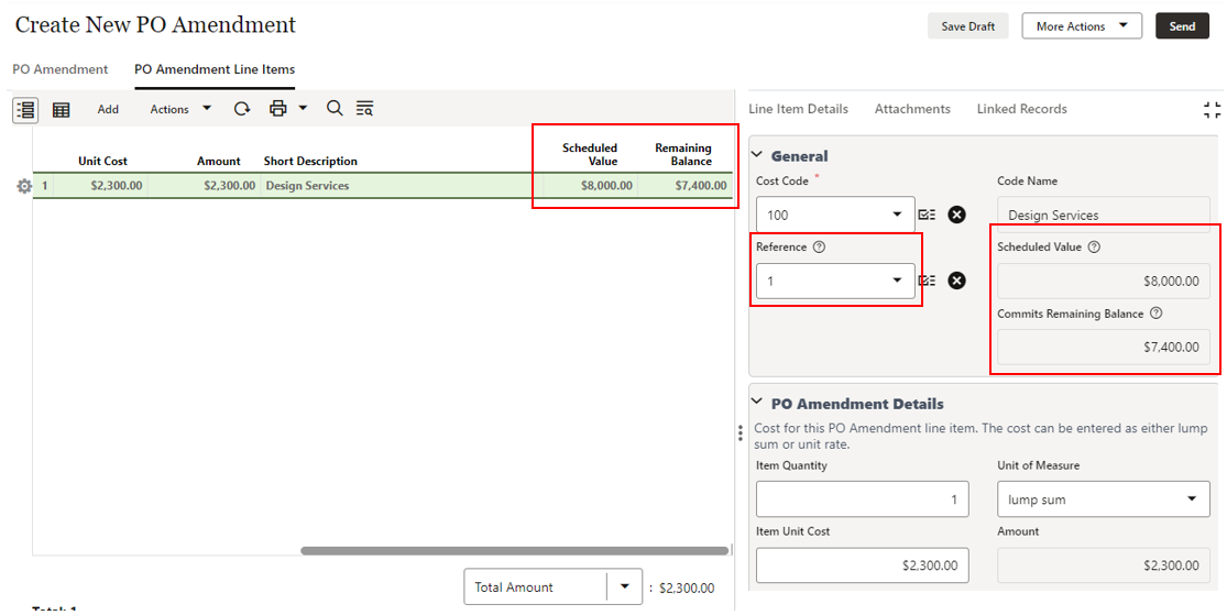

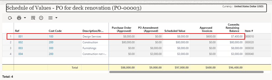

Scheduled Value and Commits Remaining Balance fields have been added to PO Amendment line items. Values auto-populate from the Purchase Order Schedule of Values when a reference row is selected.
Implementation Note: This change is included in the Configuration Package; no additional changes are required by the customer. Existing records will not be updated with the auto-populated data.
Image of a new PO amendment creation screen's line items tab, showing both scheduled value and commits remaining balance.
Image of the Schedule of Values for a project, showing columns for both the new scheduled values and commits remaining balance fields.

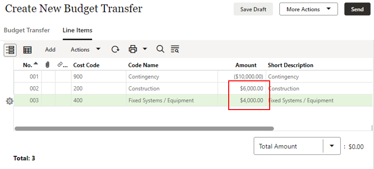

A Transferred Amount field has been added to the Budget Transfer business process form and BP log. A Budget Transfer record will always be a net zero transaction with a total amount of zero. The Transferred Amount is one side of the total transaction to show the significance of the transfer.
Image of line items in a new budget transfer record, showing two amounts totaling $10,000.

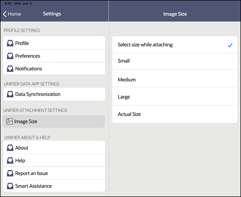

The Unifier Attachments Settings panel is added to the mobile app, providing users with the ability set an image size for all attachments or specify the size each time they add an image. Sizing choices include Small, Medium, Large, and Actual Size.
Image of an iOS screen, showing the new setting panel which allows users to select image sizes while attaching or pick one of four sizes for all future attachments.
