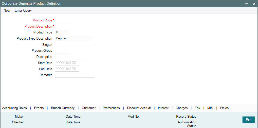

The corporate deposit product defined in the FCUBS, that is ‘Corporate Deposits Product Definition’ (CDDPRMNT) screen is sent to OBCL.

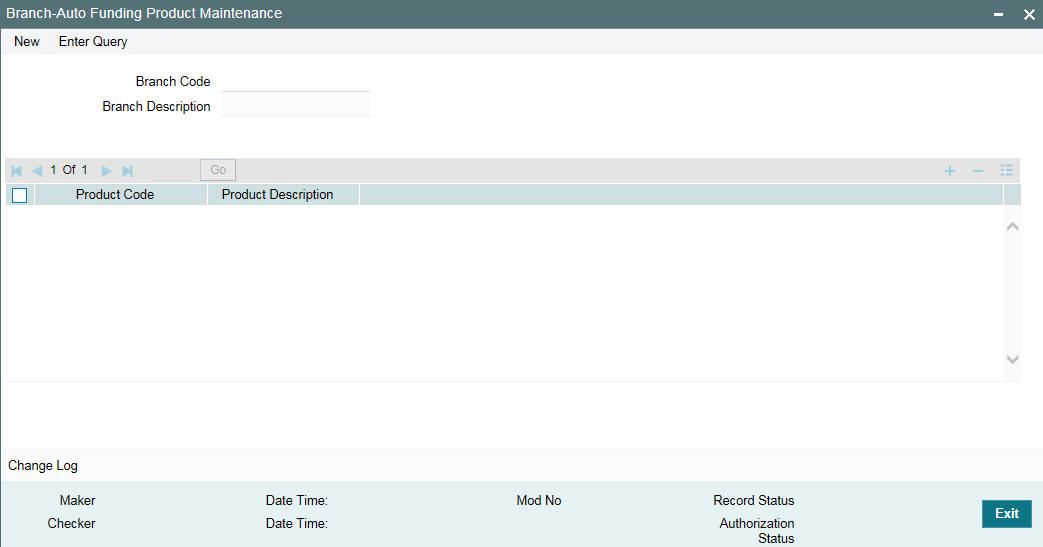

You can use this screen for mapping a branch to corporate deposits products.
You can invoke the ‘Branch Auto Funding’ screen by typing ‘OLDBRAFP’ in the field at the top right corner of the Application tool bar and clicking the adjoining arrow button.
You can use this screen, to select the OL product that can use the loan deposit product.

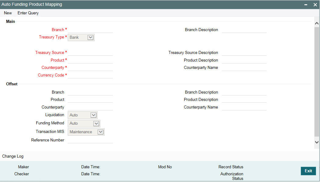

You can invoke the ‘Auto Fund Product’ screen by typing ‘OLDAFMAP’ in the field at the top right corner of the Application tool bar and clicking the adjoining arrow button.
You need to enter the 'Branch', ‘Treasury Type’, 'Treasury Source', 'Product', 'Counterparty' and 'Currency Code'. Based on these loan contract parameters, the following deposit parameters are derived.
Counterparty field allows you to maintain different deposit parameters for a specific counterparty of the loan.
During auto-funding, the system follows the below priority order to derive the deposit parameters. This is done irrespective of the 'Treasury Type'.
 | Branch | Treasury Source | Product | Currency | Counterparty |
| Priority 1 | Specific | Specific | Specific | Specific | Specific |
| Priority 2 | Specific | Specific | Specific | Specific | ALL |
| Priority 3 | ALL | Specific | Specific | Specific | ALL |
Below is an example of auto-funding mapping maintenance.
| Loan Contract Parameter | Value |
| Branch | 567 |
| Treasury Source | TREASURY |
| Product | RES1 |
| Currency | USD |
| Counterparty | 000000321 |
| Deposit Contract Parameter | Value |
| Branch | 567 |
| Product | CL04 |
| Currency | USD |
| Counterparty | 000000323 |

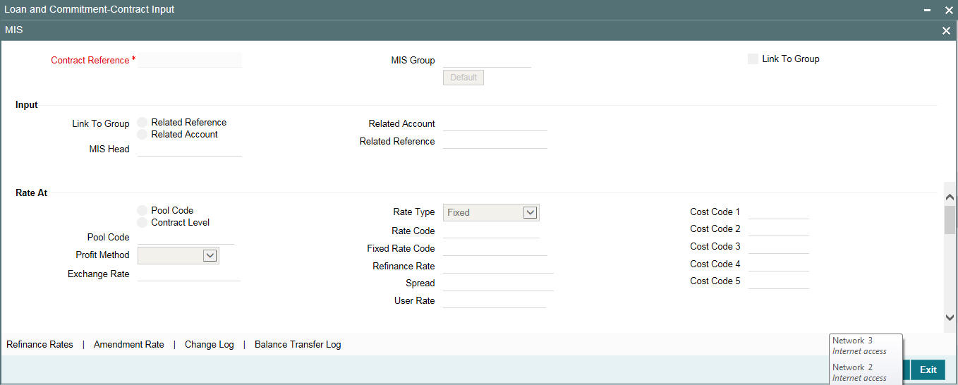

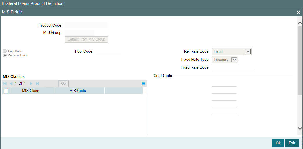

You need to maintain ‘Ref Rate Code’, ‘Fixed Rate
Type’, ‘Fixed Rate Code’ in Bilateral Loans Product
Definition- MIS’ screen and the same rate codes are defaulted to
Loan and Commitment-Contract Input -MIS screen. Based on these rates,
‘Refinance Rate’ will be fetched from the ‘Treasury
Floating Rate Maintenance’ screen.

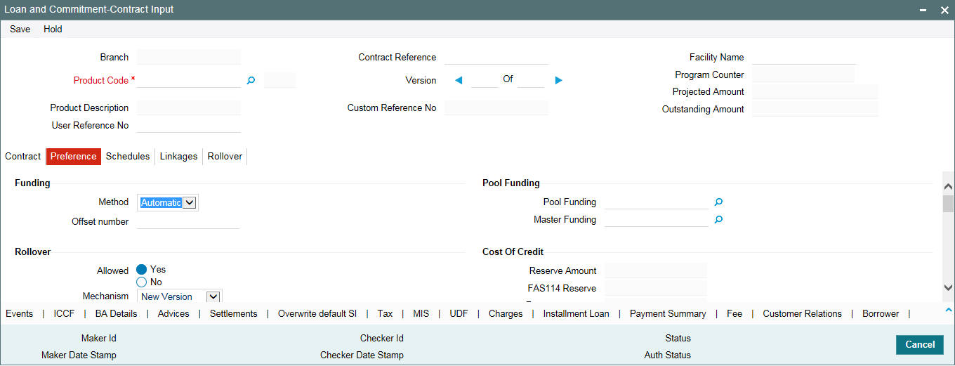

In Loan and Commitment-Contract Input screen (OLDTRONL), under ‘Preferences’ tab ensure to select ‘Funding Method’ as ‘Automatic’. If the disbursement is mode is auto, on contract creation deposit is initiated for the amount disbursed.This triggers deposit creation automatically on contract save.
On save of deposit creation the following takes place in the staging table.
OL Contract Authorization - Auto Disbursement
OL Contract authorization is validated with the deposit contract initiation status. If deposit creation is successful, then OL contract authorization is allowed.
If deposit creation is failed/ unprocessed, then OL contract authorization will not be allowed.
OL Contract Reverse Authorization - Auto Disbursement
OL Contract reverse authorization is validated with the reverse deposit contract initiation status. If the reverse deposit authorization is processed, then OL Contract reverse authorization is allowed. If the reverse deposit authorization is unprocessed or failed, then OL Contract reverse authorization is not allowed.
OL Contract modification- Auto Disbursement
If deposit creation is unprocessed, then OL contract modification will not be allowed
If deposit creation is processed, then OL contract modification will be allowed
If deposit creation is failed, then OL contract modification will be allowed
OL Contract Deletion - Auto Disbursement
If deposit creation is in unprocessed, then OL contract deletion will not be allowed.
OL Contract Reversal - Auto Disbursement
On reversal of loan contract, reverse deposit request will be initiated.
Reversal of OL Contract after Authorization - Auto Disbursement
If the reverse deposit is processed, then OL Contract reverse authorization is allowed. If the reverse deposit is unprocessed or failed, then OL Contract reverse authorization is not allowed.
If deposit reverse is failed/ unprocessed, then OL contract reversal authorization will not be allowed.
Once deposit reverse gets processed, contract reversal deletion will not be allowed.

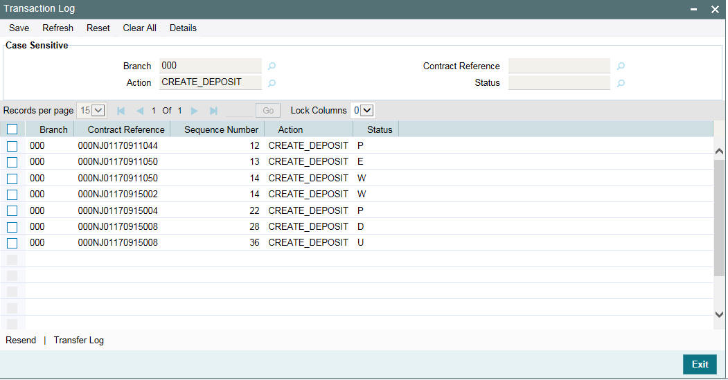

You can view list of all failed deposit contract transactions with all the request details, status, failure reason if applicable and then initiate for re-processing.
You can invoke the ‘Transaction Log’ screen by typing ‘OLSIFCD’ in the field at the top right corner of the Application tool bar and clicking the adjoining arrow button.
