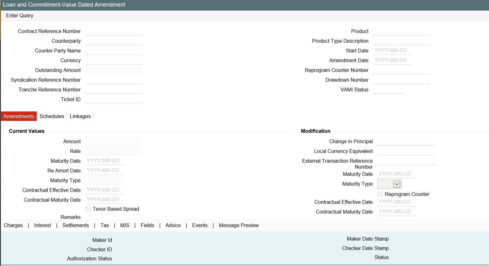

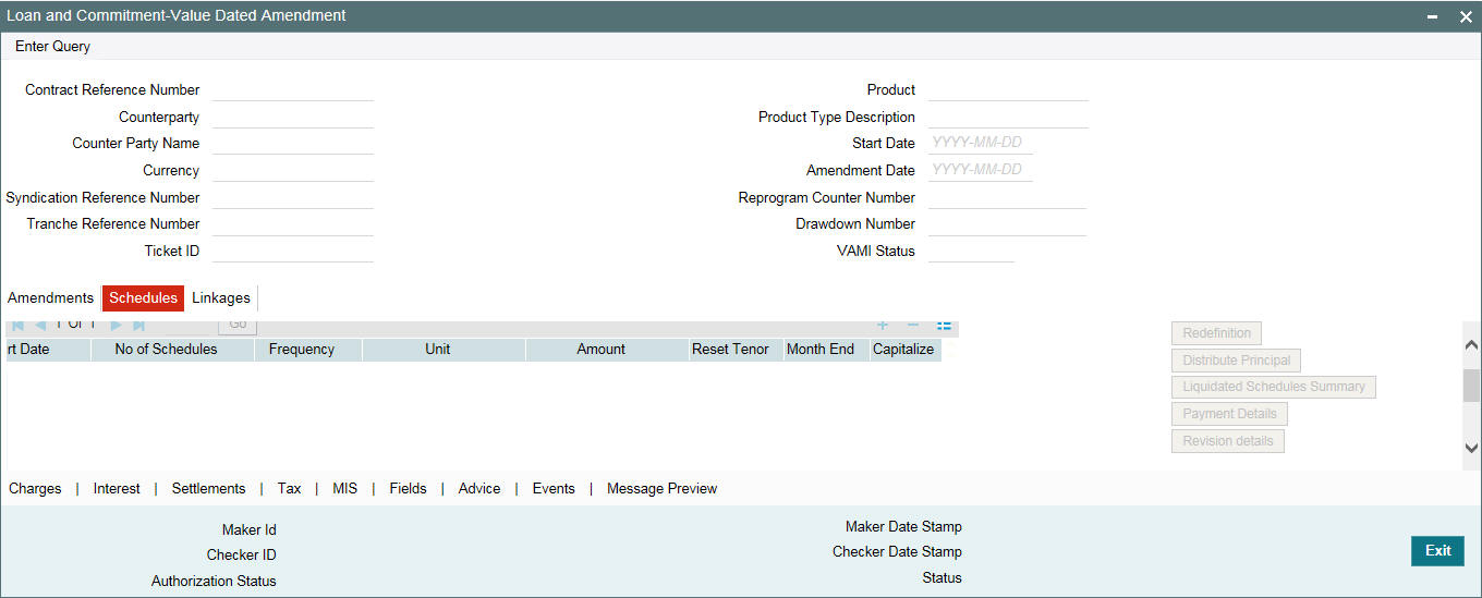

You can invoke the ‘Loan and Commitment - Value Dated Amendment’ screen by typing ‘OLDVAMND’ in the field at the top right corner of the Application tool bar and clicking the adjoining arrow button.
Enter the reference number of the loan to which you want to make amendments. The main details of the loan is displayed in the screen.

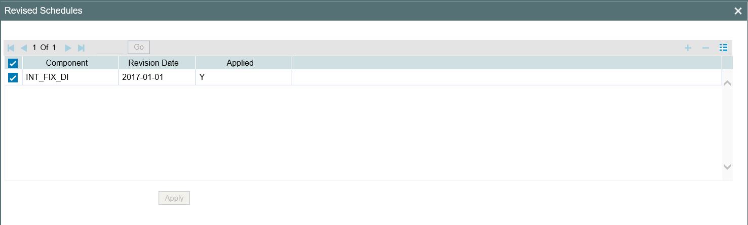

The schedule changes, which have come about as a result of value-dated changes, can be done through the Value Dated Amendments screen. For example, if the schedule change has come about following a change in the maturity date, you have to do this through this screen. Click on ‘Schedules’ in this screen.
When you change the rate applied on a fixed rate contract through the Value Dated Amendments screen, you can also apply the rate revision schedules to the contract. In the Schedules tab of the Loans and Commitment- Value Dated Amendments screen, any interest rate revision schedules defined for the contract are displayed. You can make these schedules effective by clicking on the “Apply” button.

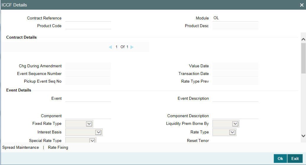

Through the Value Dated Amendment function, you can make changes to the maturity date, the principal and specify a new value date for the loan.
However, if you want to change the interest rate, the rate code, the
spread or the interest amount, you have to invoke the Contract ‘ICCF
Details ‘screen of the ICCF module through the ‘Loan and
Commitment Value Dated Amendments’ screen. Click the’Interest’ to invoke this screen.
You can make Value Dated Amendments only to the following components in the Contract ICCF screen.

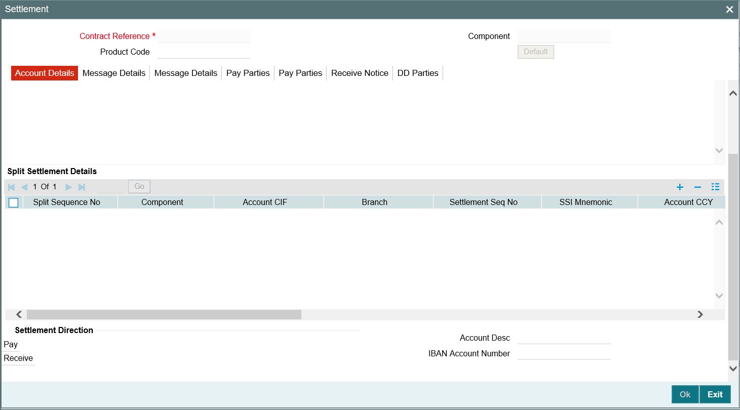

If you want to make changes to the settlement accounts and the currency conversion rates, you have to invoke the ‘Loans and Commitment - Contract Input’ screen and go to the ‘Settlements’ screen by clicking the ‘Settlements’.
For more information, refer to the Settlements User Manual.
The system amends the settlement instructions which are defaulted as a part of maintenance and the settlement accounts which are defaulted component (Amount Tag) wise.
Note
CAMD event is triggered when you upload amendment for settlement instruction.

If there is any principal amount increase or maturity date change in the contract, you can distribute the amount equally among all the schedules and redefine the schedules from the amendment date till maturity date. You can do this using 'Distribute Principal' and 'Redefinition' button in 'Schedules' tab of 'Loan and Commitment Value Dated' screen.
In addition, you can use 'Default' button to default back to the original schedules as in contract and 'Liquidate Summary Schedule' button to view the overdue or liquidated schedules.

When you click ‘Payment Details’ button in this screen, you can see the ‘Payment Schedule Details screen’ similar to ’Loan and Commitment - Contract Input’ screen. Here you can view the details of the schedules for a particular contract. For more information, refer to ‘Revision and Repayment Schedules’ sub-section in Processing Repayments section.
When you click ‘Revision Details’, the changes made in the ’Loan and Commitment - Contract Input’ screen are displayed. For more information, refer to ‘Revision and Repayment Schedules’ sub-section in Processing Repayments section.

In Oracle Lending, you can authorize the value-dated amendments made on Loan contracts through the ‘Loans and Commitment - Value Dated Amendment Summary’ screen.
You can invoke the ‘Loans and Commitment - Value Dated Amendment Summary’ screen by typing ‘’OLSVAMND’ in the field at the top right corner of the Application tool bar and clicking the adjoining arrow button.
The authorization status of all unauthorized contracts is marked as ‘U’. The following stages of the contracts might be unauthorized:
To authorize the unauthorized contracts, double-click on the contract in the ‘Loans and Deposits Contract Summary’ screen. The screen that is displayed depends on the stage of the contract that is unauthorized.

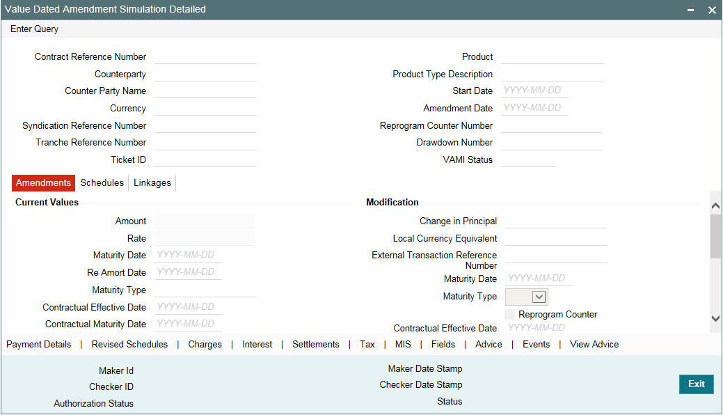

The value dated amendment simulation screen is similar to ‘Loan and Commitment - Value Dated Amendment’ screen. Once the VAMI is saved in this screen, you can view the revised schedules and view the advice.
Value Dated Amendment simulation is used to view the impact on repayment schedules, tenor and maturity date after the VAMI.
You can invoke the ‘Value Dated Amendment Simulation Detailed’ screen by typing ‘OLDVAMSI’ in the field at the top right corner of the Application tool bar and clicking the adjoining arrow button.

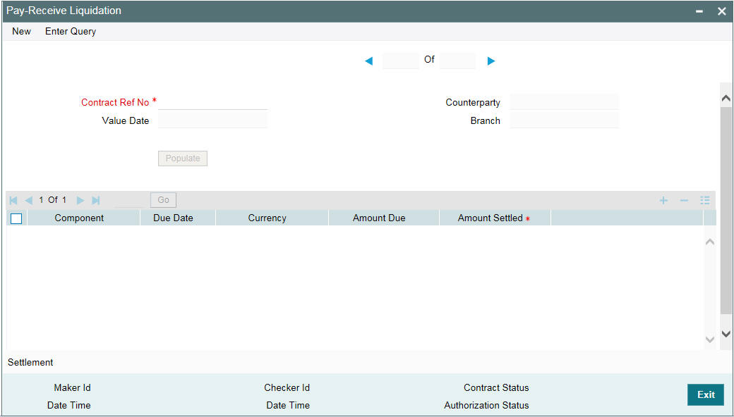

You can track and liquidate the differences in the settled amount using ‘Pay – Receive Liquidation’ screen.
You can invoke the ‘Pay - Receive Liquidation’ screen by typing ‘OLDPRLIQ’ in the field at the top right corner of the Application tool bar and clicking the adjoining arrow button.
Note
In case of any Pro Rata VAMI beyond any Payment, it may result in the change in the settlement amount for the settled schedules. These differences in the settled schedules (both positive and negative) you can track under the payable and receivables and can settle the differences to the Pay-Receive Liquidation option.
Contract Reference Number
Specify the contract reference number whose list of components you want to display in this screen.
The following fields are displayed
Value Date
Specify the value date of the payment for the selected component. The value date of the payment can be either backdated or current dated.
Amount Settled
Specify the amount to be liquidated for the selected component.
