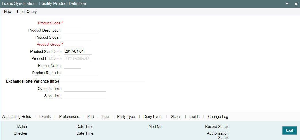

At the first level, you must define a borrower facility product for borrower facility contracts. The example given below will illustrate this.
Example
Your bank has decided to make available the facility of entering into a loan syndication contract with customers. You can define a product for this facility. Let us assume that the product you define has been given the code SYN1. Now, any syndication facility contracts that are entered into by your bank with any borrowing customer can be processed against this product.
You can define more than one syndication facility product. For instance, you can define a general syndication product, and a special syndication product.
Let us suppose that you have entered into a syndication contract with one of your customers, Mr. John Baldwin. After identifying the participants for a tranche under this contract, you want the participants in a tranche to fulfill their commitments five days in advance, before each drawdown schedule under the tranche falls due. You could define a general syndication facility product to enter a contract of this nature, specifying the required number of notice days as five.
Your bank has also entered into an agreement with one of your corporate customers, Equinox Consultants. Let us suppose that, for this contract you do not need to notify the participants in advance of a schedule. You could define a special syndication facility product to enter agreements of this nature, with the number of notice days as zero.
When you define a borrower facility product, you must specify the corresponding borrower tranche and drawdown products to be used for borrower tranche or drawdown contracts that will be processed under the parent borrower facility contract that uses the borrower facility product.
You must also specify the participant product that is used to process participant contracts that are created from borrower facility contracts that use the borrower facility product.
Therefore, it becomes necessary for you to create participant products and borrower tranche and drawdown products before creating borrower facility products.

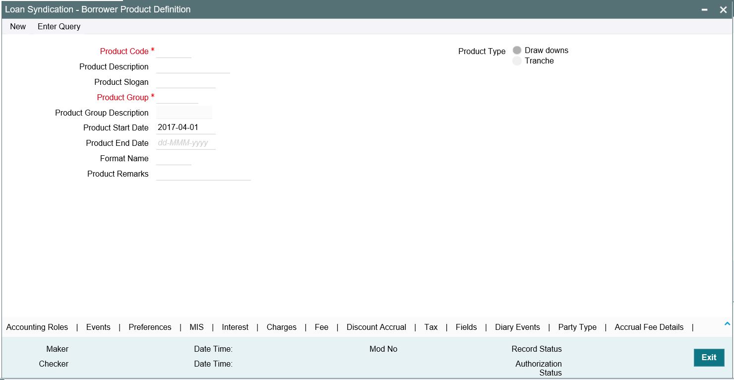

To create a borrower tranche or drawdown loan you can specify the basic details such as the Product Code, Group, Description, and so on in the ‘Loans Syndication – Borrower Product Definition’ screen. You can invoke the ‘Loan Syndication - Borrower Product Definition’ screen by typing ‘LBDPRMNT’ in the field at the top right corner of the Application tool bar and clicking the adjoining arrow button.
For any product you create in Oracle Banking Corporate Lending, you can define generic attributes, such as fees, charges, interest details, and so on, by clicking on the appropriate icon in the horizontal array of icons in this screen.
The tabs provided in the screen are used for the following purposes:

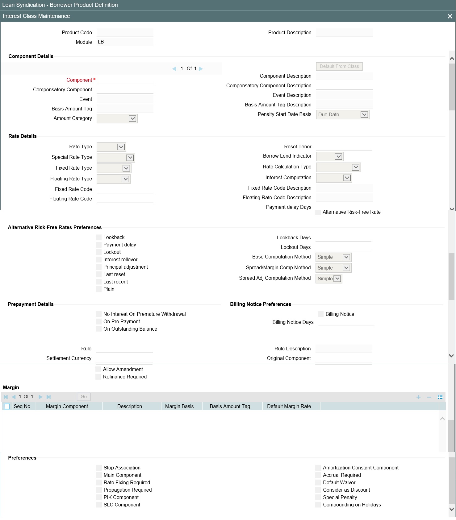

Interest |
Maintaining Interest details for a product |

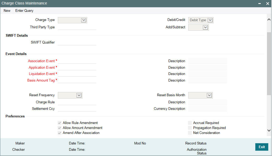

Charges |
Maintaining Charge details for a product |

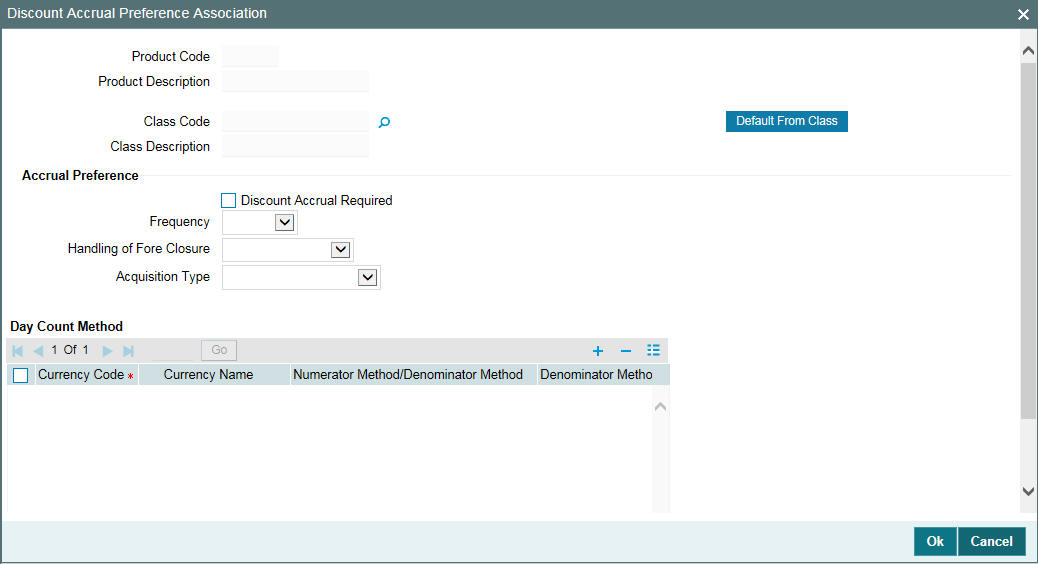

Discount accrual |
Specifying discount accrual preferences |

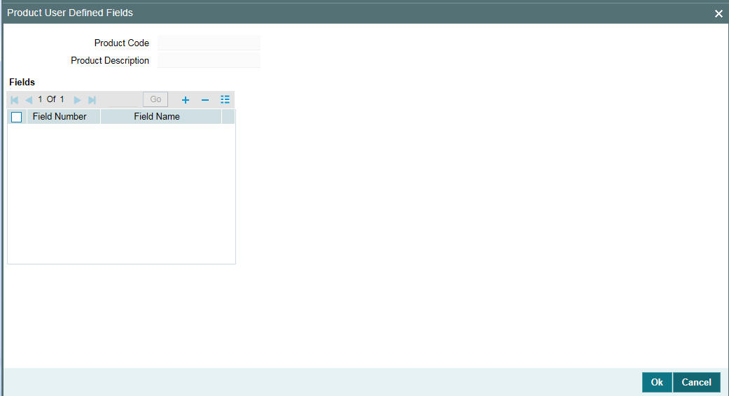

Fields |
Making User Defined Fields (UDFs) applicable to a product |

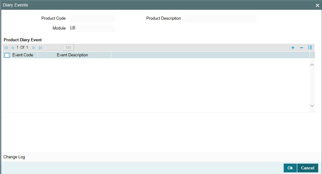

Diary Events |
Associating diary events with the product |

For a borrower tranche/drawdown product, in addition to these generic attributes, you can specifically define other attributes.
You can define the generic attributes specific to a borrower tranche/drawdown product in the ‘Loans Syndication – Borrower Product Definition’ screen.
Type
The product type is the first attribute that you specify for a borrower tranche or drawdown product. It indicates the category under which the product can be placed, and the type of contract that will be processed against the product.
Each borrower product that you define could be placed under any of the following categories:

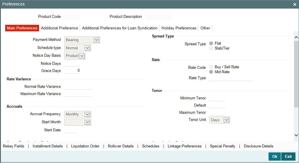

Preferences are options that you can use to define specific attributes for a product, which is applied automatically to contracts that are entered and processed against the product.
You set up preferences for a borrower tranche/drawdown product in the Loans Syndication – Borrower Product Preferences screen. Invoke this screen by clicking ‘Preferences’ in the ‘Loans Syndication – Borrower Product Definition’ screen.
You set up the general preferences for a borrower tranche or drawdown product in the ‘Loan Syndication – Borrower Product Preferences’ screen in the same manner as you would for a normal commitment product or loans, depending upon the product type you have specified in the ‘Loans Syndication – Borrower Product Definition’ screen.
Refer the Bilateral Loans User Manual for a detailed description.
NoteThis section explains about those preferences that you need to set specifically for borrower tranche or drawdown products under a borrower facility contract.
To indicate Forward Processing is applicable to the borrower tranche or drawdown product during the events INIT and LIQD, select the option ‘Semi-Auto’ against the fields ‘Initiation Mode’ and ‘Liquidation Mode’, respectively. The system processes the two events before the scheduled date, but hold the messages till the spot date or value date. The messages are held in the Forward Processing Queue.
For details on Forward Processing, refer to the ‘Capturing Forward Event processing details’ in the chapter ‘Reference Information for Loan Syndication’.
Notice Days
You can indicate whether the notice days applicable for borrower drawdown contracts using the product must be defaulted from the product preferences, or from the parent tranche or facility contract.
The notice days refers to the number of days before a schedule payment date, a payment notice is to be sent to the borrowing customer, for the borrower drawdown contract. This would apply to ad-hoc fee, interest and principal schedules, and defined for the contract.

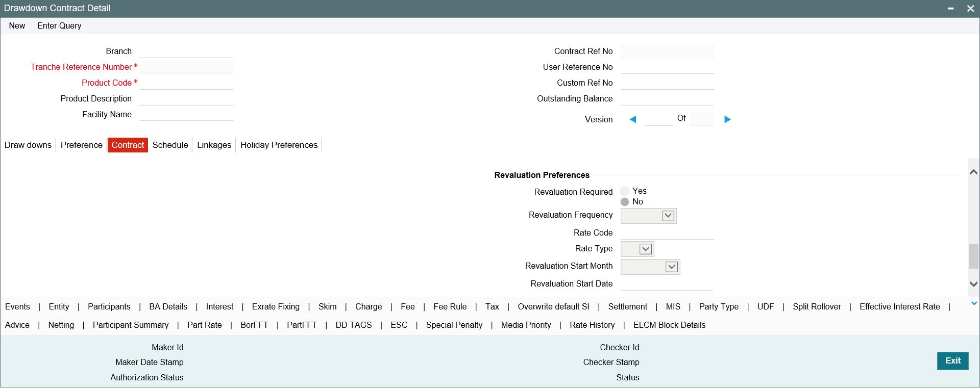

Oracle Banking Corporate Lending facilitates periodic revaluation of drawdowns if the drawdown currency is different from the tranche currency. The revaluation preferences you maintain as part of additional product preferences defaults here.
For details on revaluation preferences, refer the heading titled ‘Specifying revaluation preferences for drawdown products’ in this chapter.

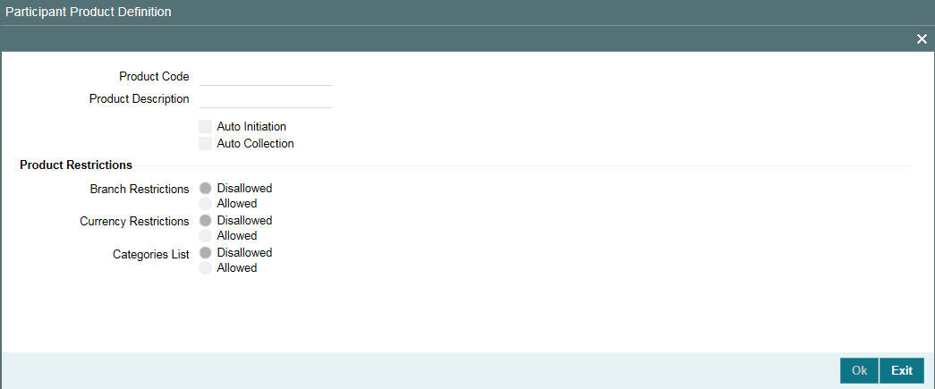

Product Restrictions
When you create a product, you can provide product restrictions. That is, you can specify the branches of your bank that can offer this product, the currencies that are allowed or disallowed and the customers who can avail the product.
You can set preferences as ’Allowed/Disallowed’ in this screen and the same is defaulted to 'Bilateral Loan and Commitment Restrictions' screen.

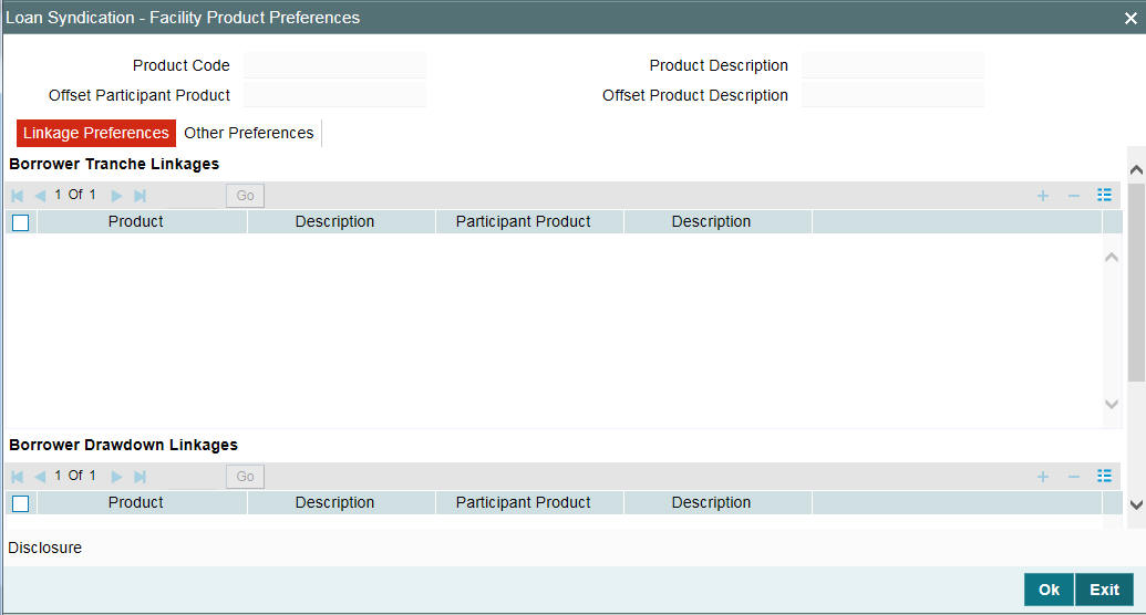

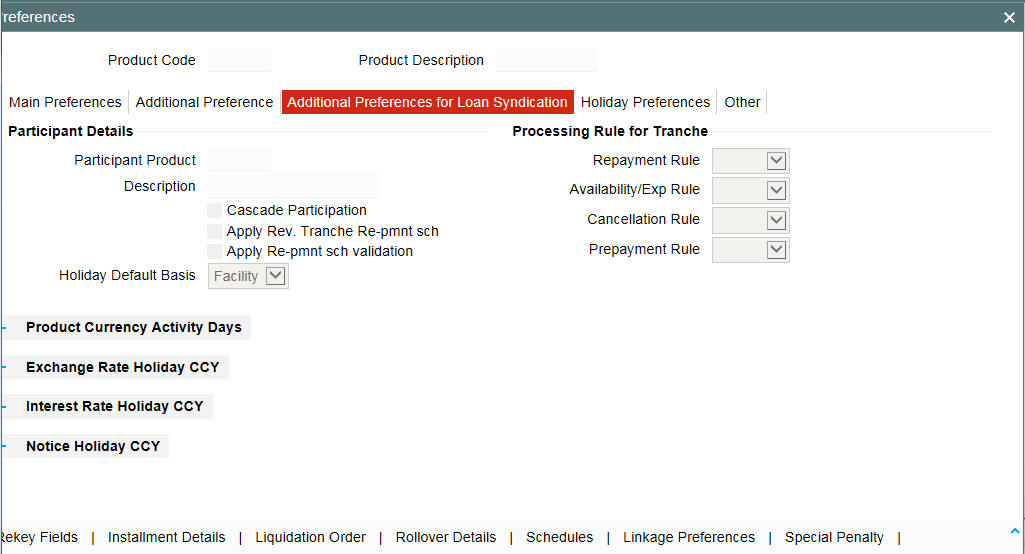

You can specify the following additional details regarding syndication, for borrower tranche or drawdown products, in the ‘Additional Preferences for Loan Syndication’ screen.You can invoke this screen by clicking the ‘ Additional Preferences for Loan Syndication’ button in the ‘LB Product – Preferences’ screen:
Capture the following information in this screen:

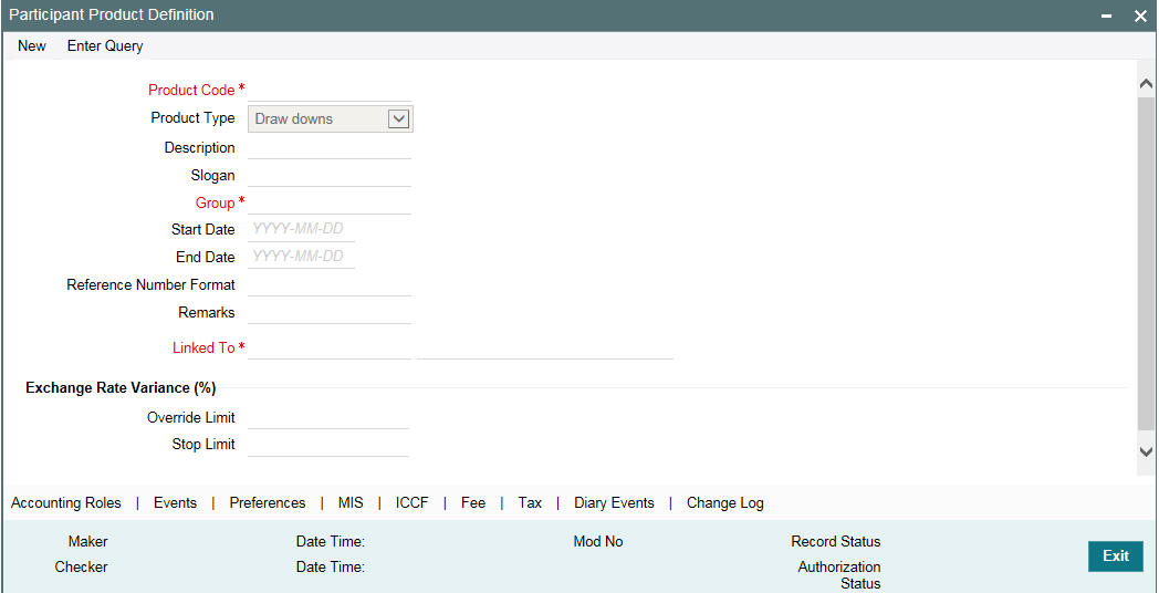

Participant Product
For a borrower tranche product, the corresponding participant product to be used for participant borrowing line contracts that are created under the borrower tranche contracts that use the product is displayed in this screen. The linkage is established when you define the participant product.
For a borrower drawdown product, the corresponding participant drawdown to be used for participant drawdown contracts that are created under the borrower drawdown contracts that use the product is displayed in this screen. The linkage is established when you define the participant product.
Cascading Participation
For a borrower tranche product, you can indicate whether any changes to participants in respect of a borrower tranche contract that uses the product, must be propagated to all related active drawdown contracts.
For a borrower drawdown product, you can specify that the participants should be propagated to the contract using the product, by selecting the check box ‘Cascade Participation’. The preference you specify for the product can be changed at the contract level.
Apply Rev. Tranche Re-prmnt sch
Select this check box to indicate that prepayment on the tranche repayment schedule is applicable for revolving tranches. If this check box is selected, then system enables the ‘Tranche Schedules’ button in the ‘Tranche Online’ screen for revolving tranches. If you select this check box for a tranche product having active tranches, then you should define the tranche repayment schedules manually for underlying active tranche contracts.
Note
Apply Re-prmnt validation
Select this check box to indicate that system should validate sum of processed and unprocessed repayment schedule amounts against the transfer availability of the tranche. In addition to this, the following validations are also applicable for the tranche product:
By default, this check box is deselected. You can modify this check box only after product maintenance is authorized.
Holiday Default Basis
For a borrower product, you can indicate whether the holiday treatment (for schedule dates and maturity date) applicable to tranche or drawdown contracts using the product must be defaulted from the parent borrower facility product; or from the borrower tranche or drawdown product.
In the Holiday Default Basis field, select ‘Facility’ to indicate that the holiday treatment specified in the borrower facility product is applicable, or select ‘Product’ to indicate that the holiday treatment from the borrower tranche or drawdown product is applicable.
You have to specify the processing rule for the following:
Repayment Rule
Select the repayment rule for the tranche product. You have the following options:
You can change this preference for the contract.
Availability / Exp Rule
Select the expiry rule for the tranche product. You have the following options:
Cancellation Rule
Prepayment Rule

Indicating Interest Rate Fixing Days
For borrower tranche products, you can specify the number of days before the drawdown date (defined in the drawdown schedule), the interest rate must be fixed. You can specify the applicable number of days for each required currency.
DD Notification Days and Time
For borrower tranche products, you can specify the number of days before the drawdown date that the customer needs to inform the bank of a new drawdown or reset of interest rate.
Exchange Rate Holiday Currency
The holiday preferences of the currency you select here is applied to calculate the exchange rate fixing days or date.
Interest Rate Holiday Currency
The holiday preferences of the currency you select here is applied to calculate the interest rate fixing days or date.
Notice Holiday Currency
The holiday preferences of the currency you select here is applied to calculate the notice rate fixing days or date.
Schedule dates for a contract could fall on holidays defined for your branch or on holidays defined for the currency of the contract. In the Product Preferences, you can specify whether the system should check for schedule dates falling on holidays, and how such schedule dates must be handled. These specifications would default to any borrower facility contract using the product, and also to underlying borrower tranche or drawdown contracts that are opened under the facility contract.
Note
You can change the holiday parameters for schedules through amendment at tranche/drawdown contract online screens, if required. You can specify that:
If you specify that checks must be made, you can also specify the corresponding treatment for schedule dates falling on holidays.
The Holiday Treatment Type is the parameter that defines how the system checks for schedule dates falling on holidays. You can specify one of the following options:
Include Branch Holiday
Select this check box to indicate that you want the system to check whether a schedule date falls on a local holiday defined for the branch. You cannot specify a check for currency holidays, if you choose this option.
The system checks the holiday table for your branch. If it encounters a contract entered in your branch, with a schedule date falling on a branch holiday, the holiday is handled according to the holiday-handling preferences you specify.
Use Facility Currency
If you choose this option, the system checks whether the schedule date falls on a holiday defined for the currency of the facility (borrower) contract, if this currency is different from the holiday currency you have indicated.
Use Local Currency
If you choose this option, the system checks whether the schedule date falls on a holiday defined for the local currency, if this currency is different from the holiday currency, facility currency and contract currency you have indicated.
Holiday Ccy
If the system must check whether the schedule date falls on a holiday defined for the currency of the contract, you must specify the code of the holiday currency.
Further, you have the following options to specify the specific currency for which the check must be done:
The system checks the holiday table for the currencies you have specified. If it encounters a contract using any of the specified currencies, with a schedule date falling on a holiday for any of the currencies, the holiday is handled according to the holiday-handling preferences you specify.
If you have specified that the system check for schedule dates falling on holidays, you must also specify the treatment for schedule dates encountered by the system that do fall on holidays. The following preferences can be set:
Moving the Schedule Date Backward or Forward
You can indicate whether the schedule date falling on a holiday must be moved forward to the next working day, or backward to the previous one.
Moving Across Months
If you have indicated either forward or backward movement, and the moved schedule date crosses over into a different month, you can indicate whether such movement is allowable; it will be allowable only if you indicate so in the ‘Move Across Months’ field.
Cascading Schedules
If one schedule has been moved backward or forward in view of a holiday, cascading schedules would mean that the other schedules are accordingly shifted. If you do not want to cascade schedules, then only the schedule falling on a holiday is shifted, as specified, and the others remain as they were.
Select the ‘Move Comm Redn Sch’ check box to indicate the holiday processing rule should be applied on commitment schedules. This is applicable only to tranche products.
Select the ‘Move Payment Sch’ check box to indicate the holiday processing rule should be applied on repayment schedules. This is applicable only to drawdown products.
Select the ‘Move Revision Sch’ option to indicate the holiday processing rule should be applied interest rate revision schedules. This is applicable only to drawdown products.
The maturity date for a contract could fall on holidays defined for your branch. In the Product Preferences, you can specify whether the system should check for maturity dates falling on holidays, and how such dates must be handled. These specifications would default to any borrower facility contract using the product, and also to underlying borrower tranche or drawdown contracts that are opened under the facility contract. You can specify that:
The Holiday Treatment Type is the parameter that defines how the system checks for maturity dates falling on holidays. You can specify one of the following options:
Select this check box to indicate that you want the system to check whether a maturity date falls on a local holiday defined for the branch. You will not be able to specify a check for currency holidays, if you choose this option.
The system checks the holiday table for your branch. If it encounters a contract entered in your branch, with a maturity date falling on a branch holiday, the holiday is handled according to the holiday-handling preferences you specify.
Use Facility/Tranche Currency
If you select this check box, the system checks whether the maturity date falls on a holiday defined for the currency of the facility (borrower)/tranche contract, if this currency is different from the holiday currency you have indicated.
Use Local Currency
If you select this check box, the system checks whether the maturity date falls on a holiday defined for the local currency, if this currency is different from the holiday currency, facility currency and contract currency you have indicated.
Holiday Ccy
If the system must check whether the maturity date falls on a holiday defined for the currency of the contract, you must specify the code of the holiday currency. Further, you have the following options to specify the specific currency for which the check must be done:
The system checks the holiday table for the currencies you have specified. If it encounters a contract using any of the specified currencies, with a maturity date falling on a holiday for any of the currencies, the holiday is handled according to the holiday-handling preferences you specify.
Apply Financial Centre Holiday Treatment
This check box allows you to enable financial centre holiday treatment and add the financial centres for the holiday treatment.
For more information about maintaining financial centre for holiday treatment refer to Products User Manual.
If you have specified that the system check for maturity dates falling on holidays, you must also specify the treatment for maturity dates encountered by the system that do fall on holidays.
Moving the Maturity Date Backward or Forward
You can indicate whether the maturity date falling on a holiday must be moved forward to the next working day, or backward to the previous one.
Moving across months
If you have indicated either forward or backward movement, and the moved maturity date crosses over into a different month, you can indicate whether such movement is allowable; it is allowable only if you indicate so in the ‘Move Across Months’ field.
Oracle Banking Corporate Lending facilitates periodic revaluation of drawdowns based on the preferences you maintain here and this is applicable only if the drawdown currency is different from the tranche currency. The new exchange rate, post revaluation, is used to convert the transaction amount from the drawdown currency into its equivalent in the tranche currency.
You can specify revaluation preferences in the ‘Contract’ tab. The product code and description is displayed in this screen. You can specify the following revaluation preferences:
Reval Reqd
By default, revaluation is applicable for a drawdown product and the option ‘Yes’ is selected. In this case, you have to specify the following additional preferences as mandatory information:
Exchange Rate Code
You must select the code for the exchange rate that must be used to convert the drawdown amount from the drawdown currency to its equivalent in the tranche currency. The option list displays the rate codes maintained in the ‘Currency Rates Maintenance’ screen.
By default, the rate code you select here will be applicable to all drawdowns. At the time of capturing drawdown details, if the drawdown currency is different from the tranche currency and the default ‘Exchange Rate Code’ is not maintained for the currency pair involved, system displays an error message.
Exchange Rate Type
You must also specify the type of exchange rate that must be used to convert the drawdown amount from the drawdown currency to the tranche currency. The options available are:
On the revaluation schedule dates, arrived at abased on the Frequency, Start Month, and Start Day, Oracle Banking Corporate Lending picks up the exchange rate defined for the selected ‘Exchange Rate Code’ and ‘Exchange Rate Type’ combination, corresponding to the currency pair involved in the conversion, to convert the amount in the drawdown currency into its equivalent in the tranche currency.
Frequency
This refers to the frequency or periodicity of revaluation. The options available are:
Start Month and Start Day
For the frequency you select, you must also specify the month and the date for commencing the revaluation process.
Note
If Reval Required is ‘Yes’ for the drawdown product, the same defaults to all drawdowns processed with the product. You can, however, change the preferences at individual drawdown levels. But, if ‘Reval Required’ is ‘No’ for the product, you cannot change it to ‘Yes’ at the drawdown level and revaluation is not applicable for cross currency drawdowns.
For details on specifying revaluation preferences for a drawdown, refer the heading titled ‘Capturing details in the ‘CONTRACT’ tab’ in the ‘Loan Syndication Contracts’ chapter of this User Manual.

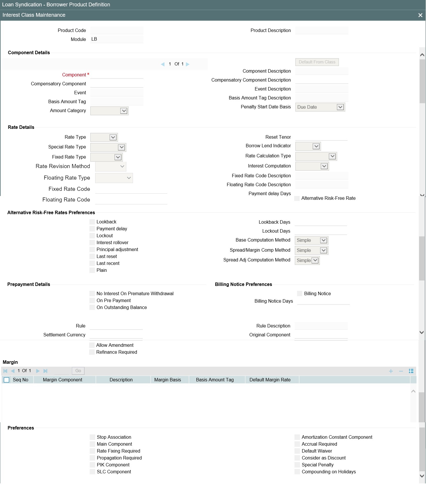

You must indicate the applicability of interest components, for borrower contracts using the product. You can use the ‘Interest Class Maintenance’ screen for this. Click ‘Interest’ in the Tranche/Drawdown Product Definition screen to invoke the ‘Interest Definition’ screen.
In this screen, you associate interest components in the same manner as you would for a normal commitment or loans product. Only information specific to the LB Module is explained here.
Rate Fixing Required
You can fix the interest rate for a component if you check this option. The system arrives at the Interest rate fixing date for the drawdown currency based on the Interest rate fixing days maintained at the tranche level and the holiday validation currencies specified for the drawdown currency.
Note
Rate fixing is applicable for an interest component with the following attributes:
This is done through the ‘Rate Fixing Details’ sub-screen invoked from the ‘ICCF Details’ screen of the ‘Drawdown Contract Online’ screen.
Rate Revision Method
You can select 'Auto' or 'Manual' from the drop-down list. The rate revision method is allowed for floating periodic type of loans.PIK Component
This value defaults from the associated interest class. You can modify this, if required.
If you select this option, you need to specify the Rate Type as ‘Fixed’ and Fixed Rate Type as ‘User Input’.
Note
For more details on this screen, refer the heading titled ‘Fixing interest rate for the drawdown’ in the ‘Loan Syndication Contracts’ chapter of this User Manual.
Compensatory Component
Specify the name and description of the compensatory component.
Note
SLC Component
Select this field to default schedules for SLC component from the main interest component. The base rate is SLC fee rate and you can modify this rate as part of value dated amendment, if required.
The margin and spread sub components from the main interest components are defaulted to SLC component as well.
Note
Amortization Constant Component
Select this check box to indicate that the component is amortization constant component.
You can select this flag only if the schedule type is ‘Amortization’ and user input installment flag is checked. For main interest component, this flag is checked and disabled for products with schedule type ‘Amortization’ and user input installment flag checked.
For Amortization Constant, along with the Main Interest component and the Principal, the below components are considered:
INS_COMP1 -- Insurance component (Escrow Impounding component)
TAX_COMP1 - Tax component(Escrow Impounding component)
SERVFEE – Servicer Fee – applicable only for Agency (Interest component for Servicer Fee)
ESCROW 3 – An escrow impounding component (Escrow Impounding component)
The options of ‘Alternative Risk-Free Rates Preferences’ are defaulted from ‘Interest Class Maintenance’ screen (LFDINTCL). If required, you can modify
For more information, refer to Interest User Manual.
You can specify the following billing preferences for the interest component in this screen:
Billing Notice Required
Select this check box to indicate that you would like to send a billing notice for the interest component.
No of Days
Specify the number of days prior to the billing date that the billing notice needs to be sent.
You can also associate margin components with an interest component here. Select the margin component from the option list which contains margin components you have defined through the ‘Margin Definition’ screen. Once you select a margin component, the Description, Margin Basis, and Basis Amount Tag are displayed.
You are allowed to enter a default margin rate if the ‘Margin Basis’ is ‘Drawdown’.
For details about associating interest components for a product, refer the Interest manual. The preferences specific to borrower tranche or drawdown products are explained in this section.
Interest component classes for specific application to borrower tranche or drawdown contracts can be propagated to participant contracts resulting from the borrower contracts. You can build this preference into interest classes that you define specifically for borrower tranche or drawdown products. During definition of the class, this preference can be indicated, by selecting the Propagation Reqd check box in the ‘Interest Class Maintenance’ screen.
Note
This check box is active only for interest components of the LB module. For all other modules the box is deactivated.
Click the PIK Component check box to indicate that you want to calculate the interest based on the PIK margin.
In the Product ‘Interest Class Maintenance’ screen, when you are associating the interest components for the borrower tranche or drawdown product, you can choose an interest class for which the propagation to participants option has been indicated in the class definition, if required. If so, the Propagation Reqd check box is selected.
You can change this specification and deselect the Propagation Reqd check box, if you want to indicate that interest class propagation to participants is not applicable. Alternatively, if you have chosen an interest class for which propagation to participants has not been indicated, you can select the Propagation Reqd box to indicate propagation of interest class to participants, if required.

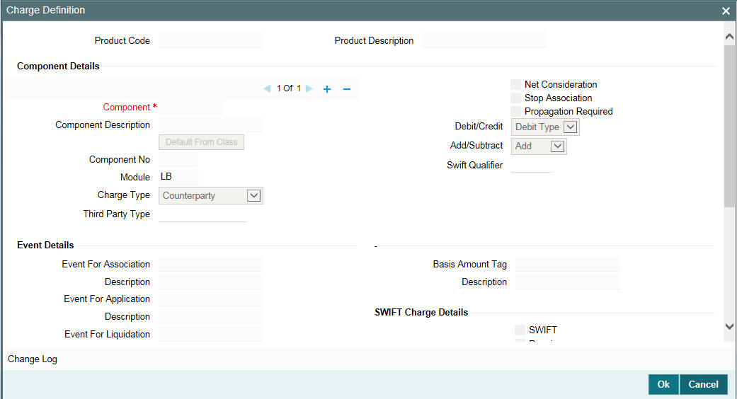

You must indicate the applicability of charge components, for borrower contracts using the product. You can use the ‘Charge Definition‘screen. Click ‘Charges’ in the Tranche / Drawdown Product Definition screen to invoke the ‘Charge Definition’ screen.
In this screen, you associate charge components in the same manner as you would for a normal commitment or loans product.
For details about associating charge components for a product, refer the Charges and Fees manual. The preferences specific to borrower tranche or drawdown products are explained in this section.
When you collect the charges from the borrower, you can choose to pass the charges to the participants of the tranche or drawdown contract. To indicate this you have to click the ‘Propagation Required’ check box in the ‘Charge Class Maintenance’ screen (LFDCHGCE).
Note
This check box is active only for charge components of the LB module. For all other modules the box is deactivated.
Refer the Charges and Fees manual for further details on this screen.
In the product Charge Definition screen, when you are associating the interest components for the borrower tranche or drawdown product, you can choose a charge class for which the propagation to participants option has been indicated in the class definition, if required. If so, the Propagation Reqd check box is required.
You can change this specification and deselect the Propagation Reqd check box, if you want to indicate that charge class propagation to participants is not applicable. Alternatively, if you have chosen a charge class for which propagation to participants has not been indicated, you can select the Propagation Reqd check box to indicate propagation of charge class to participants, if required.

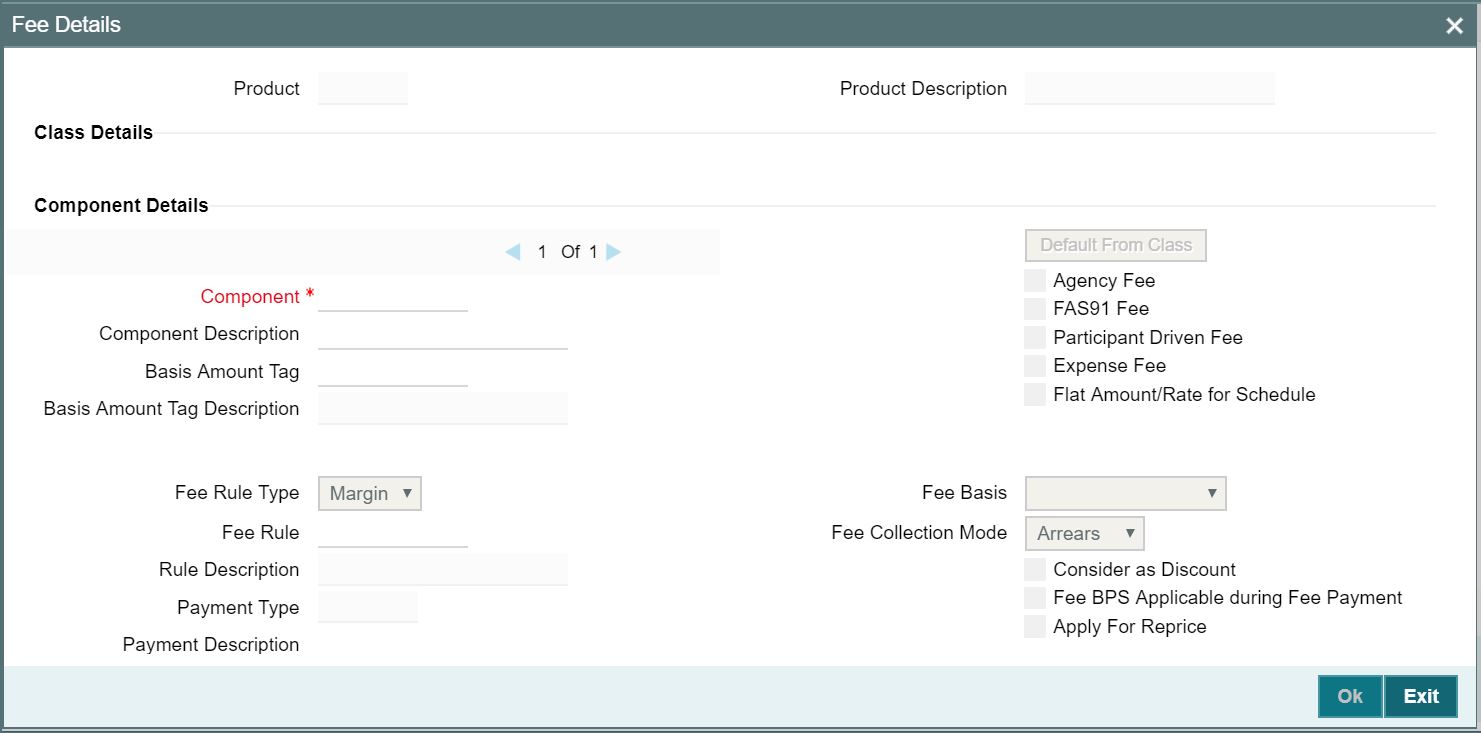

System defaults the parameters of the selected fee component. However, you can change the parameters according to your requirements.
In this screen, you associate fee components applicable for the product you are defining. Specify the following in this screen:
Component
Enter the fee component you are maintaining details for.
Description
Enter a description for the fee component.
Basis Amount Tag
When defining fees, you can select the applicable amount tag on which the fee is to be calculated from the option list given.
The following amount tags are available for a Tranche product:
Note
Since issuance fee is not distributed across all the participants, the same is not displayed in the ‘Participant Ratio Details’ screen. The participant who is identified as the issuer of the LC is entitled to 100% of this fee.
The following example illustrates the difference between utilized and unutilized basis amount tags with reference to ‘Revolving’ and ‘Non-Revolving’ tranches:
Example
In the case of a non-revolving tranche, the unutilized amount does not take into consideration the repayments made by the customer under any of the draw-downs under the tranche.
A customer has three draw-downs of USD 100,000 each, under a tranche of USD 500,000 of which:
In this case:
In the case of a revolving tranche, the utilization or non-utilization amount takes into consideration the repayments made by the customer under any of the draw-downs under the tranche.
Considering the same example as above, in this case:
Outstanding amount is : USD 172,500 (DD2-72500; DD3-100,000)
Utilization amount is : USD 172,500
Non-Utilization amount is : USD 327,500 (500,000 – 172,500)
Agency Fee
If, for the fee component that you have selected, you have selected the box ‘Agency Fee’, the income on the component is meant for the leading agent alone. It does not get propagated to the participants.
Note
If you check the box Agency Fee, the box ‘Participant Propagation Required’ is disabled.
FAS91 Fee
Select this check box to perform FAS91 computations. The system validates if:
Participant Driven Fee
If you select this check box, the system allows you to define an individual fee amount for each participant.
Note
Expense Fee
Select this check box to enable the expense fees. The fees can be accrued or amortized.
The expenses may be flat amounts (such as Legal Fee) or rate based on a specific basis amount (such as fee paid to credit guarantor)
These are expenses incurred against a contract which the bank does not directly recover from the borrower. These expenses can be one-time expenses or periodic expenses or paid in advance or in arrears. They may be incurred at the Facility/Tranche/ Drawdown levels.
In expense the fee calculation happens only within the schedule period of the contract whereas in normal arrears the fee calculation happens from the start of the contract till the schedule end date and for advance from the start of the schedule till the end of the maturity date.
For more information refer, to ‘Expense Fee’ section in this User Manual.
Fee Rule Type
Select the Fee Rule Type applicable from the option list. You have the options ICCF and Margin. The rules are applicable depending on the rule type you select.
Fee Rule
Select the rule applicable from the option list given. The option list includes Fee Rules that you have defined in the Fee Rule Maintenance screen.
Fee Basis
The Fee Basis indicates the method in which a given fee schedule amount has to be calculated. The values in the drop-down list are:
For more information on fee basis, refer to Charges and Fees User Manual.
Fee Collection Mode
While defining fees, you can specify whether the fee is to be collected in advance or in arrears.
Payment Type
The system displays the payment type.
Fee BPS Rate Applicable
Select this check box to indicate that BPS rate is applicable to the payment type.
Note
‘Payment Type’ and ‘Fee BPS Rate Applicable’ options are enabled only if ‘Basis Amount Tag’ is ‘USERINPUT’.

Liquidation Mode
Select the liquidation mode for the fee components under this fee class. You have the following options:
No of Days
If you have selected the option ‘Deferred Auto Liquidation’, you have to specify the number of days by which the liquidation is to be deferred, in this field.
When liquidation is due, you can choose whether or not you would like to send a notice to the concerned customer. Select this check box to indicate you would like to send a notice.
No. of Days
Enter the number of days prior to liquidation that the notice is to be sent out.
Accrual Required
Select this check box to indicate accrual is required.
Accrual Method
If you have selected the ‘Accrual Required’ check box, you have to select the accrual method. You can accrue a fee using the straight line or discount accrual method.
Accrual Frequency
Specify the accrual frequency. The frequency can be one of the following:
Accrual Frequency Units
Specify the units of accrual frequency here. If, for example, you select the frequency of accrual as ‘Monthly’, and specify the frequency units as ‘5’, the accrual once in five months.
Allow Rule Amendment
Select this check box to indicate the fee rule can be amended.
Allow Amount Amendment
Select this check box to indicate the user at the transaction level, based on the margin or ICCF rule linked to the fee class can amend the fee amount calculated. This field is applicable only for advance types of fee collection.
Stop Association
Select this check box to indicate the fee component should not be associated with the product henceforth.
Participation Propagation Reqd
While entering fee details, you have the option of passing the fee collected from the borrower to the participant of a facility, tranche or drawdown contract.
Select ‘Participant Propagation Reqd’ check box, if you want to transfer the fee to the participant. If you do not select this check box, fees collected from the borrower is not passed to the participant.
Allow End Date Input
If you select this check box, you can enter the date on which the system has to stop the accrual of fee amount, in the LB Contract Online screen.
This date can be lesser than, or equal to the Maturity Date. If you do not select this check box, the Maturity Date of the contract is defaulted as the end date for accrual.
Allow Start Date Input
If you select this check box, you can enter the date on which the system has to start the accrual of fee amount, in the LB Contract Online screen.
This date can be greater than, or equal to the Value Date. If you do not select this check box, the Value Date of the contract is defaulted as the start date for accrual.
After building discount accrual fee classes you can associate the class with loans or bills products. Click the ‘Discount Accrual’ in the Product Definition screen. The ‘Discount Accrual Preference Association’ screen is displayed.
To associate discount accrual fee class with a product, click the ‘Default From Class’ in the Discount Accrual Preference Association screen. Select the appropriate discount accrual fee class from the list of classes that you would have maintained through the Discount Accrual Preference Class Maintenance.
For further information on the Discount Accrual Preference Class Maintenance screen, refer to the chapter ‘Defining Discount Accrual Fee Classes’ in the Bilateral Loans User Manual.
The attributes defined for the discount accrual fee class defaults to the product. You have the option to modify the attributes defined for the class, to suit the requirement of the product you are creating.
Alternatively, you can choose to define the discount accrual details for the product.

In the Diary Event Association screen, you can also specify the different diary events that would need to be processed for borrower tranche or drawdown contracts using the borrower tranche or drawdown product. Click ‘Diary Events’ in the Tranche / Drawdown Product Definition screen to invoke the ‘Diary Events’ screen.
In this screen, select the code of the diary event that you want to associate with the product, in the Event Code field.
You can maintain the UDFs pertaining to the loan using the ‘Product User Defined Fields’ screen. To invoke this screen, click the ‘Fields’ on the Application toolbar of the ‘Loan Syndication -Borrower Product Definition’ screen.
In this screen, you can maintain the UDF ‘PAYOFF-FEE’ attached to tranche/drawdown products which is used to determine the flat fee amount.

After you have created products to process borrower side contracts in respect of a syndication agreement, such as borrower tranches and drawdowns, as well as products for participant side contracts, you must define products that would be used to process the main syndication agreement (facility) contract with the borrower. Such products are called borrower facility products.
To create a borrower facility product, you can specify the basic details such as the Product Code, Group, Description, and so on in the Loan Syndication – Facility Product Definition screen. You can then use the other product definition screens to set up preferences for the product.
You can invoke the ‘Loan Syndication - Facility Product Definition’ screen by typing ‘FCDPRMNT’ in the field at the top right corner of the Application tool bar and clicking the adjoining arrow button.
You can specify the basic details for the product, such as the Product Code, Description, Group and life-span, in the same manner as you specified for the tranche/drawdown product.
After specifying all the basic details of a product, you can indicate certain specific attributes for the product. Each of these attributes can be defined in the corresponding screen that you can invoke from the Loan Syndication Product Definition main screen, by clicking the appropriate icons. Attributes with common characteristics are grouped together in common screens, simplifying the process of defining them.
For a borrower facility product, in addition to generic attributes, you can specifically define other attributes. These attributes are discussed in detail in the following sections.
For further information on the generic attributes that you can define for a product, refer the following Oracle Banking Corporate Lending User Manuals:
You can create participant products only after you have defined the borrower products (for processing borrower facility, tranche and drawdown contracts).
Subsequently, when you define a borrower facility product for processing borrower facility contracts, you have to associate the borrower tranche product and the borrower drawdown product participant tranche product and the participant drawdown product to be used for processing the corresponding participant contracts that would be created under the borrower facility contracts.
You must define the products to be used for participant facility, tranche and drawdown contracts that will be created for participants under a borrower facility contract. This can be done through the Product – Creation screen.
You can invoke the ‘Participant Product Definition’ screen by typing ‘LPDPRMNT’ in the field at the top right corner of the Application tool bar and clicking the adjoining arrow button.
Click ‘New’ to create participants products. In the ‘Product – Creation’, you have to specify the following details:
Participant Product Type
Select the product type of the participant product you are creating, from the option list. The options available are:
Linked Borrower Product
Select the borrower product with which you to want to link the participant product being created.
New Product Code
Give the participant product a unique code by which it can be easily identified. The code can be combination of alphabets and numbers and should consist of at least one alphabet.
Click ‘Ok’ to proceed with product creation. The ‘Loans Syndication – Participant Product Definition’ screen is displayed.
After specifying all the basic details of a participant product, you can indicate certain specific attributes for the product. Each of these attributes can be defined in the corresponding screen that you can invoke from the Loan Syndication – Participant Product Definition main screen, by clicking the appropriate icons. Attributes with common characteristics are grouped together in common screens, simplifying the process of defining them.
For a participant product, in addition to generic attributes, you can specifically define other attributes. These attributes are discussed in detail in this section.
The product type is the first attribute that you specify for a participant product. It indicates the category under which the product can be placed, and the type of contract that is processed against the product.
Each participant-level product that you define could be used to process any of the following types of contracts that are created under a corresponding borrower contract, as applicable at each level:
You can select the required product type in the Product Type field, in the Loan Syndication – Participant Product Definition screen.

Preferences are those options you can use to specify attributes for a product. These attributes are picked up and applied automatically to any contracts involving the product.
For instance, for participant contracts using a participant facility product, you can define whether collection from the participants towards a drawdown must be initiated automatically; or whether the amount repaid by the borrower must be disbursed automatically to participants.
Click ‘Preferences’ to specify certain preferences unique to the product. The ‘Loans Syndication - Participant Product Preferences’ screen is invoked, where you can specify your preferences.
You can capture the following information in this screen:
Auto Initiation
You can indicate whether collection from the participants towards a borrower drawdown must be initiated automatically. Your specification is inherited by all participant contracts using the participant product.
Auto Collection
You can indicate whether the amount repaid by the borrower must be disbursed automatically to the respective participants. Your specification is inherited by all participant contracts using this product.
Note

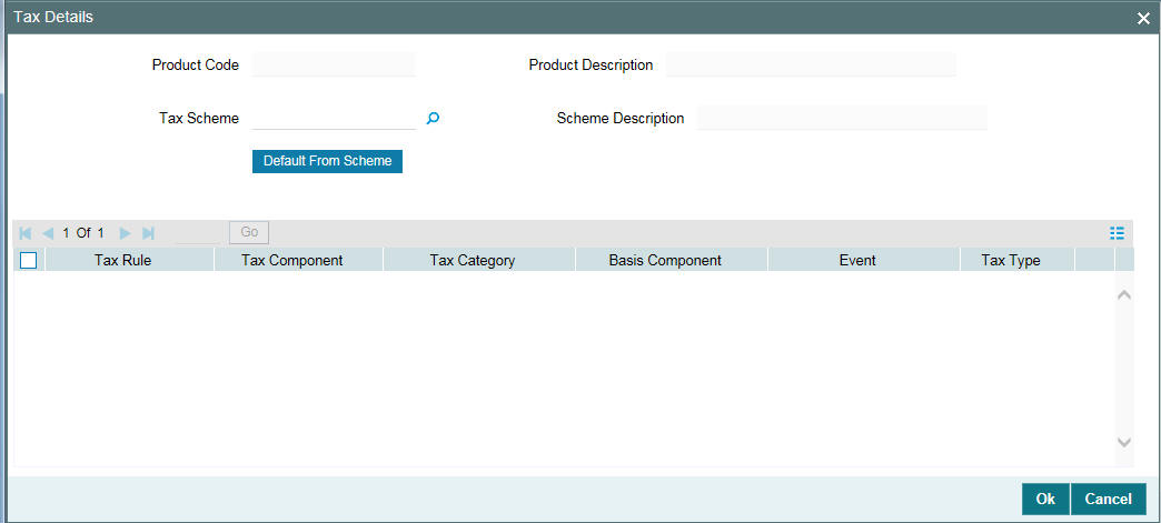

You can click ‘Tax’ option to tax components with a product. The ‘Loan Syndication - Facility Product Definition (FCDPRMNT) is used for a facility product, whereas Loan Syndication - Borrower Product Definition (LBDPRMNT) is used for both tranche and drawdown product.
Specify the following details in this screen:
Tax Scheme
A tax scheme can consist of a set of tax rules that can be applied to a product.
A tax scheme is made applicable to a product when it is linked to the product. Select the applicable scheme from the list. The tax schemes maintained through the ‘Tax Scheme Maintenance’ screen are available in the option list provided.
When you select a scheme, the following defaults:
The tax scheme linked is applicable on a contract processed under the product by default. However, you have the option of waiving the application of tax, for a specific contract.
Tax Rule
A tax rule represents the method in which a specific tax has to be applied. Thus, for a tax component to be levied on a contract, you should specify:
In addition, you can also specify the minimum and maximum amount of tax that can be applied for a specific rule.
Tax Category
You can specify tax category for each tax rule that is linked to a tax scheme. The categories defined through the ‘Tax Category Maintenance’ are available in the option list provided. Select the appropriate one from this list.
Basis Component
Tax can be applied on the basis of any component that is taxable according to the laws in your country. This component is called the Basis Component. The method of tax application defined for the Tax Rule is applied on this component.
Event
You should specify the event upon which the tax is to be applied. For instance, if you specify that the tax be to be applied at the time the fess is collected from the customer, then the entries for tax are passed when the fee component is liquidated.
Tax Type
The type of tax, decides the bearer of the tax. It could be the bank or the customer. A customer bears withholding type of tax and the tax component is debited to the customer’s account. The bank bears an expense type of tax and the tax component is booked to a tax expense account.

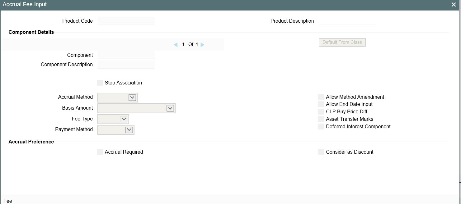

Specifying Accrual Fee Details
You can maintain accrual fee details for a product. These values get defaulted to ‘Amortization Fee Details’ (LFDACFIN) screen
Preferences are those options you can use to specify attributes for a product. These attributes are picked up and applied automatically to any contracts involving the product. For instance, for contracts under a borrower facility syndication product, you can define when intimation must be sent to participants to fulfill their commitments towards a scheduled drawdown.
Click ‘Preferences’ to specify certain preferences unique to the product. The Borrower Facility Product - Preferences (FCDPRMNT) screen is invoked, where you can specify your preferences.
You can associate several tranche products to a facility product. To each of the tranche products, you can associate several drawdown products. Each time you initiate a borrower tranche or drawdown contract under the Facility contract, you have the option of selecting one of the tranche or drawdown products you have associated with the facility product under which you have booked a contract. The system then defaults the attributes of the product to the contract.
Note
This feature allows you to associate any LC product (which can be treated like a drawdown product) with other drawdown products under a tranche. The participant product that is linked to the borrower facility product while defining the participant product is displayed as the ‘Offset Participant Product’.
Example
Let us assume that you are maintaining a borrower facility product called SYN2. You have associated the following products with this product:
Tranche Products
Drawdown products
You are initiating a borrower tranche contract under a main syndication contract involving the syndication product SYN2. Automatically, the system defaults the product codes and attributes of:
Similarly, the product codes and attributes of BD02 and PT02 are defaulted for the corresponding drawdown contracts under each tranche.
Select this option to indicate that you want the system to check whether a schedule date falls on a local holiday defined for the branch. You cannot specify a check for currency holidays, if you choose this option.
Use Local Currency
Holiday Ccy
If the system must check whether the schedule date falls on a holiday defined for the currency of the contract, you must specify the code of the holiday currency. Further, you have the following options to specify the specific currency for which the check must be done:
Cascading Schedules
If you choose this option, the system checks whether the maturity date falls on a holiday defined for the currency of the facility (borrower) contract, if this currency is different from the holiday currency you have indicated.
Use Local Currency
If you choose this option, the system checks whether the maturity date falls on a holiday defined for the local currency, if this currency is different from the holiday currency, facility currency and contract currency you have indicated.
Holiday Ccy
If you have specified that the system check for maturity dates falling on holidays, you must also specify the treatment for maturity dates encountered by the system that do fall on holidays. The following preferences can be set:
You can also specify the different types of entities or parties that would be applicable for the borrower facility product in the Party Association screen. Click ‘Party Type’ in the Facility Product Definition screen to invoke the Party Association screen.
For each party type that you associate in this screen, you can specify:
In the Diary Event Association screen, you can also specify the different diary events that would need to be processed for borrower facility contracts using the borrower facility product.
Click ’Diary Event’ in the Facility Product Definition screen to invoke the Diary Event Association screen.
Note
If you have selected the product type as ‘Collateral Online’ or ‘Collateral Settlements’, ‘Diary Event’ is disabled.
After you have specified all the mandatory information required for the product in the product definition screens, you could save the product. You are not allowed to save the product until you have specified all the mandatory information.
When you save the product, the following information is updated and displayed in the status bar of the Product Definition main screen:
In addition, the status of the product is updated as Open and Unauthorized. Another user with authorization rights must authorize it, before you can begin to use it.

In the ‘Loan Syndication –Borrower Product Preference’ screen, select the ‘Schedule Type’ of the product as ‘Amortize’ and check the ‘Allow user input Installment’ and ‘Allow Re-amortization‘ option selected. During the contract maintenance, you can maintain installment amount for an amortized contract only if this flag at product level is enabled.
The following flags are not allowed to be checked for amortize schedule type products:
