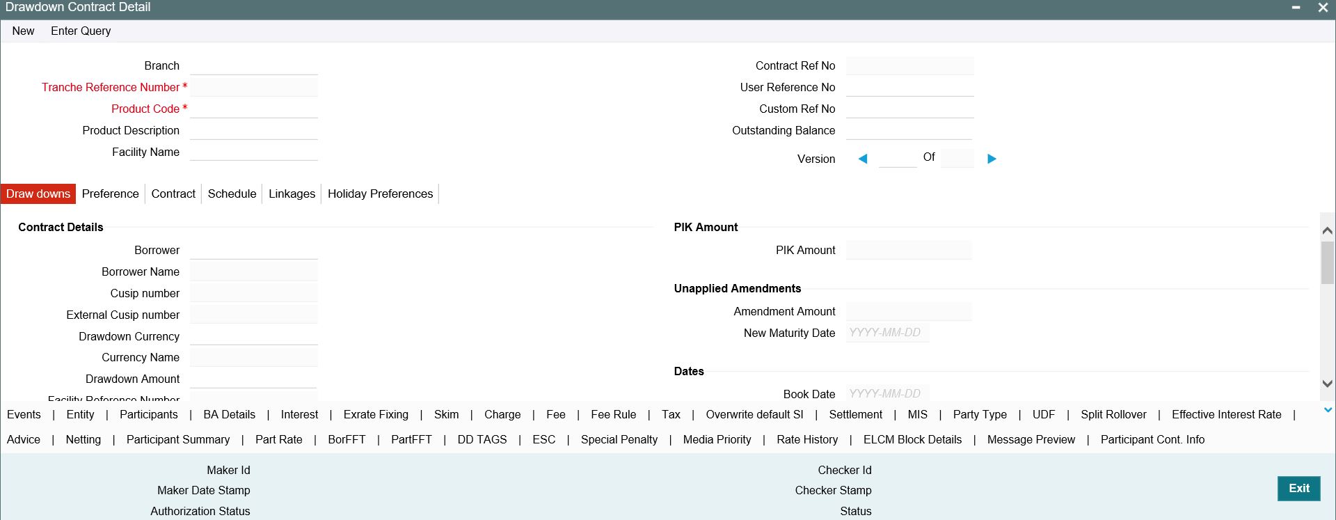

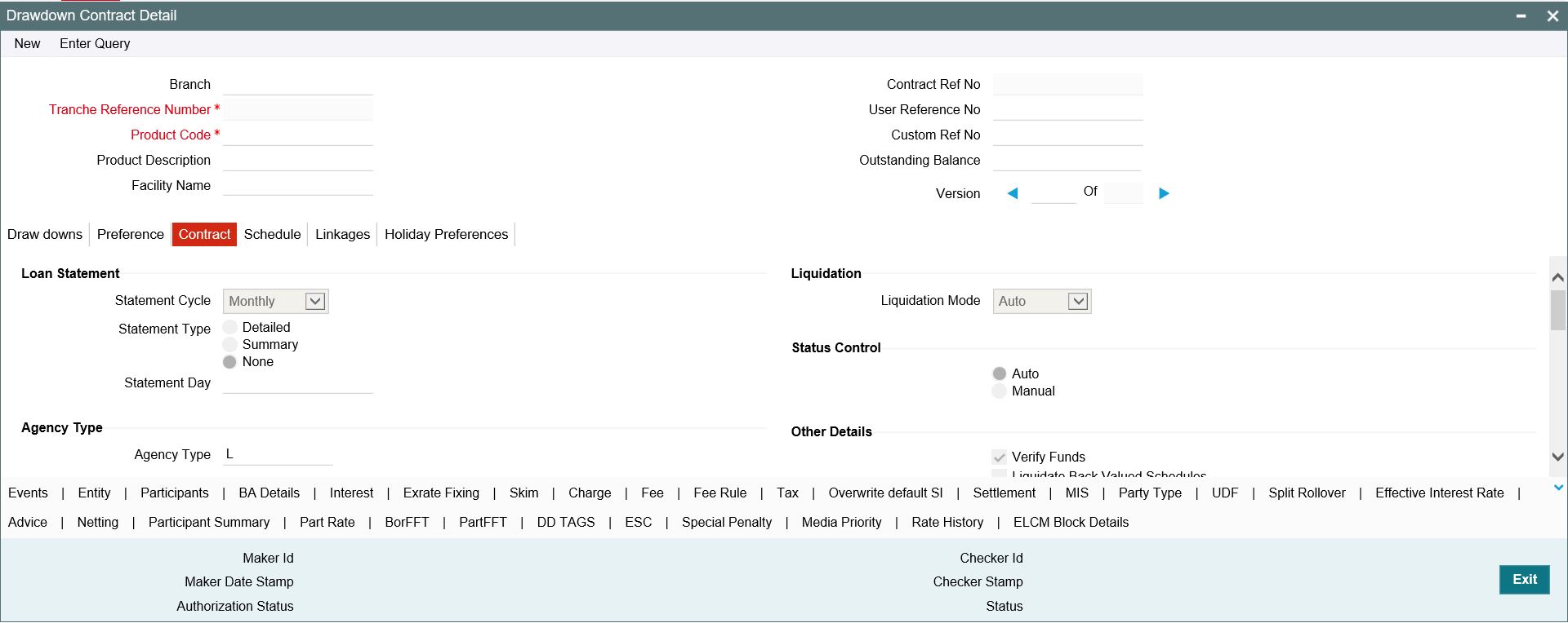

You can process a drawdown contract in the ‘Drawdown Contract Online’ screen. You can invoke the ‘DrawDown Online’ screen by typing ‘LBDDDONL’ in the field at the top right corner of the Application tool bar and clicking the adjoining arrow button.
The screen is displayed with details of an existing drawdown contract, as shown below.
When you are capturing a new drawdown, Oracle Banking Corporate Lending validates the following:
You can capture a drawdown contract either by:
For more details, refer the heading ‘Entering the facility details’ in this chapter.
6.1.1 A description of the ‘Drawdown Contract Online’ Screen
You can capture the following in for a drawdown:
You capture information pertaining to the drawdown in the following tabs of the screen:
In addition, a vertical toolbar provided in the screen, may be used to invoke other sub-systems meant to capture important information for the drawdown.
These buttons are same as the ones available for the ‘LB Tranche Contract Online’ screen, except for the following:

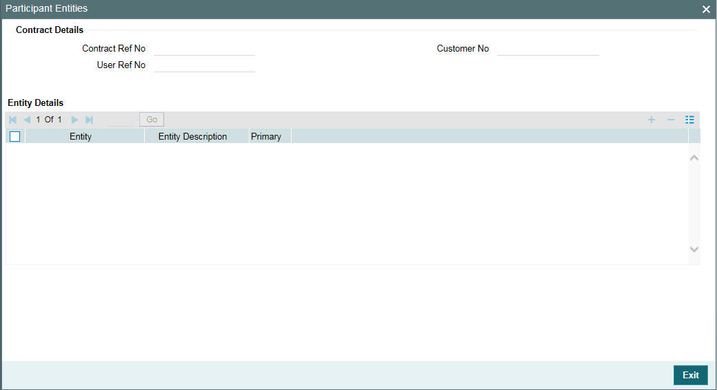

‘Entity’
Click this tab to view/modify the entity details for the drawdown

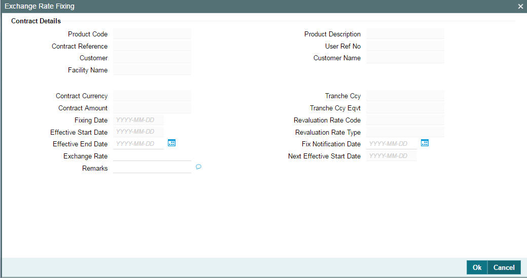

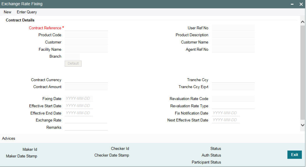

‘Exrate Fixing
Click this tab to fix the exchange rate for a cross currency drawdown

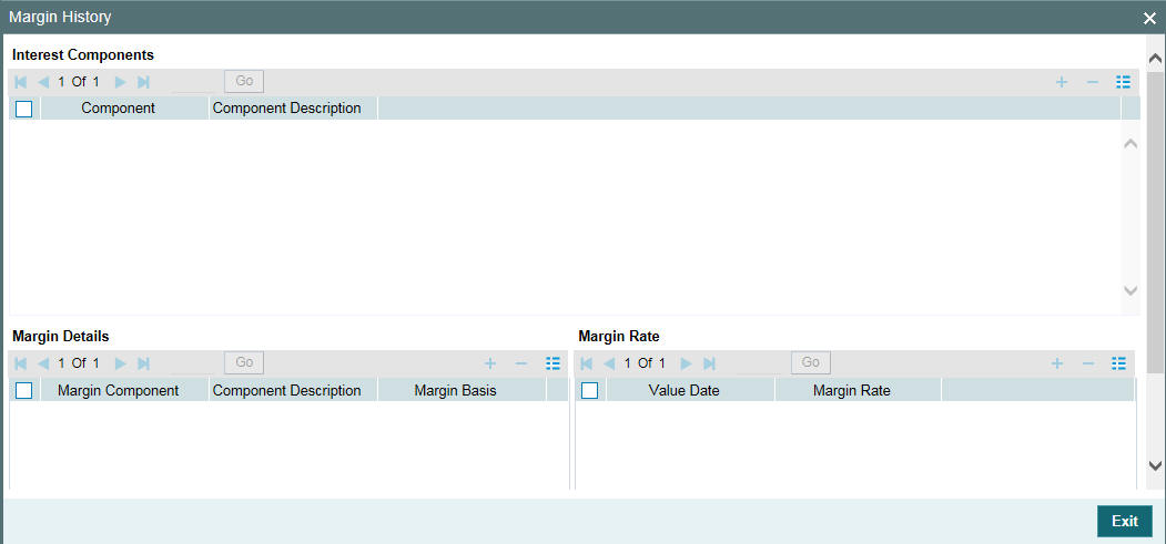

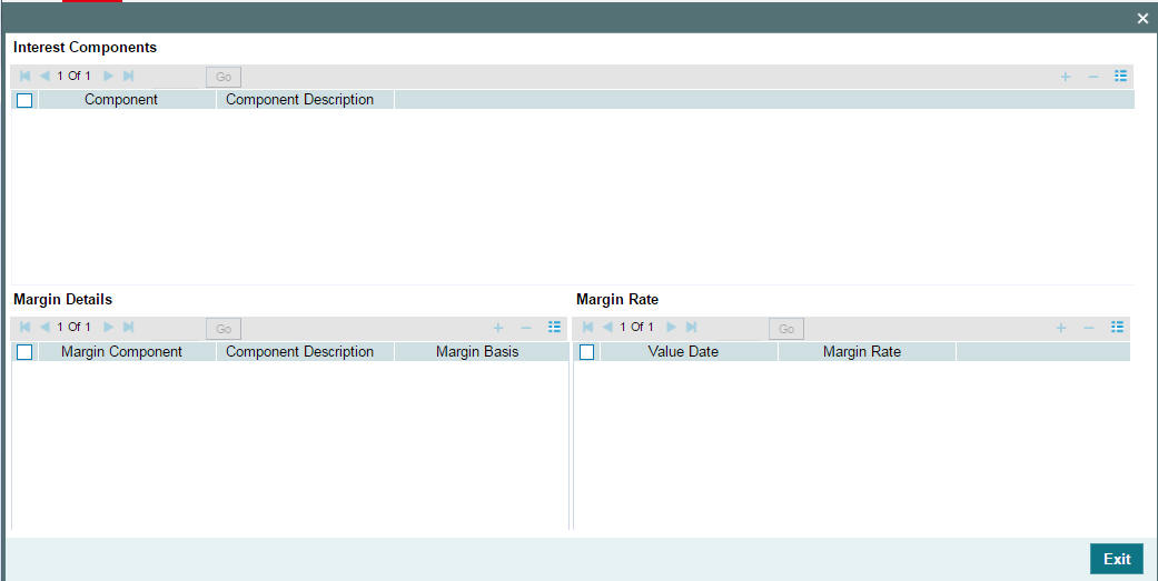

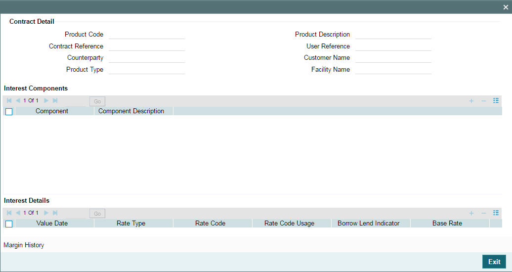

‘Interest’
Click this tab to view the interest and margin components

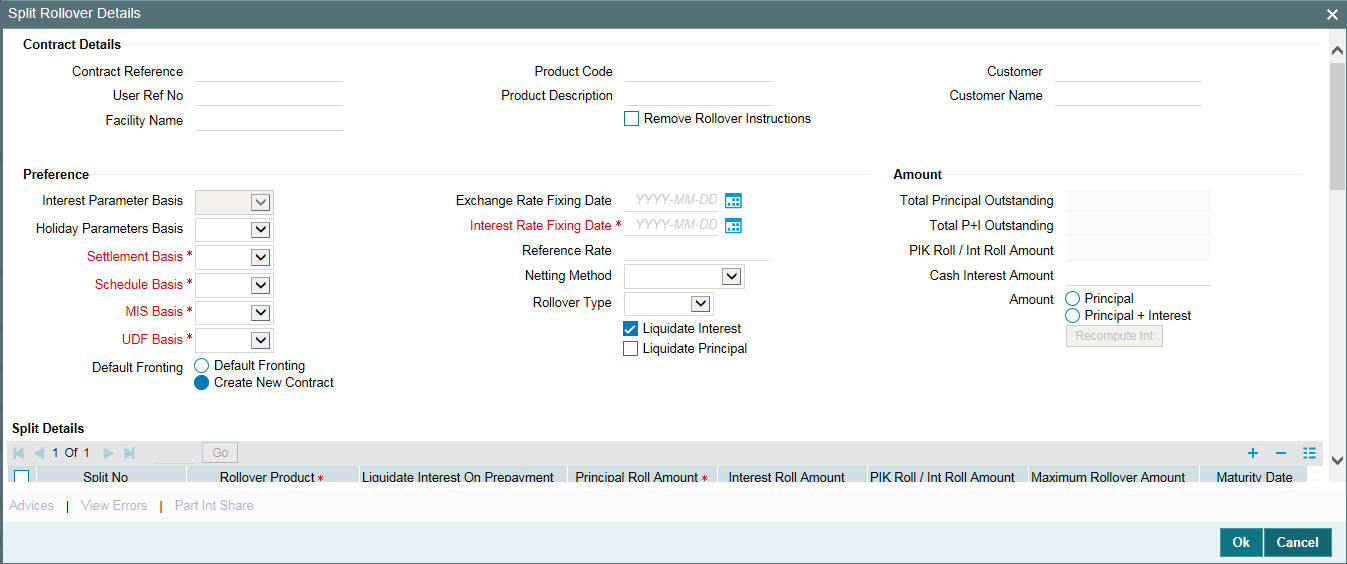

Split Rollover
Click this tab to specify the spilt rollover details if applicable for the draw­down

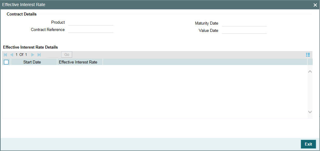

‘Effective Inter­est Rate’
Click this tab to view the Effective Interest (EI) rates for the drawdown
‘Media Priority’
Click this tab to specify the media for message generation
6.2 Capturing Drawdown Details
To capture a new drawdown, click New from the menu.
The ‘Drawdown Type’ is displayed as ‘New’. The contract inherits the details of the template. Alternatively, you can also select the following details to capture a new drawdown:

Exchange Rate needs to be fixed!
The ‘Exchange Rate Fixing Date’ displays the current system date (booking date of the drawdown).
Note
If the drawdown currency is different from the tranche currency and the ‘Exchange Rate Code’ that defaults from the product is not maintained for the currency pair (tranche and drawdown currencies), the system displays an error message.
For more details on exchange rate fixing, refer the heading ‘Fixing exchange rate for the DD currency’ in this chapter.

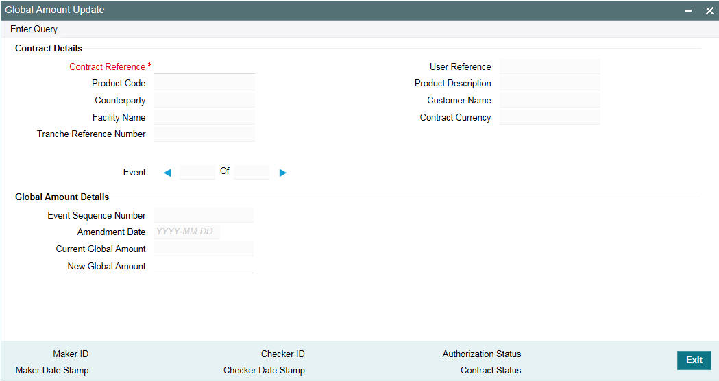

Global DD Amount
The Global Drawdown amount is computed and populated during new drawdown booking based on the Tranche, Global Tranche, and Drawdown amounts. The Global Drawdown Amount is computed as follows:
Global Drawdown Amount = (Global Tranche Amount / Tranche Amount) * Drawdown Amount.
You can amend this amount only for non-lead drawdowns and only if the corresponding Tranche has ‘Cascade Participation’ set to ‘No’. You cannot amend this amount if the underlying Tranche has ‘Cascade Participation’ set to ‘Yes’. The latest Global Amount as on the date of handoff is used for handoff of the Commitment Reduction to the Loans QT system.
However, only those Drawdown Global Amounts, with cascade participation set to N, can be amended using the new screen Global Amount Update/Amendment screen.
Note
The Global Drawdown amount cannot be updated during drawdown amendments.

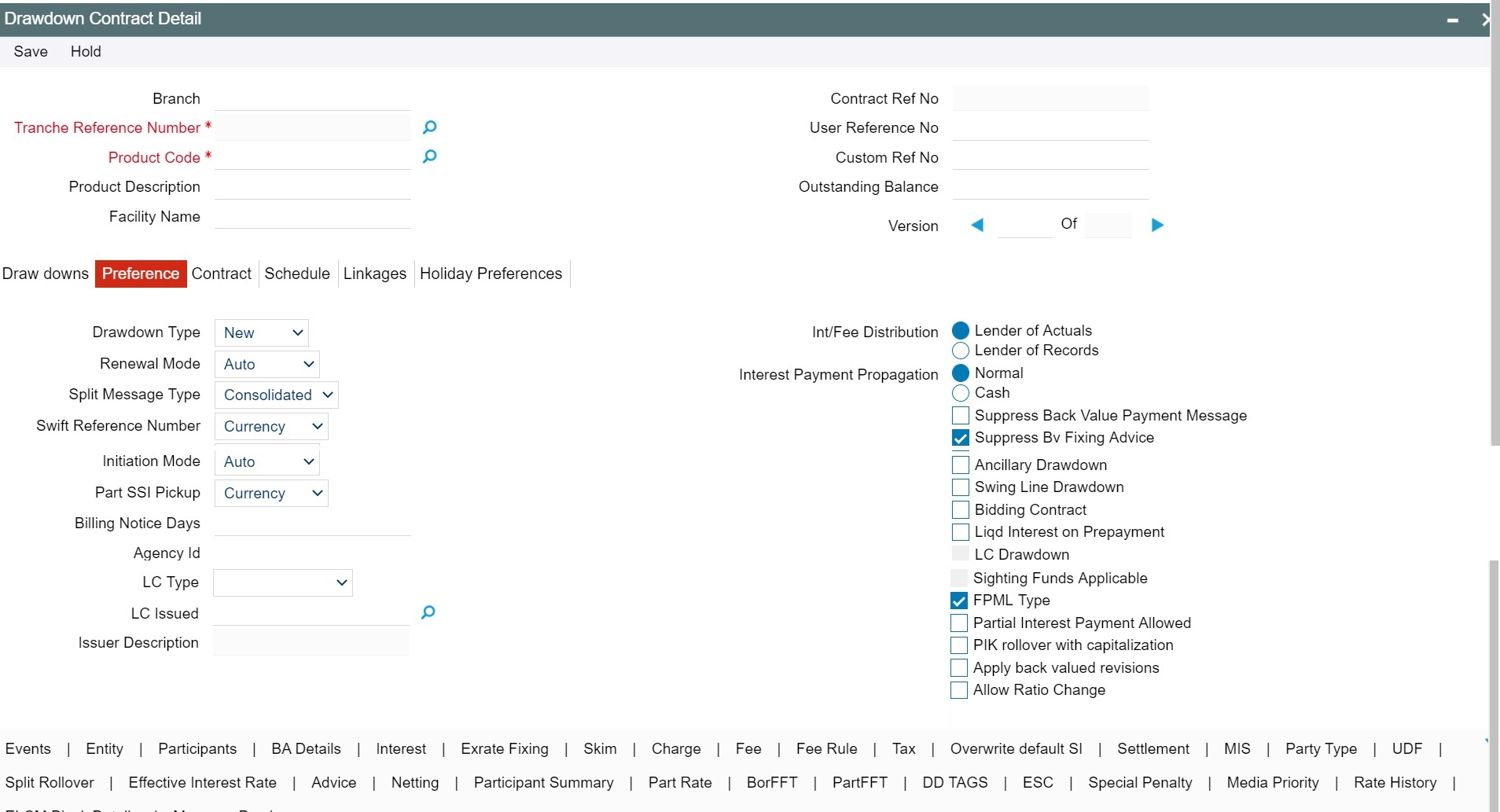

6.2.2 Capturing Details in the ‘Preferences’ Tab
Drawdown Type
This indicates whether you are defining a new drawdown or renewing an existing drawdown. For a new drawdown, ‘New’ is displayed and you cannot change it.
Renewal Type
The ‘Rollover Method’ you specify for the drawdown product will default here. You can change it at the drawdown level. Specify the manner in which the drawdown should be renewed/rolled over. The options available are:
Note
Irrespective of the type of renewal you select here, the system allows you to capture in­structions for any one of the renewal types mentioned above. Depending on the type of instructions you capture, the system automatically updates the ‘Renewal Type’ with the lat­est value when you save the instructions.
Split Message Type
You can select this message type only if the ‘Renewal Type’ is specified as ‘Split’. The message types available are:
INIT Mode
This specification defaults from the tranche. You can change it for the drawdown, if required. This will indicate the mode of initiating the drawdown in the system. The following options are available:
For more details on this screen, refer the heading ‘Specifying participant details for the tranche’ in this chapter.
Suppress B.V Fixing Advice
You can check this option to stop the generation of payment messages when back valued schedules for a back-dated drawdown (with initiation date before today’s date) is liquidated.
Ancillary Drawdown
Oracle Banking Corporate Lending allows you to process Ancillary drawdowns under a tranche. Check this option to indicate that you want to process an Ancillary Drawdown.
This check box is enabled under the following conditions:
A pro-rata tranche is converted to a ‘Non-Cascade’ type once you save the drawdown and it remains as Non-Cascade even on repayment of the drawdown. You can send out participant FFT messages to all the lenders in the syndicate in case of ancillary drawdowns and amendments of the same. You need to maintain a separate advice template for this which you can choose in the FFT screen.
Note
Swing Line Drawdown
You can check this option while booking the new drawdown to identify a swing line drawdown. You cannot make any changes to this during the amendments of the drawdown at the contract level.
For more information on swing line refer to Loan Syndication – An Overview chapter.
Note
If you process a swing line drawdown under a tranche for which the ‘Cascade Participa­tion’ option is checked, the system automatically converts the tranche into a non-cascade participation type.
Further, it triggers the event ‘CASC’ to indicate this conversion.
Bidding Contract
You can select this check box to specify whether the contract is of competitive bidding type.
Note
You can process a bidding contract under tranches for which the ‘Cascade Participation’ option is not checked.
Sighting Funds Applicable
The value for this field is defaulted from the corresponding tranche and you are not allowed to modify this value.
Note
Liqd Interest on Prepayment
Select this check box to indicate if interest should be liquidated as part of prepayment. This check box is enabled only for Prime contracts.
In other words, you can liquidate an interest component for a contract on prepayment, only if you have selected this check box and also the ‘Prime Loan’ check box for a product in the ‘Loan Syndication – Borrower Product Preferences’ screen.
If this check box is selected, Oracle Banking Corporate Lending allows you to define only a bullet interest schedule. Otherwise, you can define a frequency-based schedule.
Note
FpML Type
Select this check box to indicate that the FpML type is required for the DrawDown contract.
If you have selected this box, the system does the following:
If you have not selected this check box and the ‘Media Priority’ option is selected at the product level, then ‘Media Priority’ tab is enabled.
For more information, refer the section ‘Specifying Media for Message Generation’ in this chapter.
Partial Prepayment Allowed
Select this check box to indicate that for drawdown products, partial prepayment is allowed.
Note
Partial prepayment is allowed only for drawdown products where,
Allow Ratio Change
Select ‘Allow Ratio Change’ check box if you want specify the participant ratio change in ‘Loan Syndication - Contract Payment’ screen (LBDPYMNT).
LC Type
This specification defaults from the product. You may change it at the contract level, if required. The available types are:
Note
You can select the type of LC only if the ‘LC Drawdown’ option is checked for the draw­down.
If you check the ‘LC Drawdown’ option for the product, the same defaults to all drawdowns and you cannot amend it at the drawdown level.
LC Issuer
If the drawdown is an LC type of drawdown, you have to select the issuer of the LC as mandatory information. The option list displays the names of participants you have identified as issuers of LC. This is done at the tranche level.
The LC Issuance Fees is paid to the participant who is identified as the issuer of LC. This fee is computed on the outstanding amount of all the LC drawdowns for the selected issuer.
For more details on this, refer the heading titled ‘Identifying participants as issuers of LC’ in this chapter.
Int/Fee Distribution
System displays the method in which the interest and fee components are distributed among the participants when an assignment is executed before the liquidation date. The distribution type is classified into - ’Lender of Actuals’ type and ’Lender of Record’ type.
This is defaulted from the tranche level.
SSI Pickup At
This option defaults from the tranche. You can opt for a different value for the drawdown, if required. This indicates the basis for picking up the SSI (Standard Settlement Instructions) Mnemonic for the drawdown.
The available options are:
For more details on this screen, refer the heading ‘Specifying drawdown participant details’ in this chapter.
Billing Notice Days
This defaults from the drawdown product. You can change default value, if required.
This indicates the number of working days before the repayment due date when a billing notice should be generated, to be sent to a customer as a reminder of the payment.
PIK Rollover with capitalization
Select this check box to indicate that the PIK rollover with capitalization is allowed for the contract. You can amend this value after the Rollover is removed\reversed. You cannot amend the value if the interest component linked to Tranche PIK margin component is having non- zero rate.
Interest Payment Propagation
Select the interest payment for the drawdown from the below two options:
Cash payment can be processed as part of manual payment, split rollover and consolidated rollover processing. The field value for the child contract gets defaulted from parent contract during split rollover processing. During consol rollover processing, the value gets defaulted to child contract from the driver contract.
You cannot book drawdown booking with ‘Interest Payment Propagation’ as ‘Cash’ if below mentioned existing flags are checked for drawdown contract
You cannot book drawdown under lead tranche with ‘Interest Payment Propagation’ as ‘Cash’.
After the drawdown is authorized, amendment of interest payment propagation is allowed under the below validations:
For the drawdowns under lead tranches, the value is ‘Normal’ always. All the existing lead and non lead tranches, the ‘Interest Payment Propagation’ gets updated as ‘Normal’.
Named Agent
System defaults the value of the named agent maintained in the tranche contract online screen, while booking a new drawdown, in this field.
System also displays the name of the named agent adjacent to the Named Agent field.
Agreement/Administrator/Internal Remarks
These details gets default from the tranche contract and may be changed at the drawdown level.
6.2.3 Capturing Details in the ‘Contract’ Tab
You can capture the other contract details in the ‘Contract’ tab of the screen.
The following contract details applicable for drawdowns are explained below:
6.2.3.1 Liquidation
Mode of liquidation of interest and fee components associated with the drawdown defaults from the drawdown product.
At the drawdown level, you can change the mode to any one of the following methods:
For more details on ‘Contract Payment’ screen, refer the heading ‘Processing Repayments Manually’ in the ‘Processing Repayments’ chapter of this User Manual.
For more details on ‘Fee Liquidation’ screen, refer the heading ‘Liquidating Fee Components’ in the ‘Processing Charges and Fees’ chapter of this User Manual.
For more details on this screen, refer the heading ‘Forward processing of events’ in this chapter.

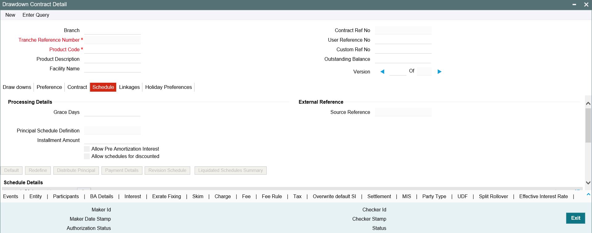

6.2.4 Capturing Details in the Schedule tab
You can capture the details pertaining to the drawdown schedule in the ‘Schedule’ tab.
The information available in this screen is discussed below:
6.2.4.1 Specifying Holiday Treatment for Schedules
The holiday treatment you specified for the DD product defaults to the drawdown. However, you can change the details, if required.
Note
The system redefines the future schedule dates for Principal, Fees, and Interest compo­nents based on the changes made.
For details on the available options, refer the heading ‘Specifying Additional Preferences for Loan Syndication’ in the ‘Defining Products for Loan Syndication’ chapter of this User Manual.

6.2.4.4 Specifying Repayment Schedule Details
The repayment schedule definition for the drawdown is based on the repayment processing rule specified at the tranche level. The available rules are:
For more information on the above rules, refer the heading ‘Specifying processing rules for the tranche’ in this chapter.
Further, it also depends on the ‘Auto Repay Schedule’ option defined for the tranche (in the ‘Schedule’ tab of the ‘LB Tranche Contract Online’ screen).
Note
The drawdown repayment schedules are determined by the reduction schedules only for drawdowns with the following attributes which are defined as part of drawdown product preferences.
The repayment schedule details include the following:
Type

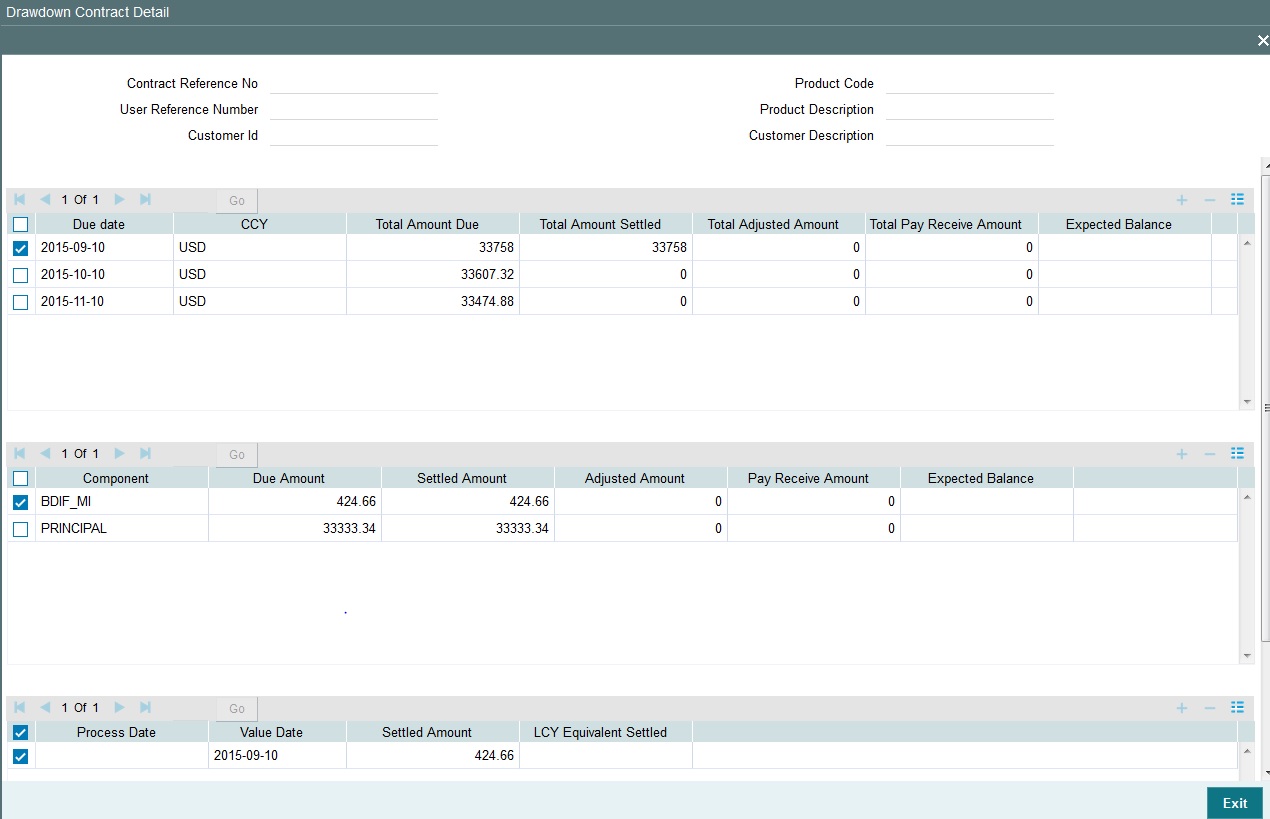

6.2.4.6 Viewing Drawdown Payment Schedule Details
Based on the payment schedules captured for the components, Oracle Banking Corporate Lending computes the schedules and the amount payable for each schedule in the ‘Payment Schedule Details’ screen.
Click ‘Payment Details’ button from the ‘Schedule’ tab.

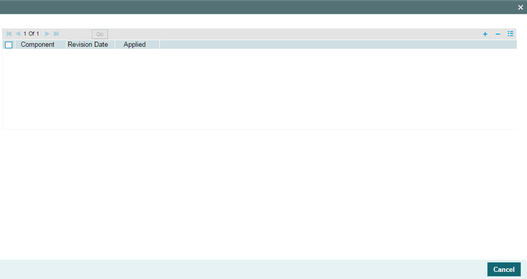

6.2.4.7 Viewing Drawdown Revision Schedule Details
To view the rate revision schedules, click the ‘Revision Schedule’ button. The ‘Revision Schedule Details’ screen appears.
The following details are displayed in this screen:

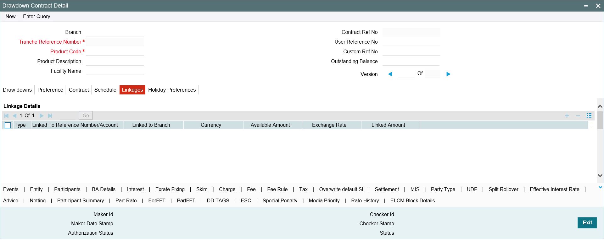

6.2.6 Viewing Linkage Details for the Drawdown
In the ‘Linkage Details’ section of the screen, you can view the details of the tranche under which the drawdown is processed. The following details are displayed here:
Note
For ELCM linkage, you can link the facility, collateral and collateral pool of counterparty and other additional borrowers as part of loan creation.

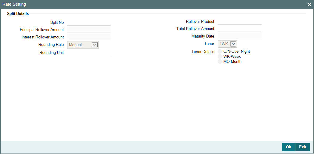

6.2.7 Capturing Details in the ‘Split Rollover’ Tab
You can rollover a drawdown only if you have checked the ‘Allow Rollover’ option for the drawdown product used to process the drawdown. If this option is not selected, the following message appears when you click ‘Rollover’ tab:
“Rollover not allowed”

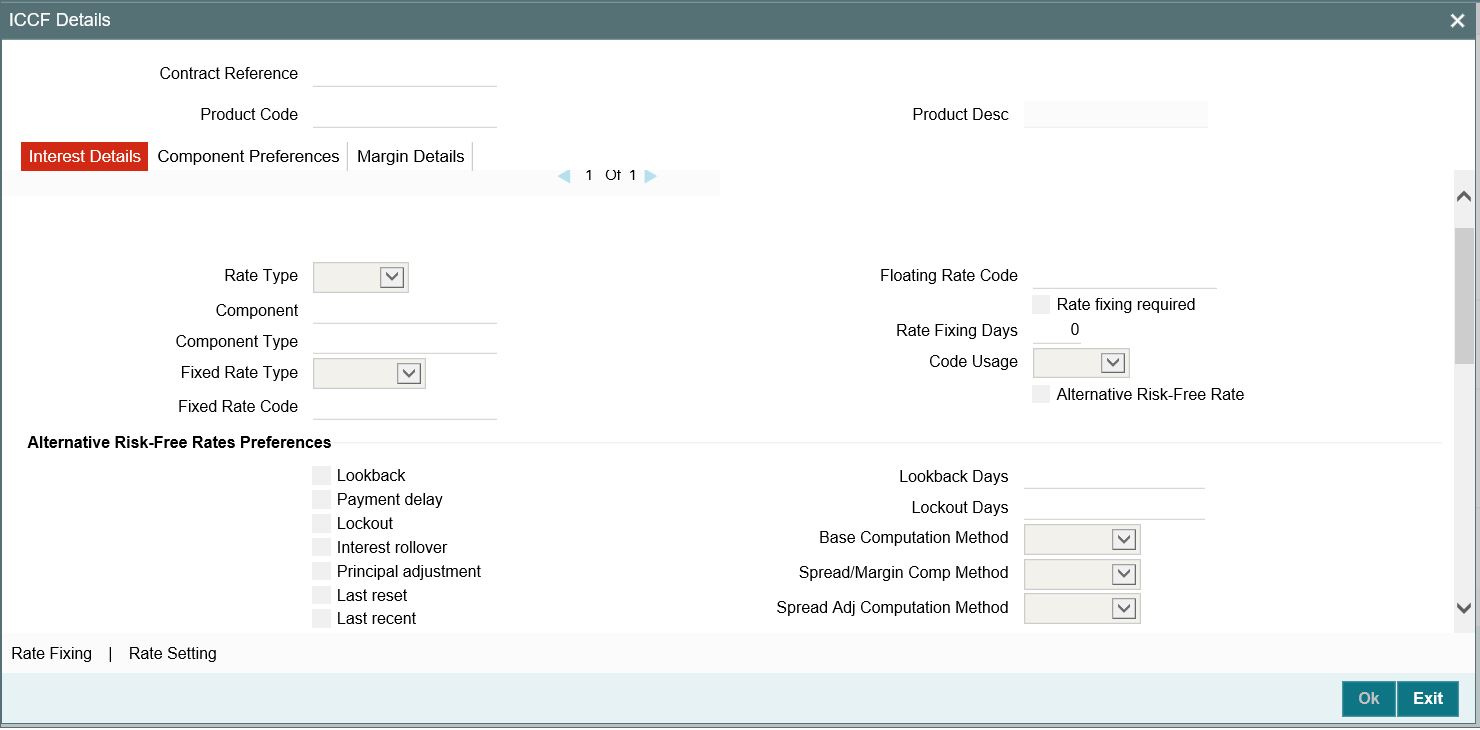

Click ‘Interest Details’ button to enter interest related details and also RFR (Risk Free Rate) details. For more information on RFR, refer to Interest User Guide.
For details on rollover and information on the ‘Rollover’ tab, refer the ‘Rolling-over a drawdown’ chapter of this User Manual.

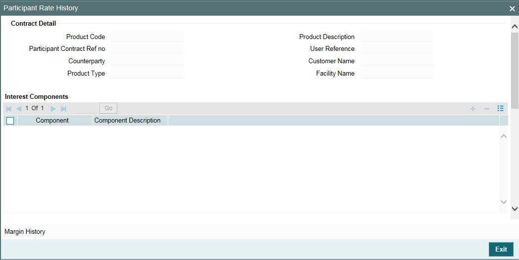

6.2.8 Viewing Rate History Details
You can view the Interest rate and margin rate history for each drawdown in the ‘Rates History’ screen. This screen holds the history of interest rate and margin changes that have happened for the drawdown. Click ‘Rate History’ tab to invoke this screen.

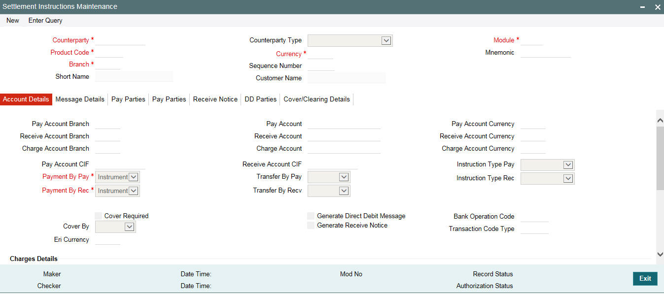

You can view the borrower entity details in the ‘Borrower Entities’ screen. These details default from the tranche associated with the drawdown. Click the ‘Entity’ tab to invoke this screen.
You can modify only the following parameters:
SSI Counterparty
By default, the drawdown borrower is displayed here. You can change the counterparty if the borrower requests to process the settlements through another account. The option list displays the names of all the customers maintained in Oracle Banking Corporate Lending.
SSI Mnemonic
SSI Mnemonics are maintained in the ‘Settlement Instructions’ screen for a Counterparty, Module, Currency, Product and Branch combination. The same is available for the counterparty/borrower of the drawdown. The Mnemonic selected here obtains the settlement details for the borrower of the contract and the same defaults to the ‘Settlement Message Details’ screen.
If you do not select the SSI Mnemonic, system defaults the SSI Mnemonic for the counterparty and contract currency when you exit the screen.
Note
Note the following:
Select the appropriate ssi mnemonic applicable for the selected currency

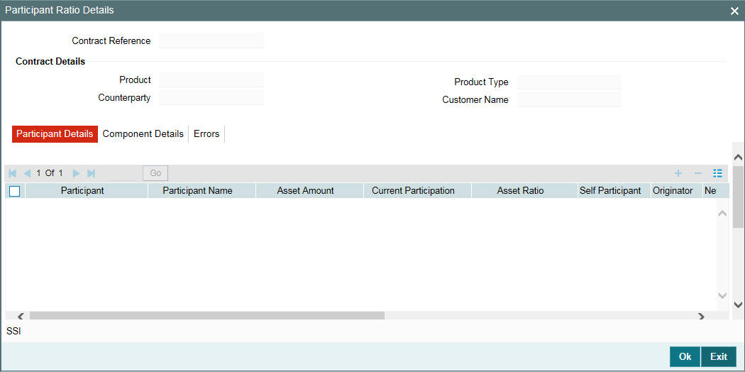

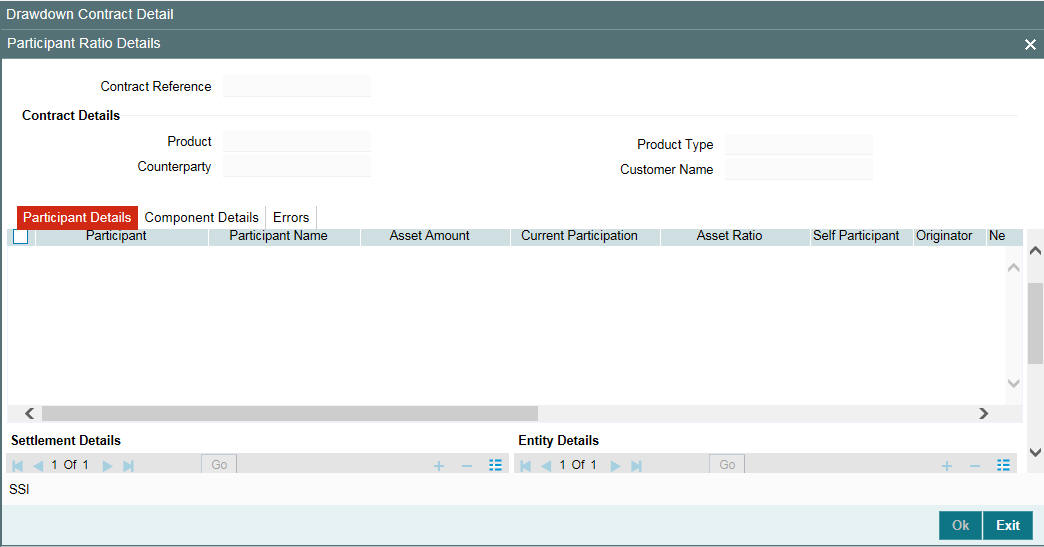

6.2.10 Specifying Drawdown Participants
You must also identify the participants who contribute to the amount being disbursed under the drawdown. A borrower drawdown contract inherits the participant details defined for the borrower tranche under which it is entered. You can make changes to the defaulted participant details when you enter a borrower drawdown. To view the details in the ‘Participant Ratio Details’ screen, you have to click the ‘Participants’ tab.
Based on the drawdown amount, the system computes the contribution of each participant towards the drawdown as per the ‘Asset Ratio’ maintained for the tranche.
You can change the default participant details in this screen. Upon change of participants, the system automatically convert a ‘Cascade Participation’ type of tranche to a ‘Non Cascade Participation’ type. The ‘CASC’ event is triggered to indicate the change in the attribute and the ‘Cascade Participation’ option for the underlying tranche (in the ‘CONTRACT’ tab of the ‘LB Tranche Contract Online’ screen) is deselected. If changing the participant details is possible, you can specify the following details for each participant, for the drawdown schedule:
For example, let us assume a tranche amount of USD 10 million. The Asset Sharing Ratio (ASR) for various participants can be calculated as follows:
Participant
Asset amount in USD
ASR in %
CITIBANK
2,000,000
20
BAR­CLAYS
2,000,000
20
NATWEST
3,000,000
30
HSBC
3,000,000
30
At the drawdown level, you can choose to change the asset sharing ratio of the participants in the following manner, if required.
Let us assume that the first drawdown amount is USD 4 million. The Asset Sharing Ratio (ASR) for this amount is as follows:
Participant
Asset amount in USD
ASR in %
CITIBANK
1,200,000
30
BAR­CLAYS
400,000
10
NATWEST
1,600,000
40
HSBC
800,000
20
When you change the ASR for a drawdown under the tranche, the ASR at the tranche level will remain the same. However, at the time of a second drawdown, the ASR at the drawdown level displays the availability ratio instead of the tranche asset sharing ratio.
Note
The original asset sharing ratio is displayed only at the Tranche level.
The availability ratio after the first drawdown is as follows:
Participant
Asset amount in USD
ASR in %
Availability amount
Availability ratio in %
CITIBANK
2,000,000
20
800,000
13.33
BAR­CLAYS
2,000,000
20
1,600,000
26.67
NATWEST
3,000,000
30
1,400,000
23.33
HSBC
3,000,000
30
2,200,000
36.67
The availability amount is computed on the following basis:
The availability amount could vary for revolving and non-revolving tranche.
For revolving tranche contracts, the available amount will be calculated as follows:
For non-revolving tranche contracts, you can compute the available amount in the following manner:
You can change the asset sharing ratio for participants on a non proportionate basis using the ‘Contract Payment’ screen.
For more information on this, refer the section ‘Processing Repayments Manually’ in the ‘Processing Repayments’ chapter of this User Manual.
For details on fields available in this screen, refer the heading ‘Maintaining participant details for the tranche’ in this chapter.
In addition to the above, you can do the following through this screen:
For details on the above procedures, refer the following headings in this chapter:

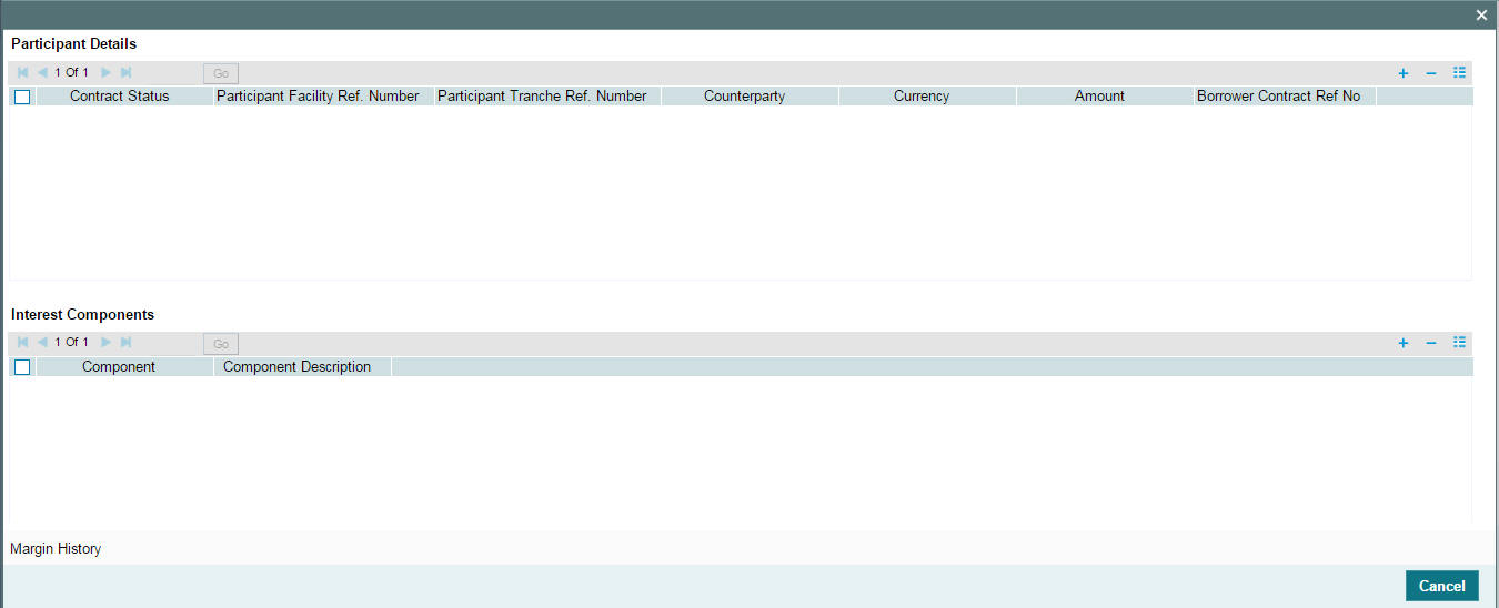

6.2.12 Viewing Participant Margin Details
You can view margin details maintained for participants of the drawdown contract, using the ‘Participant Rate Summary’ screen. To view this screen, you have to click the ‘Part Rate’ tab.
Here you can view the following details.
Participant Details
The system displays the following participant details:
Interest Components
The system displays the following component details.
Interest Details
The system displays the following interest details.
Margin Details
The system displays the following margin details.
6.2.12.1 Viewing Margin History
You can view margin details of all participants including the margin history by clicking the ‘Margin History’ button on the ‘Participant Rate Summary’ screen.
The system displays the following details.
Margin History Interest Component
Margin Details
Margin Rates
The system displays the following margin rate details.
The margin rate maintained for the individual participant is considered while calculating the interest due on the participant side, during contract booking. This is applicable for current dated/back dated/forward dated drawdown bookings.
6.2.13 Fixing Exchange Rate for Drawdown Currency
You will need to fix the exchange rate for drawdowns only if the drawdown currency is different from the tranche currency. The exchange rate fixing days refers to the number of business days before the value date of the drawdown or the new rate fix period. Exchange rate fixing for the new drawdown or the new rate fix period is done on this day.
To fix the exchange rate for the drawdown currency, click ‘Exrrate Fixing’ tab. The ‘Exchange Rate Fixing’ screen is displayed, as shown below:
The system arrives at the exchange rate fixing date for the drawdown currency based on the exchange rate fixing days maintained at the tranche level and the holiday validation currencies specified for the drawdown currency.
For more details, refer the heading ‘Specifying currency details for the tranche’ in this chapter.
You can specify the following details in this screen:
Effective End Date
You have to specify an end date for the new rate to be effective in the system. The start date will be equal to the drawdown date. You have to capture the date in ‘DD-MMM-YYYY’ format.
Exchange Rate
The default exchange rate is displayed here. The system picks up this rate from the ‘Currency Rates Maintenance’ screen. You can change the rate, if required. You can enter upto 15 decimal points.
Remarks
You can also capture additional information, if required. This is used only for information purposes.
Note
It is not mandatory for you to fix the exchange rate before you fix the interest rate.
6.2.13.1 Saving the New Exchange Rate
Click ‘Ok’ button to save and exit the screen. When you save the drawdown, the system triggers the ‘EXFX’ event with the exchange rate fixing notice. For future dated drawdowns, you need to fix the exchange rate before the value date of the drawdown.
Subsequently, you have to manually fix the exchange rate for the drawdowns. You have to fix the rate for the next period before the end of the current period. However, if you do not do the rate fixing for the subsequent periods, Oracle Banking Corporate Lending applies the latest fixing rate for the rest of the period.
Note
For more information, refer the heading ‘Fixing Exchange Rate after drawdown booking’ in this chapter.
6.2.14 Specifying Drawdown Interest Details
You can view the interest and margin components, if applicable to the drawdown, in the ‘ICCF Details’ screen. These details default from the tranche under which the drawdown is being processed. Click ‘Interest’ tab to invoke this screen.

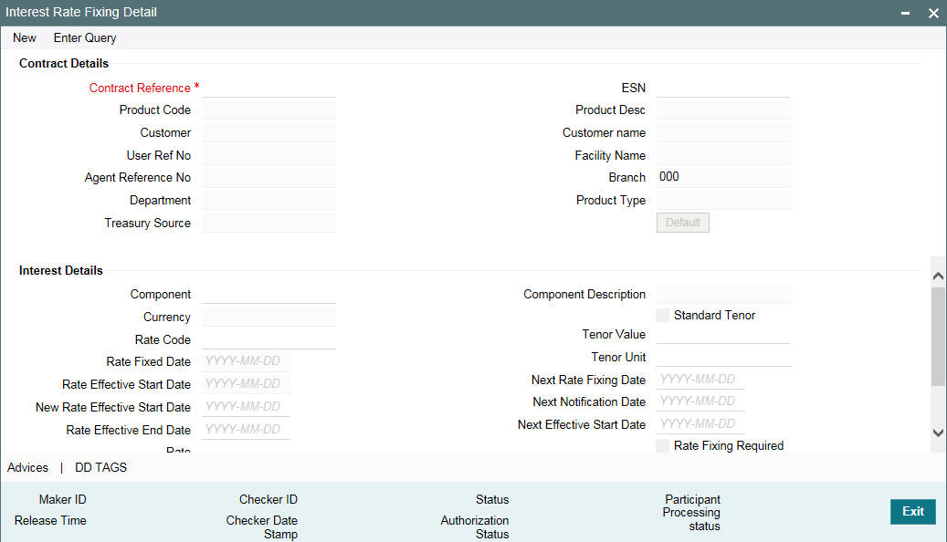

To fix the interest rate for the drawdown currency, click the ‘Rate Fixing’ tab in the ‘ICCF Details’ screen and invoke the ‘Rate Fixing Details’ screen, as shown below:
Note
Rate Fixing button gets enabled in ‘ICCF Details’ screen only if rate fixing is selected at the product level.

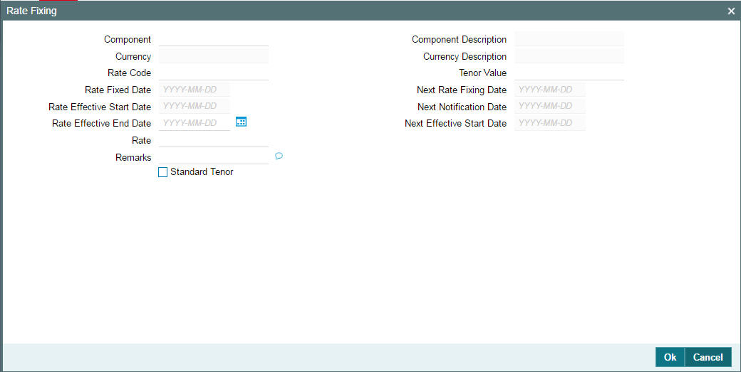

You can specify the following details in the ‘Rate Fixing Details’ screen:
Rate Code
You have to specify the floating rate code based on which you can specify the interest rate fixing tenor and the default fixing rate.
Tenor Value
You can specify the rate fixing period by specifying a ‘Tenor Value’ or the ‘Rate Effective End Date’. If you are specifying a tenor, you can select a value from the option list which displays the tenor values associated with the rate code you select. This is based on your maintenance in the ‘Floating Rate Code Definition’ screen. Upon choosing a value, the following details are also displayed:
If you do not want to specify a ‘Tenor Value’, you have the option to capture the end date of the rate fixing period. This date should not be less than or equal to the ‘Rate Effective Start Date’. The system displays the following after you specify the end date:
Rate
The system defaults the interest rate based on the rate code and the tenor value/effective end date you specify for the drawdown. You can change the default rate, if required.
If the base rate is changed or new rate is added or the floating rate codes are changed, the system recalculates the interest. Note that it considers the margin rates maintained for the participants while recalculating the interest due for the participants.
For more details on negative rate processing, refer the title ‘Maintaining Loans Parameters Details’ in the chapter ‘Bank Parameters’ in Core Services User Manual.
Remarks
You can also capture additional information, if required. This will be used only for information purposes.
Click the ‘Ok’ button to save and exit the screen.

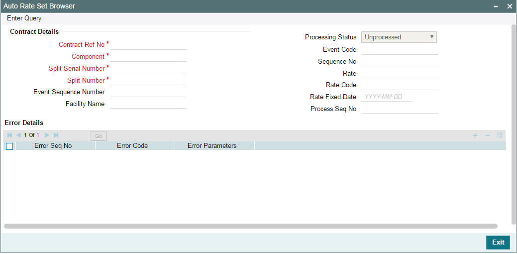

Rate Setting
To set the rate setting rules for the borrowers drawdown, click the ‘Rate Setting’ in the ‘ICCF Details’ screen and invoke the ‘Rate setting’ screen, as shown below:
Specify the following details.
Contract Details
Product code
The system displays the product code.
Contract Ref number
The system displays the contract ref number.
User ref number
The system displays the user ref number.
Customer
The system displays the customer name.
Facility name
The system displays the facility name.
Split Details
Split number
The system displays the split number.
Principal roll amount
The system displays the principal roll amount.
Interest roll Amount
The system displays the Interest roll amount.
Roll Product
The system displays the roll product.
Total roll amount
The system displays the total roll amount.
Maturity date
The system displays the maturity date.
Interest rate rounding rules
Rounding rule
Select the rounding rule from the adjoining drop down list. Select one of the options listed below:
Rounding Unit
The rounding unit enables only if the you have selected the ‘rounding rule’ as ‘Down’ and ‘Upto’
Interest rate period
Select one of the interest rate periods from the options given.
Once all the Rate setting rules are maintained and when you come out of ‘Rate Setting Rule screen’ by clicking OK button (Green tick), the following override messages are displayed

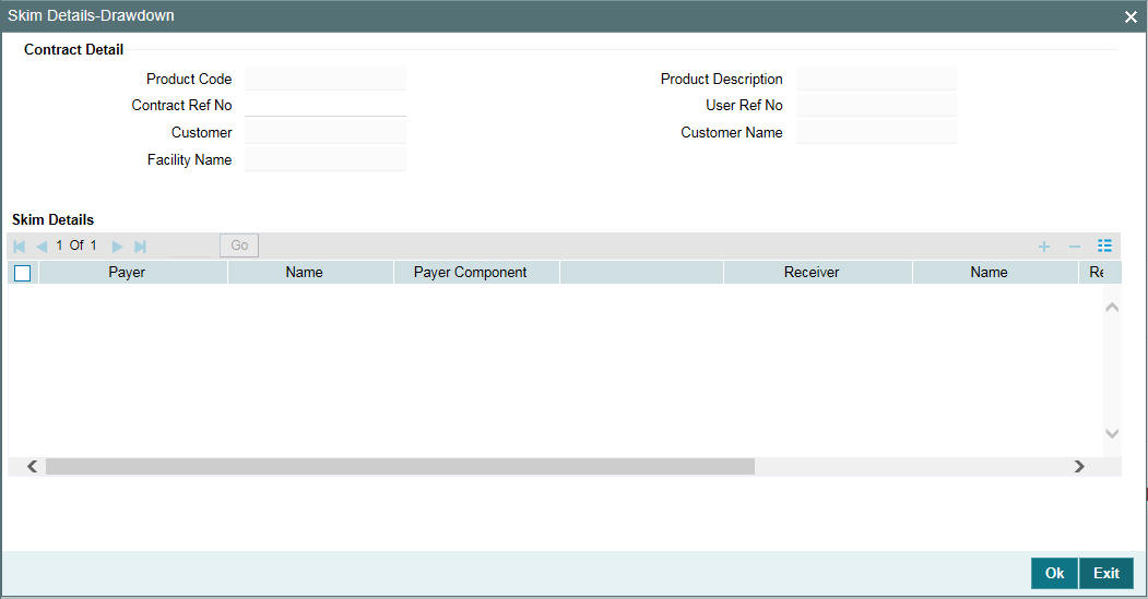

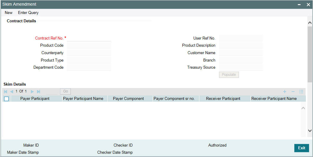

6.2.15 Specifying Drawdown SKIM Details
The SKIM details captured for the tranche gets propagated to the drawdown contract. You are allowed to amend the details at the drawdown level. To view and amend the details, if needed, click the ‘Skim’ tab. The ‘SKIM Details – Drawdown’ screen is displayed.
The details of the payer and receiver of Skim and the Skim rate gets defaulted to the respective participant contracts for processing. The accounting entries are also passed in the corresponding participant contracts.
Note
If SKIM details are not maintained for the tranche, you cannot define them afresh at the drawdown level. Atleast one combination of Skim should be defined for the tranche.
For details on the fields in this screen, refer the heading ‘Defining SKIM details for tranche participants’ in this chapter.
For details on the accounting entries defined for the Skim components, refer the heading ‘Maintaining Skim components for participants’ in the ‘Defining Products for Loan Syndication’ chapter of this User Manual.
Note
You have the option to amend the Skim details for a drawdown through the ‘Skim Amendment’ screen.
For more information on this screen, refer the heading titled ‘Amending drawdown SKIM details’ in this chapter.

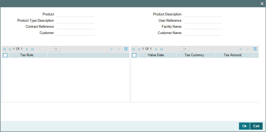

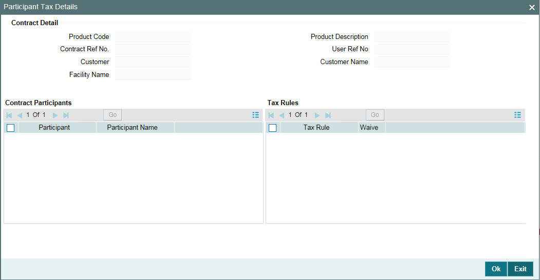

6.2.19 Viewing Drawdown Tax Details
You can collect withholding tax on the fee/interest collected by the participants of a drawdown. However, tax is not applied on the fee collected from the participants. The tax details, if applicable for the participant product (linked to the drawdown through the facility product) is applied on the drawdown. To view the details, click the ‘Tax’.
This screen displays the tax rules for each participant based on which withholding tax is computed on the fee or interest components. Tax rules associated with the drawdown product defaults to the drawdown. You can waive the subsequent tax to be applied for a participant and tax rule combination.
The system passes the entries for tax based on the event you specify in the ‘Product Tax Linkage’ screen. Typically, tax on fee is calculated upon liquidation of the fee (event ‘FLIQ’ will be associated with the rule) and tax on interest is computed on interest liquidation (event ‘LIQD’ is associated with the rule).
For details on associating tax with a product, refer the heading titled ‘Specifying tax details for a participant product’ in the ‘Defining Products for Loan Syndication’ chapter of this User Manual.
For more information on the Tax sub-system of Oracle Banking Corporate Lending, refer the Tax User Manual.
6.2.20 Defining Overwrite Settlement Instructions for the Drawdown
You can maintain settlement instructions for various components such as fees, charges, tax, principal, interest, and so on, using the ‘Overwrite Settlement Instruction Details’ screen. Using this screen, you can post liquidation entries into an Internal GL account instead of the customer account at the time of rollover. Click ‘Overwrite default SI’ in the ‘Drawdown Contract Online’ screen to invoke the following:
Enter the details as specified below:
Component
This screen displays the all the components displayed in the Settlement Message Details screen.
Internal GL
Specify the Internal GL accounts into which you want to post the liquidation entries for the components.
Overwrite Default Settlement Instruction
Select the ‘Overwrite default settlement instruction’ check box to confirm that the liquidation entries should be posted into the Internal GL account. System posts the entries to the Internal GLs only if you check this box. Otherwise, system posts the entries as per the settlement instructions specified for the component of the contract.

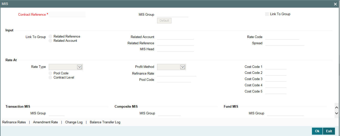

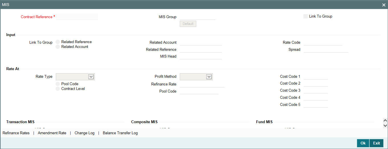

6.2.22 Viewing MIS Details for the Drawdown
If you have maintained MIS details for the DD (drawdown) product, the same will default to the drawdown. To view the details, click the ’MIS’ tab.
For details on the ‘Transaction MIS Details’ screen, refer the MIS User Manual.

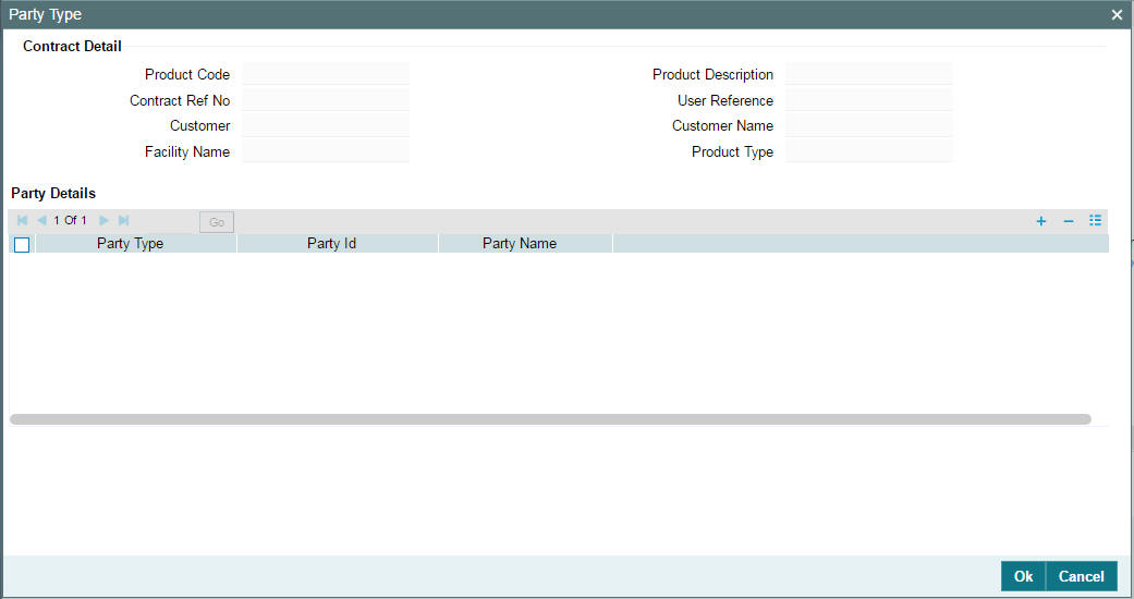

6.2.23 Specifying Parties for the Drawdown
You can also specify different entity or party types that would be applicable for the borrower drawdown as well as the applicable parties belonging to the selected party type. This is done in the ‘Party Details’ screen. Click ‘Party Type’ in the ‘DrawDown Contract Online’ screen. The party types associated with the drawdown product defaults to the drawdown. You can change the defaulted values, if required.
For more details on the above screen, refer the heading ‘Specifying parties for the facility’ in this chapter.

After capturing the drawdown details, you have to save the same and have it authorized by your supervisor.
After you save the drawdown, you can view the following details of the contract:
This section explains only those details that are unique to a drawdown. For details on the other options (Diary Events, Netting Cash Flow Summary, Message Preview, Participant Summary, Events), refer the following sections in this chapter:
6.2.26 Viewing EI for the Drawdown
You can view the effective interest (EI) rates applied on the drawdown through the Effective Interest Rate details screen. Click the ‘Effective Interest Rate’ to invoke this screen.
In this screen you can view the ‘Effective Interest Rate’ and the ‘Start Date’ from which interest rate is effective in the system.

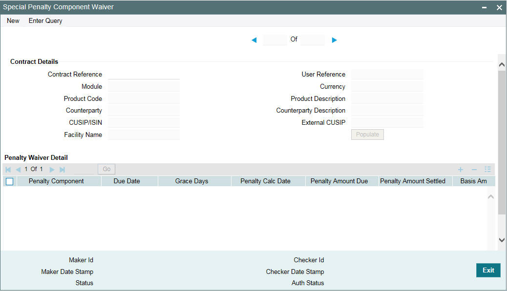

6.2.28 Specifying the Special Penalty Components
You can select components to which late payment charges are applicable for both commitment and loan contracts using the ‘Special Penalty Components’ screen. To invoke this screen, click the ‘Special Penalty’ tab in ‘Drawdown Contract Online’ screen.
Specify the following details:
Component
System defaults the components selected for late payment charge application at the product level.
Apply Special Penalty
Select this check box to indicate that system should apply special charges to the penalty component.
6.2.28.1 Processing the Late Payment Charges

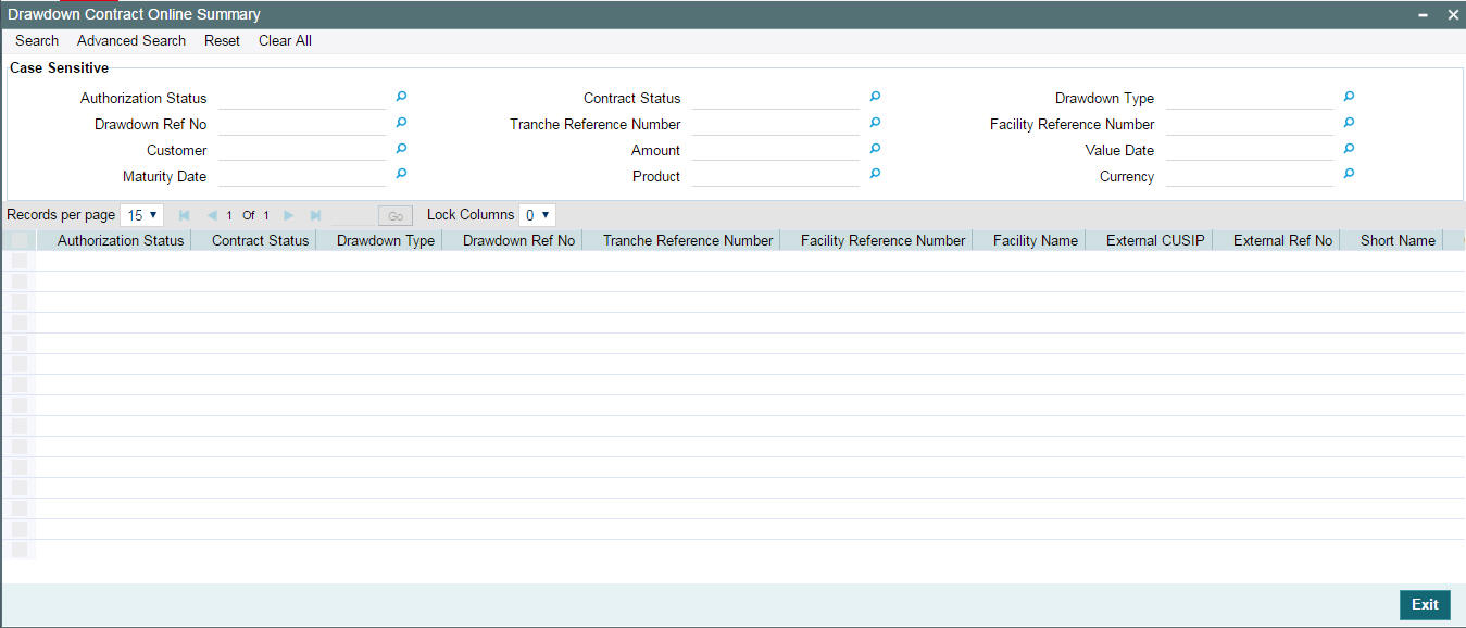

6.2.31 Viewing Drawdown Summary
You can view the drawdown details using the ‘Drawdown Summary’ screen. You can invoke the ‘‘Borrower Drawdown Summary’ screen by typing ‘LBSDDONL’ in the field at the top right corner of the Application tool bar and clicking the adjoining arrow button.
You can view the following fields:
6.2.32 Fixing Exchange Rate After Drawdown Booking
You can perform a case independent search only if the parameter, ‘CASE_SENSITIVITY’ in cstb_param, is set to ‘Y’.
If you do not fix the exchange rate during drawdown booking (the event ‘EXFX’ is not fired for such drawdowns) you have the option to fix the same after the booking event. This is applicable if the drawdown currency is different from the tranche currency. You can invoke the ‘Exchange Rate Fixing’ screen by typing ‘LBDEXRFX’ in the field at the top right corner of the Application tool bar and clicking the adjoining arrow button.
All subsequent exchange rate fixing after the drawdown booking is done through the above screen. Through this screen, you can fix the exchange rate for the current period (before the effective start date) as well as specify a rate for a new period. These options are discussed below.
6.2.32.1 Using the ‘Unlock’ option to fix the exchange rate before the start date
You can use the unlock option to fix the exchange rate before the effective start date of the exchange rate fixing period. If you attempt to fix the exchange rate after the effective start date, the following message is displayed:
Exchange rate already fixed
To amend the exchange rate for the current fix period (i.e. before the effective start date), do the following:
  1. Select the drawdown for which you want to fix the exchange rate. You can use the navigation button provided in the toolbar of the screen to select the drawdown. Alternatively, you can also use the F7 and F8 keys to fetch the required drawdown. The system will display the ‘Fixing Date’ based on the exchange rate fixing days maintained for the drawdown currency at the tranche level. The ‘Fix Notification Date’ will be one day prior to the ‘Fixing Date’ for such drawdowns (for which exchange rate fixing is done before the effective start date).
  2. Unlock the selected drawdown. To do this, Select Unlock option from the menu.
  3. Specify the effective end date for the period. This date should not be greater than the drawdown maturity date and earlier than the ‘Effective Start Date’. When you specify the end date, system will accordingly display the ‘Next Effective Start Date’ (Effective End Date + 1).
  4. Change the default exchange rate, if required. This rate is picked up from the ‘Currency Rates Maintenance’ screen. You may also capture any remarks, if required.
  5. Select Save from the menu to save the changes. The system will display a confirmation message if the save operation is successful.
Note
    • If you have defined revaluation schedules for a period, you cannot fix the exchange rate for that period
    • In case of future dated drawdowns, exchange rate should be fixed before the value date of the drawdown
    • If you fix the exchange rate for a contract wherein the advices ‘BORR_EXFX_ADV’ or ‘PART_EXFX_ADV’ are suppressed for the EXFX event, then the system dis­plays the following override when you save:
‘Advice for event EXFX is suppressed for the product, Do you want to continue?’
Advice for event ROEX is suppressed for product, Do you want to continue?
Advice for event CREX is suppressed for product, Do you want to continue?
6.2.32.2 Using the ‘New’ option to fix the exchange rate after the effective start date
You can use the ‘New’ option to fix the exchange rate for the next period. Follow the steps given below to fix the exchange rate using this option:
  1. Select New from the menu
  2. Select the reference number of the drawdown for which you want to fix the exchange rate for the next period. The option list will display the reference numbers of drawdowns with effective start date earlier than the current system date. This indicates that you are fixing the exchange rate for the next period. By default, the effective end date of the previous period+1 will become the effective start date of the new period. The system displays the ‘Fixing Date’ for the next period based on the exchange rate fixing days maintained for the drawdown currency at the tranche level.
  3. Change the effective start date, if required. By default, the system displays the current date. You can change it to date in the future such that the date is not beyond the drawdown maturity date. However, if the end date of the previous exchange rate fixing period is greater than the system date, the effective start date of the current period should be greater than the previous period end date.
  4. Specify the effective end date for the period. This date should not be greater than the drawdown maturity date but may be equal to the effective start date.
  5. Change the default exchange rate, if required. This rate is picked up from the ‘Currency Rates Maintenance’ screen. You may also capture any remarks, if required.
  6. Select Save from the menu to save the changes. Since you are fixing the exchange rate before the actual fixing date, the system will display an override message indicating the date and time when the actual fixing should have taken place, before saving the details. A confirmation message is displayed if the save operation is successful.
6.2.33 Fixing Interest Rate after Drawdown Booking
For the first time, you can fix the interest rate as part of drawdown booking through the ‘Rate Fixing Details’ screen. Subsequent rate fixing should be performed through the ‘LB Interest Rate Fixing’ screen. You can invoke the ‘Interest Rate Fixing’ screen by typing ‘LBDIRTFX’ in the field at the top right corner of the Application tool bar and clicking the adjoining arrow button.
You can view the agent reference number in this screen.
For interest rate fixing also you have the ‘Unlock’ (to fix the interest rate before the effective start date) and ‘New’ (to fix the interest rate after the effective start date) option. For more details on negative rate processing, refer the title ‘Maintaining Loans Parameters Details’ in the chapter ‘Bank Parameters’ in Core Services User Manual. For details on the two options, refer the heading ‘Fixing exchange rate after drawdown booking’ in this chapter.
For more information on the editable fields in the above screen, refer the heading ‘Fixing interest rate for the drawdown’ in this chapter.
You can specify the media for the message generation in ‘Media for Message Generation’ screen. You can invoke this screen by clicking ‘Media’ tab. This tab is enabled only if the ‘FpML Type’ option is deselected at the contract level and the ‘Media Priority’ option is checked at the product level.
If this tab is enabled, then the system displays an override message saying to view the ‘Media for Message Generation’ screen. If not, the system handoffs the message as per the details maintained in the ‘Customer Entity Maintenance’ screen.
For more information on the ‘Media for Message Generation’ screen, refer the heading ‘Specifying Media for Message Generation’ in this chapter.
6.3 Amending Drawdown SKIM Details
You can amend the Skim details maintained for a drawdown in the ‘Skim Amendment’ screen.
For details on maintaining SKIM for a tranche, refer the section titled ‘Defining SKIM details for tranche participants’ in this chapter.
You can invoke the ‘Amending Drawdown SKIM Details’ screen by typing ‘LBDSKMAM’ in the field at the top right corner of the Application tool bar and clicking the adjoining arrow button.
You can use the ‘New’ option for amending the Skim details for an authorized drawdown. The ‘Unlock’ option is available only if the drawdown is unauthorized.
Note
During amendment:
When you ‘Unlock’ or select the ‘New’ option, as the case may be, do the following as part of amendment:
  1. Add a new combination of Payer and Receiver Participants. The option list displays the participants selected for the drawdown. When you select a ‘Payer Participant’ or ‘Receiver Participant’, the corresponding name and component are also displayed. The system displays the number of times you select the participant for a combination. However, you cannot repeat a combination of Payer and Receiver
  2. Specify the value date when the amendment should be applied to the drawdown. This date should not be earlier that the drawdown value date or later than the drawdown maturity date.
  3. Specify the Skim rate for the combinations maintained for the drawdown
  4. The details get updated to the drawdown upon save of the amendment. You can view the same in the ‘Skim Details – Drawdown’ sub-screen invoked from the ‘Drawdown Contract Online’ screen. The drawdown status is ‘Unauthorized’ after an amendment. The same gets updated to ‘Authorized’ only after the amendment is authorized.
For more details on the ‘Skim Details – Drawdown’ sub-screen, refer the heading titled ‘Specifying drawdown SKIM details’ in this chapter.

Following points are noteworthy here with reference to interest rate changes:
In addition, the margin value can change due to changes in the tranche outstanding because of a back value dated drawdown. If the amount due from a borrower changes due to a back value dated drawdown, the amount receivable from the participants also change and this change is shared by the participants based on the participant sharing ratio for the associated business event (MRFX).

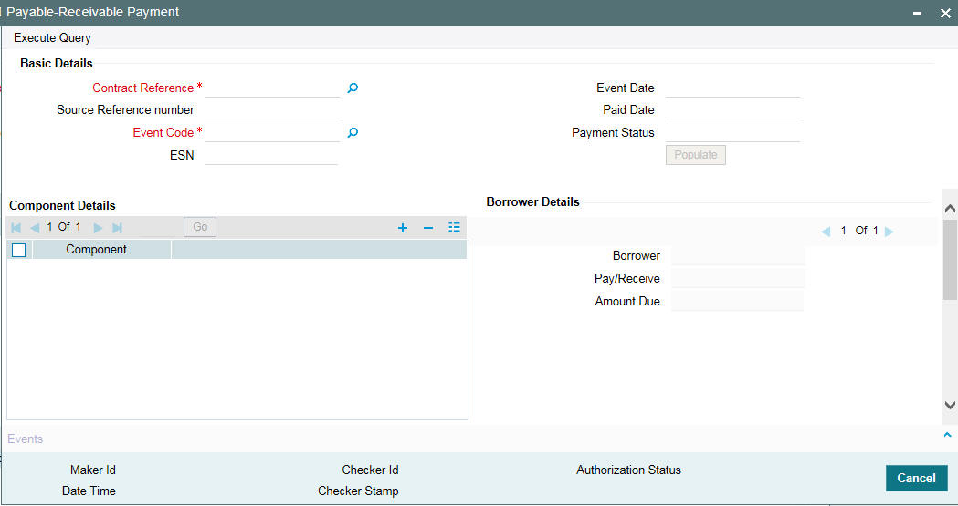

The following points are noteworthy with respect to payable/ receivable tracking:
Note
You can reverse a payment of a payable/receivable by clicking the ‘Reverse’ option . This option is enabled only if you access the above screen directly from the Application Browser (to do this, you need to choose LB Operations and double-click on the Payment option under Receivable Payable).

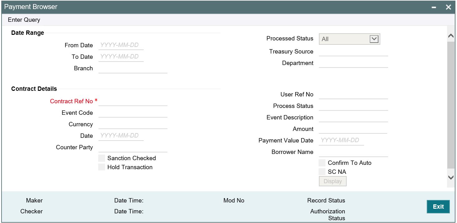

If you have selected the ‘Payment Browser’ preference as part of the preferences for the branch for secondary loan trading (in the ‘Secondary Loan Trading – Branch Parameters’ screen), then the system processes the payments meant for trading through the ‘Payment Browser’ screen. The payments that are processed through this browser are:

6.7 Amending Global Amount for a Contract
You can specify the Global Tranche or Global Drawdown amounts in the ‘Tranche Online’ and ‘Drawdown Online’ screens respectively during contract booking. Any amendment to the Global Tranche or Global Drawdown amounts is done in the ‘Global Amount Amendment’ screen.
Using the ‘Global Amount Amendment’ screen, you can amend all non-lead Tranches; however, you can only amend those non-lead Drawdowns where the Cascade Participation is set to ‘No’.
You can invoke the ‘Global Amount Update’ screen by typing ‘LBDGLAMT’ in the field at the top right corner of the Application tool bar and clicking the adjoining arrow button.
To amend the Global Tranche or Drawdown amounts, do the following:
The system automatically updates the Global Amount for non-lead Tranches or Drawdowns in the following scenarios:
The latest Global Amount for tranche as on the date of handoff is used for handoff of the Commitment Reduction to the Loans QT system.

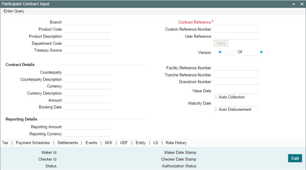

6.8 Processing Participant Contracts
When you ‘BOOK’ a borrower tranche, the system creates the related participant contracts. It picks up the participant tranche product linked to the borrower tranche product (in the ‘Loans Syndication – Facility Product Preferences’ screen) and the participant details maintained for the borrower tranche contract to create the corresponding participant tranche.
In the same manner, it picks up the participant drawdown product to create the participant drawdowns. The contract uses the participant details maintained for the borrower tranche contract.
The processing of participant contracts depends on the ‘Participant Process’ mode, whether ‘Job’ or ‘Online’, set for your branch. You have to specify this as part of defining parameters for your branch in the ‘Branch Parameters – Detail’(OLDBRMNT) screen.

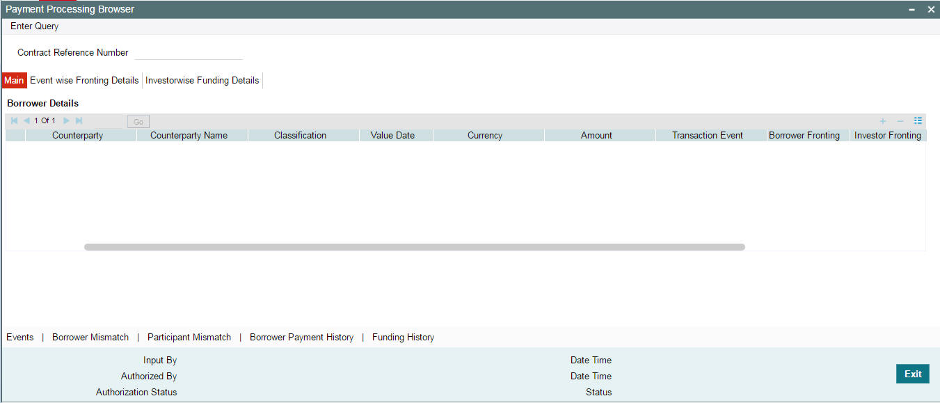

6.8.1 Processing in the ‘Online’ Mode
If the ‘Participant Process’ mode is set to ‘Online’ for your branch, the system automatically processes the related participant contracts, as mentioned above. In the ‘Online’ mode, you can save and authorize the borrower side contracts (facility, tranche or drawdowns) ONLY if the corresponding participant side contracts are processed successfully. You can view the status of the participant contracts in the audit trail section at the bottom of the respective borrower contract. For successfully saved borrower contracts, the ‘Participant Processing Status’ is displayed as ‘Processed’.
You can also view the details of borrower and participant contracts processed in Oracle Banking Corporate Lending in the ‘JOB PROCESS STATUS’ screen.
For more details on the above screen, refer the heading ‘Viewing borrower/ participant contract processing status’ in this chapter.

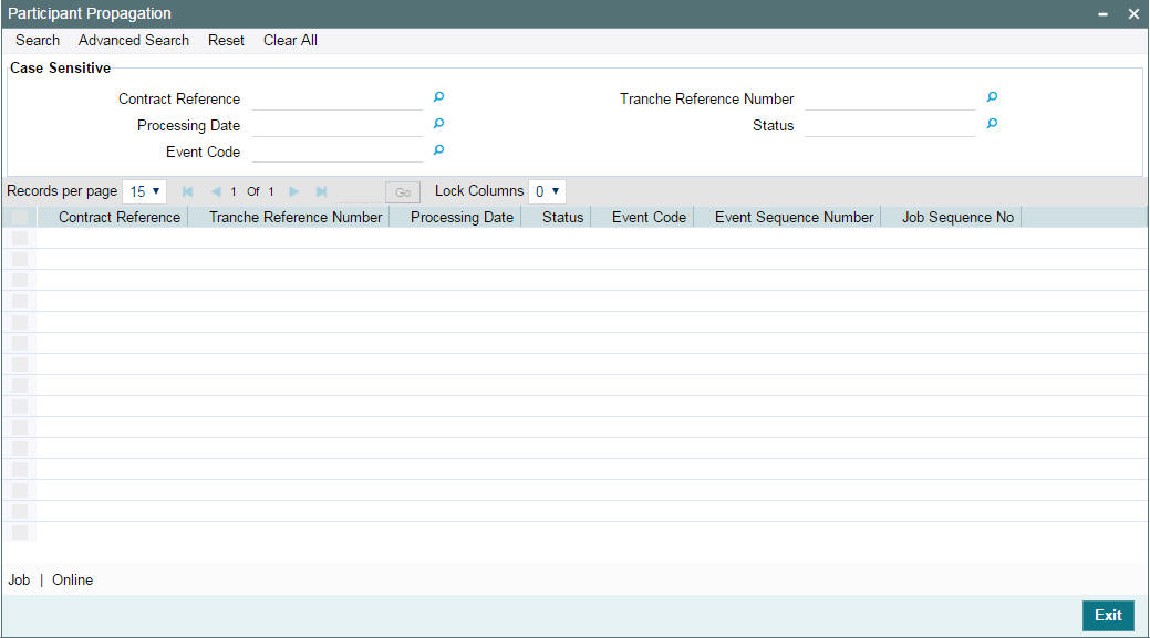

6.8.2 Processing in the ‘Job’ Mode
If the ‘Participant Process’ mode is set to ‘Job’ for your branch, you have to initiate a Background Job which picks up the participant contracts created in the system for further processing.
You have to initiate the Background Process as part of BOD programs run for the branch. The initiation is done through the ‘Participants Propagation’ (LBSPPROP)screen.
The ‘Job Status’ is ‘Job’. When you click the ‘Start Job’ button, the Background Job gets initiated in Oracle Banking Corporate Lending. In the ‘Job’ mode, after you save the borrower side contract, you can proceed with the next contract while the system processes the participant side contracts in the background. However, you can authorize the borrower side contracts only if the corresponding participant side contracts are processed successfully.
For successfully saved borrower contracts, the ‘Participant Processing Status’ (in the audit trail section at the bottom of the respective borrower contract) displays any one of the following statuses:
The status gets updated when the Background Job processes the participant contracts. After processing, the status reads ‘Processed’ or ‘Failed’, as the case may be.
Before executing the EOD operations for the branch, you have to stop the Background Job. This is mandatory. To stop the process, you have to click the ‘Stop Job’ button in the ‘Participants Jobs’ screen.
6.9 Loans Syndication – Participant Contract Online screen
To recall, when the BOOK event for borrower facility, tranche or drawdown is triggered, the system creates the related participant facility, tranche or drawdowns You can view the participant contracts initiated by the system in the ‘Loans Syndication – Participant Contract Online’. You can also view the position identifier description in case the participant is self participant.The features of this screen are discussed in the following sections.
You can invoke the 'Participant Contract Input’ screen by typing ‘LPDCOMNT’ in the field at the top right corner of the Application tool bar and clicking the adjoining arrow button.
In the above screen, you can view the following details about the contract:
In addition, a vertical toolbar is also provided in the screen. These buttons are used to invoke other sub-systems required for processing a participant contract. These buttons have been described briefly below:

6.9.2 Viewing Participant Entity Details
You can view the participant entity details in the ‘Participant Entities’ screen. These details are defaulted from the participant details maintained for borrower facility/tranche/drawdown associated with the participant facility/ tranche/drawdown. Click the ‘Entity’ tab to invoke this screen.
You can add or delete entities and also assign a different primary entity for the participant, if required. You can view the position identifier description in case the participant is self participant.
For more details on the options available in this screen, refer the heading ‘Specifying drawdown entity details’ in this chapter.

6.9.4 Viewing Participant MIS Details
If you have maintained MIS details for the participant tranche/drawdown product, the same will default to the participant tranche/drawdown. To view the details, click the ‘MIS’ tab.

6.9.6 Viewing Participant Tax Details
You can collect withholding tax from participants on the interest and fee components. If you have associated tax rules with the participant tranche/drawdown product, the same is become applicable to the contract. You can view the tax details for the contract in the ‘Tax Details’ screen.
Click the ‘Tax’ tab to invoke the screen.
For details on maintaining tax rules and schemes, refer the Tax User Manual.

6.9.8 Viewing Rates History
To view the margin rate history, click the ‘Rate History’ tab. The ‘Rates History’ screen is displayed, as shown below:
The following details are displayed on this screen.
6.9.8.1 Viewing Margin History
You can view the participant’s margin details that are applicable for the contract, by clicking the ‘Margin History’. The ‘Rates History’ screen is displayed, as shown below:
Margin Details
Margin Rates

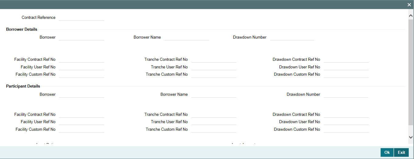

6.9.9 Viewing the Syndication Details
To view the details of the syndication, click the ’LB’ tab. The ‘Syndication Details’ screen is displayed, as shown below:
In this screen, you can view the reference numbers of contracts created both for the borrower and the participant involved in the syndication.
After you save the contract, you can view the following details of the contract:

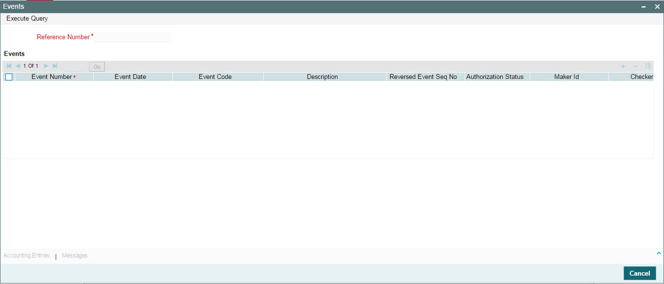

6.9.10 Viewing Events for the Participant Contract
You can view the events triggered during the contract life cycle in the ‘Event Log Details’ screen. To invoke this screen, click the ‘Events’ tab. The events defined for the participant tranche/drawdown/facility product will be triggered for the contract.
For details on the above screen, refer the heading ‘Viewing events for the facility’ in this chapter.

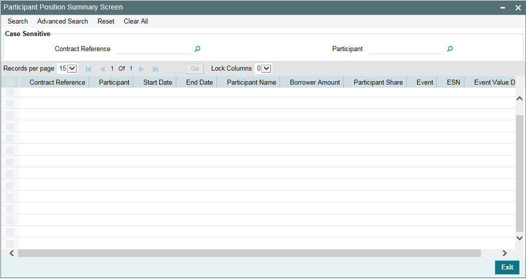

6.10 Participant Position Summary
You can view the participant position summary in the Participant Position Summary screen.
You can invoke the ‘Participant Position Summary’ screen by typing ‘LBSPTPSN’ in the field at the top right corner of the Application tool bar and clicking the adjoining arrow button.
You can view the position details of the participants, for different dates, using this screen. To view details, query using any of the following fields in the Participant Position summary screen:
The following fields are displayed in this screen
You can use this screen to query the details for self-participants and also for external participants.

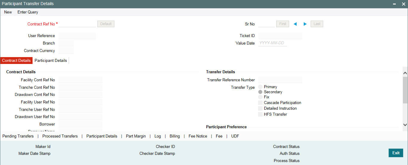

You can use the ‘Participant Transfer Details’ screen for the following purposes:
Addition of new participant is allowed from a facility and is available for the tranches and drawdowns processed under it. When you invoke the screen, the following contract details are available:
When you perform a back value participant transfer and when tranches for which ‘Cascade Participation’ is selected, the following happens:
When you perform a back value participant transfer and when tranche contracts for which ‘Cascade Participation’ is not selected following happens:
You can perform future dated participant transfers for pro-rata tranches. You can specify a future date as the value date for the transfer.

In the ‘Payment Processing Browser’ (LBDMTPRC) screen, the following details are updated for participant transfer with existing participants during participant transfer authorization based on the latest ratio for future-dated events:
For participant transfer with new participants, system adds the new participants to the existing list of participants in the ‘Payment Processing Browser’ screen. The fronting value is defaulted as follows:
For more details, refer section ‘Processing the Release of Payment Messages’ in this User Manual.

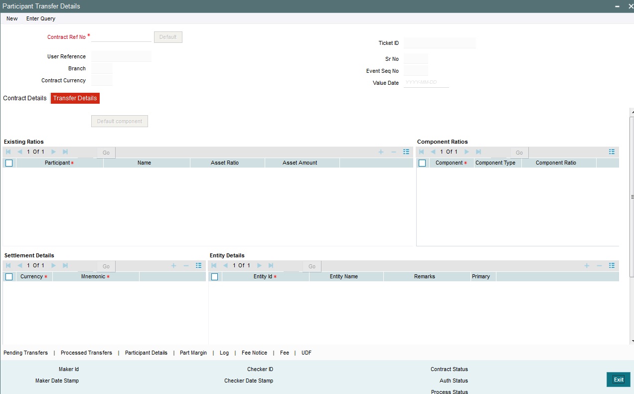

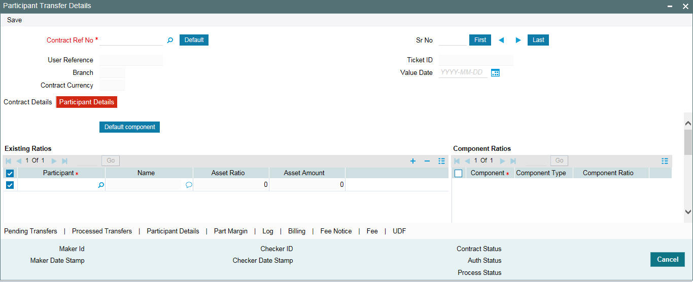

6.12.2 Transferring assets between existing participants

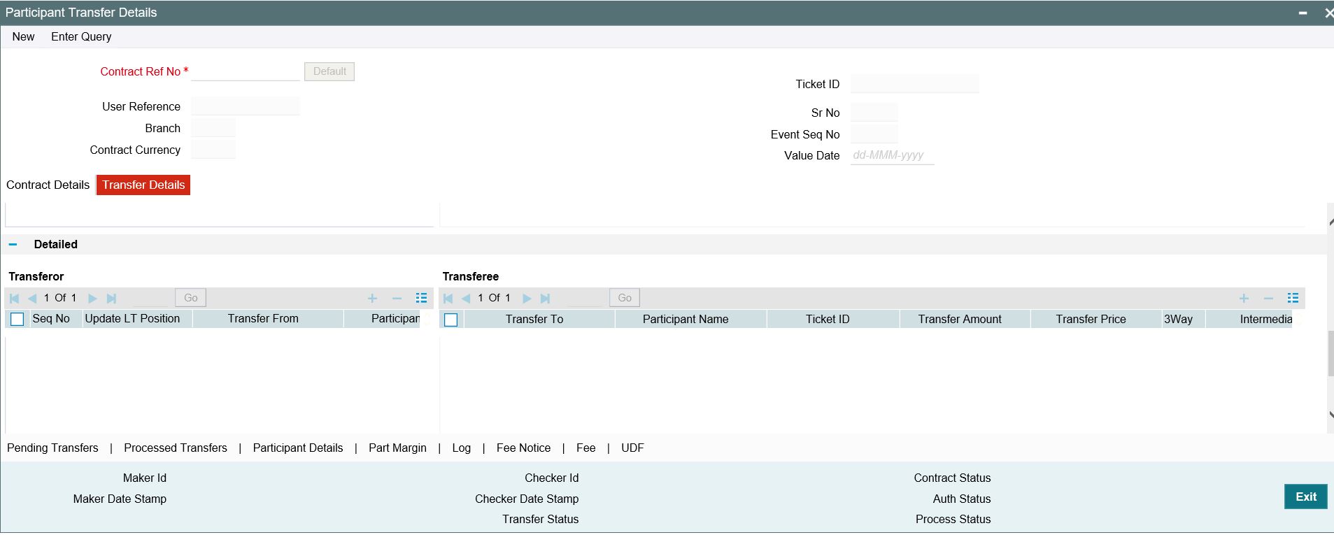

To transfer assets from one participant to another, you have to select the reference number of the contract for which you want to initiate the asset transfer amongst the participants.
  1. Enter the Contract Reference Number. You can either enter or select from the option list.
  2. Click ‘Default’ button.The system defaults the contract details.
  3. Click ‘Transfer Details’ tab
You can either click ‘Add Row or ‘Delete Row’ to add or delete participants. The ‘Participant Selection’ screen is displayed.
In this screen, you can view the existing participants of the contract.
The ‘Participant Transfer Details’ screen displays the following details:
You have the option to capture a consolidated type of transfer instruction or a detailed instruction for each participant. By default, the system takes you to the ‘Consolidated’ tab of the ‘Participant Transfer Details’ screen.
The system ensures the following when you capture the transfer instructions:
6.12.2.1 Capturing Detailed Transfer Instructions
To capture individual participant transfer details, check the ‘Detailed ’ section.
Click Participant Details tab and check the Detailed section
To transfer assets between participants, you have to select the participants from the ‘Participant Selection’ screen and then specify the following for each:

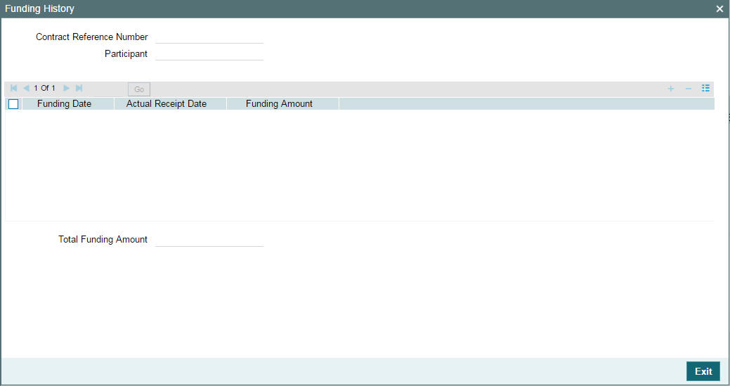

On save of Participant Transfer of a contract, if funding is pending (Fund sighted is No) for any participants involved in transfer, the system provides an override message as shown below.
‘Funding from Participant(s) is pending. Do you want to continue?’
The following details the updated:

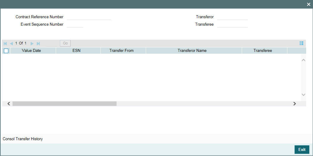

6.12.2.2 Capturing Consolidated Transfer Instructions
Select the name of the participants between whom you want to asset transfer in the ‘Consolidated’ tab of the ‘Participant Transfer Details’ screen. For a given value date, you can capture the net amount transferred to and from each participant.
For the participant who is the transferor, specify the amount with a negative sign (to indicate that the transfer is ‘From’ the participant).
Note
The sum of the transfer amount across all participants should be zero.
While maintaining the consolidated transfer instruction, you cannot visit the ‘Detailed’ section of the screen. The system displays the following error message:
Transfer Instruction Type is consolidated. Cannot enter detailed transfer instructions.
Click ‘Save’ to save the transfer details.

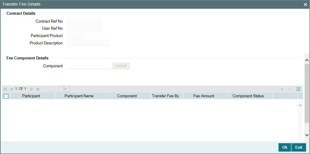

6.12.2.4 Capturing Transfer Fee Details
You, as the lead agency, have the option to collect transfer fee for the asset transfer between participants. The fee can be charged to both the transferor and the transferee.
You can collect fee from participants only if fee components are associated with the participant product involved in the contract. In addition, the fee components should be defined with the following attributes:
For details on defining product level fee components, refer the heading ‘Specifying fee components with the product’ in the ‘Defining Products for Loan Syndication’ chapter of this User Manual.
You can capture the fee details in the ‘Transfer Fee Details’ screen. Click ‘Fee’ tab to invoke this screen.
You can capture the following transfer fee details in this screen:

The applicable fee components defined for the participant product is available in the option list. You can select one of them to collect the transfer fee. After you select the component, the following details are displayed:
Fee Amount
Specify the amount to be collected as fee. The fee is expressed in the contract currency. This is collected as one time fee and hence requires no schedule definition.

6.12.2.6 Viewing the Participant Details After the Transfer
You can view the new asset sharing ratio and new income sharing ratio for the participants involved in the contract in the ‘Participant Ratio Details’ screen. Click the ‘Participation Details’ tab from Participant Transfer Details screen (LBDPTFR).
Payment message generation at the drawdown level for the Ledger entries goes with the Settlement days defined for the respective drawdown currencies. You can view the unique transfer referernce number in the ‘Participant Transfer Details’ screen which is preceded with the Branch code, Product code, and PTFR sequence number.

6.12.2.7 Adding a New Participant
To add a new participant
  4. Click the ‘Add Row’ from the ‘Existing Ratios’ section and click ‘Default Components’.
You can define the following:
LMA/LSTA Participation
The following are the list of values in the ‘LMA / LSTA Participation’ drop-down list.
You are allowed to select the value during new tranche contract creation. In the drawdown creation screen, the value is defaulted from the tranche contract and you are not allowed to edit the same.
Note
LMA / LSTA participation is applicable only for ‘Cascade Participation’.
The default value of ‘LMA / LSTA Participation’ is ‘Non-Standard’ during new tranche con­tract creation. However, you are allowed to manually update the same to ‘LMA Participa­tion’ / ‘LSTA Participation’.
The system validates at the time of clicking ‘Ok’ button in the participant sub screen if position identifier and portfolio maintenance is present with the ‘LMA / LSTA Participation’ value selected when you create a tranche contract with the new field value for ‘LMA/LSTA Participation’. Appropriate error messages are displayed if the validation is failed.
When the ‘LMA / LSTA Participation’ value is selected ‘Non-Standard’ for a participant for whom the ‘LMA / LSTA Participation’ is selected in the portfolio / position maintenance, the system displays an error message advising ‘LMA Participation’ is selected at position identifier or portfolio maintenance for $1.LMA/LSTA Participation flag cannot be Non-Standard when self-participation flag is checked for this participant’ at the time of save.
You have to either change the value of the field to ‘LMA Participation’ / ‘LSTA Participation’ or clear the ‘Self-Participation’ check box and proceed to save the contract.
The ‘Self Participant’ check box is selected and disabled if the value ‘LMA /LSTA Participation’ is selected.
Note
If the value ‘Non-Standard’ is selected , the ‘Self Participant’ check box is cleared and dis­abled.
The value of the ‘LMA / LSTA Participation’ is not editable during contract amendment.
When you select the value for ‘LMA / LSTA Participation’, there will not be any validations to check if the linked trade contract has the similar value in the field ‘Trade Standard’.
When a participant transfer or value dated amendment is processed for tranche / drawdown contracts with value selected in the ‘LMA / LSTA Participation’, the same value is defaulted to the participant sub-screen in the corresponding tranche and drawdown contracts.
The ‘Participant Transfer Details’ screen looks as shown below:
After capturing the necessary details, save and authorize the record. You can then select the tranche processed under the facility (to which new participants have been added) and transfer the assets appropriately between the existing and new participants.
6.12.2.8 Viewing Details of Processed Transfers
You can view all ‘Detailed’ authorized transfer instructions in the ‘Processed Transfer Details’ screen. To invoke this screen, click ‘Processed Transfer’ tab.
In this screen, you can view the following details of a transfer transaction:
You can also view the net amount transferred from/to each participant (for ‘Consolidated’ transfer instructions) in the ‘Processed Transfers - Consolidated’ screen. To invoke this screen, click ‘Console Transfer History’ button.
The ‘Transfer Amount’ with a negative sign indicates that the transfer is ‘From’ the participant. If the transfer is ‘To’ the participant, the amount will be shown with a positive sign.

6.12.3 Viewing Participant Margin Details
You can view margin details maintained for participants of the drawdown contract, using the ‘Participant Margin Maintenance’ screen. To view this screen, you have to click the ’Part Margin’ tab.
All details captured in the ‘Margin Maintenance’ screen are defaulted here.
For a given effective date and currency, you can view the margin maintained for the borrowers and participants.
To add a new participant, click ‘Add Row’ and click ‘Default Components’.
The system displays all participants linked to the tranche. You can specify the margin rate applicable for the required participants from the required effective date.
Note that you can maintain margin rates for participants only for margin components of the main interest components of the Tranche’s Drawdown products.
Place your cursor on a participant and click the ‘Delete Row’ button to delete that participant.
Click ‘Ok’ button to save the details and exit the screen.
The system will ensure that the total margin rate of all the participants is the same as the borrower margin rate for the effective date for which margin rate is captured/ amended. It will also check the rates for each participant, margin component, currency, effective date and amount slab combination. You should have computed the required margin rates prior to capturing or amending the margin rate using this screen. If the validation for margin rates fails, the system will display an error message and will abort the transaction. You will have to correct the margin rates and then proceed.
If base rate is negative or borrower margin rate is negative then system will not allow user to maintain participant margin. If user has captured positive margin rate for borrower and participant then system will not allow user to amend the margin rate from positive to negative.
The system displays the below error:
Borrower margin is lesser than 0, hence participant margin cannot be captured.

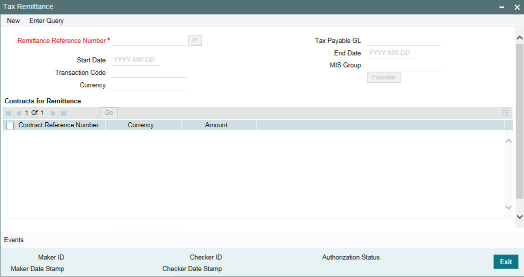

6.13 Remitting Withheld Tax
Oracle Banking Corporate Lending enables you to remit the withheld tax amount that was not remitted for a period, to the Central Bank. The tax administrators will review the tax withholdings of all participants at regular intervals. They will select the tax withholdings that need to be sent to the internal Treasury Tax Loan (TTL).
Tax is remitted to the Central Bank using the ‘Tax Remittance’ screen. You can invoke the ‘Tax Remittance’ screen by typing ‘LBDTARMT’ in the field at the top right corner of the Application tool bar and clicking the adjoining arrow button.
Enter the following details:
Remittance Ref No
For any remittance, you need to click ’New’ from menu. System generates a unique 16 digit reference number and populate the same here. For example, the format of the reference number will be as follows - CT4ZTRM043660065 where;
You can query the remittance made in the past using the remittance reference number.
Tax Payable GL
The tax remitted amount will be credited into this GL account. The option list will display all internal GLs of the branch.
Start Date
Select the date from when you want to remit the tax withholdings. The drop-down list will display all the withholding tax have been booked from this date.
End Date
Select the date till when you want to remit the tax withholdings. The drop-down list displays all the withholding tax have been booked till this date.
Transaction Code
The transaction code you specify here will be used to pass liquidation entries. The option list displays all transaction codes maintained in the ‘Transaction Code Maintenance’ screen.
For more details on transaction codes, refer the chapter ‘Transaction Code Maintenance’ in the Core Services (CS) User Manual.
MIS Group
Select the MIS Group from the list of values. The accounting entries are posted with MIS details associated with the MIS group.
Currency
This is the currency in which the tax that has been withheld needs to be remitted.
Note
System does not post accounting entries or fire events after remitting tax for any LB con­tract.
Once you enter the above details, click the ‘Populate’ button to view details under ‘Contracts for Remittance’. Here, system will display all the withheld tax entries for the specified period in the currency you have selected.
If you change the Start Date, End Date or Currency, you will need to click the ‘Populate’ button to update the details displayed under ‘Contracts for Remittance’.
Contract Ref No.
The reference number of the facility, tranche and drawdown contracts against which the tax was withheld is displayed here.
System displays the tax currency and the total tax amount that was withheld against the participants of the contract. Click ‘Events’ to view the ‘Event Log Details’ screen.
For more details on the ‘Event Log Details’ screen, refer the section titled ‘Viewing events for the facility’ in the ‘Loan Syndication Contracts’ chapter of this User Manual.
You can execute the following operations in the ‘Tax Remittance’ screen:

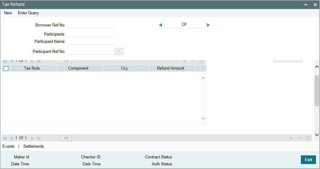

6.14 Refunding Withheld Tax
Oracle Banking Corporate Lending enables you to refund the withheld tax amount when there is fluctuation in the interest rate, or change in the tax status. The tax administrators review the previous tax withholdings of all participants and select those withholdings that need to be refunded. System calculates and refunds the total amount to the participants through wire transfer.
Tax is refunded to the participants using the ‘Tax Refund’ screen. You can invoke the ‘Tax Refund’ screen by typing ‘LBDTXREF’ in the field at the top right corner of the Application tool bar and clicking the adjoining arrow button.
In the above screen, system displays all the withheld tax components. The following details will be displayed:
Borrower Ref No.
Specify the reference number of the borrower contract for which you want to refund the tax.
Participant
From the option list select the participant for whom you want to refund the tax.
Participant Ref No.
System displays the reference number of the participant.
Tax Rule
System displays the tax rule associated with the contract.
Component
System displays the component against which the tax rule is associated.
Ccy
This is the currency in which the Tax that has been withheld which needs to be remitted.
Refund Amount
This is the sum of all the Refund Amount specified under ‘Schedule Details’.
System will display the schedule details of the components:
Tax Rule
This is defaulted from the Tax Rule under ‘Component Details’.
Tax Due Date
System displays the due date of the component with which the tax rule is associated.
Tax Collection Date
This is the date on which the component was liquidated.
Amount
This is the maximum tax amount that can be considered for the refund for a Tax rule, Due Date and collection date combinations for the given participant of an LB contract. System calculates this amount considering the impact of the past refunds and the remittances.
Refund Amount
You can specify the amount you wish to refund to the participant. You can choose to refund the tax withholdings in partial or full. The amount in the Amount field is defaulted here. You can, however, change the amount. If you specify zero, it indicates that you do not want to refund any amount.
Click ‘Settlements’ tab in the ‘Tax Refund’ screen to invoke the ‘Settlement ’ screen. This screen displays the customer’s account where the refund amount is credited.
Click ‘Events’ tab to invoke the ‘Event ’ screen. This screen displays the accounting entries posted with TXRF (Tax Refund) and TXRV (Reversal of refund) events.
Click ‘Media Priority’ button to invoke the ‘Media for Message Generation’ screen. You can specify the media for the message generation in this screen. This buttonis enabled only if the ‘FpML Type’ option is unchecked at the contract level and the ‘Media Priority’ option is selected at the product level.
If this button is enabled, then the system displays an override message saying to view the ‘Media for Message Generation’ screen. If not, the system handoffs the message as per the details maintained in the ‘Customer Entity Maintenance’ screen.
For more information on ‘Settlement Message Details’ screen, refer the Settlements User Manual.
For more information on the ‘Media for Message Generation’ screen, refer the section ‘Specifying Media for Message Generation’ of this chapter.
You can execute the following operations in the ‘Tax Refund’ screen:
Note
6.14.1 Forward Processing for Investor Tax Refund Payments
The payments generated or handed off to the investors as tax refunds can be sent for Sanction Check avoiding maker/checker process. You can view the payments and their sanction screening ACK code.
If the option, ‘Forward Processing Required’ in Loans Parameter screen is selected, the system populates the payments details to the forward processing browser, and the full message is sent to Sanction Check system immediately.
If the status from sanction check system is ‘-1’ (Complete) and the INIT/Liquidation mode is selected as ‘Auto’, the tax refund payment from Forward Processing browser is released. And if the INIT/Liquidation mode selected at the contract level is ‘Semi-Auto’, then you have to manually confirm the release of payment message.
Note
Sanction check functionality is applicable only for the new payment messages.
6.14.2 Viewing separate fee liquidation entries in Forward Processing Browser
The system supports fee payment messages in modules LB, OL and SLT where the messages are released from ‘Forward Processing browser’. Firstly, the system populates the ADHOC Fee and derived fee payments into Forward Processing browser if the ‘forward processing required’ flag is checked and if fee liquidation mode at the product level is set to the following criteria’s:
You will be able to release the message if the liquidation mode is ‘Semi-Auto’ and ‘Auto’ for derived Fee in LB module. For Adhoc Fee component in LB and OL modules, the system will release the messages based on the sanction check without user intervention
Therefore, in a contract if more than one fee liquidation is performed, on the same value date and for the same currency, ‘Forward processing browser’ contains entries even when multiple fee liquidation are performed for the same reference, Counterparty, value date and currency.

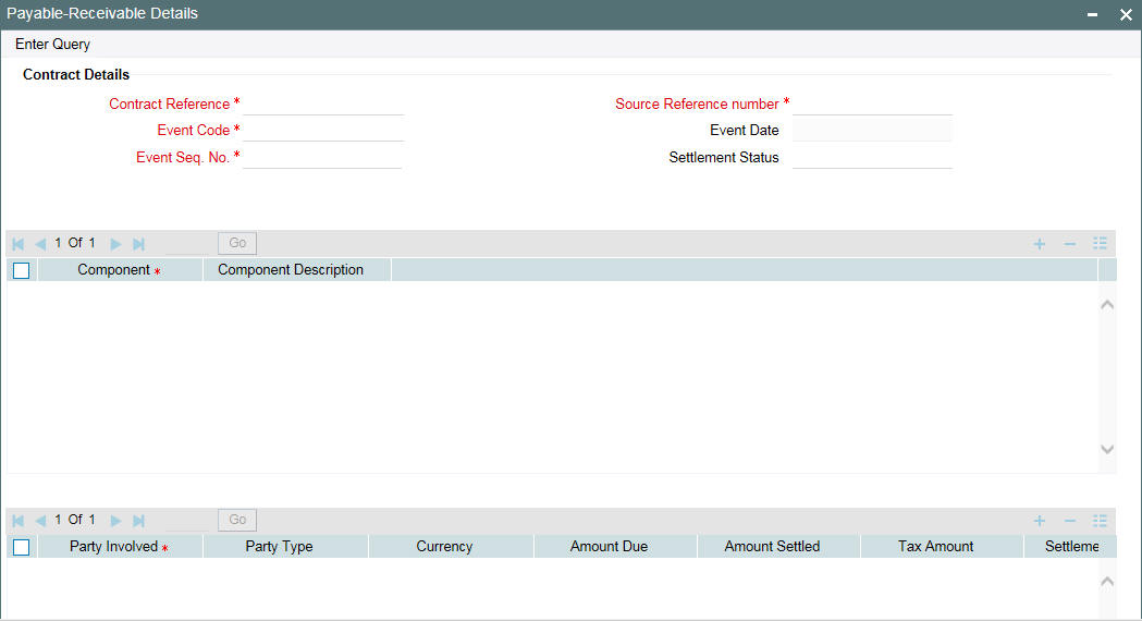

6.15.1 Viewing the Receivables/Payables for a Contract
In Oracle Banking Corporate Lending, you have the ‘Payment–Receivable Details’ screen through which you can view the receivable/payable amounts for a drawdown. You can invoke the ‘Payable-Receivable Details’ screen by typing ‘LBDPRDET’ in the field at the top right corner of the Application tool bar and clicking the adjoining arrow button.
For a drawdown/tranche, this screen displays the receivable/payable amounts for each component and the associated event. Based on the last event which has occurred in the life cycle of the contract, the corresponding event sequence number gets defaulted in the ‘Event Seq No’ field. Once the payable and the receivable amounts are settled across all the components for a particular contract, the system updates the ‘Settled Status’ field to ‘Settled’.
All the components for a contract are displayed in the ‘Component Details’ section.
For each component of the drawdown/tranche, the system displays the following details:
Note
If the tax rules are tagged to the components and if the tax is applicable, the system also passes the necessary accounting entries for tax.
You can use the navigation buttons - provided in the toolbar to scroll through the tranches and drawdowns.
6.15.2 Processing Settlement of Receivables/Payables for a Contract

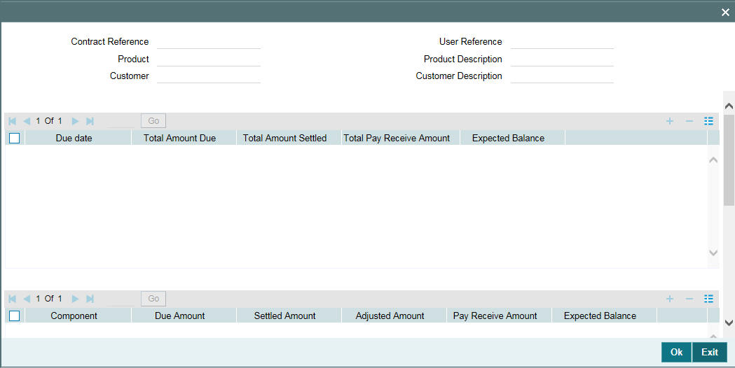

You can process settlement of a payable/receivable amount in the ‘Payable – Receivable Payment’ screen. Click the ‘Payment’ button to access this screen. This screen shows the amounts payable and receivable for the contract chosen in the ‘Payable – Receivable Details’ screen.
Note
You also have the provision to invoke the ‘Payable-Receivable Payment’ screen directly from the Application Browser. To do so, choose LB Operations and double-click on the Payment option under the Payable Receivable sub-menu. In this case, you need to se­lect the tranche/drawdown from the option list provided. In addition, you need to select the relevant event from the ‘Event Code’ option list provided. The corresponding event se­quence number gets defaulted in the ‘Event Seq No’ field here.
To view the components due for the selected contract, click “Populate’ button. The following details are displayed:
Liqd Reqd
By default, this option is checked for all the participants. However, you can choose to liquidate the payable/receivable amount for selective participants only. To do so, you need to check this option against the appropriate participant (s) and uncheck the same for the others.
Note
The receivables from any party (participant or borrower) should be liquidated in a single instance. For instance, if the amount receivable from a borrower is USD 6000, the same has to be settled entirely including the settlement of individual participant share. Likewise, the amount receivable from participants can be settled individually or with other partici­pants. However, you are not allowed to do a partial liquidation within the individual partic­ipant amount.
Apply Tax
Tax is calculated upfront based on whether tax is applicable for the contract. However, at the time of payment, you can check this option to apply tax on the receivable/payable amount. To waive tax, uncheck this option. Your selection here is updated in the ‘Payable-Receivable Details’ screen.
Click button to move between the ‘Component Details’ and ‘Participant Due Details’ sections of the screen.
After capturing the amounts to be settled against the components, click ‘Save’ to save the payment. Click ‘Exit’ button to exit the screen and return to the ‘Payable-Receivable Details’ screen. The ‘Amount Settled’ field in this screen is updated accordingly.
Note
You can reverse a payment of a payable/receivable by clicking the ‘Reverse’ from the menu. This option is enabled only if you access the above screen directly from the Appli­cation Browser (to do this, you need to choose LB Operations and double click on the Payment option under Receivable Payable.
6.16 Viewing Borrower/Participant Contract Processing Status
You can view the processing status of both borrower and the resultant participant contracts in the ‘JOB PROCESS STATUS’ screen. You can invoke the ‘Participant Exception Log’ screen by typing ‘LBDBPCNT’ in the field at the top right corner of the Application tool bar and clicking the adjoining arrow button.
This screen displays all the borrower side contracts (facility, tranche and drawdowns) and the corresponding participant contracts for each borrower side contract.
The following details are displayed for a borrower contracts:
The following details are displayed for a participant contract:

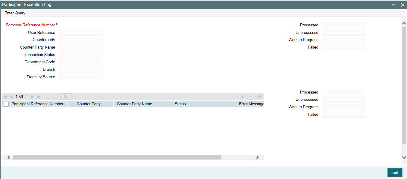

In addition, the ‘Borrower Contract Process Summary’ section of the screen displays the following details:
For each borrower contract, the above details are displayed for the corresponding participant contracts, in the ‘Participant Contract Process Summary’ section of the screen. You can double-click on any contract to view the contract details in the respective contract online screen.
Note
The system displays the processed contracts in ‘Green’ while the contracts that fail are displayed in ‘Red’.

6.17 Maintaining Special Penalty Component Waiver De­tails
You can waive late payment charge schedule(s) for a component using ‘LB Special Penalty Component Waiver’ screen.
You can invoke the ‘Special Penalty Waiver’ screen by typing ‘OLDPNWVR’ in the field at the top right corner of the Application tool bar and clicking the adjoining arrow button.
Contract Ref No
Specify the reference number of the contract for which the late payment charge schedules should be waived.
System displays the following details based on the specified contract reference number:
Penalty Comp
Select the penalty component from the adjoining option list. This list displays all the late payment charge schedules for the contract which are not fully paid of waived.
Due Date
System displays the due date for the penalty component selected. However, you can edit the due date.
System displays the following details based on the selected penalty component:
Remarks
Specify a brief description regarding the waiver for late payment charges for a schedule.
Waive
Select this check to indicate that the late payment charge schedule should be waived for a component. You can save the waiver operation only if the ‘Waive’ box is checked for all schedules.
You can waive a partially paid late payment charge schedule. In this case, the unpaid amount is treated as waived and the already paid amount is treated as settled. No further dues are tracked for this schedule.
Before allowing the waiver of each schedule, system checks that all preceding schedules have been paid or waived. If there are any unpaid schedules preceding this schedule, then system displays the following override message:
‘Prior schedules are unpaid for this component. Please pay/waive all such schedules before proceeding’
On waiving a late payment charge, the previously calculated charges are no longer be due.
The accounting entries are posted against the event ‘SPWV’ (Special Penalty Waiver). If multiple schedules are waived as part of the same waiver operation, then system triggers a single ‘SPWV’ event with separate accounting entries for each schedule. The accounting entries are posted for information and tracking purposes only.

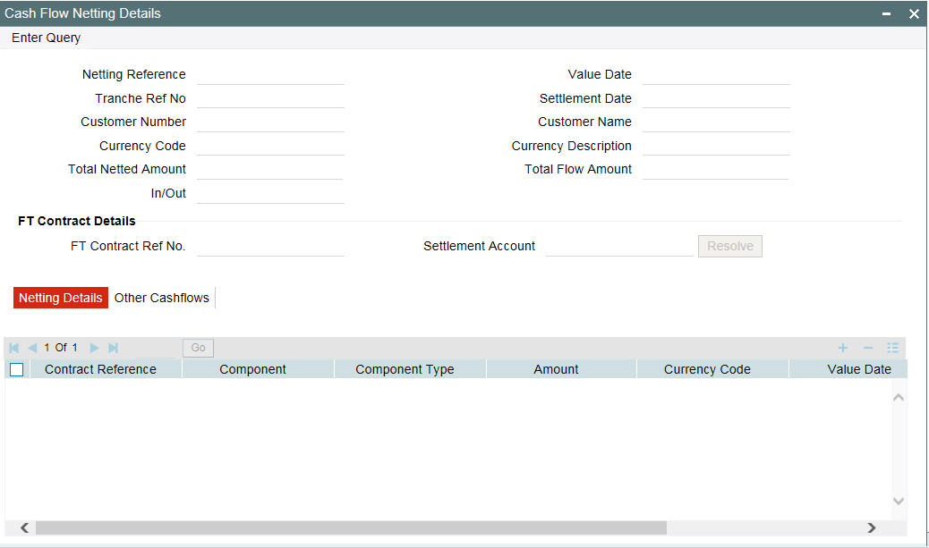

6.19 Netting Cash Flows for a Tranche
You can maintain netting preferences for borrowers and participants of a tranche in the ‘Borrower Details’ sub-screen and the ‘Participant Ratio Details’ sub-screen of the ‘LB Tranche Contract Online’ screen.
For a borrower, you can choose one of the following as the netting preference (in the ‘Borrower Details’ sub-screen of the ‘LB Tranche Contract Online’ screen):
Similarly, for a participant, the following options are available for netting (in the ‘Participant Ratio Details’ sub-screen of the ‘LB Tranche Contract Online’ screen):
You can view the borrower and participant side contracts for a tranche, for which netting is applicable, in the ‘Loans Syndication Netting Cash Flow Summary’ screen.
Netting takes place only if the following parameters for a cash flow are same:
6.19.1 Viewing the Contracts for Netting
In this screen, you can specify the following to view:
6.19.2 Netting the Components
To net the components for a contract, select the contract from the summary screen and double-click on it. The ‘Cash Flow Netting Details’ (LBDNETCF) screen is displayed, as shown below:
You can view the following details in the ‘Netting Details’ tab of this screen:
The ‘Other Cashflows’ tab of the screen displays all contracts till date which need to be netted.
You can check the ‘Netted’ option for these contracts if you want to net them along with the current contracts.
After selecting the contracts for netting (in the ‘Netting Details’ tab of the screen), you have to click the ‘Resolve’ button to continue. If pending cashflows are present in the ‘Other Cashflows’ tab, system will display a message to indicate the same. The system will display a message to seek confirmation to resolve the selected contracts. Select ‘OK’ in the message window to continue.
If netting is successful, system will update the ‘FT Contract Details’ section of the screen with the following details:

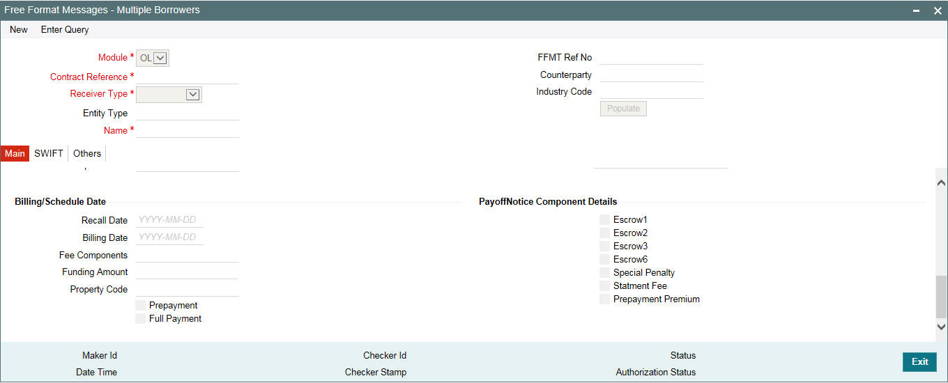

6.20 Free Format Messages for Loan Syndication Con­tracts
You can enable the system to generate free format messages with respect to loan syndication contracts, by using either of the following options:
You can generate free format for multiple participants or borrowers.

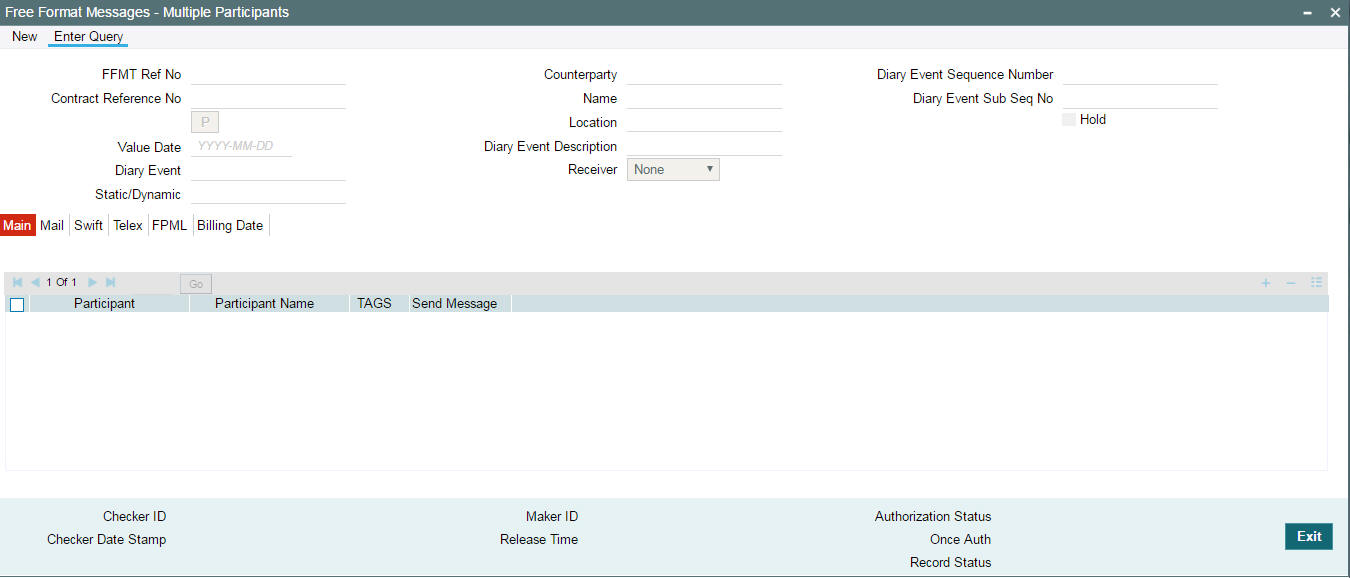

6.20.1 Generating Free Format Messages for Multiple Participants
You can invoke the ‘Free format message’ screen by typing ‘OLDFFMSG’ in the field at the top right corner of the Application tool bar and clicking the adjoining arrow button.
Thereafter, select ‘New’ from the menu. The Free Format Message screen is displayed without any details. Alternatively, you can also select invoke this screen by clicking the ‘PartFFT in the ‘Contract Diary Event’ screen.
When you click on the ‘New’ button, system automatically generates a unique ‘FFMT Reference No’ for the free format message.
6.20.1.1 Specifying Message Details
You have to specify the following in the ‘Message Details’ section of the screen:
Contract Ref No
Select the reference number of the loan syndication contract (facility/tranche/borrower) in respect of which you want to generate free format messages. Upon selection of the contract, system displays the counterparty code and name of the customer involved in the contract. The system also displays the names of participants involved in the contract.
Hold
You have the option to place the free format message on hold. To do this, check this option.
If you have indicated that messages should be generated on-line the free format message is displayed in the ‘Outgoing Message Browser’ once it is saved. You can generate it from the browser. If you indicate that the message should be put on hold, you first have to release the message before you generate it from the ‘Outgoing Message Browser’.
Receiver
You have to select the recipient of the message. The available options are:
Entity Type
If you select the receiver as ‘ENTITY TYPE’, you have to select the type here. The entity types defined for the participants are displayed in the option list. You can select the required type from this list.

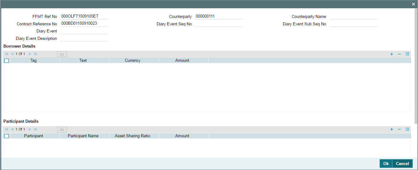

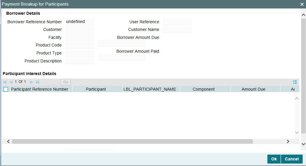

6.20.4 Specifying Payment Breakup for Participants
Click ‘Part Int share’ button to invoke the screen, ‘Payment Breakup for Participants’(LBDPYMNT) with details of all the participants under the drawdown and outstanding interest (Cash Interest) for each participant under the field ‘Amount Due’.
Refer the section, ‘Specifying Payment Breakup for Participants’ in the Repay Chapter
for more details.
Amount Paid
Specify the individual participant share amount for the interest being paid.
Existing participant free format advices having interest payment details can include cash interest payment that is captured by user during free format message generation (for interest liquidation and principal + interest liquidation).
Rollover notification advices that are generated systematically during rollover booking, can include cash interest payment that is captured by user during rollover booking (for interest liquidation and principal + interest liquidation).
Specify the proper cash amount for borrower and participant during free format message generation and payment should be processed for the same amount which is operationally controlled by user.
