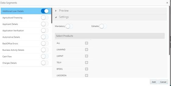

- Data Segments: Select the required data segments listed for the stage
and specify if the data segment is mandatory or non-mandatory. User can
click on Preview to view the data segment. User can also restrict a data
segment to a single product or list of products.

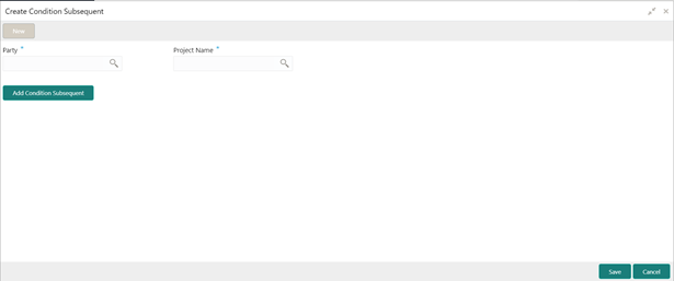

2.1.3 Condition Subsequent
Condition Subsequent is an event or a condition which needs to be
complied or monitored during the life of a Loan Contract. Conditions
Subsequent will have an expected completion date. OBCLPM user can capture
the respective Conditions Subsequent in a Loan Agreement along with the
target date of completion. User will be able to capture the remainder
days to trigger the notification to the respective RM regarding the upcoming
Condition Subsequent prior to the completion date
How to reach here:
Corporate Lending > Maintenance > Condition
Subsequent
How
to configure a Condition Subsequent:
- In the Create Condition Subsequent screen, provide the
required details:
- Party: Click Search to view and select the required party.
- Project Name: Click Search to view and select the required project
name.

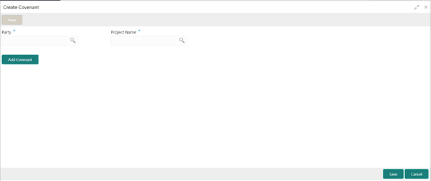

2.1.4 Covenant
Covenant is an event or a condition which needs to be complied or
monitored during the life of a Loan Contract at desired frequency. The
frequency can be weeks, months or years. Covenant will have an expected
completion date for every frequency. OBCLPM user can capture the respective
Covenant in a Loan Agreement along with the target date of completion.
Upon completion of one Covenant for a particular frequency, the status
can be captured accordingly and a new pending Covenant will be created
for the next frequency. User will be able to capture the remainder days
Covenant prior to the completion date.
How to reach here:
Corporate Lending > Maintenance > Covenant
How to configure
a Covenant:
- In the Create Covenant screen, provide the required details:
name.

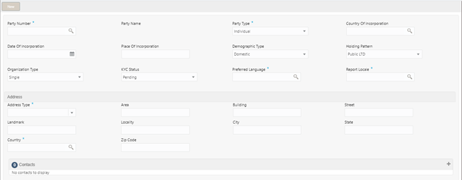

2.1.5 Party Maintenance
How to reach here:
Corporate Lending > Maintenance > Party Maintenance
How to
configure a Party Maintenance:
- In the Create Party screen, provide the required details:
- Party Number: Click Search to view and select the required party.
- Party Name: Party name gets auto-populated.
- Party Type: Select the type from the drop-down list.
- Country Of Incorporation: Click Search to view and select the required
country.
- Date of Incorporation: Select the date from the drop-down calendar.
- Place of Incorporation: Enter the place.
- Demographic Type: Select the type from the drop-down list.
- Holding Pattern: Select the pattern from the drop-down list.
- Organization Type: Select the type from the drop-down list.
- KYC Status: Select the status from the drop-down list.
- Preferred Language: Capture the preferred Language of the Party
- Report Locale: Select the preferred advice language for the Party
- Address Type: Select the type from the drop-down list.
- Area: Enter the area.
- Building: Enter the Building.
- Street: Enter the street.
- Landmark: Enter the landmark.
- Locality: Enter the locality.
- City: Enter the city.
- State: Enter the state.
- Country: Click Search to view and select the required country.
- Zip Code: Enter the code.
- Contacts: Click to add the contacts.
