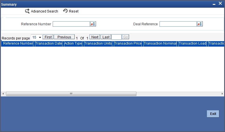

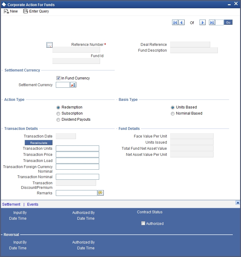

6.1.1 Maintaining Corporate Action for Funds
If you are calling a corporate action for funds record that has already been defined, choose the Summary option. From the ‘Summary’ screen double-click a class of your choice to open it. You can invoke the ‘Corporate Manual Action – Summary’ screen by typing ‘AMSCAONL’ in the field at the top right corner of the Application tool bar and clicking the adjoining arrow button.
In cases where there are no Investor services, you would need to enter details of the corporate actions manually. You can invoke the ‘Corporate Action For Funds’ screen by typing ‘AMDCAONL’ in the field at the top right corner of the Application tool bar and clicking the adjoining arrow button.
Oracle FLEXCUBE assigns a unique reference number to each corporate action that you process. This reference number bears a sequence in which the action was performed. You can assign your own identification to the action.
Settlement Currency
The settlement of a corporate action can be in the base currency of the fund or in another currency. Depending on the type of corporate action you are processing, it could be the currency in which:
l A subscription is made to the fund
l Units of the fund are redeemed
l Dividend is paid
If the corporate action is in the base currency of the fund, choose the option ‘In Fund Currency’. If the corporate action is not in the base currency, indicate the currency in which the corporate action is settled. The equivalent of the transaction amount denominated in the base currency of the fund is displayed. The standard rate is used in the currency conversion.
Action Type
The Corporate actions that can be processed during the lifecycle of a fund are:
l Redemption
l Subscription
l Dividend payment
Choose the appropriate option based on the type of corporate action you are processing on the fund.
Basis Type
Subscription and redemption can be enlisted in two ways:
l Units (500 units of a fund)
l As Nominal (units worth USD 5000)
For a corporate action that is denominated in units it is mandatory for you to indicate the number of units involved in the action. The transaction nominal amount is calculated based on the number of units that you specify and the load applicable to the fund. Fractional units will be handled based on the rounding and decimal unit preferences that you specified for the fund.
If the basis type is nominal, you should indicate the transaction amount. The number of units allocated is calculated based on the transaction nominal, the transaction load and the NAV of a unit of the fund.
If the basis type is nominal, you should indicate the transaction nominal amount and then click the ‘RECALC’ button. The number of units allocated is calculated based on the transaction nominal, the transaction load and the NAV of a unit of the fund. If the basis type is unit then need to mention the number of units.
Transaction Details
You can specify the following details here:
Transaction Units
If the quotation basis for the corporate action is expressed in Units, you should also specify the number of units that are involved in the corporate action. Based on the number of units that you specify, the transaction nominal amount is calculated.
If the quotation basis is Nominal, Oracle FLEXCUBE calculates the number of units based on the transaction nominal and load that you specify.
Transaction Price
The transaction price of an action is the price at which a single unit of the fund is transacted. Oracle FLEXCUBE calculates the transaction price as follows:
For a subscription,
NAV + Subscription Load
For a redemption,
NAV – Redemption Load
This amount is expressed in the base currency of the fund. You can change the price that is defaulted. If you change the defaulted transaction price the other related components like the transaction load will be automatically adjusted.
Transaction Load
The load applicable to a corporate action is defaulted from the fund to which the corporate action is associated. Depending on the type of corporate action you are processing, the buy/sell load will apply. For instance, if you process:
l A subscription the buy load will apply
l A redemption the sell load will apply
You have the option to use or change the defaulted buy or sell load. If you change the defaulted transaction load amount, the other related components like the transaction price will be automatically adjusted.
Note
 You can process a subscription or redemption on a fund with or without the transaction load.
Transaction Nominal
If the quotation basis for the corporate action is Nominal, you should specify the transaction amount expressed in the currency in which the action is settled. Based on the amount that you specify, the number of units is calculated.
If the quotation basis is Units, Oracle FLEXCUBE calculates the transaction nominal based on the number of units involved in the action and transaction load.
Transaction Discount or Premium
The transaction discount or premium indicates the profit or loss applicable for the corporate action you are processing.
Discount or Premium = (Transaction Price - FV per unit - Load per unit) x No of Units
It is computed as the difference between the Face value and the NAV of the Fund.
Fund Details
The following details of the fund for which you are processing corporate actions are displayed:
l The Face value per unit
l The number of units of the fund that have been issued
l The NAV of the fund
l The NAV of a single unit of the fund
