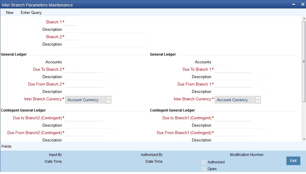

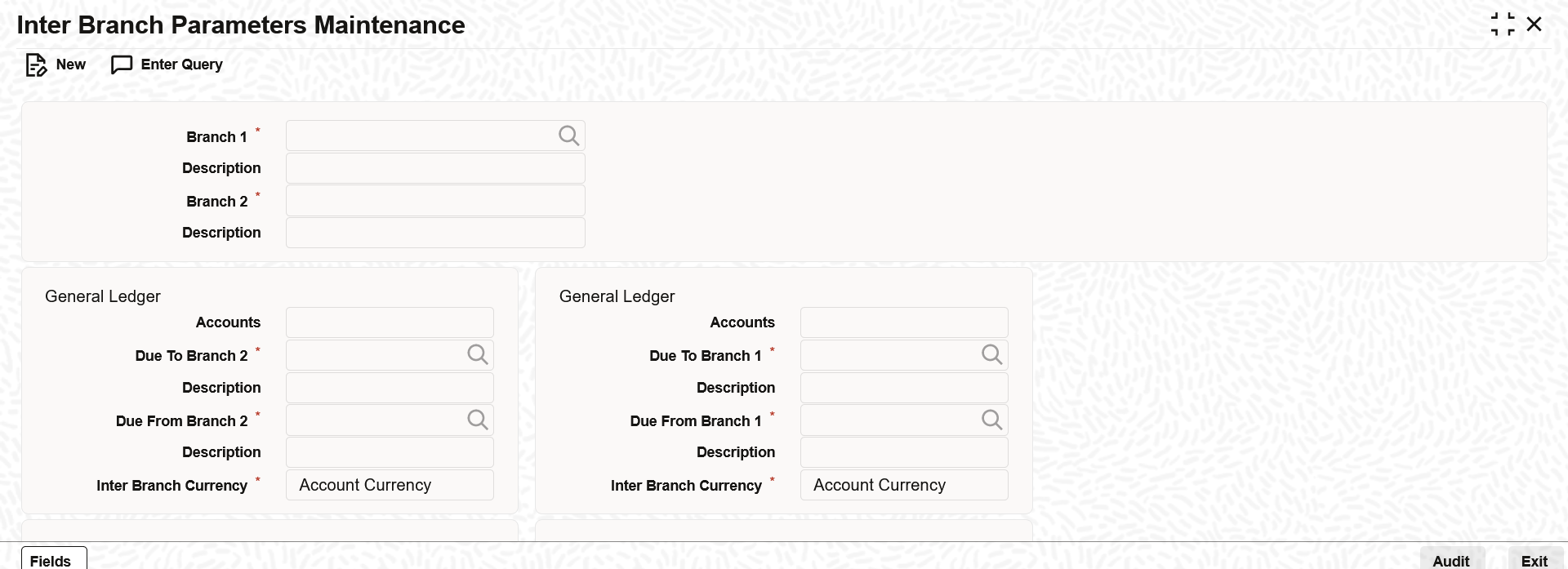

This route for all transactions is defined in the ‘Bank parameters’ screen. In the ‘Inter-branch Parameters Maintenance’ screen you define the internal accounts for pairs of branches that would be involved in any inter-branch accounting.
Invoke this screen by typing ‘ACDIBMNT’ in the field at the top right corner of the Application tool bar and clicking the adjoining arrow button.
The screen appears as shown below:
In this screen you maintain the following for each combination of branches that may be involved in an inter-branch transaction:
l Branch Code of both the branches that are involved in the transaction
l For each of the branches, whether inter-branch entries must be posted in transaction currency or settlement account currency
l GL accounts of Branch 1
Due to Branch 1
Due from Branch 1
l GL accounts of Branch 2
Due to Branch 2
Due from Branch 2

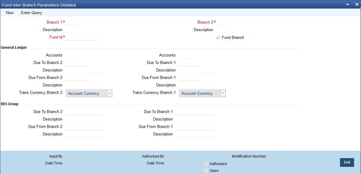

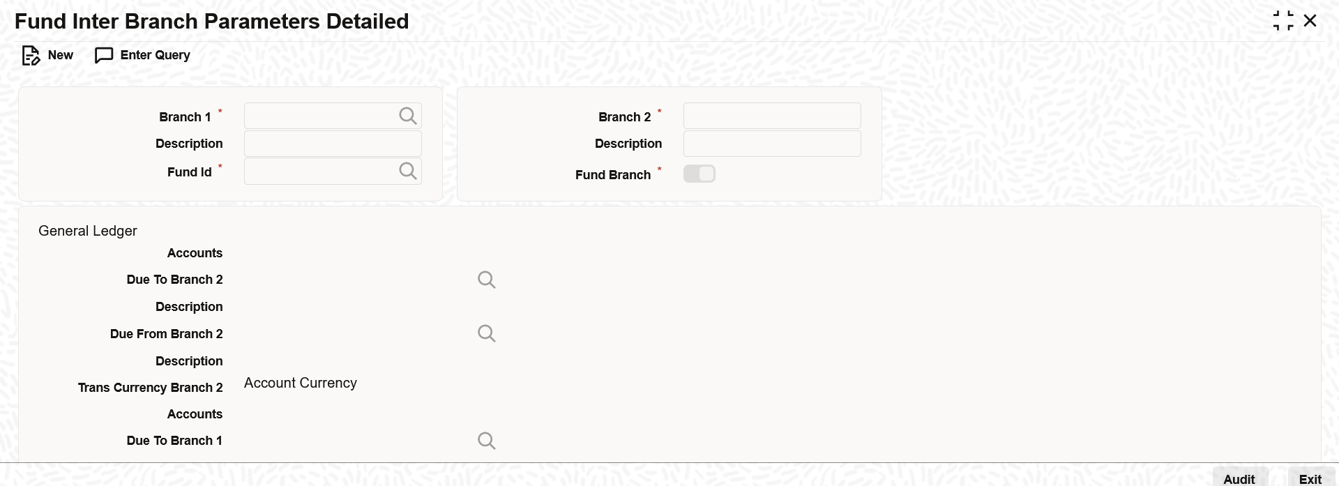

As mentioned earlier, if you have selected the option ‘Allow Corporate Access’ in the Branch Parameters screen and the branch is a fund branch, the IB Entity will be defaulted as General Ledger. The GL that will be used will be based on the maintenance in the Fund Inter Branch Accounts Maintenance screen, for the fund id.
To invoke this screen, type ‘IADIBMNT’ in the field at the top right corner of the Application tool bar and clicking the adjoining arrow button.
I
 For a fund id, specify all the details necessary to define the Inter branch GL that will be used. The option list against the field Fund ID includes all the valid funds maintained in the system.
For an explanation on each of the other fields, refer to the previous section.

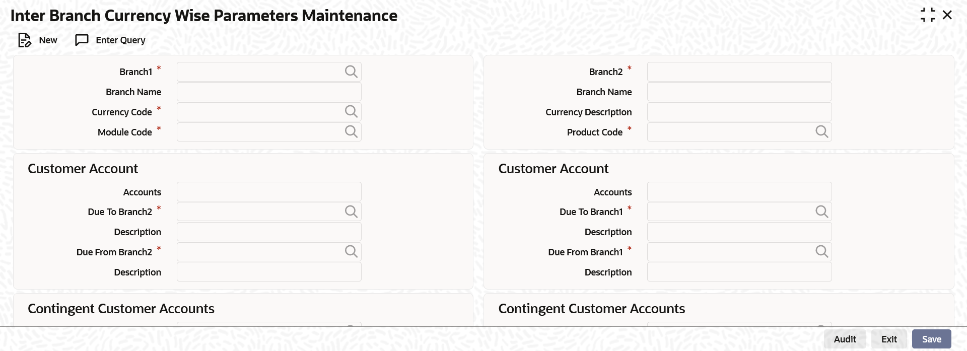

Inter-Branch Currency Wise Parameter Maintenance (CADIBMNT) allows you to define the routing of accounting entries that take place between two branches when the debit and the credit entries are posted to accounts that belong to different branches.
This maintenance allows you to set up the inter-branch parameters by following Branch, Currency, Module and Product wise hierarchy. Inter-Branch accounts to be debited and credited in case of a cross-branch transaction can be defined in three different ways.
1.  You can have a unique inter-branch entry definition for every Product belonging to a specific Module, per Currency,
2. A common definition of inter-branch entry for all Products under a Module, per Currency, or
3. An inter-branch entry definition common across an entire Branch, per currency.
System passes inter-branch entries based on the currency wise inter branch parameters, The preference will be given to the following order:
l Transaction module and transaction code
l Transaction module and all products
l All modules and all products
To invoke this screen, type ‘CADIBMNT’ in the field at the top right corner of the Application tool bar and clicking the adjoining arrow button.
I
Specify the following details in this screen:
Branch Code1
Specify the branch 1 code. Alternatively, you can also select the valid branch code from the adjoining option list.
Branch Code2
The system displays branch 2 code based on the branch code 1 selected.
Branch Name
The system displays the branch name based on the branch code selected.
Currency Code
Specify the currency code. Alternatively, you can select the currency code from the option list. The list displays all valid codes maintained in the system.
Currency Description
The system displays the currency description based on the currency code selected.
Module Code
Specify the module for which the currency wise inter-branch parameter to be maintained. Select ‘*.*’ to maintain currency wise inter branch parameter for all modules.
Product Code
Specify the product code. Alternatively, you can select the product code form the adjoining list. Product code will fetch all the valid products for selected module. Currency wise Inter branch parameter can be maintained for all product by selecting ‘*.*’ from the list values. You can select product code as ‘*.*’, only if module code selected as ‘*.*’.
Specifying Account Details
Due To Branch 2
This field identifies the account maintained in Branch 2 into which the credit entry is passed.
To specify the account, select the appropriate account from the pick list of all the customer accounts maintained at Branch 2.
Due From Branch 2
This field identifies the account maintained in Branch 2 into which a debit entry will be passed.
Due to Branch 1
This identifies the account maintained at Branch 1 into which a credit entry will be passed.
Due From Branch 1
This identifies the account maintained at Branch 1 into which a debit entry will be passed.
System uses the accounts specified in this screen and determines the settlement route for a transaction between two different branches of your bank.
