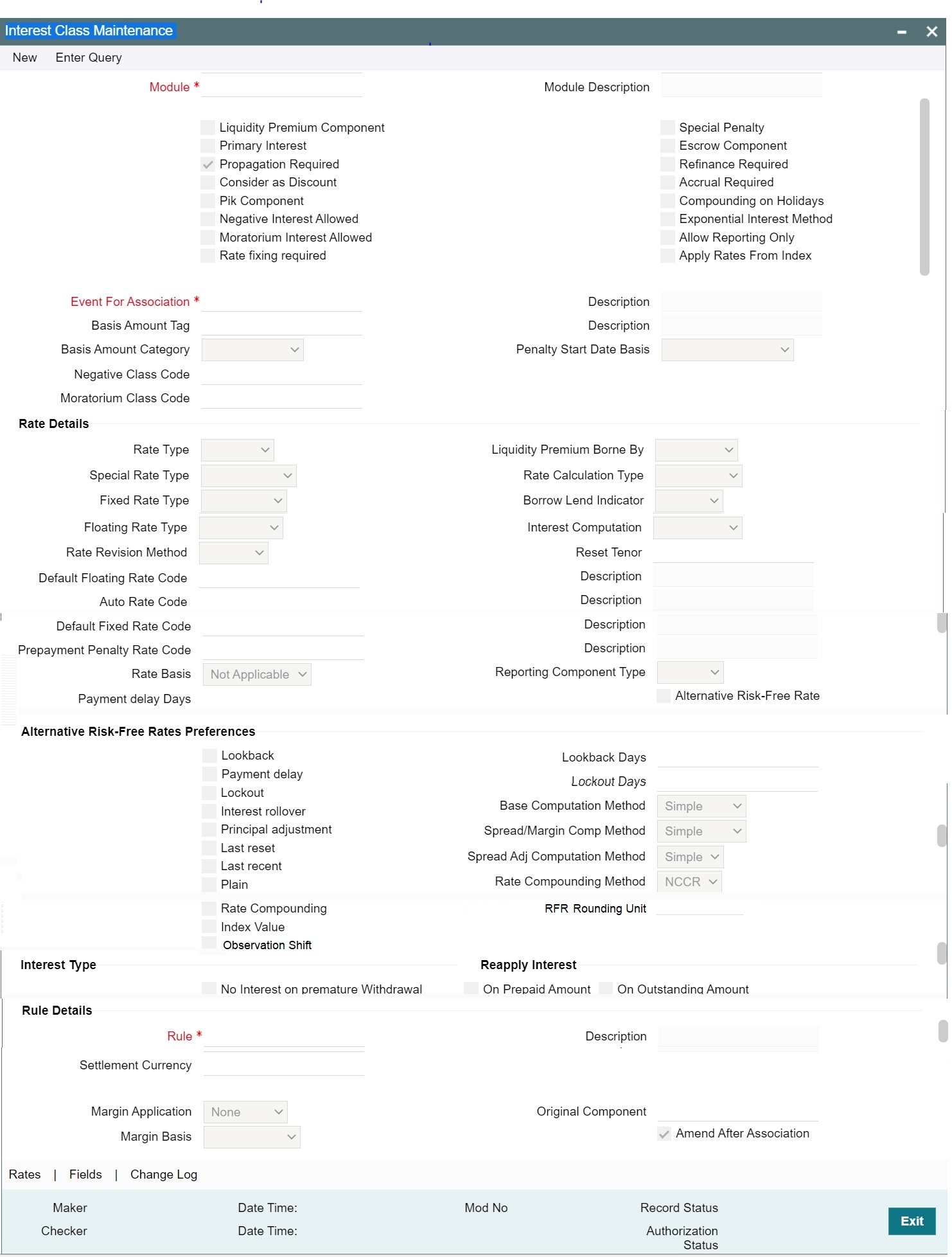

A class is a specific type of component that can be built with certain attributes. This chapter explains how interest classes are built and how attributes are defined.
When building an interest class, certain attributes, such as the following can be defined:
You can define the attributes of an interest class, in the ‘Interest Class Maintenance’ screen.
You can access this screen by typing LFDINTCL in the field at the top right corner of the Application tool bar and clicking the adjoining arrow button.
Before defining the attributes of an interest class, you should assign the class a unique identifier, called the Class Code and briefly describe the class. A description would help you easily identify a class.
An interest class is built for use in a specific module. This is because; an interest component would be applied on different basis amounts, in different modules.

Events
The term Event can be explained with reference to a deal. A deal goes through different stages in its life cycle, such as:
Each stage is referred to as an Event in Oracle Lending.
The event at which you would like to associate the interest component, being defined, to a contract is referred to as the Association Event.
Basis Amount Tag
The basis on which an interest is calculated is referred to as the Basis Amount. When building an interest class, you have to specify the tag associated with the Basis Amount.
The attributes defined for an interest class, will default to all products with which you associate the class. When maintaining interest details for a product, you can change these default attributes. Contracts maintained under a product will acquire the attributes defined for the loan product.

Specifying rate fixing
Select this check box to indicate whether the rate fixing is applicable for a particular component. This is applicable for Bilateral Loans and Loan Syndications.
Moratorium Interest Allowed and Moratorium Class code
In case 'Moratorium Interest Allowed' check box is selected for main interest component, then on save the system creates 'Moratorium Class Code' ('Class Code' field value is appended with _M).

Specifying the amount category
Indicate the category of the component on which the interest has to be applied. The available options are:
If Normal is selected, the balance on which interest has to be applied will be the Expected Balance (assuming that all the scheduled repayments, defined for the contract, are made on time). An example of this category is the application of interest on the principal of a loan.
If Overdue is selected, the balance on which interest has to be applied will be the amount that is outstanding, based on the repayment schedule defined for the contract. An example of this category is the application of penalty interest, on the principal or interest, when a repayment has not been made as per the schedule.
If Outstanding is selected with the amount category as principal, the interest is calculated on the balance of the total principal outstanding amount.
If Overdue OS is selected with the amount category as principal, the interest is calculated on the principal overdue outstanding.
If SCH-Overdue is selected, then the basis amount refers to amount outstanding on a particular schedule due date. If you select the ‘Basis Amount Tag’ as ‘SCH_AMT_OS’, then system defaults the ‘Amount Category’ as ‘Sch-Overdue’ and disables this field.
Select the applicable category using the drop-down list. The system defaults to Normal.

Rate Type
The interests paid on contracts can be at a Fixed Rate, or on the basis of a Floating Rate. If you indicate that interests should be calculated on the basis of a Floating Rate, you must specify the ‘Periodic’ Floating Rate Type.
For all contracts maintained under products, associated with a class, the interest will be by default calculated using the specified Rate type.
If you select the ‘Basis Amount Tag’ as ‘SCH_AMT_OS’, then system defaults the ‘Rate Type’ as ‘Special’ and disables this field.
Special Rate Type
Select the special rate type from the adjoining drop-down list. This list displays the following values:

Specifying the method for Interest Computation
You need to specify the method to be used for computation of interest. The available options are:
Indicating whether compounding of interest on holidays is required
You can opt to compound interest on holidays. Select the ‘Compounding on Holidays’ option to indicate the same.
An example to show compounded interest calculation is given under the section titled ‘Defining interest details’.
Indicating Exponential Interest Method
If main interest component is of exponential method for the loan product, the system validates that the day’s basis mentioned for main interest and penalty interest components are same during contract save/modification.
Indicating Allow Reporting Only
By default, this check box is not selected. If 'Allow Reporting Only' is selected then the component does not have any schedules and it is liquidated when the main interest is liquidated. For COSIF the accrual is always be on a Actual/360 basis, for RAP the amount is

Special Penalty Comp
System automatically checks this box if you select the ‘Basis Amount Tag’ as ’SCH_AMT_OS’ and you cannot modify it.
Specifying the Default Fixed Rate Code
If you opt for ‘Standard’ rate type, you have to select rate code based on which rate pick-up would be done.
All the rate codes maintained through the ‘Standard rate code maintenance’ screen will be available for selection in the option-list provided. The Standard rates maintained (in the Standard Rate Maintenance screen) for the selected rate code would be applicable on all products associated with the Interest class being maintained.

Choosing Rate Basis
The following options are available for rate basis.
Choosing the Default Floating Rate Code
Interest payable on contracts would be calculated at specific rates. When building an interest component, you have to specify the rate at which the interest should be computed. When associating a rate code (that you have maintained in the Rate Codes Maintenance screen) with the interest component that you are building, the rates corresponding to the code is used to compute interest.
The details defined for an interest class defaults to all products with which the class is associated. When maintaining interest details for a product, you can change this default information. Contracts maintained under a product acquires the interest details defined for the contract product. However, you can define unique interest details specific to a contract.

Indicating whether interest should be applied on premature withdrawal
You can opt to waive Interest on premature withdrawal of the loan. Select the ‘No interest on premature withdrawal’ option to indicate that interest needs to be waived if premature withdrawal (partial of full) is done for the loan.
Reapplying interest rate on prepayment
If the ‘Fixed’ rate type is ‘Standard’, you can opt to reapply interest when a prepayment is made.
You can reapply interest on one of the following:
Enabling the Consider as Discount option
While defining an interest class for either the loans or the bills module, you can indicate whether the interest component is to be considered for discount accrual on a constant yield basis and whether accrual of interest is required.
If you select the ‘Consider as Discount’ option the interest received against the component is used in the computation of the constant yield and subsequently amortized over the tenor of the associated contract. By checking this option, you can also indicate whether the component should be included in the Internal Rate of Return computation.
If you select the ‘Accrual Required’ option, the interest is accrued depending on the accrual preferences defined for the product.
If neither option is selected, the interest is not accrued, but is recognized as income on interest liquidation.
The ‘Consider as Discount’ option is not available if the amount category is Penalty.

Reporting Component Type
By default, the value is blank. You can select RAP, COSIF and blank from the drop-down list. This is applicable only when ‘Allow Reporting Only’ is selected.
Payment Delay Days
You can define the payment delay days in this screen and the same is defaulted to product and contract screens.
Payment delay days is used to capture the number of days between 'Schedule Due Date' and 'Pay By Date'.

Alternative Risk-Free Rate
If you select this check box then only you can select options available in the 'Alternative Risk-Free Rates Preferences' screen. Select this check box to define floating rate as ‘Alternative Risk Free Rate’.
Note
Look back and Look out methods can be selected in combination. None of the other methods are selected in combination.

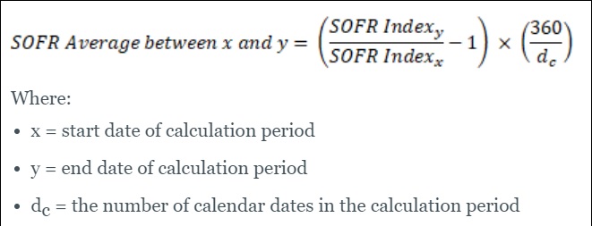

Last reset
This SOFR method is for discounted loans and true discounted loans. The SOFR average rate same as the payment periodicity of the loan will be linked operationally. Booking and cash flow projection goes with latest available rate of the linked rate code. On payment due date BOD rate revision is triggered to fetch the latest average rate. Re-calculation happens with this rate and the same is liquidated.
For example, For a 1 year contract with quarterly liquidation cycle, the 90 days average SOFR rate code will be mapped. And, for a loan with monthly payment schedule, the 30 days average SOFR rate code is linked. On booking, latest available average SOFR rate is picked up & applied to the loan. Cash flow projection till maturity goes with this rate. Advance interest collection for the first schedule happens with the same rate, on booking. Every day accrual happens with the same rate. Rate revision is controlled on this method, and triggered only on the payment due dates. On due date BOD, again the latest available average SOFR rate is picked up applied for the subsequent schedules. Rate fixing days is applicable to this method.
For example, For a last reset loan booked on Tue, 12 May 20 with rate fixing days 2, the SOFR average rate of Fri 08 Aug 20 is applied.
Last recent
This SOFR method is for discounted loans and true discounted loans. The recent SOFR average rate, lesser than the payment periodicity of the loan will be linked operationally. Booking and cash flow projection goes with latest available rate of the linked rate code. On payment due date BOD rate revision is triggered to fetch the latest average rate. Re-calculation happens with this rate and the same is liquidated.
For example, For a 1 year contract with quarterly liquidation cycle, the 30 days average SOFR rate code will be mapped. On booking, latest available average SOFR rate is picked up & applied to the loan. Cash flow projection till maturity goes with this rate. Advance interest collection for the first schedule happens with the same rate, on booking. Every day accrual happens with the same rate. Rate revision is controlled on this method, and triggered only on the payment due dates. On due date BOD, again the latest available average SOFR rate is picked up applied for the subsequent schedules. Rate fixing days is applicable to this method. Ex : For a Last Recent loan booked on Tue, 12 May 20 with rate fixing days 2, the SOFR average rate of Fri 08 Aug 20 is applied.

Rate Compounding
Rate Compounding is another method of compounding the interest in SOFR calculation along with amount compounding. Rate Compounding approaches accurately compound interest when principal is unchanged within an interest period or, if principal is paid down, when any accompanying interest is paid down at the same time.
Index Value
To apply index related rate code along with amount compounding, index value method to be selected. The RFR index measures the cumulative impact of compounding the RFR on a unit of investment over time, with the initial value set to 1.00000000 on a particular date. The Index is compounded by the value of each RFR thereafter. The following formula can be used to calculate compounded averages of the SOFR over custom time periods between any two dates within the SOFR publication calendar.
Observation Shift
In RFR Look back method, when a back dated rate is applied for the current date, the weightage of the rate, based on its applicable days, is considered while arriving the rate factor, and applied to the current rate application date.

You can select 'Simple' or 'Compound'. For compounding, interest calculation on week days go with compounded P, while for week ends its on simple P.
Rate Compounding Method
You can either select 'NCCR' or 'CCR' methods. The rate compounding happens in these two methods for RFR rate types (Normal and Index value rate types).
CCR - Cumulative Compounded Rate calculates the compounded rate at the end of the interest period and it is applied to the whole period. It allows calculation of interest for the whole period using a single compounded rate.
NCCR - Non Cumulative Compounded Rate is derived from Cumulative Compounded Rate i.e., The Cumulative Compounded Rate is first un-annualized. And then the cumulating is removed by subtracting previous day rate with current day & the same is annualized.. This generates a daily compounded rate which allows the calculation of a daily interest amount. For OL module, this value gets defaulted to 'Bilateral Loans - Product Definition' (OLDPRMNT) from 'Interest Class Maintenance' screen. If required, you can define rate compounding method at component level in these product screens. Similarly, rate compounding method is defaulted to 'Loan and Commitment -Contract Input' (OLDTRONL) screen based on the selection at the product level. If required, you can define rate compounding method at component level in these contract screens.
For LB module, this value gets defaulted to Loan Syndication -Borrower Product Definition' (LBDPRMNT) screen from 'Interest Class Maintenance' screen and then it is defaulted from product to tranche (LBDTRONL). If required, you can redefine the rate compounding method at tranche level. For drawdown contract (LBDDDONL), rate compounding method is defaulted from tranche (LBDTRONL). If tranche level rate compounding method is not defined then, it is defaulted from product screen. If required, you can redefine the rate compounding method at drawdown contract level as well.
RFR Rounding Unit
This option is applicable only for Rate compounding method. This contains the Risk Free Rate rounding unit as agreed with the borrower. The CCR is rounded with this parameter.
When you define an interest class, you can specify the limits applicable for the interest component, and the rules according to which interest amounts in respect of the interest component must be rounded. To define the rules, click the ‘Rates’ button in the ‘Interest Class Maintenance’ screen. The ‘Rates’ screen is displayed.
In this screen, the following limits and rounding rules can be defined for each currency and for each tenor:
